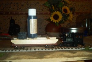

Just roughing one out...please advise! I stuck an MDC Shay fuel tank on the back, as well as an acrylic paint bottle (for diameter, NOT height) just for starters.
-Not long enough?
-Is the "fuel tank" too small?
-Are the skids too tall?
Help!!

Disclaimer: I have never seen or built a donkey and I don't know anything about logging, On30 or 303's, so I am likely the least qualified person to answer your post. I do know how to club away at the keyboard, though, so I'm gunna try :D :D :D
Referring to the famouse shamos 303 donkey here, the one in the Academy: If I'm not mistaken, a 303 casing would be .3" at the top where it was once crimped to a lead pill. Just earballin it, I would say it's about 5 times taller than that, or about 1.5" Sooooo, if I'm not mistaken, I guess you about double it to get O from HO, so I guess you want it to be about 1/2 in dia or maybe 3/4 and about 3" tall. Someone please correct me if I'm wrong, but this should get you close enough for government work. I would start with 1/2" PVC pipe and go from there :D :D :D Maybe even 1/2" PVC caps, which are about 5/8 or 3/4 dia, then go to 1/2" pipe at the top?

You have a great start there my friend, the Boiler looks about right for size, I used an old 303 shell for mine.

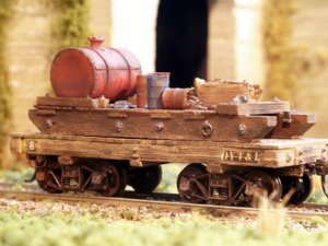

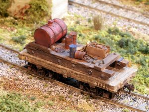

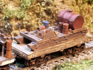

I didn't model the sled in the photos below with an engine (sorry, Shamus :( ), but one is in the plans.:)

lighthorseman,
I can give you a few dimensions which may help.
skid length= 14'-15'
skids=12" X 12"
boiler diameter=39" - 42"
boiler height (to top of stack)=12'
boiler height to beginning of taper to stack=7'
boiler, winches,etc are mounted on 12" I beams bolted to skid
stack diameter=9"
These dimensions are close, there were different manufacturers, so sizes varied somewhat, but this should get you, not just in the ball park, but within the base lines.
Pete
Hi Steve, You know, I wish I would do a little more forethought to my models and mock them up before I get down to the building:eek: :D :D I think your idea is a great approach:) :)
Nothing critical at all....just wondering though if the skids are perhaps just a bit high??? It may be just the way I'm looking at it and it may be the way its supposed to be. The reason I say that is because 12x12 timber was about as large as could be cut in a backwoods saw mill where a lot of these contraptions were built...or rebuilt 'cause they really took some "hard knocks" in actual use. Just thinking that if the skids need to be higher than that you could use 12x12 for the base and 4x12 or 6x12 for a cap. That might result in a more "rustic":D look too.
