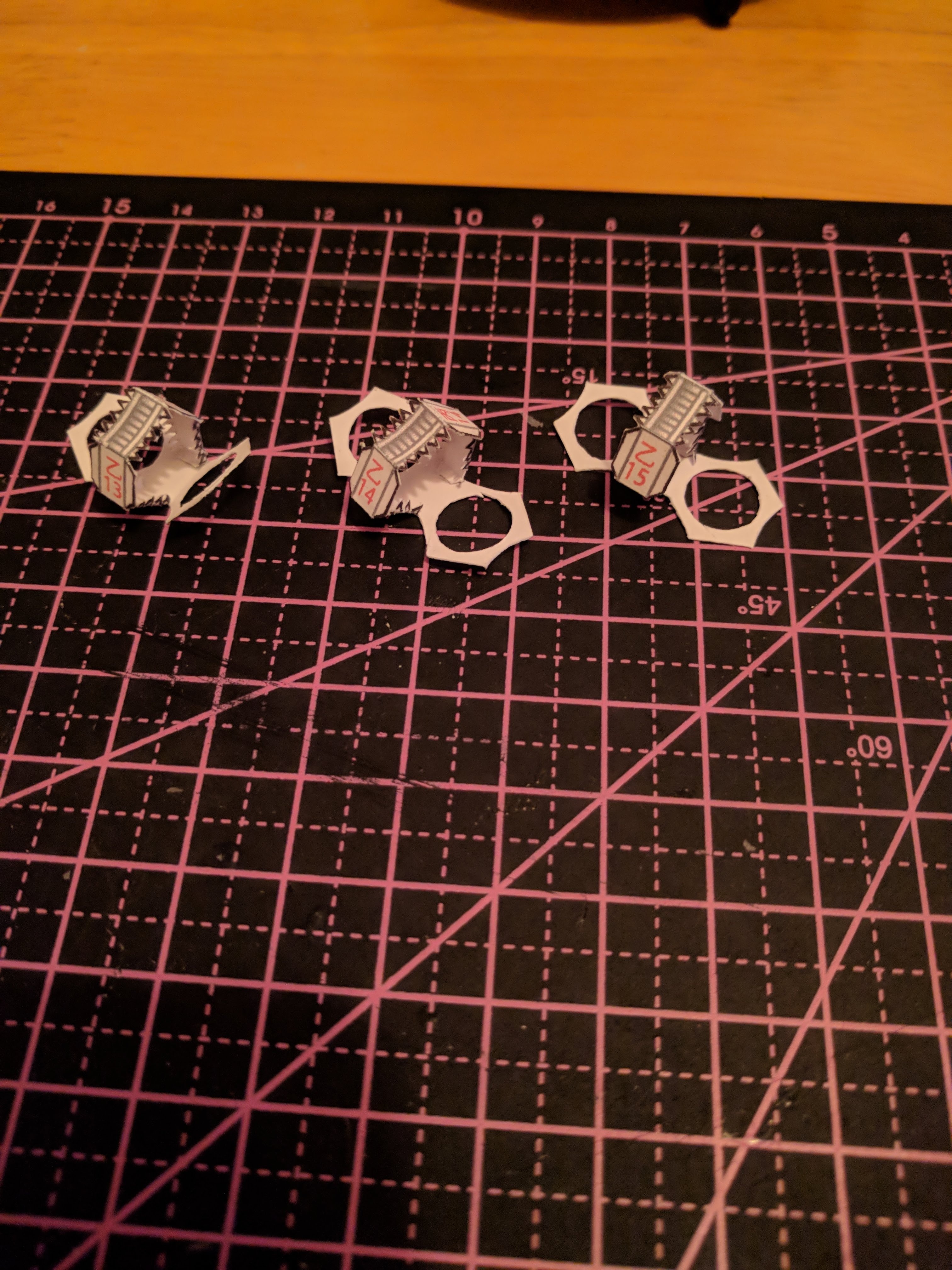

Here's my first nut...

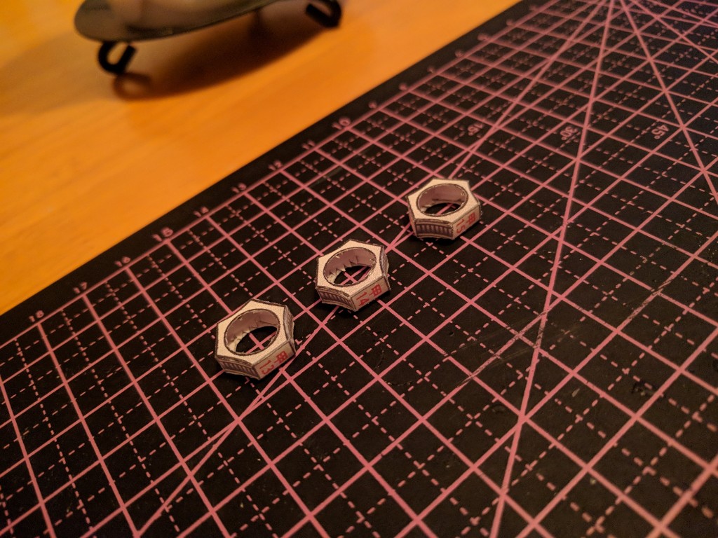

I've found it best to create the nuts in batches of three, attaching the outer belt, and then once you've folded in all the tabs, glueing each of the 'faces' in place. Prior to attaching the belt, you'll want to work the printed sections around the shaft of a screwdriver (e.g.), so that you can get a concave profile to match the profile of the nut when you fold the sides in place.

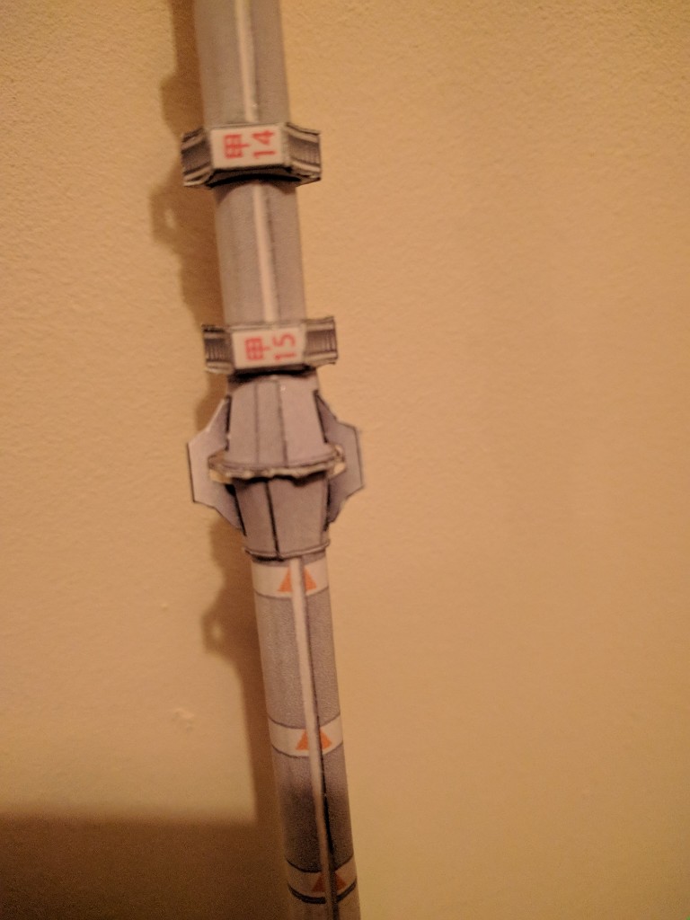

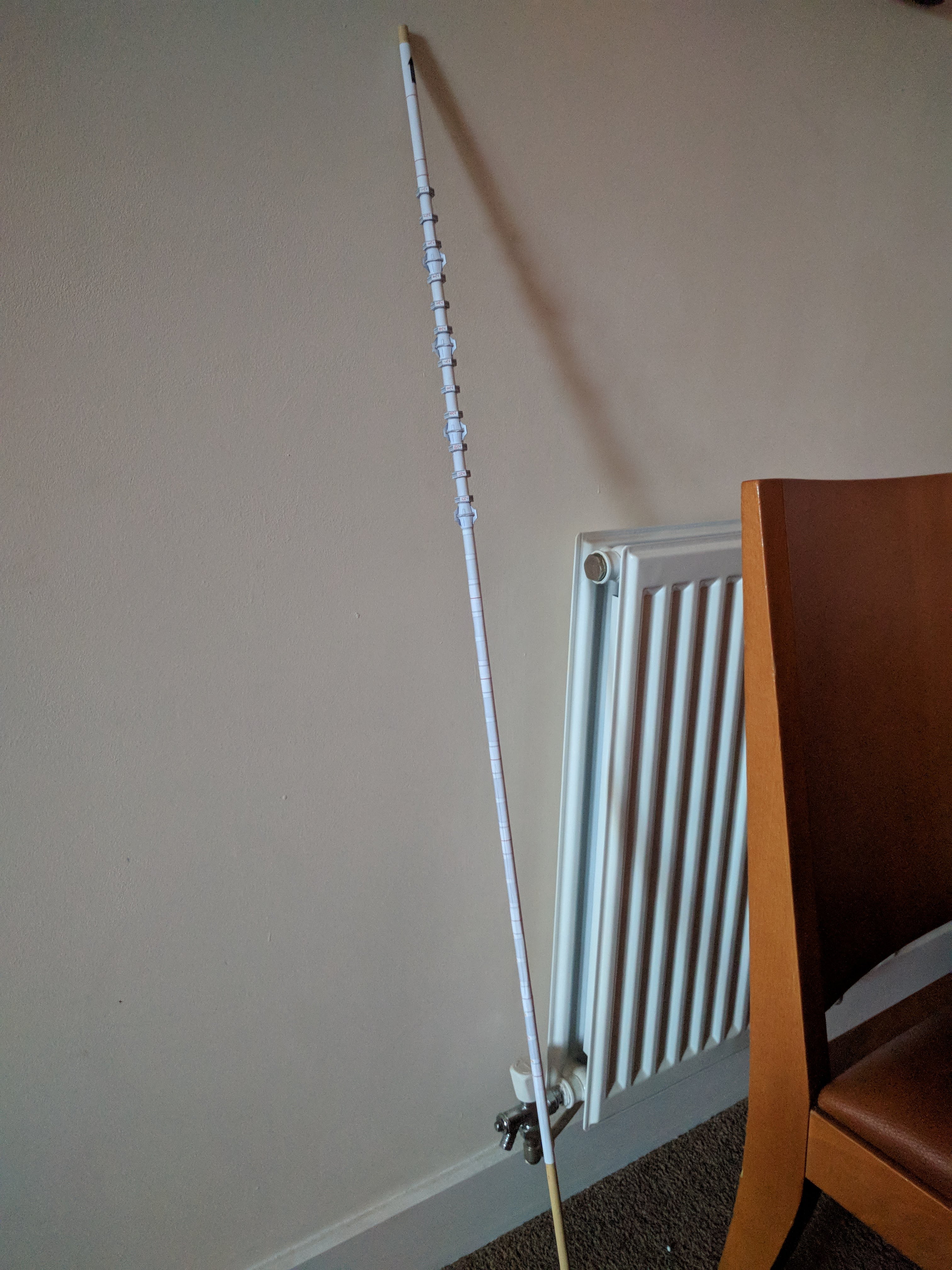

The picture of the spine looks really good. You're off to a great start. I would highly recommend you cut off the glue tabs, and make your own glue strips. This will allow the edge pieces to be on the same plane. This has been discussed much on this forum. You make a strip, of the appropriate side, and leave enough on to glue to joining piece. This allows for the edges to line of edge to edge, not offset by the glue tabs located on one side. Since the first half of the glue tab is on the backside on the piece, it will line up excellently with the adjoining piece. :)

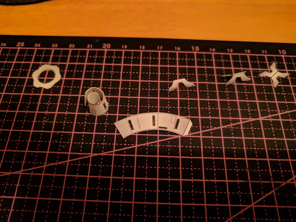

Here's the parts for the connecting sections on the spine. The round washer in the centre of the assembly has a handy red point on it which you can use to align with the seam on the papers wrapped round the spine.
I couldn't find any reference as to which way round the two conical sections go - on mine the one with the black bar brings up the rear. I notice on UHU02's pics the joints of these 'cones' match beautifully, but you need to ensure the slots align, which on my model forced the joints out of alignment. Not an issue, I just point out for reference.
The final pieces are the 'bridges' from one cone, over the washer to the other cone. These are easily applied using tweezers to guide them through the slots in the cones.

Good start, make the decision to cut on the lines, or leave them there, it makes a difference in the sum total. ;)

When I did the connecting cones, I didn't bother cutting the slots out, I just edge glued the clamps/bridges to the cones. Without the slots interfering with the stress of the paper, you get a more uniform cone this way. Also saves on some cutting work too .... ;)
