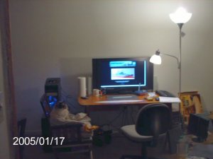

this is the work station that kitty AND i use to browse the internet and make paper models. kitty wants to start on the arizona model i have been talking about, so im going to start it before she starts up again

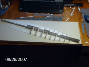

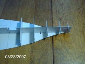

i have been gluing joints with aleens and then reinforcing them on both sides with super glue, there is no comparision it is 100x stronger joint and i will use this method on all my structural joints from now on. its the connecting joint on the bottom part and then i sand till smooth cause the super glue can make a little speed bump, im really impressed with how strong it makes the joint

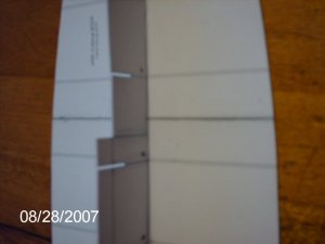

i am also super glueing all of the card stock sides AND slatts to reinforce them, i really think its worth the extra effort does any one else use this technique? also i am really liking how the color laserjet at the office printed out the color pages i am going to have to seriously consider purchasing one, because i felt awefull guilty printing the 28 pages for this model... :shock:

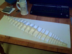

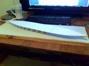

well i took apart the shelf's in my closet and i am going to use the shelf to temporary mount the superstructure, and i must say it is working very nicely, but kitty realises some thing is going on, so i have to be quick...
the quality of romans kits are amazing and worthy of printing out on your companies color laserjet...:twisted:

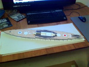

here is the results of tonights work
i have noticed one error in the plans for the superstructure
part 8 has to have the verticle saddle cut about a quarter inch higer than planned for or the piece will not fit as it is supposed to, but once cared for fits as it should, it seems that preparing each piece with the superglue does add time it really makes for a much securer adhesion i have even abandoned using white glue on the superstructure, and i just brush the super glue over the 2 pieces and it soaks in and bonds even faster than the tacky glue, i think i will use this method to finish the superstructure, with maye a ribbon of glue over that for a super bond.
more later this week, oh yeah im much happier man handling the model now that it is temprary fixed to the wooden board not to mention that it keeps it true and prevents warping, i will do that from now on when i can...
kitty said hi, im hungry...

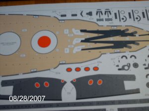

i think i have finally caught a gremlin on film
it is stalking my arizona waiting to cause havoc since i have managed to get some more work done
you tell me what???
scary no???
that is a true unaltered unedited unphotoshopped picture of the beastie
right after i told it NO in a very serious voice
i think she might be mad
i dont sleep with her tonight :shock:

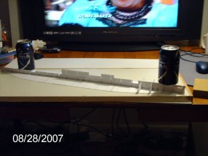

well this update will show removal of the deck
i decided it was too thin and i will start over on the deck when
i have it at 1.5 mm or 2 mm
it just felt to flimsy when assembled
i will assemble deck again once entire superstructure is completed
also i will release top structure from temp base
im amazed how well that worked
trick is using enough glue to mount yet not enough to make permanent
i prolly used just a little too much on ethier end and it was tough removing
but its absolutely straight and worth the effort
i think i might find a piece of glass to mount on the board
im sure it would be easier to remove with razor from glass
and as you can see she is now free from her bondage and assembly will now start on the lower structure
