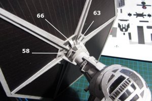

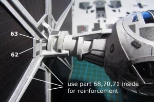

Hi,

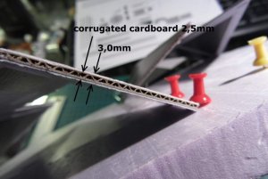

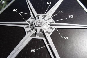

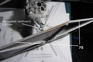

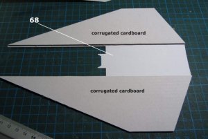

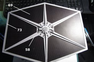

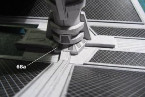

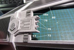

these pictures show how I built the wings of the Tie-Fighter. I used for part 58 reinforcement(parts 68,70 and 71) made of 1mm cardstock and I glued it inside.
@ dnalor : I use corrugated cardstock, additional reinforced frames(58 ) and it is also glued in several layers like a sandwich. If you knock on the wing, it sounds very strong, like wood :mrgreen:

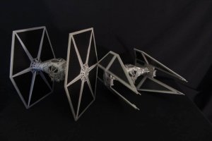

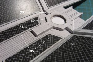

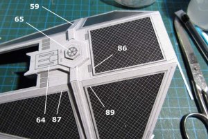

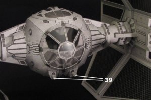

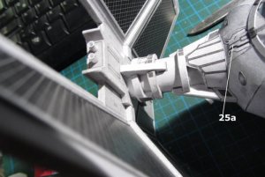

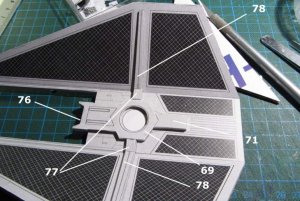

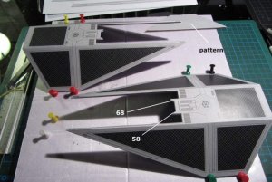

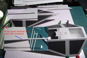

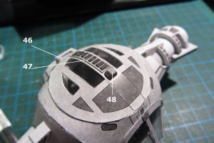

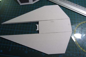

that was the Tie Fighter. Now you can see show how I built the wings of the Tie Interceptor:

Man am I biting my tongue here! Beautiful workmanship Loenf, beautiful. Until this Tie Fighter, I have never see an Tie Fighter so elegant! Truly fantastic! :)

never thought about it to use the corrugated cardstock and glue normal cardboard over them..nice :-)
Nomex Honeycomb, which is quite flexible till epoxy is applied is similar to cardboard and it's application in this case. In a helicopter blade, the Nomex Honeycomb material is doped with a proprietary epoxy resign and carbon fiber is applied over it. The rigidity of the Nomex Honeycomb applied with the tensile strength of the pre peg carbon fiber cloth makes for a very strong, stronger than ay metal, blade, yet flexible, once out of the autoclave, of course. I have seen Blackhawk Helicopter blades with multiple rounds threw the blades and the craft have landed safely. The picture below is of an S-76 blade.
That being said, a corrugated piece of soft cardboard doped up with a stiff glue or resin, can make, cut to shape first, could be a great basis for a strong part. The same cardboard unglued would be a moisture sponge. Glue of some sort is needed to seal it, resin, liquid crazy glue, would make it very stiff, though the health concern for a model part is kind of high. The part showing the cardboard interior looks very industrial! :)

The upclose shots really show off just how well done this is. It looks as good upclose as it does far away. Truly impressive.
Truly, I have not see any Star Wars craft that look this tight and crisp. They do look like computer renders. You would make George Lucas Proud! :)
