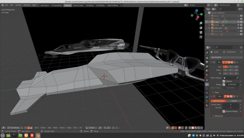

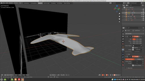

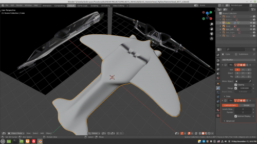

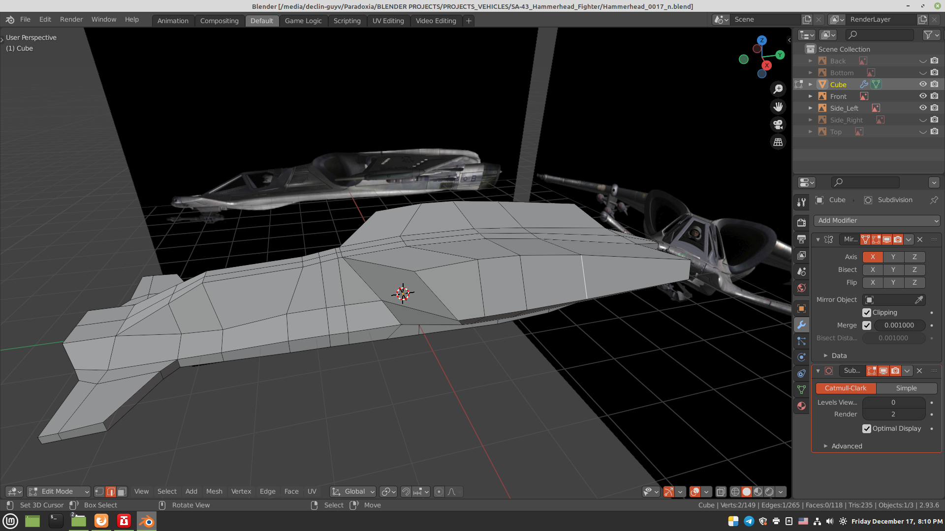

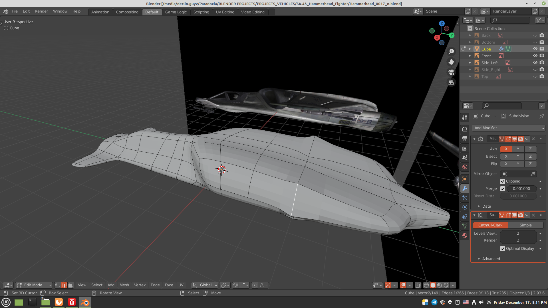

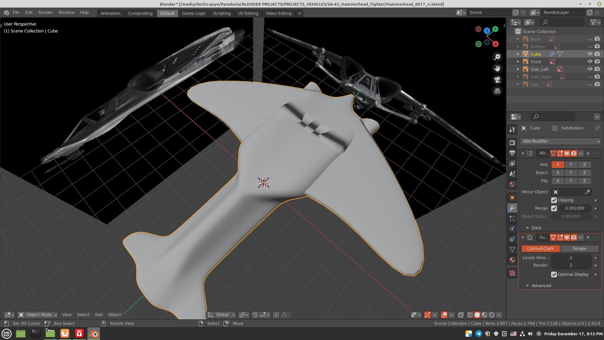

This is not really an update, but something to illustrate a problem you may come across of you are a Blender user. In this picture, my mesh looks okay. I'm getting the form of the Hammerhead established. The air intakes are starting to take shape.

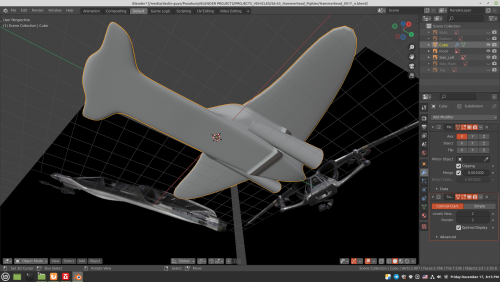

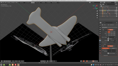

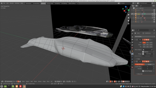

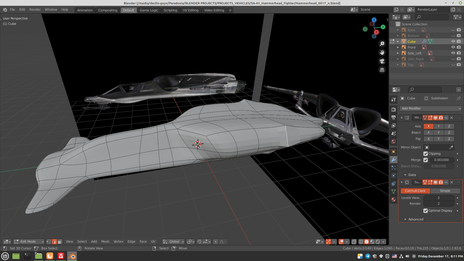

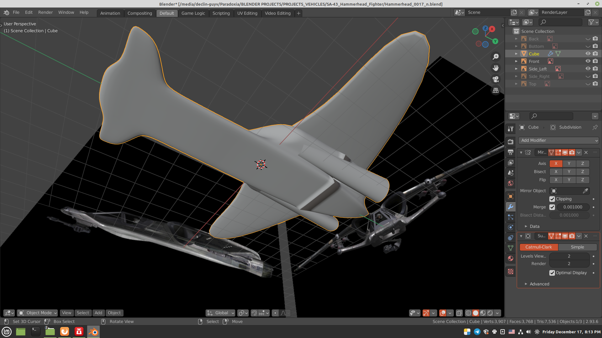

But, when I go to apply the Subdivision Surface Modifier to the mesh (Level 2), we see that there is a problem! If yoy look carefully, you will notice that the mesh is not being smoothed in the area by the white line. It looks "off" to what one would expect.

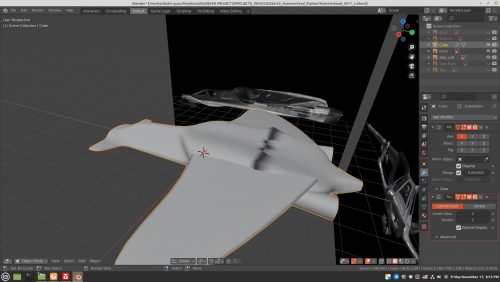

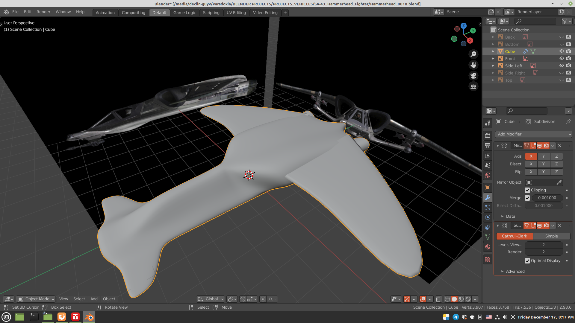

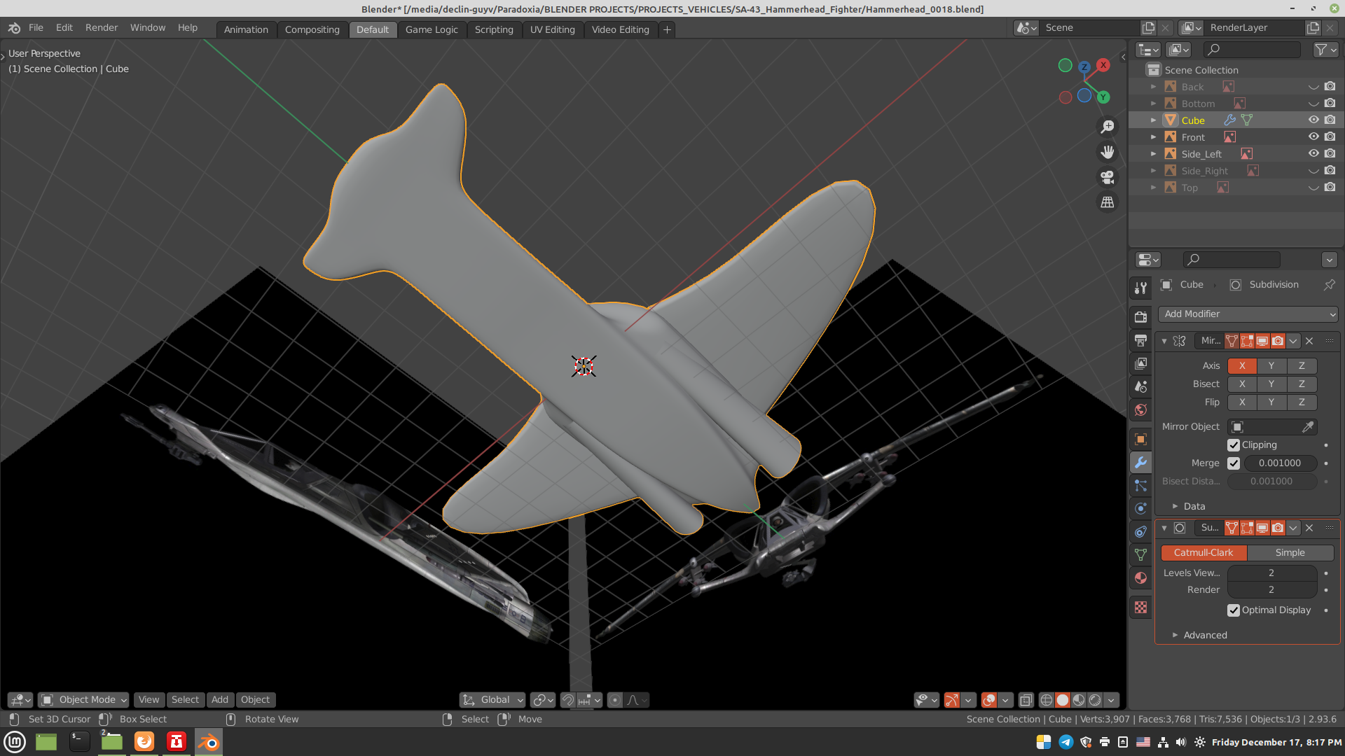

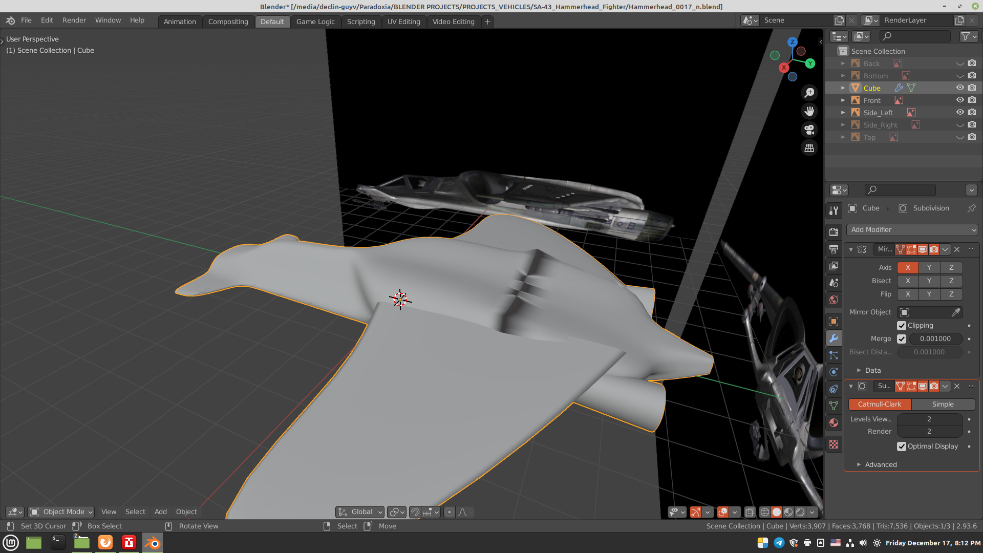

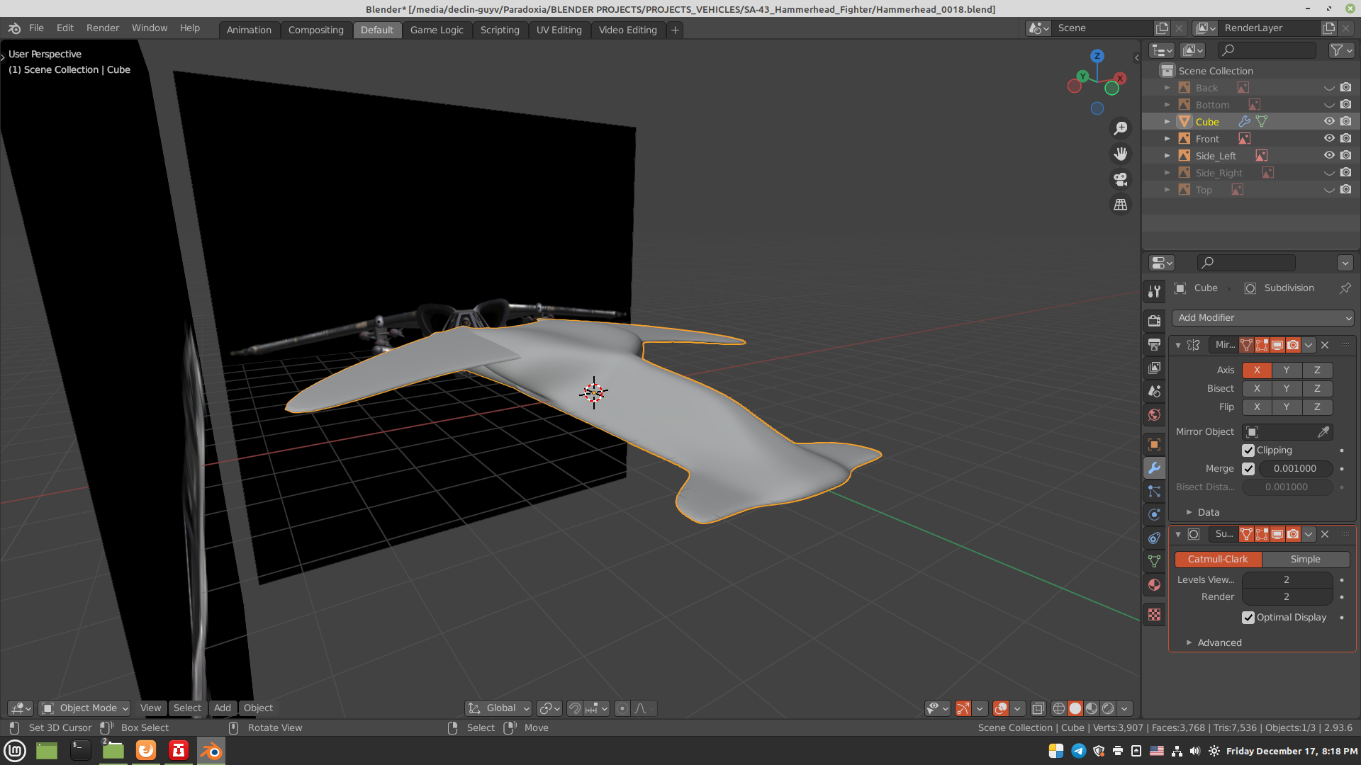

When I go from Edit Mode to Object Mode, and apply "Shade Smooth" to the mesh, the problem becomes more than apparent.
We notice an ugly black band going around the model, basically ruining the nice geometry we want to have.

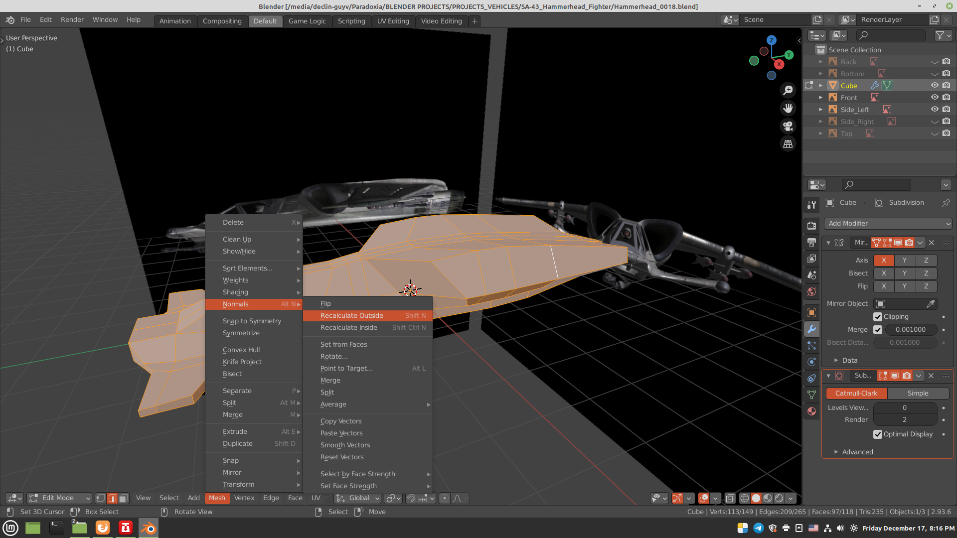

This is caused by the "normals" of the mesh being out of whack. Somehow when I was extruding vertices and faces, the "normals" of some of the faces got reversed causing the black band around the model.

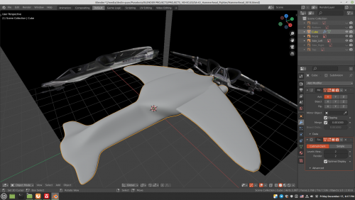

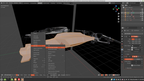

What can we do to fix this mess, this abomination that ruins our work?

@Revell-Fan You're welcome! I thought it would be a useful tidbit to point out. When I was first learning Blender dealing with this was aggravating until I stumbled upon a tutorial that explained "normals" and how to correct them if need be. Every 3D program has its own quirks and idiosyncrasies, and part of the 3D process is to learn about them and how to work around them.
In Blender, I also have to be careful of hidden geometry or when i go to subdivide the mesh it messes that up. In my case, it's usually because I forgot to delete some internal face or delete (or merge) unnecessary vertices.

Is it good approach to use Subdivision Surface Modifier when modeling for paper? Will not it be complicated to unfold such dense geometry?
@bigpetr That those are great questions! As this is my first design for a card/paper model, I'm going to find that out. My plan right now is to make a low-poly mesh of the model and then refine the details as needed. Once I get a low-poly mesh done I will be able to see the areas that need to be refined, and then I'll make the decision to apply the Subdivision Surface Modifier.
As far as a workflow, I'm keeping the low-poly mesh, and refining that as needed. My theory is that it will be easier to unfold a low-poly mesh rather than a high-density one. I will have to do some experimentation to see what works the best.
Please stay tuned and thank you for your great questions!
I see. Good plan. Personaly I would not use Subdivisons. Every subdivison level multiplies number of guads by four (tris by three), and it means a lot more geometry to handle and sort out when unfolding. Subdivisions are useful when modeling for renderings nad such, because then you control subdivided highpoly mesh with base lopoly mesh and it is much easier. When modeling for paper, you need to have precise control over every face to be able to devide model to individual paper parts.
