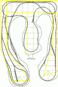

Hey Guys, New to this DCC thing and it has me a bit confused. I've purchased a Prodigy Advance system and now want to start wiring new layout but I am a bit confused about power districts/blocks and the easiest way to go about it. I am attaching a copy of my layout and would like to get some helpful hints from you guys as to what to watch out for on my layout.
The graphic doesn't show the siding or yard yet as they have to be finalized but still I am ready to get my feet wet with the wiring. What I really need is for one of you to push me in. The layout size is 21'x14'. I have concerns in regards to having my bus wires longer than 30' as per www.wiringfordcc. More to follow, just wanted to get this puppy barking!:thumb:

You do have a reverse loop on the right side - I can't tell if there's a turnout in the middle at the top or what. I would first locate and attend to the reversing loops using an automatic reverse loop controler then decide on how many and where you want the power districts. It will depend mostly on how much power you intend to have and how many trains you will be running at once. Once that is done, you can optimize the system for run lengths possibly even having to relocate your command center (I know I wound up moving mine from my original intended location)

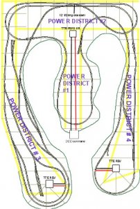

Thanks Jerry, Heres how I kind of envision the power districts. But is it that critical that the main power bus remain under 30 ft. If I were to add terminal blocks would that lessen the amount of inductance in the wire or possibly twist the wire or even yet terminate the wire as per www.wiringfordcc/track_2.htm.

Here we're talking length without mentioning wire gauge. Using larger (lower numbered) wire will allow for longer runs. I'm using #12 stranded and have runs (out and back) to about 64'. I don't think (don't really know) that terminal blocks will eliminate potential inductance but twisting will. I twisted all my cables before installing on the layout.

I'm using #14 solid core and #20 for feeders Do you think that should be alright? Jerry, how to you terminate the ends of your bus wires?
