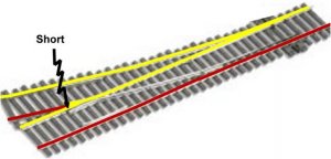

If you are using an older Shinohara turnout, you will have to insulate the frog from the two rails that diverge from the frog. Otherwise, you will have installed a short on your layout.
The short on the older Shinohara turnouts is caused in two places - at the frog, and at the points. The newer Shinohara turnouts have fixed this problem and are advertised as being DCC friendly. (The newer Walthers turnouts are also made by Shinohara and are advertised as being DCC friendly.)
The short at the point is caused by the two copper wiper strips on the underside of the points. As you move the points from one position to the other, the wiper strips momentarily contact with both outside rails which causes a short. The easy and quick way to fix this is to very carefully trim/ file the copper wiper strips so that there isn't this momentary contact with both outside rails.
The short at the frog end is due to the fact that the two diverging rails from the frog are electrically connected to the frog. The way to fix this is to cut an insulating gap at a point just beyond the frog on the two diverging rails.
