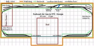

Anyone know of a website with DC info, All I can find is DCC stuff????
Yep, Shamus. That looks about right, using the "theory" that I mumbled out! :thumb:
But I think you missed an insulation point. It's a bit hard to see on the track plan, but it looks like there is a set of oppossing turnouts just to the left, under the "saw mill" from the mainline to the siding, that will need insulating between the "crossover" joint of those opposing turnouts. It's a bit hard to tell if it's a set of oppossing turnouts, or just a "blotch" on the layout plan.
Wadda ya reckon?
Just had another close look too, Shamus. With that insulation point on the passing loop at the "slate quarry", there is no way of powering the "slate quarry" sidings. I would insulate between the opossing turnouts just above the "slate quarry sidings, keep your insulating point on the passing loop, and apply power to the passing loop, between your insulating point, and the turnout to the left on that passing loop. As it is, with your insulating point on the passing loop, should the turnout from the mainline (at the left) be switched to the passing loop, and the turnout from the passing loop be switched to the "slate quarry", you will get a short.
Also, at the saw mill, I would move the power to the other end of the siding, and, again, insulate between the opposing turnouts that connect the top swamill siding to the passing loop.
The rules I dicerned from that book, is to always insulate (and never power) when encountering converging turnouts (to the left and right of a particular point on the track), and only apply power on the diverging (single track) side of turnouts.
Again, wadda ya reckon?
True 60103. That would work. I think the location you are referring to is the opposing turnouts (crossover) that I was referring to as "just above the slate quarry". Insulating there, will power that entire section (passing loop and slate quarry) only when the turnout at the far right of the passing loop is switched to the passing loop. I would move where Shamus insulated to the far right end of the passing loop, and power the passing loop. This would allow for some switching activity on the loop and siding, while the mainline trains can still run. It would require 2 controllers, of course, and have each block power connection switchable between the two. Not sure if SAL wants to run with two controllers, and hence allow multiple train operation at the same time. But what you suggest would be fine for single controller/train operation.
Do you wish to run more than one train at once SAL? Say, a mainline "thru" train, and do some yard switching?

Shamus,
If I'm not mistaken (and I may be) you've moved the "power to tracks" on the sawmill siding to the other end. (and reposted your diagram). If my reckoning is correct, then should the turnout from the mainline be switched to the sawmill passing loop (at the right hand end of the loop), and then the passing loop be switched through to the sawmill siding, and the sawmill siding turnout be switched to straight though, along the entire siding, then you will get a short. If I've missed something here, can you help me out with where I've gone wrong?
Thanks. :confused:
Also, I think, (again, may be mistkaen) you've applied a "power to tracks" at the slate quarry as well. Should the turnout between that, and the insulation point you've suggested (just to the right of that) be switched to the mainline, you'll get a short there as well. Again, If I've missed something here, can you help me out with where I've gone wrong? :confused:
If my understanding is correct, you cannot apply power to a diverging leg of an electrfrog turnout, and not get a short, when it is switched to the other leg. :confused:

Here's my tract plan at the end of this thread. I plan on only running one train at a time for now.
Ha Guys, Thanks for your efforts but, the plan I'm using is at the end(post #17) of the thread. I'd repost it here, but the software won't let me. It also won't let me post it any larger. Sorry for the confussion.
Just save and rename it SAL. Here it is.
Sometimes the gauge reconizes it even if you rename it. You have to open it with your imaging software, alter it, (ie make it 1 pixek smaller) and save it. Fred
Heres a rough blocking guide.
the blue marks represent blocks
major blocks: each passing siding is a block to itself, each yard track is a block, the Southern is a block, and the long connecting sills are each a block.
