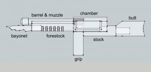

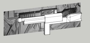

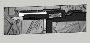

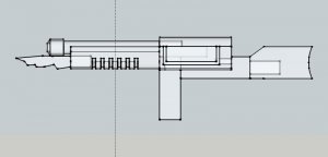

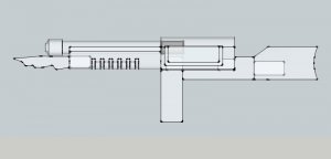

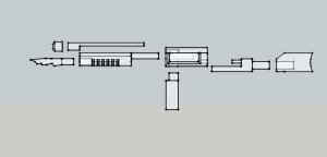

What the name says:
Total length: approximately 94 cm
Materials: Corrugated card, black card & transparent sheet
ETA: very soon (again, a very simple kit)
As you might remember from the Cylon Sword thread, this one has been on my list for quite some time. Since my flat is in a state of disorder (because someone pushed a button and nuked it by accident ;) ) I have taken a shot at the CG model. I hope to be able to conclude work on it tomorrow (yep, it is THAT simple). The only difficult parts are the plates which consist of kit-bashed model kit parts. And since I have some close-ups of these plates - you may have guessed it - I'll have to translate them to the last tiny bit. :sticktongue: :hammerhead: :smoker:
The model will be available at @BazookaJo 's site (I'd like to keep things together ;) ).
CU soon! :)
RF
The original prop was a very crude construction. They took a clear plastic tube and TAPED (!) it to a vac-formed body. The black tape used created the impression that the tube was running through another larger tube with some cutouts. The only "real" cutouts can be found at the bottom of the barrel. I'll try to mimick that look by wrapping black card around the barrel. That makes the build so easy. In theory it should work and I'm really looking forward to the test-build. :)

Re-creating these parts will involve heavy laminations.
