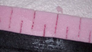

I've done it... using 1" pink insulation... but I used a band saw to make the incline cut... I used a drywall saw to make the saw cut on the sides... I made the width about 2 inches... you can sand the top after you put it down and that will take out all the irregularities....
here's a shot...

To make the curves, turn the riser on its side, and cut very thin wedges out of the side. They should go about 2/3 of the way through. With wedges cut only from one side, it will only bend one way, so turn it over if your curve goes the other way... ;)
You will end up with something that looks like the WS risers, but at a much lower cost.
