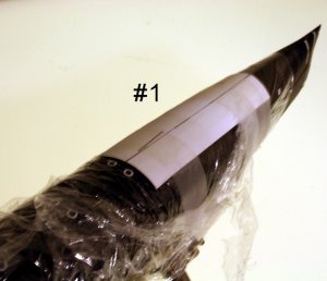

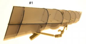

Photo #1 Eschewing the shot of the packaging and parts, I’ll start straight with the build. First, I have seen reported a number of problems with 1mm cardstock warping. The simple answer is to stop using the 1mm cardstock we routinely associate with paper modeling and switch to mechanical board, sometimes called “illustration board.” Go to dickblick.com and search for “LetraMax 2000 mechanical board.” It will cost about $7.00 plus shipping for a sheet 30” x 36” that will last many models. Save shipping and go to your local art supply house. The product does not warp. In fact, I have a supply that I have been carrying around the world since the middle 80’s that suffered a bit of water damage recently. The area not affected is perfectly fine; in fact, I used it for this project. It measures a tad over 1mm thick and can be delaminated. However, under regular use, it does not delaminate, fray or exhibit any of the undesirable qualities normally associated with cardstock. I assembled the bulkheads with Tacky Glue. Notice that the edges of the bulkheads are colored. You’ll learn why shortly.

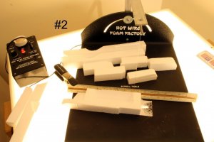

Photo #2 In a departure from normal building procedure and taking a cue from the RC guys, I am cutting sections of closed-cell Styrofoam to size to fit the spaces between the bulkheads. I use the foam in which computers are packed. It is light, dense, and very strong. I am using the “Hot Wire Foam Factory” kit which includes a number of useful accessories to cut the foam. The heated nichrome wire cuts through foam like, well, a hot knife through warm butter.
Precision is the watchword here. I want the foam to fit exactly. If I cut too small, I have to backfill the gaps (acrylic spackle); too large and I force the bulkheads out of square. Fortunately, the hot wire technique is so precise that I can shave off pieces that are a few thousandths of an inch thick if the need arises.

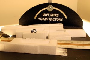

Photo #3 This close-up shows that I have ensured the wire is square with the table. Additionally, I use a draftsman ruler as a fence to ensure precise and constant cuts. Any straight-edge will do. You can make your own hot wire cutter with some wood, a motorcycle battery and 30AWG nichrome wire purchased over the Internet.

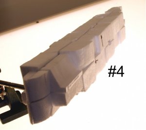

Photo #4 Using Elmer’s White glue (PVA glue) to adhere Styrofoam, this is what the hull looks like. It took a few hours to do this, working continuously, but you are going to see that this extra effort up front is going to pay off in spades later!

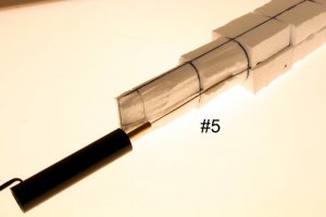

Photo #5 Using one of the accessories in the Hot Wire kit, I am roughly removing the excess Styrofoam using the bulkheads as a guide.

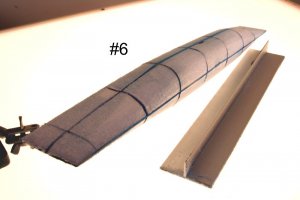

Photo #6 With an aluminum T-bar and 50 grit sandpaper, I roughed the Styrofoam down and finish sanded with 180 grit. This is where the colored bulkheads come in handy. The second I touch and edge, the color comes away indicating the limit of my sanding. Once complete, the hull is rigid.

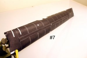

Photo #7 The reason for the Styrofoam is three-fold; first, it gives me a solid surface onto which I can glue the hull plates WITHOUT backing strips. Second, the foam undersurface prevents sagging of the paper between bulkheads. Real ships do show evidence of this but usually only after sea duty. Nevertheless, in the scales we build, that sagging is really over stated. Finally, having a solid hull allowed me to really muscle the paper into place minimizing any seams. I used some simple tools, mainly a wooden ruler, to make sure adjacent seams were perfectly flush with each other. The foam carried the load!
More importantly, the Hunley was flush riveted and quite smooth. I didn’t want to see bulkhead bulges and sagging plates.

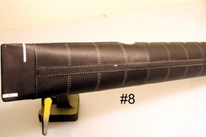

Photo #8 The proof is in the pudding. There are several seams here. Judge for yourself. This technique actually saved time and effort. I completely covered the hull in about 5 hours, taking my time and carefully aligning hull plates.

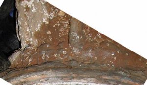

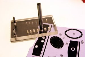

I am working on all the various subassemblies. In this photo, I am using the Reheat Models Precision Punch and Die set to punch out the viewports on the fore and aft hatches. Mike Crisafullis' site indicates that Renova got the viewport placement for the captain's hatch right on money. My intent is to allow light to bleed through the viewports for that extra touch of realism.
The subsequent photo comes courtesy of Mike and clearly shows the raised rivet detail on the coaming flange. Notice the thickness of the flange? Renova got this wrong. The two flanges need to be thicker than the supplied printed parts. No worry, I'll just do a bit of laminating to get it right. I'll shoot a photo and show you how I did this.

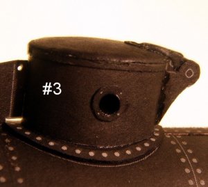

1. In this next installment, I am preparing to construct and add the two hatches. Because the real coaming flange is a thick object, notwithstanding the concretization that has yet to be removed, the Renova part is too thin. In order to prevent any cupping or creasing of the part I laminated it to a new part that I formed by laminating two pieces of card together on top of the completed hull form. Notice that I stretched Saran Wrap around the hull to prevent any damage to the hull. Notice also the registration line that allows me to align the printed part to my laminated part. Once I glued the Renova part to the preformed part, I simply glued the whole shebang into place.

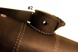

2. The next photo shows a close-up of the coaming flange with the hatch and conning tower in place along with the other fitments. Notice the light coming through the view ports. I glued the flange to the hull first, then added the conning tower after ensuring all mating edges were flush. Renova included one bulkhead at the top to shape the tower. I added another at the bottom, which made for a rigid part, easily aligned and mated to the flange.
3. The next shot is an extreme close-up showing the compound curves of the hatch cover. This is a scratch built piece that eliminates the use of the Renova part and, therefore, the appearance of any cutlines. I am working with cgutzmer to try to upload an mpeg video to demonstrate the basic process of rolling paper to achieve compound curves.

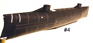

4. The final shot shows the hull with both hatches and the keel ballast installed.
Comments: All of the parts fit perfectly with only minor trimming needed. To fit the conning towers to the coaming flange required a swipe of sandpaper to ensure the surfaces mated perfectly. Secondly, I added cardboard reinforcement to the keel ballast even though Renova did not make any mention of doing so. Adding the card made the structure rigid which aided in attachment to the hull. It also gives me a solid base for subsequent mounting.
