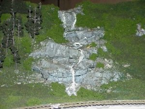

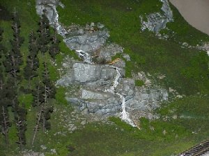

Here are some pictures of a waterfall that I did on my layout. I used Woodland Scenics Realistic Water and Water Effects.
First I shaped the area the way that I wanted. I painted the bottom using dark grays in center and lighter shades as I approached the shoreline. I then added rocks and talus. I colored the rocks and talus as necessary. Next I added some driftwood.
I then began pouring the Realistic Water into the ponds. I added it in layers about 1/8 inch deep. I let the layers dry as indicated on the instructions for at least 24 hours each. Once the water was at the depth I wanted, I then went over it with the Water Effects. Water Effects goes on white but dries clear after a few days and it has the consistency of toothpaste. I used an old brush to tease it into waves. I also molded it into the waterfalls themselves. About a month after I was done and everything had dried completely (Water Effects took a long time to dry) I dry brushed white Creamcoat over the areas where I wanted foam to appear.
Now the only thing left is to add water spray at the base of the falls and finish the trees and other foliage. The water spray will be made from teased cotton that is sprayed with scenic cement. I haven’t tried this part yet.

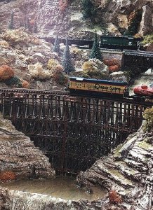

Hi Tom, here's a photo of my old N-scale railroad with a waterfall I created using glass fibre (Car stuff) and yacht varnish for the top coat.
Shamus

Shamus, that's an utterly stunning scene. I love it! It's one of those to be studied very closely. You still have much to teach the rest of us. Many thanks. :)
Second on that Brother Casey....I just moved George Sellios to the #2 postion and moved Shamus up to #1:D
Goes for me too. If me and another Nscale guy had to go down that ladder and he expressed some concern as to whether it was good or not. My reply would be "what are you talking about man, Shamus built it" :D
