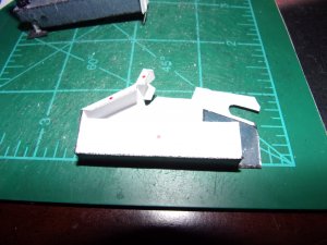

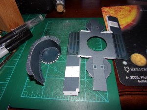

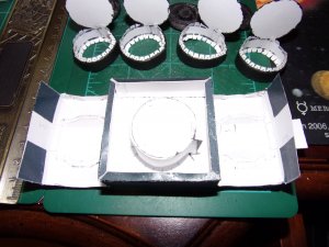

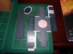

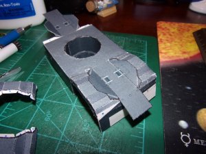

Chassis base with center turret holder.
The top edge gas the red squares on top while the bottom is mounted on top of the green squares. Note the black edge treatment done with marker to remove white glare.
Note the bottom of the turret

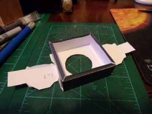

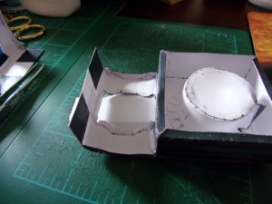

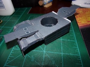

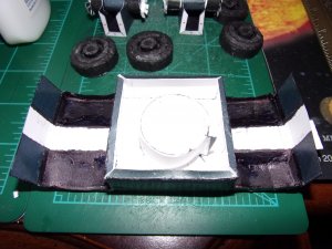

Main chassis
Note the raised front tabs that will receive the wheel wells.

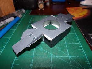

Wheel wells to the right and wheel axles to the left.

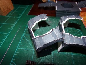

Closeup wheel well edging. note that the lower flaps are NOT glued to the body yet.
First wheel well attached. Note also that the turret is joined to the chassis in the center.

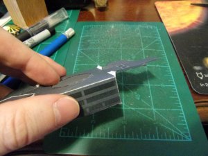

Bottom view. Flaps are folded and glued in place. In gluing the flaps a weight was placed on top of both of the flaps to maintain and form a straight flap otherwise they would buckle.
The other wheel well before joining with the chassis.
Center chassis tabs joined to wheel well.

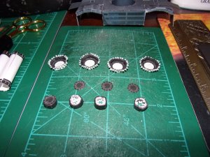

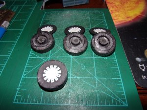

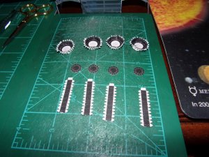

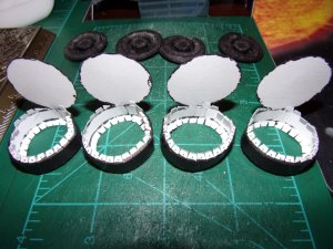

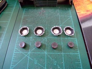

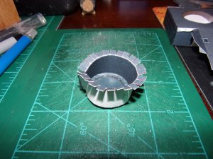

Hey everyone. It been a while since there's been any posting regarding the model. Here are some pics showing the wheel construction, which was slightly more involved than most wheels for a lot of the models out there.
Wheels - outer inset hub - Note the edge coloration on the circular portions.
Wheels - outer inset hub - assembled
Wheels - outer inset hub - close up - backside tab folding. Make sure to apply pressure from the front and apply glue to the tabs and fold around then apply pressure on both sides.

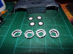

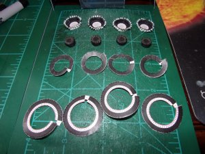

Wheels - outer inset hub - assembled - pieces of inner hub before assembling
Wheels - inner inset hub - lower portion of pic

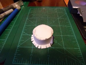

Wheels - inner hub assembled -before application to outer inset hub portion

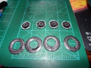

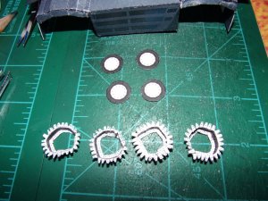

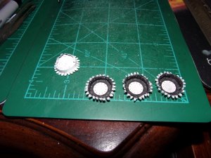

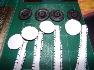

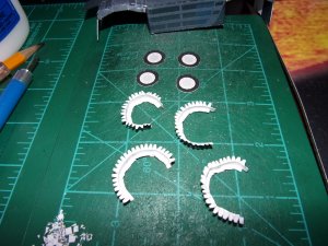

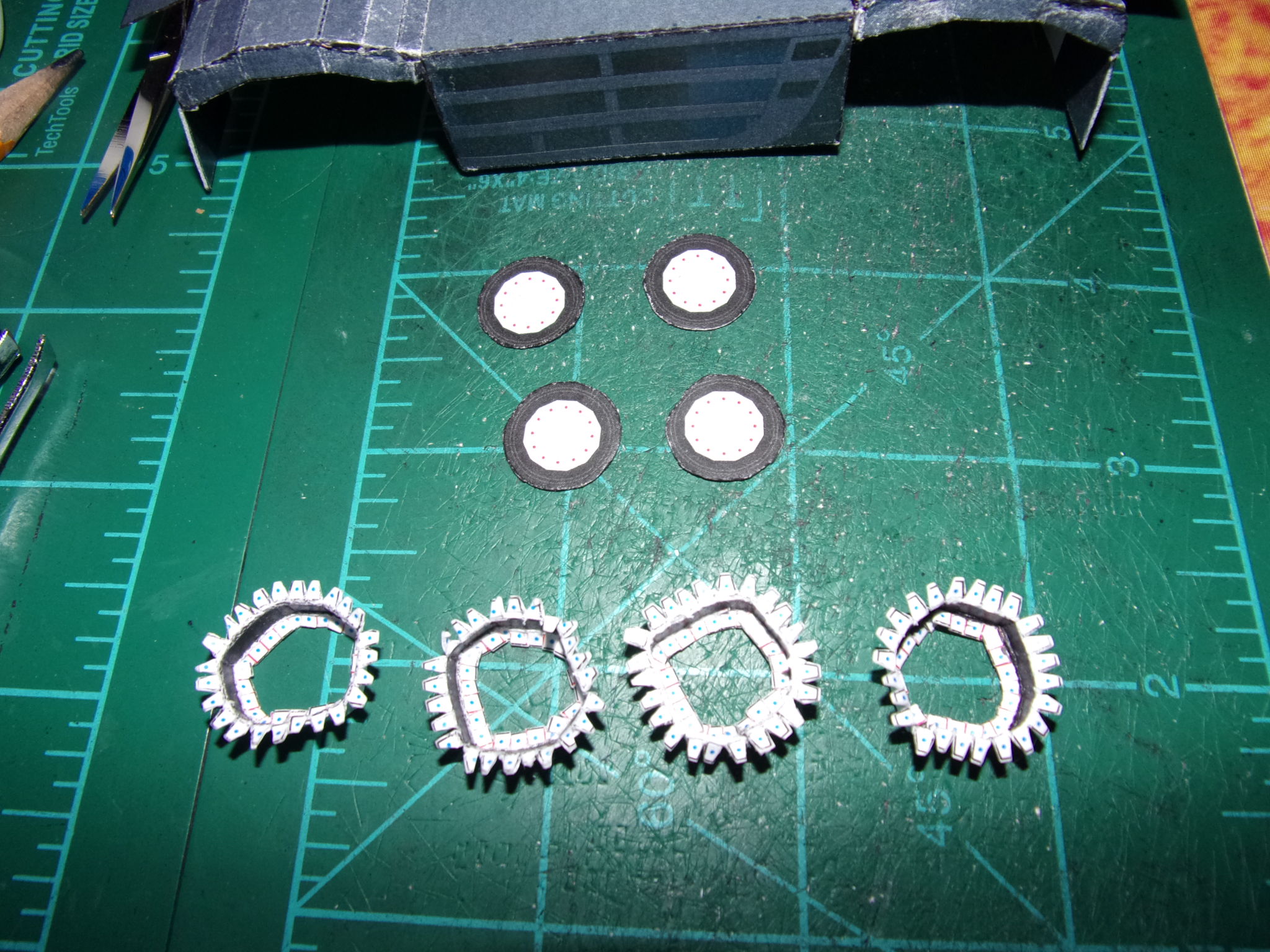

Wheels - outer edge - cut templates
Wheels - outer edge - colored edges
Wheels - inner and outer edges joined together. Inner hub assembled to outer insert hub

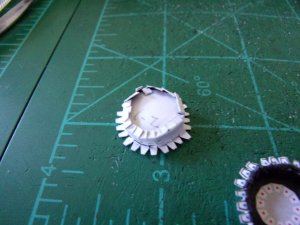

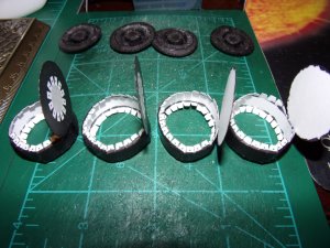

Wheels - front inner and outer edges joined to inner hub assemblies. Backing cut with edges cut. Joining the inner hub asseblies was a little tricky due to the inner circular portions having to be bent inwards while being connected to the inner hub assembly and trying to maintain the inner hub centered. Recommend in future builds to add the inner hub LAST to the wheel assembly.

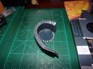

Back portion of wheel folded and glued together to for the tire tread.
Front view
Inner hub and tire tread and backing assemblies joined together. When gluing the back flap to close the wheel assembly try gluing the edges together in stages and NOT all at once due to lining up the tire treads with the edges of the circular back portion.

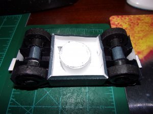

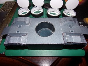

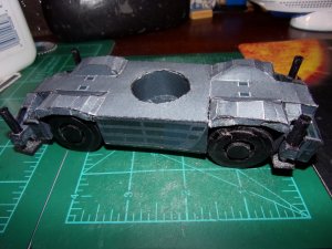

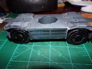

Chassis with wheels
Bottom of chassis - as can be seen everything is white with no coloration.

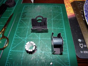

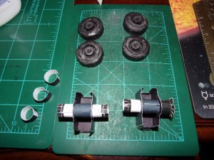

Axles for wheels - Note that the inside portion of the axle supports have been colored by a black marker.

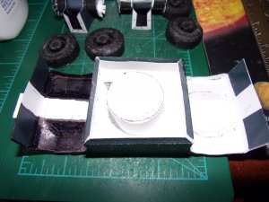

Axles - Note that the wheels have been glued and fully assembled. The axles have been inserted through the axle supports with the outer section extending through the support covered by rings (see right side with right support).
Chassis - The wheel wells are colored in to reduce glare. Also it permits location of the axle supports.
Chassis - all wheel wells colored in.

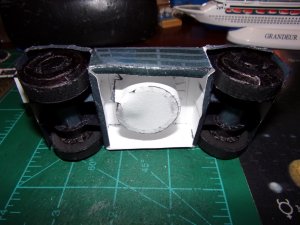

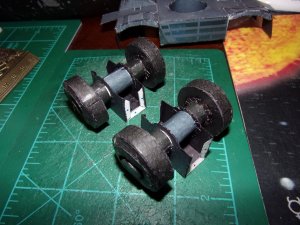

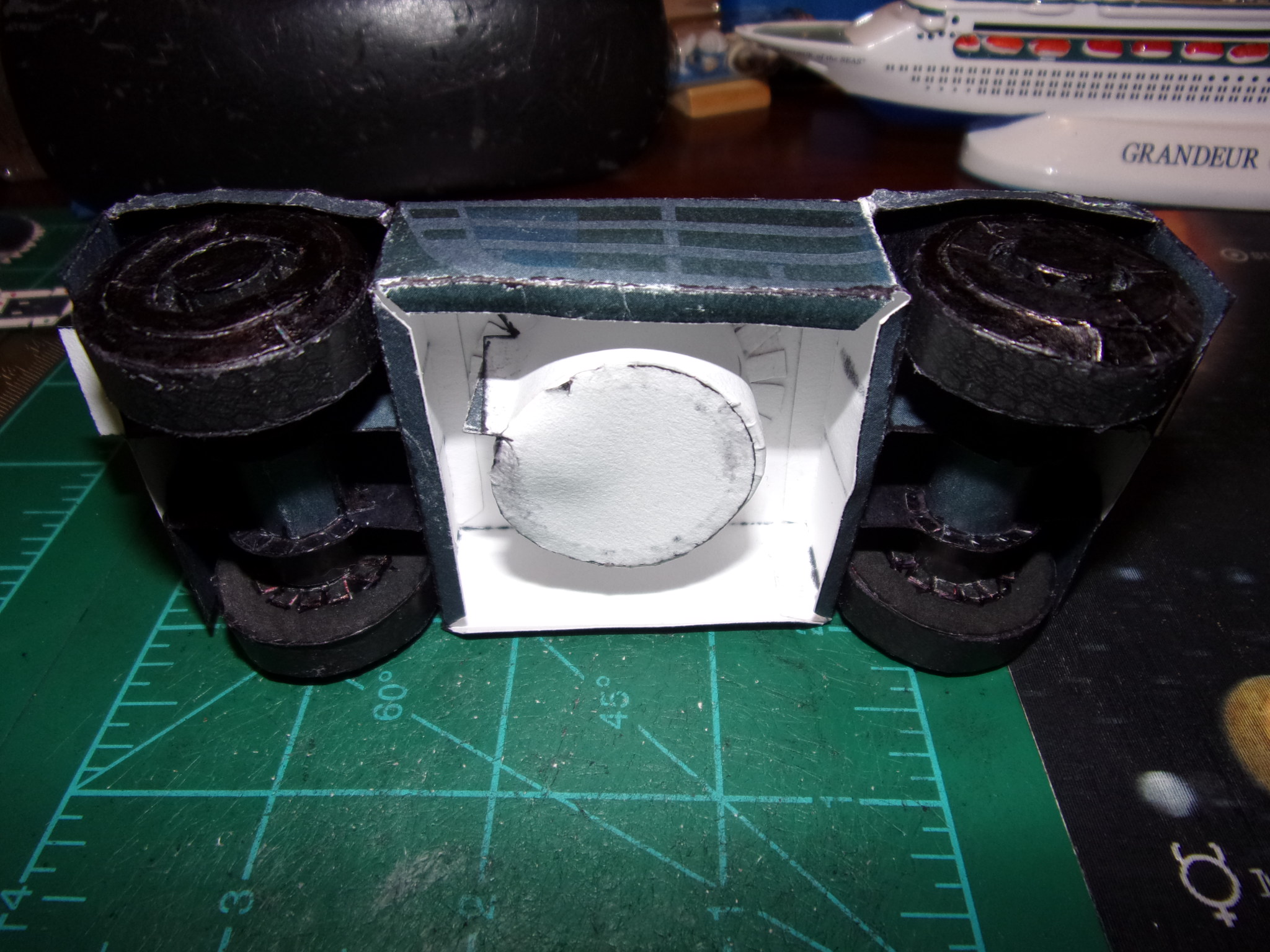

Wheel axles assembled. Wheels are joined to the axles with the rings positioned first about the axles, then the wheels are attached. While this looks easy to do, making sure that each wheel matches up with the same level on the opposite side while being centered can be difficult. What was done was that one wheel was attached and centered. The other wheel was attached on the other side while rotating the axle support so that both wheels can contact the surface. Move the second wheel until it is level and centered with the other wheel. Then let the glue dry while holding (it doesn't take long). Note the tire treads. When looking at the model with out the flash you can't see the tire treads. Additionally, you can't see the tire separation either.

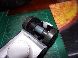

Wheel / Axle support assemblies joined to the underside of the chassis. You can color in the ends if you wish they were left white to see if the axle supports were properly lined up.
Chassis with wheel / axle assemblies. In assembling the wheels some of the sidewalls were accidentally manhandled and therefore gave a crushed in appearance with cracking of the sidewalls. The wheel hubs were then colored in by a black marker to eliminate some of the appearance of the crushed in areas.

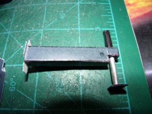

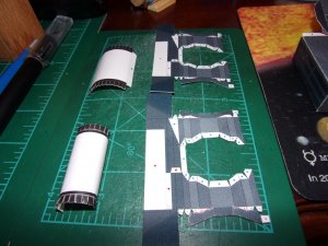

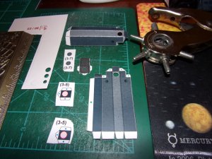

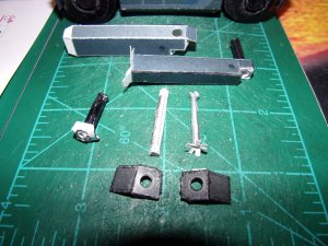

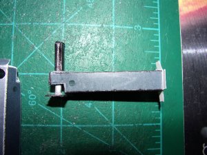

Side support struts
Template - holes cut out with a leather punch cutter. The paper on the side is used as a reference for the size of the holes and what punch to use.

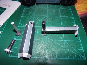

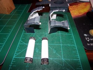

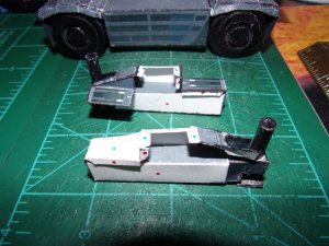

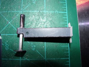

Outer strut assembly assembled. The black post section was originally gray then colored black with a marker. The bottom of the post has upturned edges that are glues inside of the forwardmost portion of the strut. The gray struts (hydraulic jacks) were rolled between fingers, then colored by a silver marker. The bottom rectangular portions on the bottom of the picture were punched out and slid onto the bottom of the gray struts to form a "hydraulic piston".

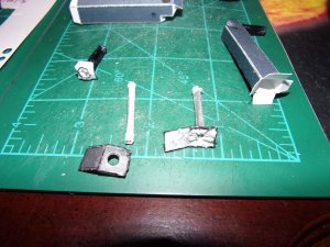

Hydraulic jack slid through the punched hole in the rectangular piece to form a foot.
Hydraulic jack assembled and assembled to form the moveable strut (yes the strut moves - it is NOT glued in place inside of the black post)
Hydraulic jack assembled - retracted

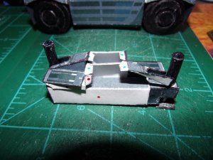

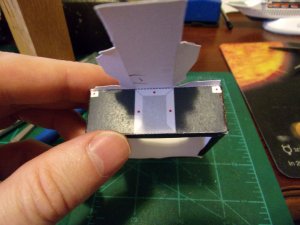

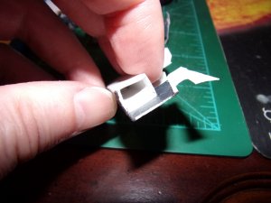

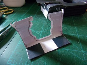

Strut receiver - note that the right hand side is folded back and glued in place and a "U" shape cut is made at one of the pieces on the right hand side.
Strut receiver - note the tabs are folded inside of the area that receives the support strut
Struts positioned inside of the strut receiver. Note that there are two receivers for left and right struts. The top strut receiver is joined to the bottom receiver. Note the "U" shape cut is there to receive the piston assembly of the hydraulic jack.
The top strut receiver is joined to the bottom receiver. Note the left side tab overlapping the right hand receiver.
Struts extended away from the stut receiver with the hydraulic jacks extended.

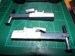

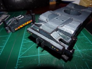

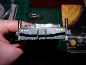

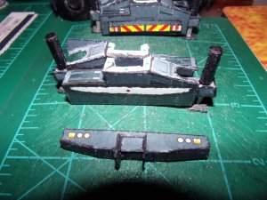

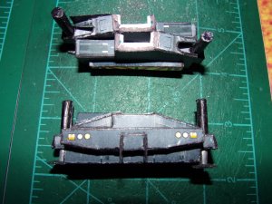

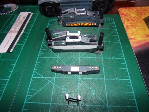

Two pairs of strut receivers joined together. All pieces are retracted. One has a rear bumper attached and the other has a fornt bumper to be attached.
Front bumper with additional piece attached the fold for this was pretty tricky to do and wasn't very obvious.
Front view of the front bumper attached. Top down view of the rear assembly. You can see how the top piston portions are received within the strut receivers.

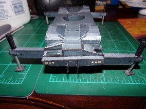

Strut assembly extended with hydraulic jacks extended (front view).
Strut assembly extended with hydraulic jacks extended (top view).

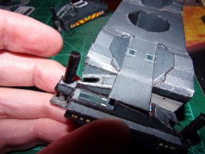

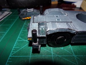

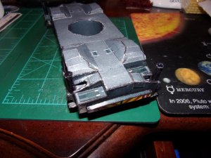

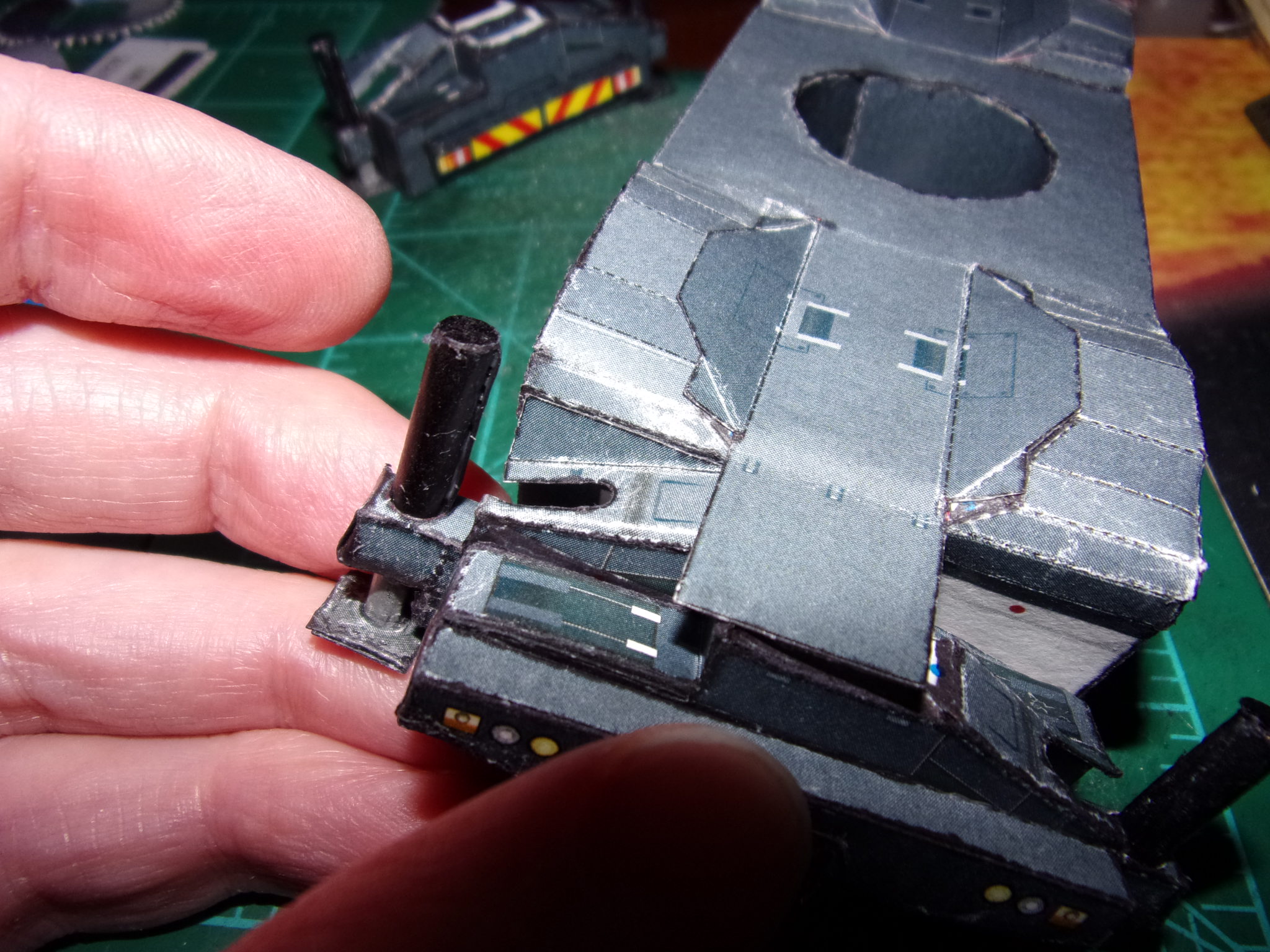

Attaching the strut assemblies to the main chassis.
Note the rear central tab extending from the front of the chassis. This is glued on top of both of the strut assemblies. Also the back of one of the assemblies is attached to the main chassis. Lining up these assemblies can be challenging.
Tab glued on top of both strut assemblies.
Tab glued on top of both strut assemblies. Side view
Front view of strut assembly joined to the front of the chasis
Rear view of chassis with second strut assembly attached.

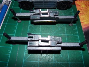

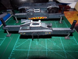

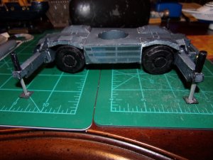

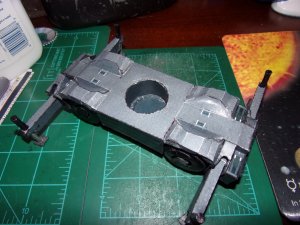

Both strut assemblies attached to the chassis. Side view.
Top view - Both strut assembles extended with jacks lowered.
Front view - Both strut assembles extended with jacks lowered.
Side view - Both strut assembles extended with jacks lowered. The jacks can lift the vehicle up and there's enough friction with the jacks to suspend the tires off of the surface.
