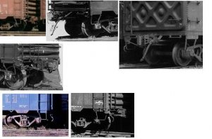

based on my memories of 50 years ago (!), I think that most of the cut levers went above the coupling. Some went under; a lot of the diesels went under with handles on both sides. I found a picture of a freight car mounted under.
The handle came out to the side -- the corner with the ladders or left as you look at it. The end ladder only came down to the floor level, no step under it, so the lever was clear.
I still don't understand how the bottom mounted levers work.

Nice close-up detailed shot Brian. At least the relevant parts are clearly visible.
