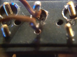

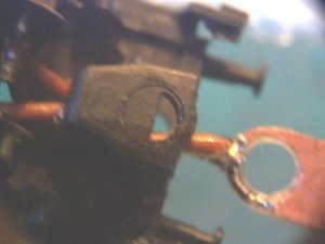

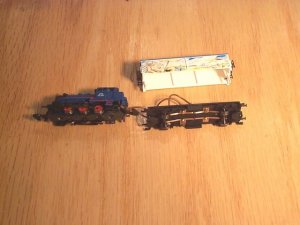

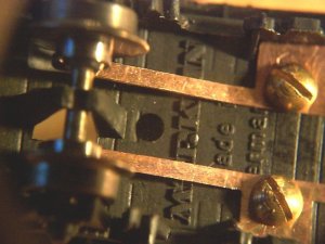

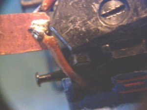

Here are some photos showing the basic technique. One of the things that really helped was the truckless wagon wheels - since they don't swivel it was easy to add wiping contacts to the wheels. The wipers were designed for the Micro-Trains Z scale F-7 to prevent similar stalling, but they just happened to fit nicely into the wagon. They look ugly, but can't be seen in normal operation when the wagon is viewed from the top or side.
here's the underside

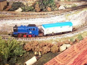

The finished train. Next time I will use black wire, you can see a little bit of brown where it comes out the bottom rear of the locomotive. Also should have narrowed the drawbar in the middle so I can glue down a scanned and printed image of a mated coupler pair so it looks a bit more prototypically proper. Live and learn.
