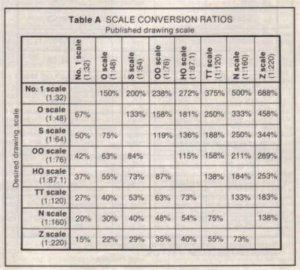

is this what you want?
Thanks Jim but that looks like greek to me. I don't understand how percentages get mixed in. I thought it was like 1:1- 1:87 meaning 87 times "X" smaller than 1. Forgive me that my math skills are horrible. It's something I just never could grasp.

You can use the table above with a calculator. Measure the whatever. Put the measurement into a calculator times the percent then push the % key. Result should be the dimension for your scale. Example: going from O to HO: 12" times 55 % = 6.6".

Jim's table is showing the conversions from one scale to another. That's the reason for the percentages. Why do you need a "calculator"? Simply do as you are suggesting and divide the actual dimesion by the scale. I have scale rulers that help for smaller dimensions, but calculate the others as I need to.
