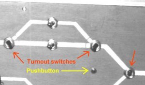

Daniel, I also used a capacitor discharge unit (CDU), and here is how I did it:
On the panel I mounted cheap single pole, double throw switches (SPDT) at the turnouts of the track diagram (orange arrows). I wired them so, that the toggle lever indicates the direction of the train will run through the turnout. This way I wired several turnouts together. The trick is that the power line from the CDU first goes to a momentary pushbutton contact on the panel (yellow arrows) and from there to the individual track switches on the panel. This way you can preselect a route and then, with one push on the button, a whole group of turnouts is thrown accordingly.

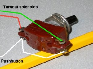

Two additions:
The first pic shows the type of SPDT switch I used and how to wire it. These are cheap switches, rated for 230 Volt (household current here in Europa).

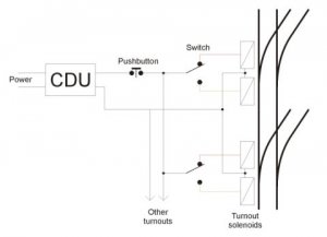

And the second picture shows the wiring diagram of the whole setup.
It is a cheap solution which has the advantage that you always see the selected route through a turnout ladder without additional feedback wiring from the turnouts.
