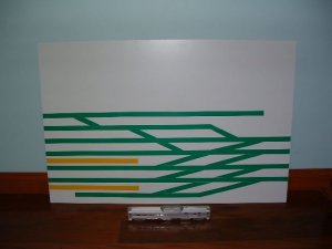

I had an attempt last night at making up a control panel. It ended up about twice the size I thought it would be. :eek:
I made it from a sheet of prepainted masonite, and used insulation tape to represent the tracks. I hope it don't shrink or come off!! I'll probalby seal it with lacquer of varnish or something.
It's only one half of it, and will be mounted on the front of the layout at about a 45 degree angle. The green represents the tracks, and the yellow represents the station platforms. The mainlines (the central 4 "thru" tracks are up/down/up/down lines (top to bottom) (top track runs west to east/left to right). The crossover tracks are not double slips, just plain crossovers.
Are crossovers represented in a track diagram such as this, in any special way? i.e. to NOT show them as, say, a double slip?
It's a bit big, but I think I'll need it that big by the time block and turnout switches go on it, (and those elusive LED circuits!!) and other switches etc for sturcture lighting etc go on the empty bit at the top.
That's a HO Budd Railcar at the bottom to show the size. Is it tooooooooo big? Its the control panel for only one half of the main section of Garahbara Mk II that covers 3.6 metres.

Hi woodie,
With crossings (crossovers are two points facing each other on dual track lines that allow trains to get from one track to the other but not in all four possible ways, only two) it is usual to represent them as an X. Doulbe slips have an X with a ^ and an upside-down ^ drawn just above and below the X to represent the fact that trains can change tracks. In a single slip the ^ is only put on the side that has the slip.

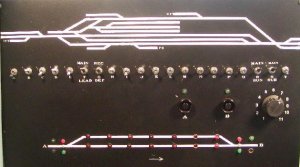

Woodie, Only you can decide if it's too big, but if you'd like it smaller, you may be able to do as I did. I gave up having the switch/toggles on the track diagram. Instead, I used dry transfers (not visable in the photo for some reason) on each turnout on the diagram and arrainged my toggles in a row beneath, with corresponding letters. I used toggles as these turnouts all use slow motion motors. I didn't need to worry about leds for showing which way the turnout is thrown since the toggle handle shows it. When up, the turnout is sraight, when down the turnout is diverging. In operation, one simply follows the desired route and throws toggles to suite. I used 1/8" wide lines, seperated by 1/8". Except on the bottom where two lines represent hidden staging. They are 1/2" apart to allow room for the Acme pushbuttons I used for these two turnouts, which have twin coil machines. The panel is 11"x18". The leds along the two lines are driven by photo cells between the rails and are occupancy detectors. The rotary switch and two pushbuttons next to it are for electromagnetic uncouplers. A thought about your dilema concerning visual display of turnout status: Use toggle switches much as I did, but have a momentary pushbutton to connect the power source. You could throw all toggles required and push the button to throw all turnouts. And the toggle handles will show which way the turnouts are thrown. Of course all the turnouts will receive power, but that should be ok. You'll need ample power, like I mentioned before. And the pushbutton will have to be heavy duty. Maybe someone else can elaborate on this, it's just off the top of my head.
Gary

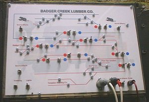

I use two pieces of Perspex the right size for my panel. Next thing I did was to draw out the plan on a computer programme to A4 size. When finished I printed one copy on plain paper and another on Photo paper at top quality to use as the finished product.
Here's the finished panel
Shamus

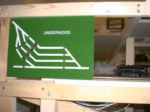

This is the control panel for my underground storage yard, appropriately called 'Underwood'. :D
I sprayed my panel (hardboard) white. After the paint had dried thoroughly, I laid out the track lines with plastic strips which are used for pinstriping automobiles. (The color doesn't matter.)
Then I sprayed the panel green and carefully pulled away the masking strips. The lettering is done with white Letraset letters.
The small buttons control the turnouts: Pushing a button aligns all the turnouts from the yard throats (top left and bottom right) to the respective yard track. The PECO double coil turnout motors are powered by a CDU.
And the toggle switches simply kill the power to the yard tracks.
So far I didn't install indicator LEDs for turnout position or track occupancy.
Ron
Ron
Ahhhh.... I like that idea. :thumb: :thumb: Then I don't have to worry about the tape peeling off or shrinking or whatever, or twisting up around the drill when I drill the holes. :thumb:

Before using the plastic strips on the panel I pressed them to a glass sheet and pulled them away again. This makes them a bit less tacky, so they won't pull away the lower paint layer.
Ron
