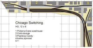

that’s funny. I was inspired to build my layout by exactly the site about North Chicago switching you mentioned in your post., especially by the pics of the Lakewood branch and Goose Island. I finished laying track and wiring and I am starting to build the scenery and the first structures now. Here is the trackplan of my layout.

Love the track plan. Looks like it has some great possibilities. By the way, I plan to use the CNW MP15DC put out by Atlas to switch my layout. (Or at least one of the locomotives).

I am modelling an earlier era, my locomotives will be CNW RS3, SW 1200 and GP 9. It took quite a while to develop this track plan. I hope it turns out to be nicely balanced between scenery and opeartion. Time will tell.
