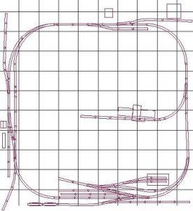

Comments and suggestions on this plan
VunderBob
Mar 11, 2005
44
65
The enclosed plan is more of a doodle than a serious effort. Unfortunately, all I have to work with is Atlas RTS. Also, even though you see the sectional track in use, I'm an old hand, and I sure don't intend to build it that way.
The plan is the best rendition I could do of Iain Rice's East Suffolk short line, stretched to 10 X 10, with a continuous run connection added. As I worked with RTS, it struck me that Iain might be a little optimistic with his switch dimensions because he's using drafting equipment and freehand techniques, and RTS would be a worst case because you can't really trim switches on paper like you would in real life. Even so, I did manage to cobble together a couple of pseudo-Shinohara 24-20 curved switches when I needed them.
The railroad is supposed to be a weed choked shortline, with bad track. Minimum mainline radius is 24", with 20" and 18" found on various spurs. No grades. The interchange is a dropleaf so you can use the door.
Anticipated benchwork is lightweight, free-standing, and designed to be semi-portable.
I'm not real happy with the plan, because if I put in all the industry that Iain had, it's too busy, and the trackwork can't be done without some real contortions, but with what I have, there's not enough to support the business.
If anyone can offer some friendly criticisms and comments, I'll be grateful.

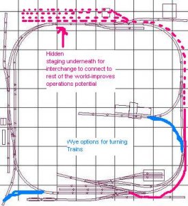

Tileguy said:
Just a couple ideas here to kick around
Tileguy, where you have the second wye penciled in on the lower left, the stub end track with the two rerailers shown is a drop-leaf interchange, and the curve immediately above is a liftout continuous run.
My concept is to 0-5-0 interchange cars onto/off the layout. I don't think I have the room for a staging yard underneath; the 10X10 dimension is dictated by the 10X11'5" bedroom this is destined for.
What is that industry on the spur that extends into the middle of the room? When I saw that track I thought, "car float!". A barge with a couple of tracks could supply your road with cars from "off layout". Some could be set out at your local industries and others placed on the interchange track and vice versa. Just a thought. :)

That penninsula appears as if it could be made up to 26-30" in width and a stub end yard along with that (grain elevator??).The Wye in that area would help operate a stub yard without having to resort to the ol 0-5-0 which is always hard on equipment and preferably avoided if at all possible.
The Wye will also give you the ability to run east and westbound trains out of a centrally located Stub yard.
Now, if you could add a couple hidden staging tracks(perhaps behind a backdrop or scenick block on the right wall.This would give you 1 eastbound and 1 westbound offline interchange trains that will help connect you to the rest of the world.
Remember to designate one spur in the stub yard for interchange and you can operate 1 or 2 differant roads into and around your layout.
Another option would be to just have one interchange train and a passenger express come out of staging to make a loop and add a great looking priority train to the mix.
Again, just my ramblings for you to kick around.
Ooh i just got excited about that express rolling through town :D

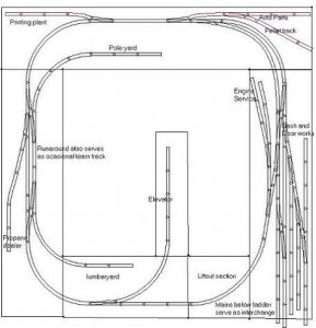

Another doodle. If you detect the influences of Dave Barrow, you're right. This is a CM&SF variant in the 2K4 MRP, squashed from 12X12 to 10X10, and with a continuous run connection added. Same theme as before...
I like this one better than the OP. I knocked it out in about 45 minutes (2 hours for the other one), and without any of the contorted trackwork. I could also add more industry without overcrowding. Larger yard for sorting, and more interchange capacity, too.
The one bad point is that the stub end of the yard blocks the doorway, so I'll have to come up with some kind of way to clear the door. I won't be able to take it off the hinges because I need it to keep the cats out of the room.
Whadaya think about this one?

David has a knack for building things that he has access to on all sides. building that yard on the backside with a 3o" reach makes it tough to switch.Keeping a yard accesable from all sides for a big one is really nice.Having it towards the front of the layout is only practical.reaching over scenery ,buildings etc to constantly hit switches is nerve racking ;)
Also, we really need to find a way to turn a train around and a wye is a natural off of that penninsula.Want to get David Barrow involved with your plan??? Join the LDsig at yahoo and the RRINDOPsig at yahoo.Davaid spends quite a bit of time in both along with another few names you may recognize like Bill Jewett,Linda Sand,Andy Sperandeo etc etc

Tile, FWIW, all of the benchwork shown is 24" wide. I have short arms and a lateral displacement problem (AKA beergut), so I'm painfully aware of reach limits. All turnouts are within reach, even if barely. Granny grabbers will do the job for the corner spurs if something derails out of reach.
I have another doodle of the Barrowish plan, and there's room for a runaround using curved turnouts at the bottom where the elevator spur comes in. It's not very long, but it will get my engines on the other end of the cut.
