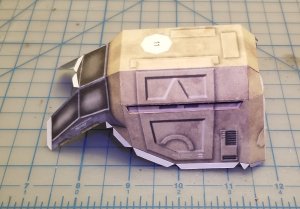

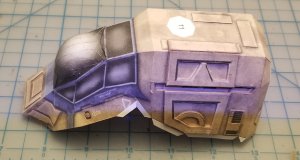

So, starting with the cabin section.

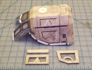

Here are the door panels.
The door panels are attached.
Here is the top part of the nose.
The top part of the nose is attached. I have also raised all of the body panels as well.

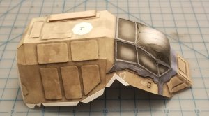

I raised the panels on the nose as well as augmented the "rescue" knob.

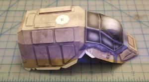

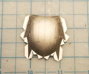

Here is front windscreen canopy.
The front windscreen canopy is attached.
I raised the frame work around the canopy
Please stay tuned to your local Colonial Broadcast Network for further updates as they come in.

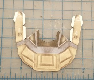

Continuing on with the underside of the hull. Here are front armoured sections of the "wings".
I raised the armour plates and the little rectangle parts that are under the plates.

I really like this model but the Glass section front does it a dishonor. You may get away with a glass effect buy making a second glass piece, cutting it out, and stretching "Cling Wrap" over it, to give it a sheen. You could probably glues it over the existing cardboard glass, or cut it out of the model when it's finiished, and leave a glue tab on the model's periphery to glue the faux glass piece in. It's coming out great!!:)
I have thought about getting some gloss black paint and going over it later.
Then again I have never really liked the "doomed" windscreen. It really makes no sense to have it that way. It should have been flat.
I have the moebius plastic kit that I will eventually build. It has a full cockpit interior that I am going to use as guide to design a cockpit interior as an add-on kit for this one.
If you coat that Moebius glass with Vaseline, and stick in in bos of Plaster of Paris, you could easily pull it out without damaging it, after it dries, and use it to make a reverse plug, the same way, you coat the imprint with Vaseline, pour in Plaster of Paris, Put a stick with a nail across it, so you can pull it out, and you could pull a plastic softened sheet of plastic over the plug. You could do the same thing with 2 part Epoxy, making sure you have a thick smooth layer of Vaseline (as a release agent) to protect the original glass, them make a plug, again using Vaseline, this method gives you a much stronger plug. . ;)
