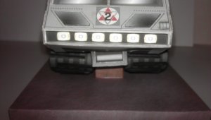

Colonial Landram from Battlestar Galactica
Raven......look....
That was my fault. I made a mistake when I made the Landram. I did not catch it until well after it was finished.
I am planning on rebuilding it (eventually). I am wanting to make a track system that is more realistic (as well as a few other changes).

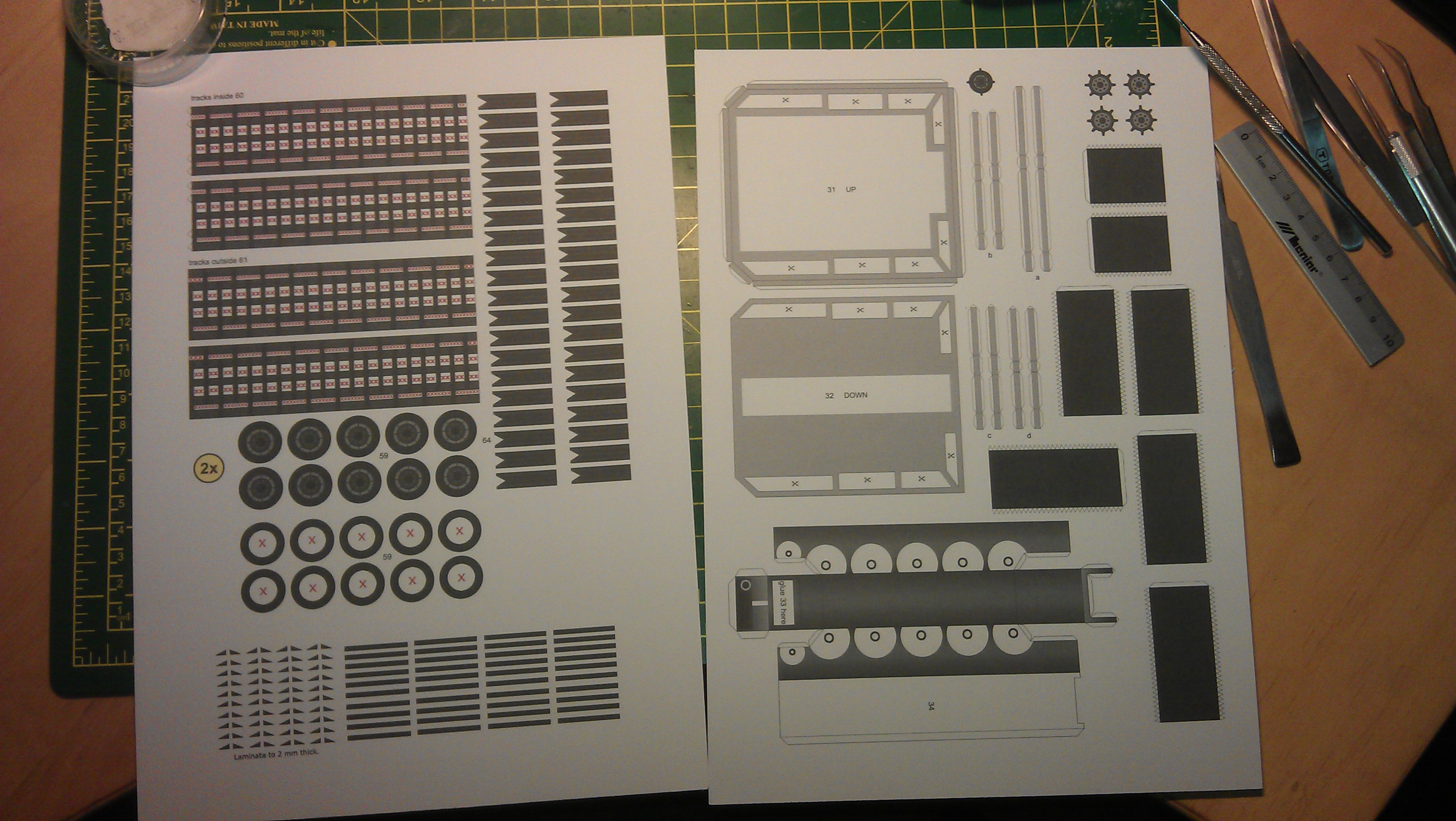

Here is the parts sheets.

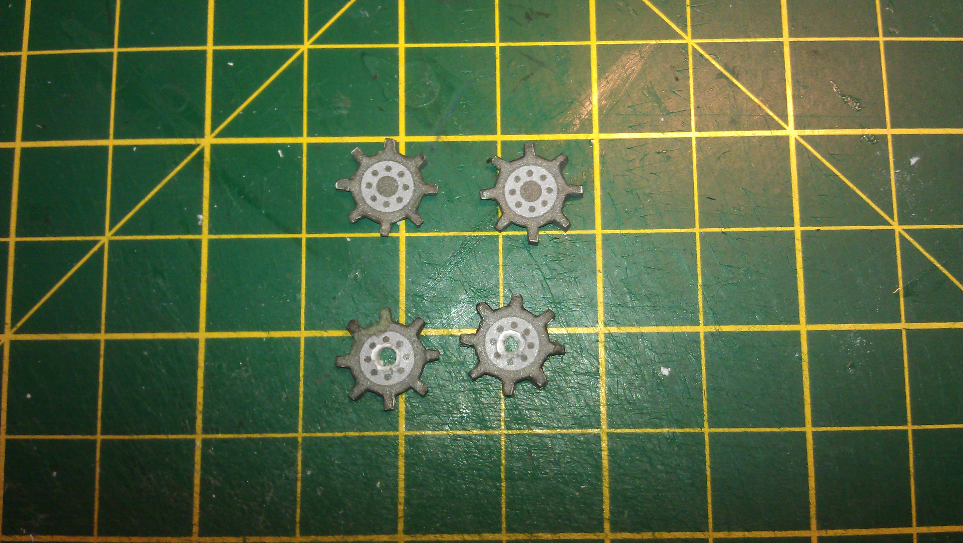

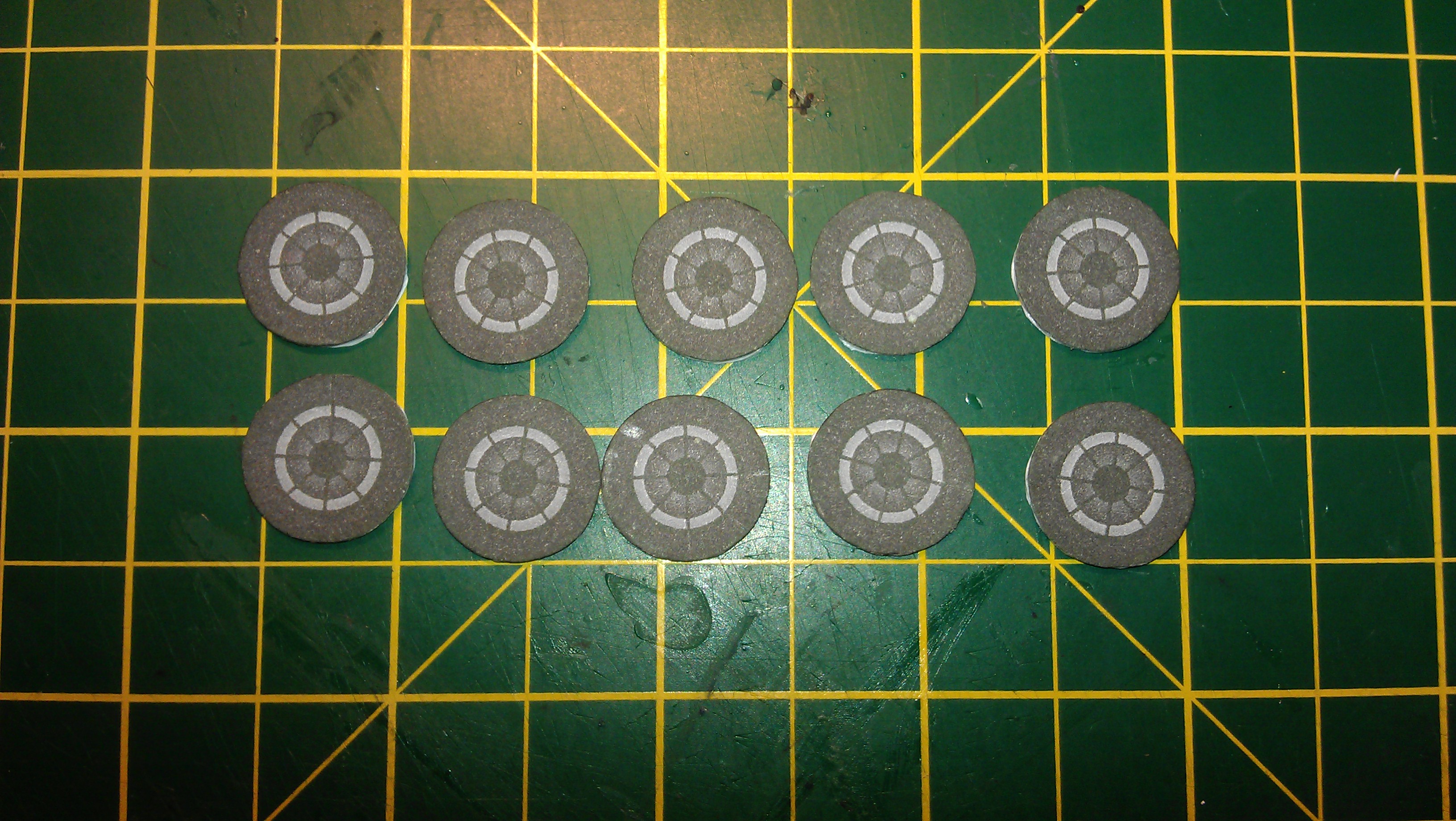

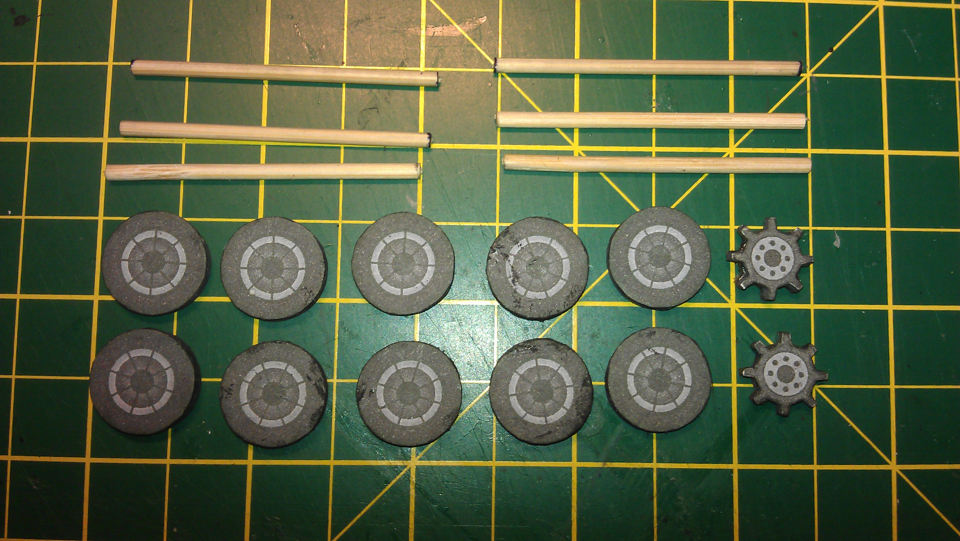

I started with the wheel first (starting with the drive wheel).

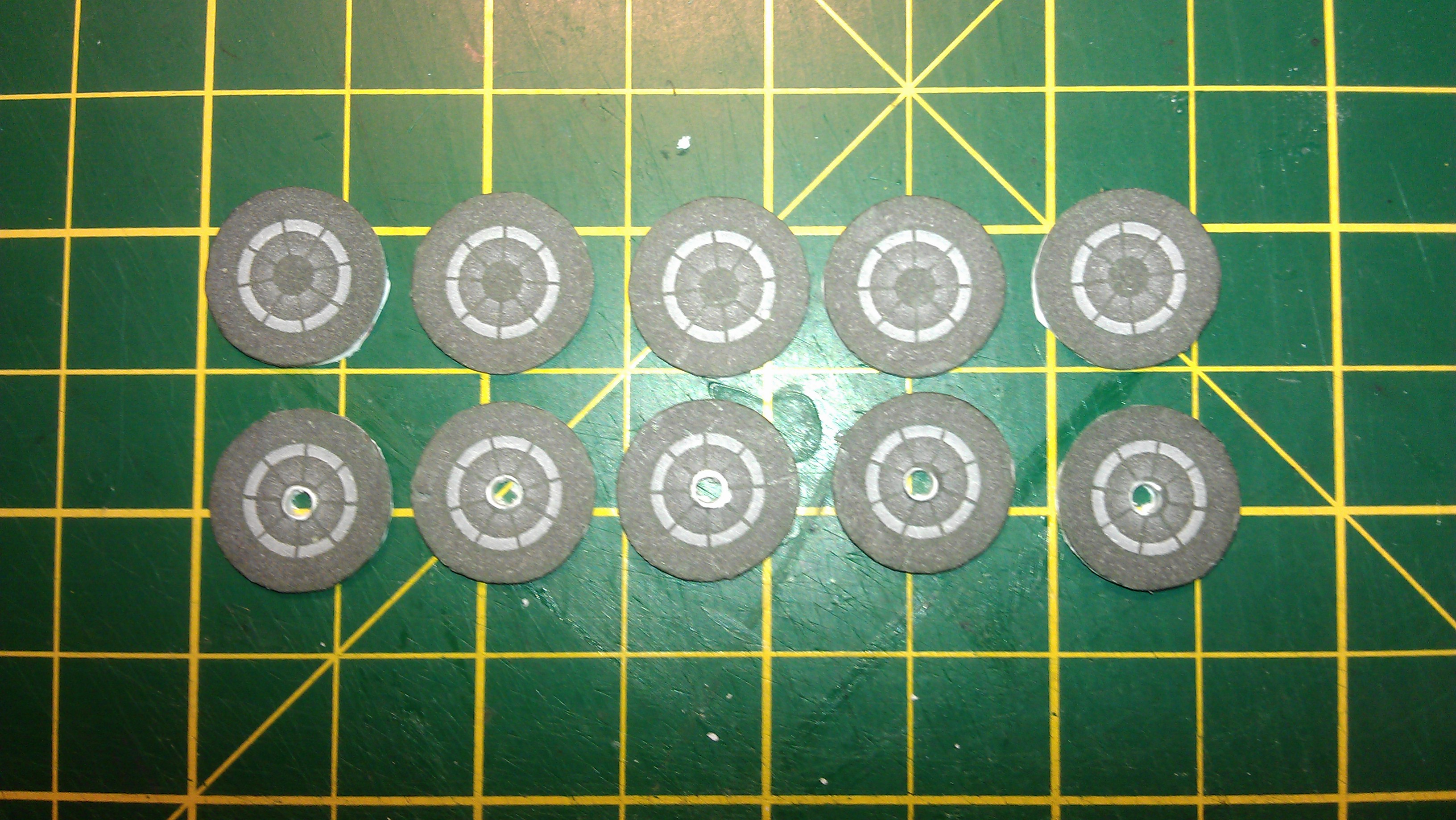

I laminated both the front and back faces to 1.5 mm.
I drilled a hole in the back parts (the same diameter as a bamboo skewer (about 2.mm).
Both halves are glued together. The hole will help hold the axle in place.
I have done the same with the main guide wheels.
All of the wheels are finished. I have also cut pieces of bamboo skewers to a length of 5 cm.

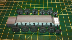

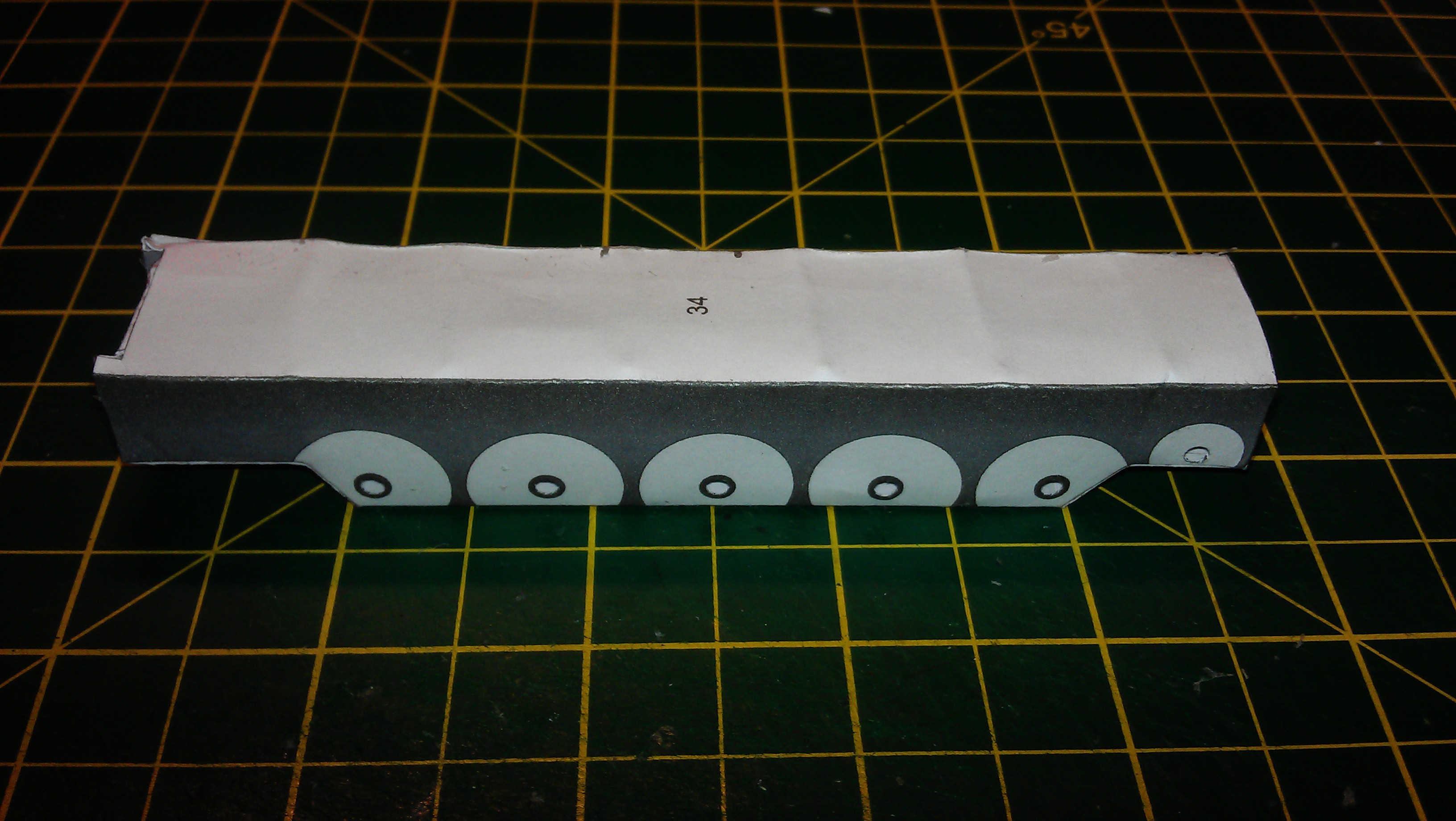

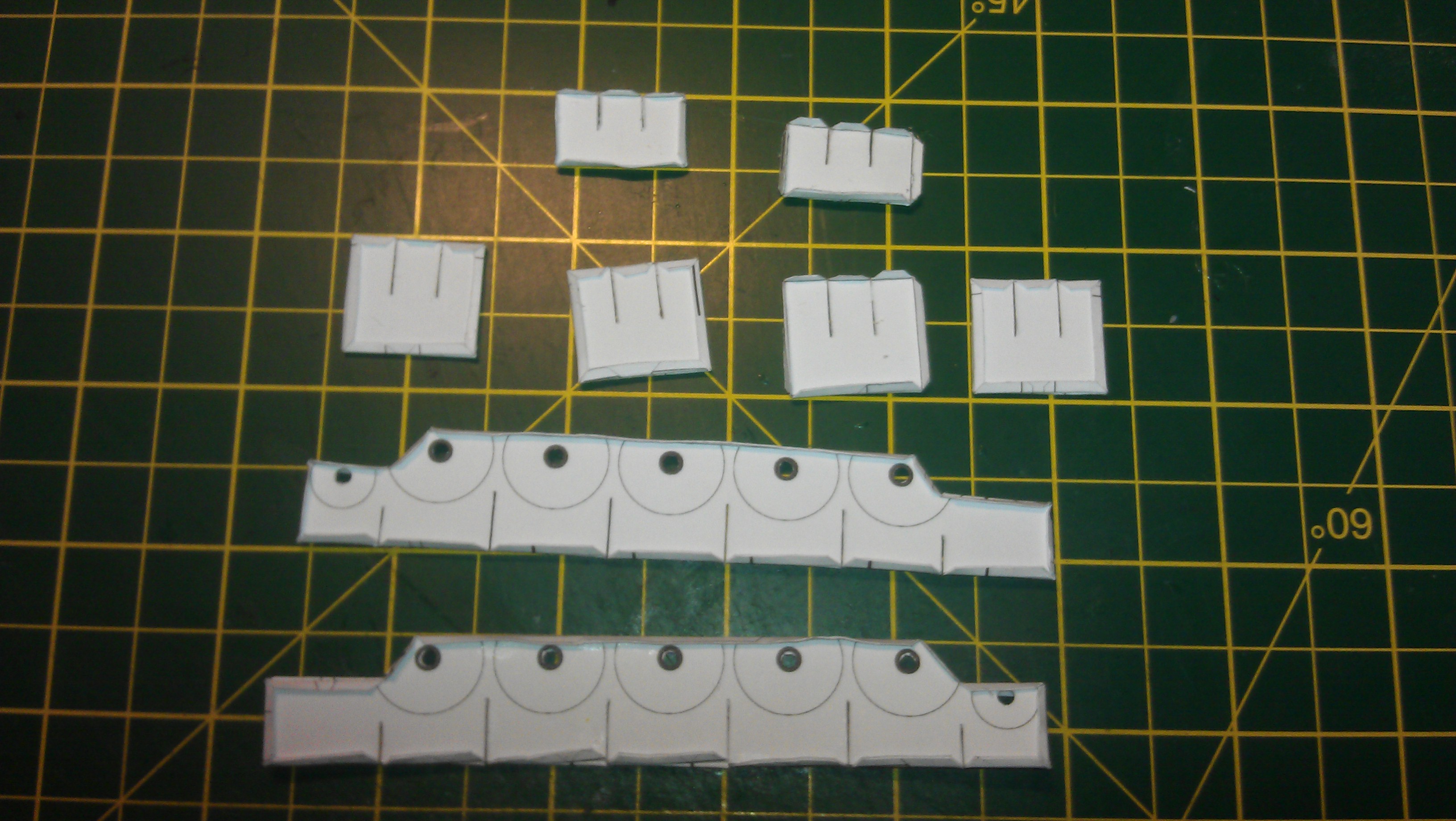

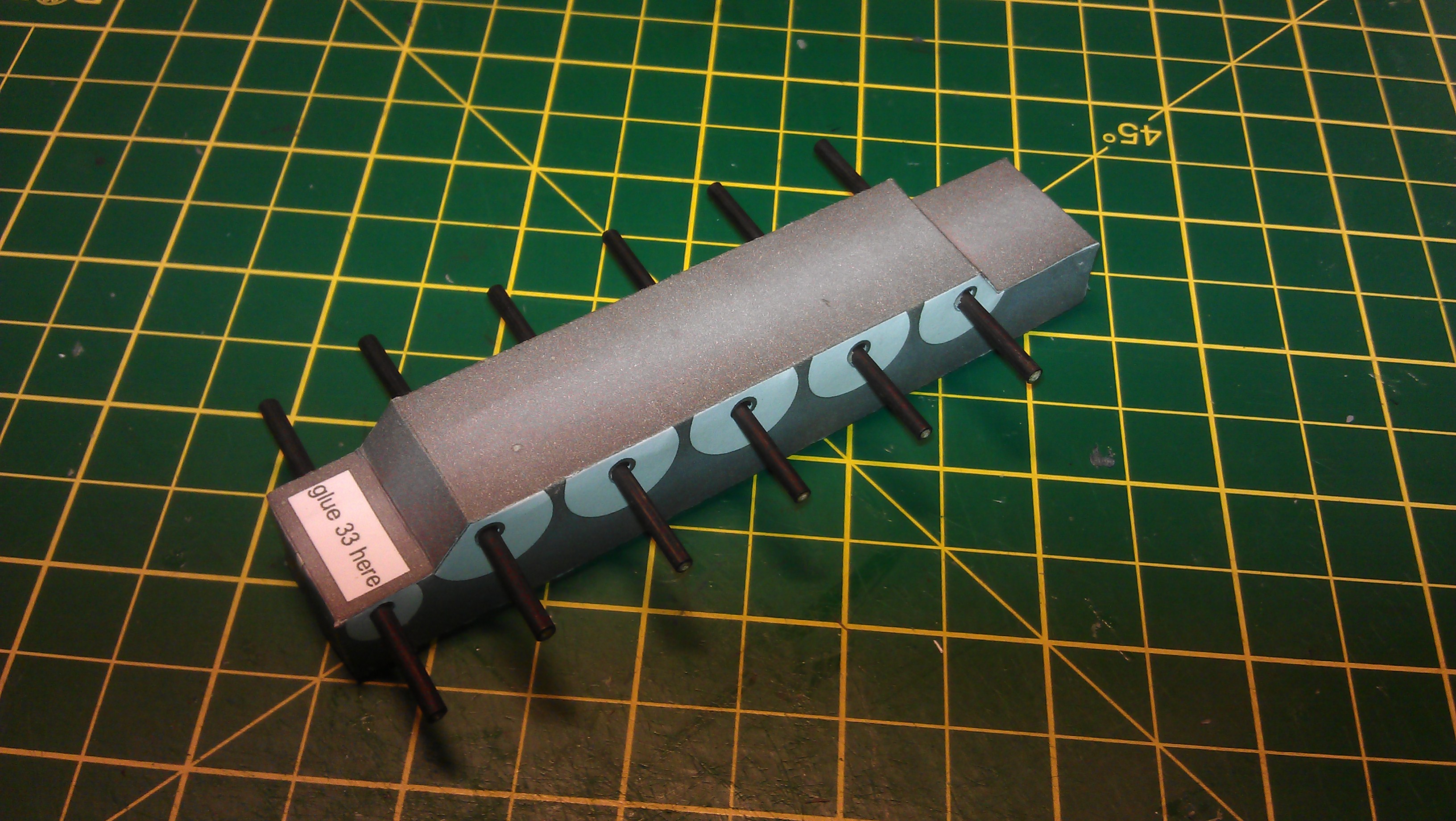

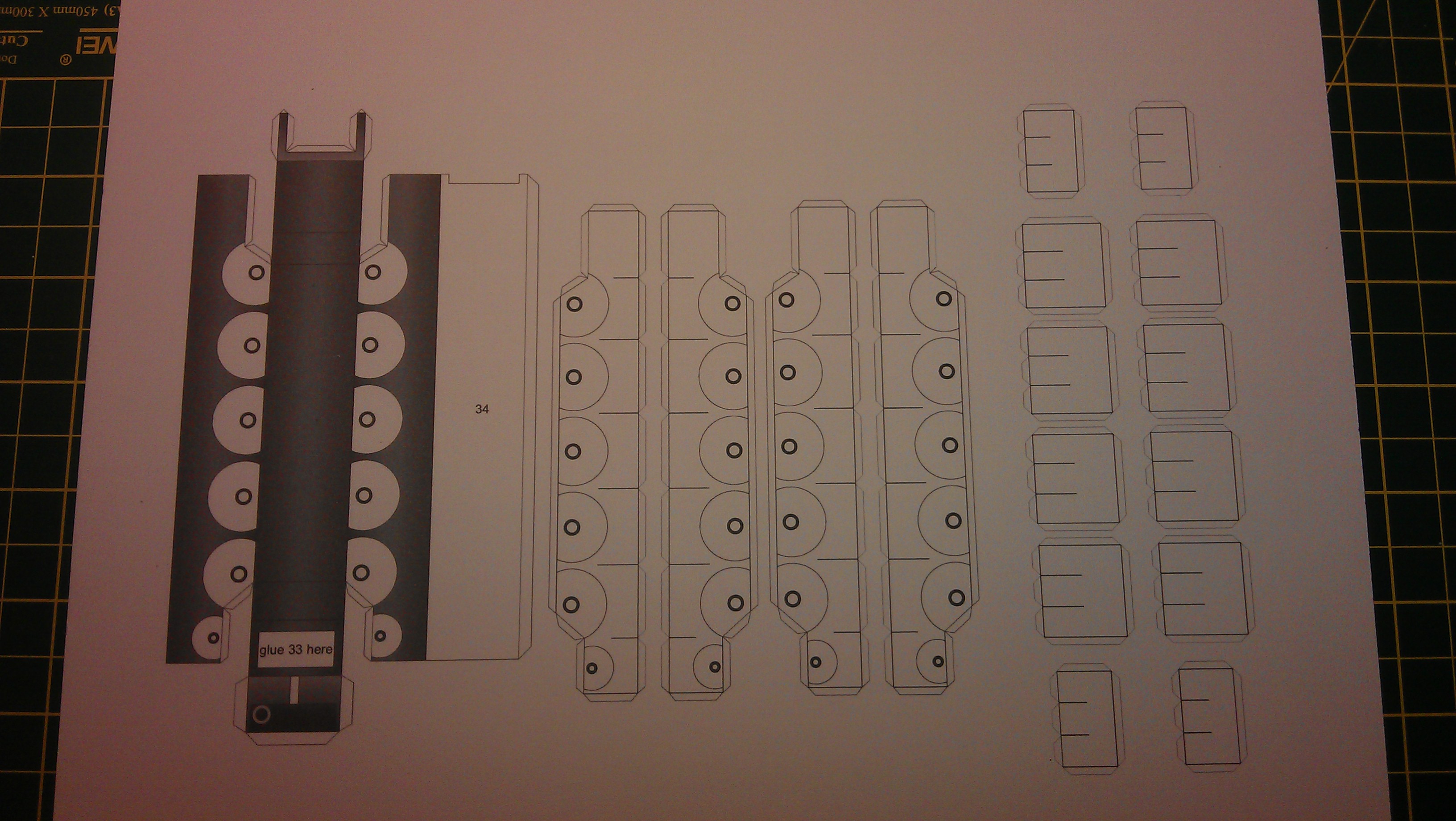

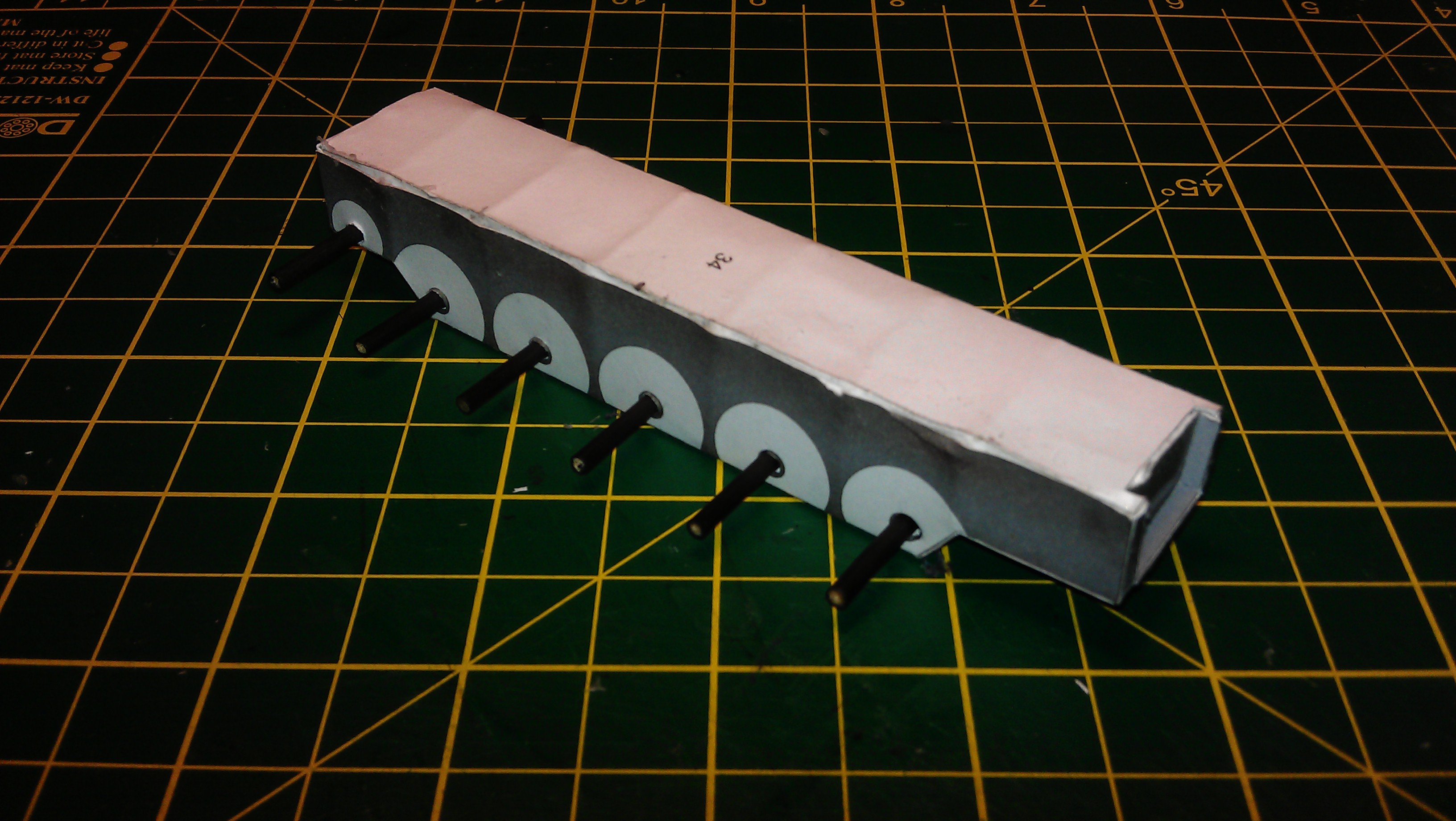

I have started on the drive box (engine and drive system).
Here is the parts sheet for that.

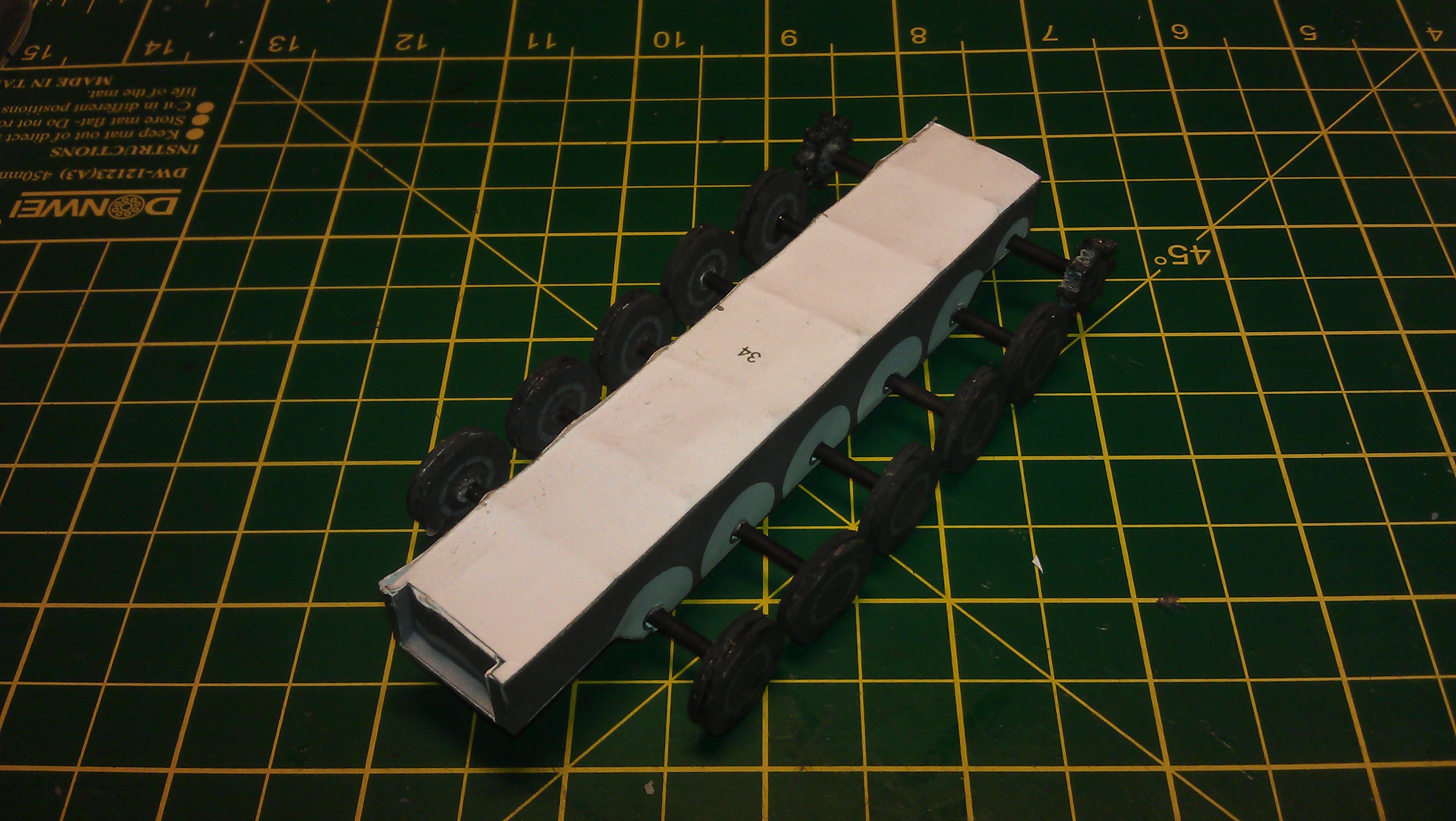

I have made internal formers for the drive box to help hold the axles and give added strength to the drive box as a whole.
The formers and the drive box are assebled.
The drive box is fully assembled.

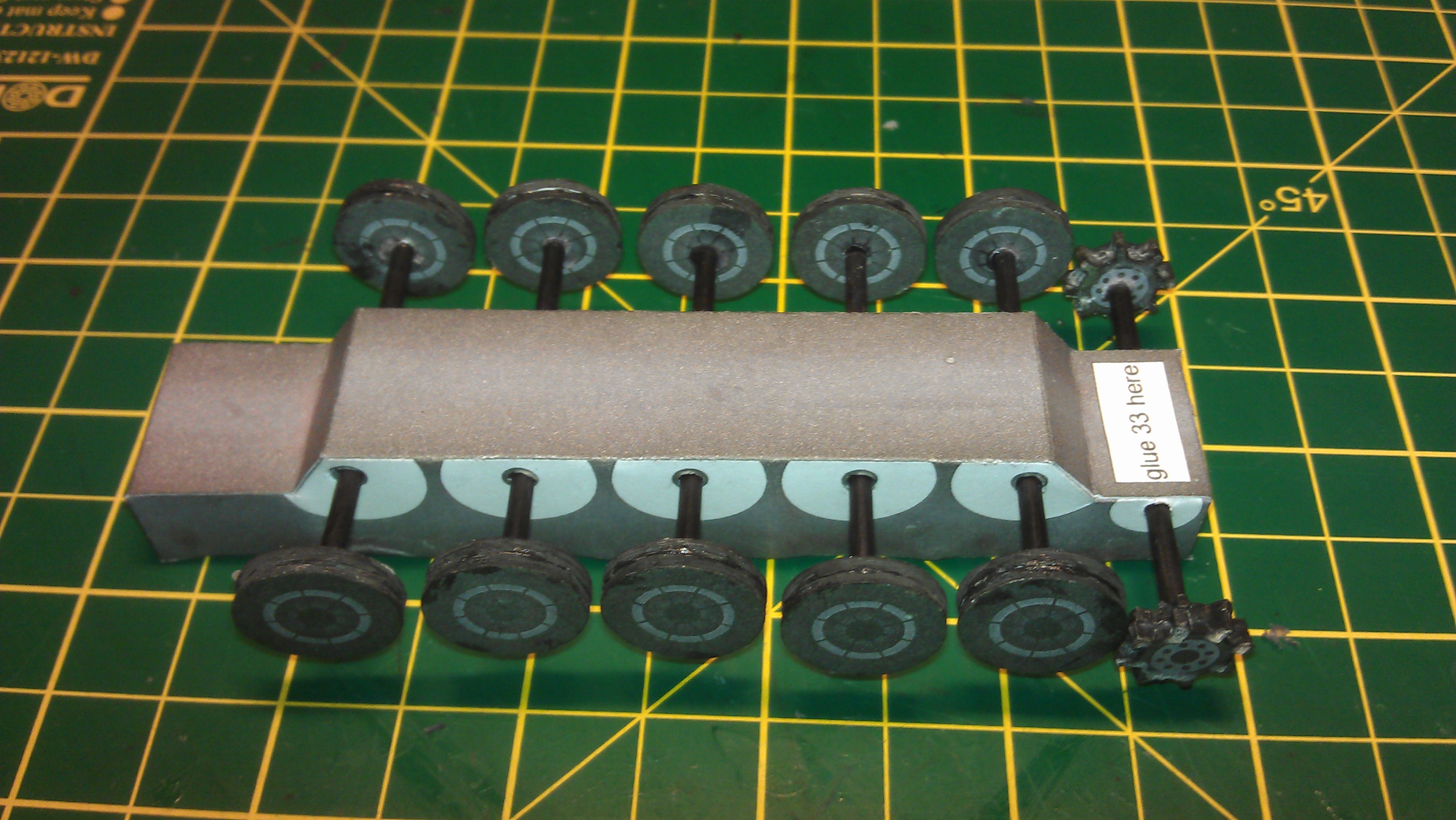

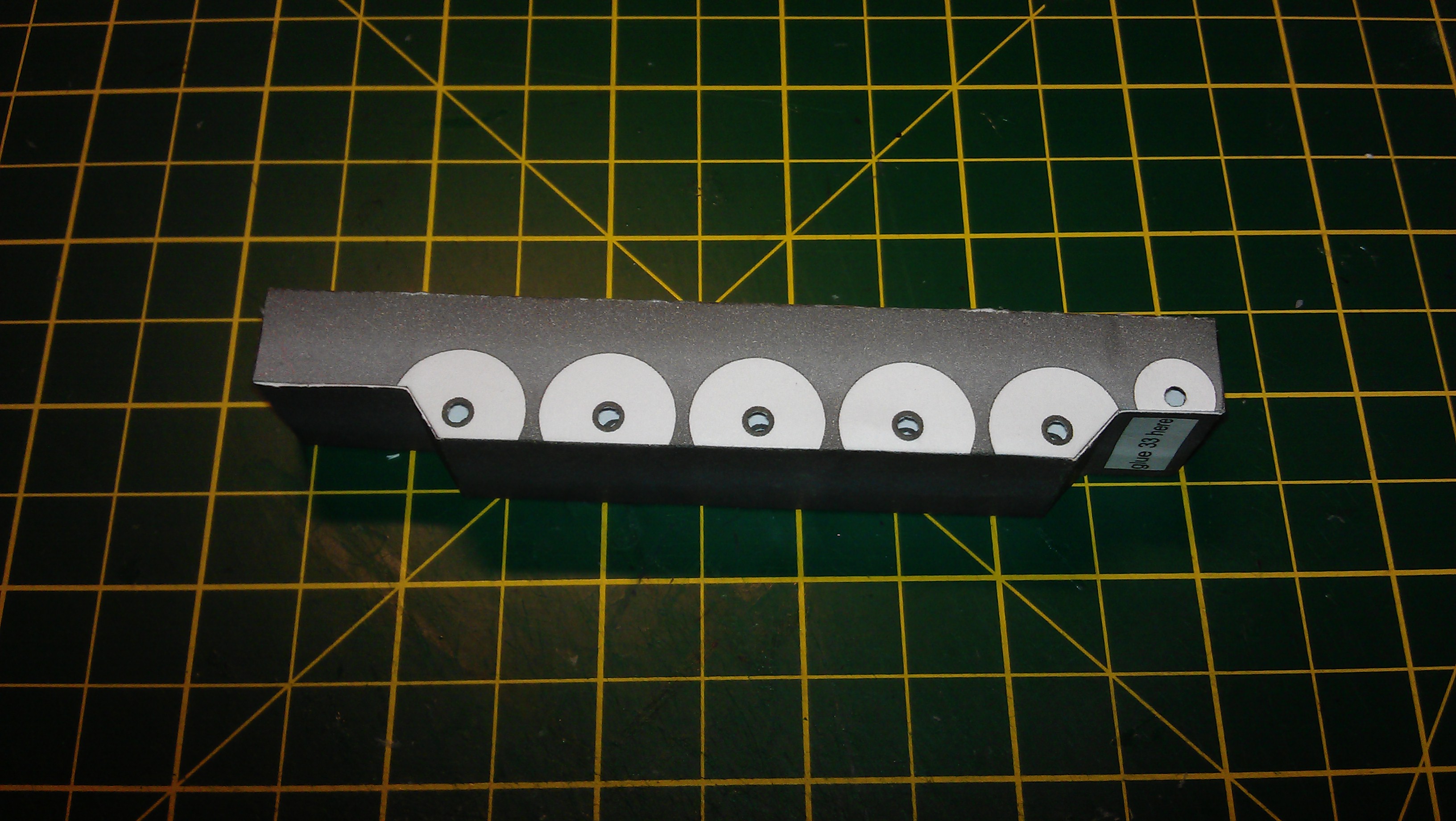

I have attached the axles.
I have attached all of the wheels to the axles.

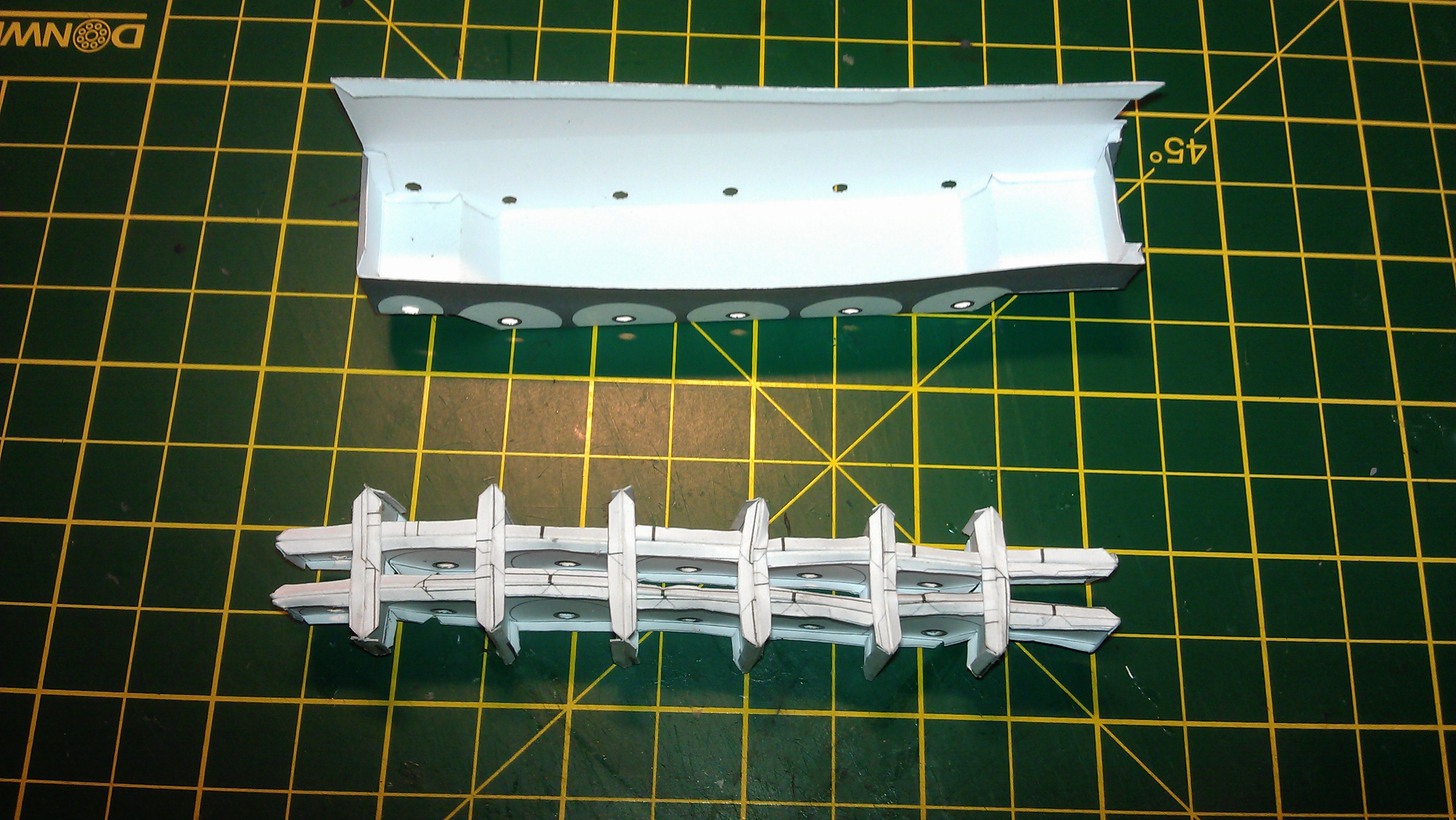

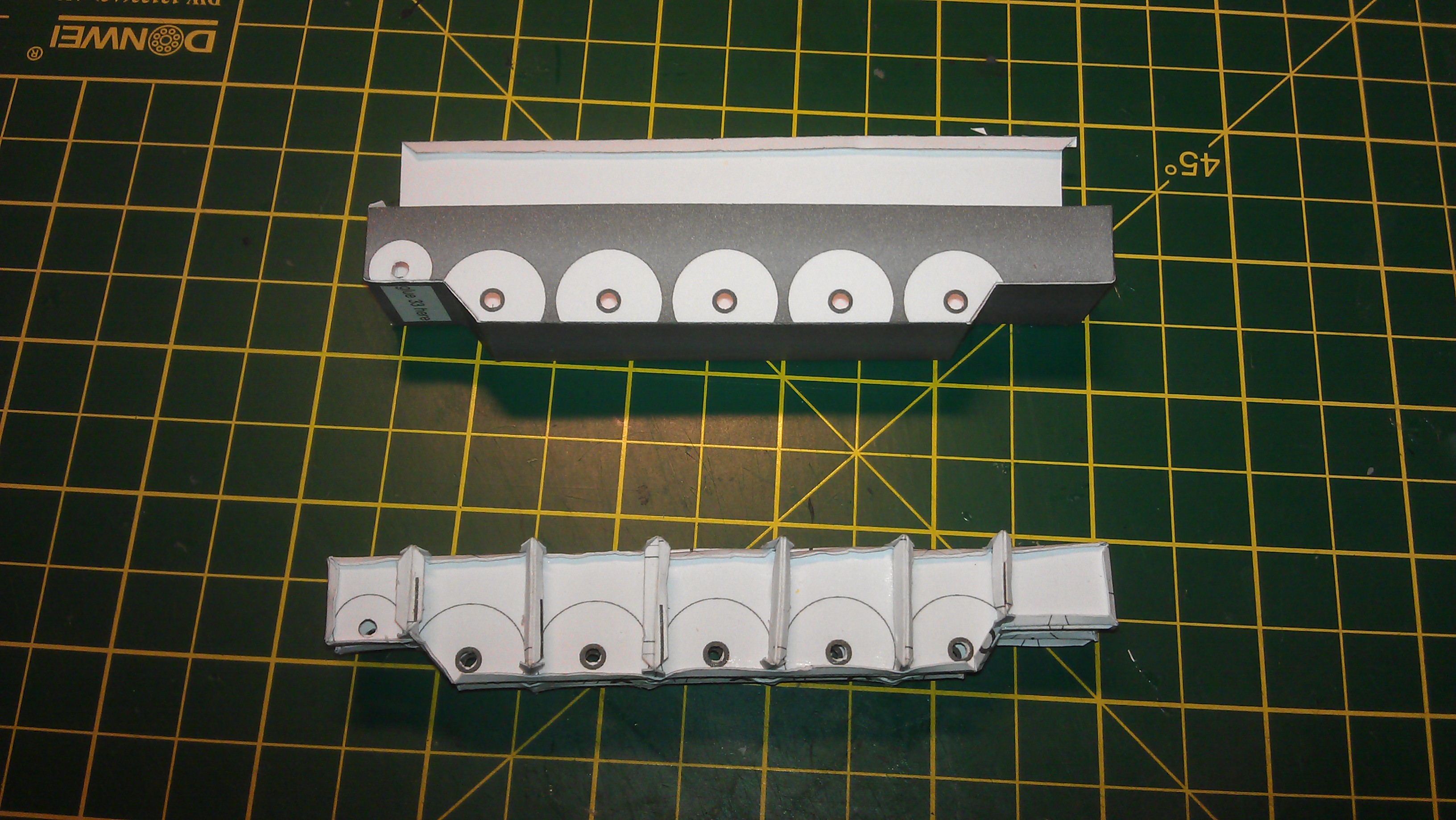

Here is an update to this project.
I am now working on the tracks.

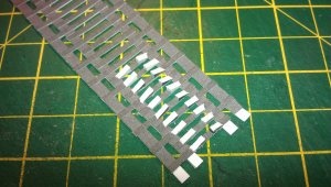

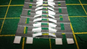

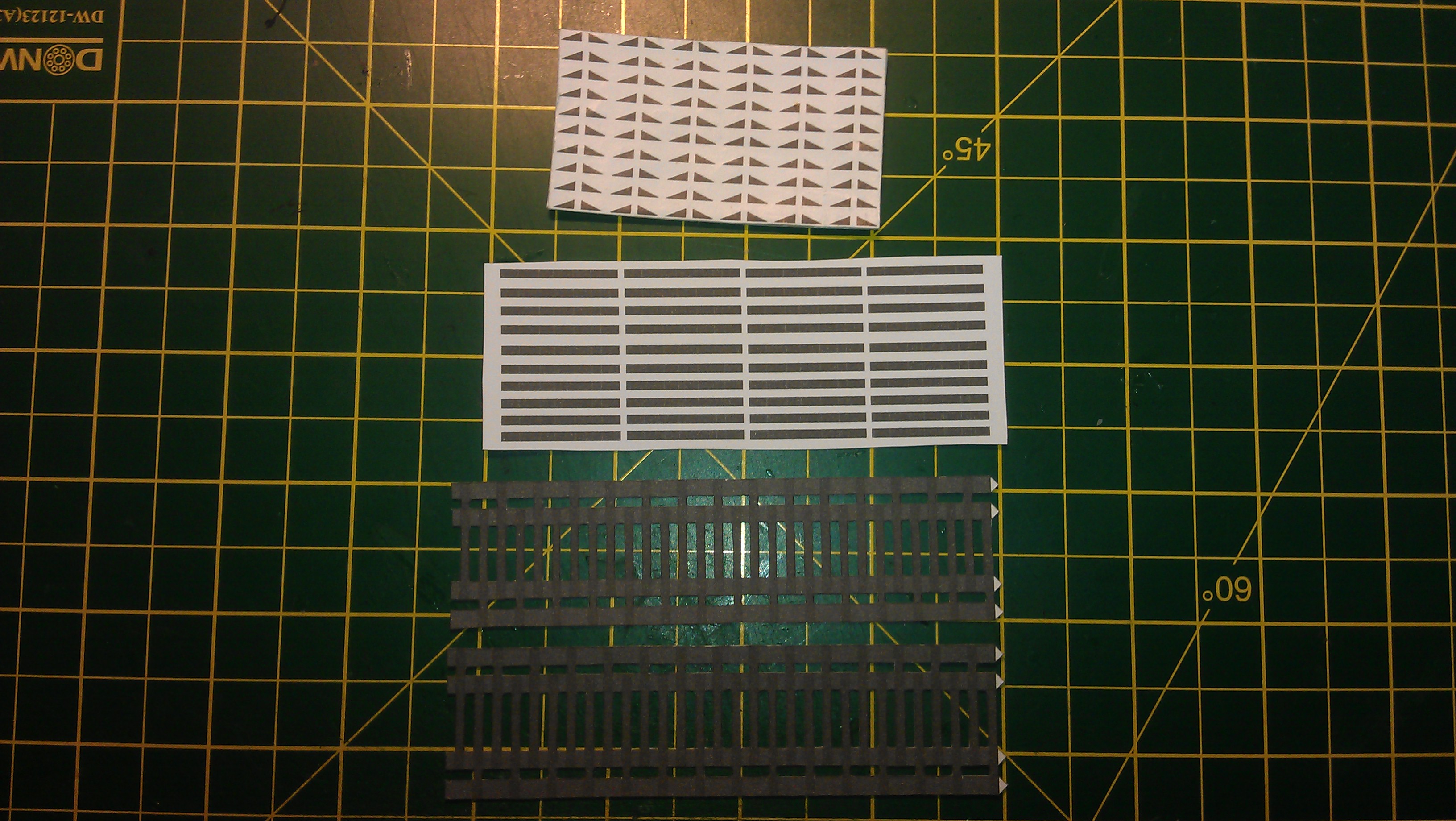

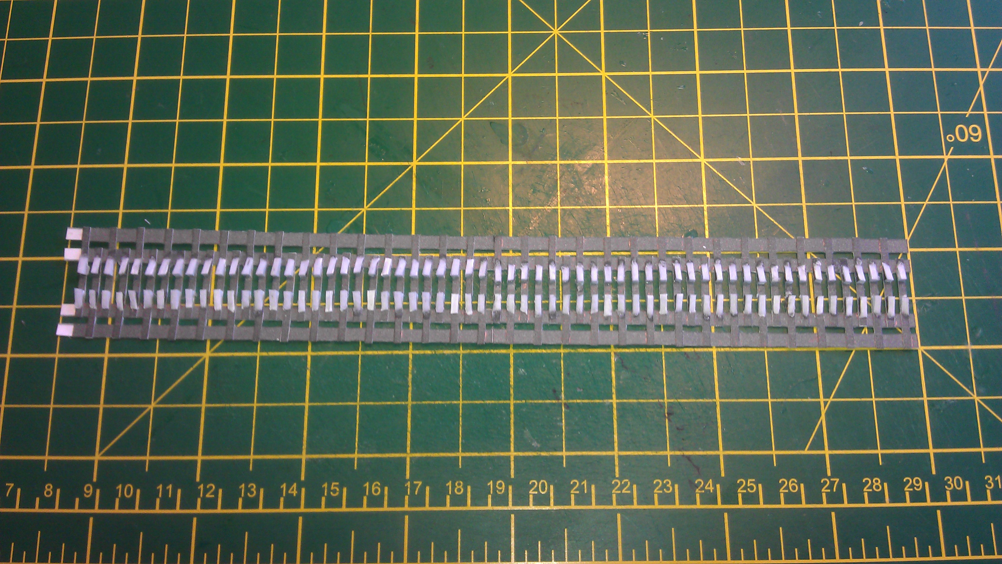

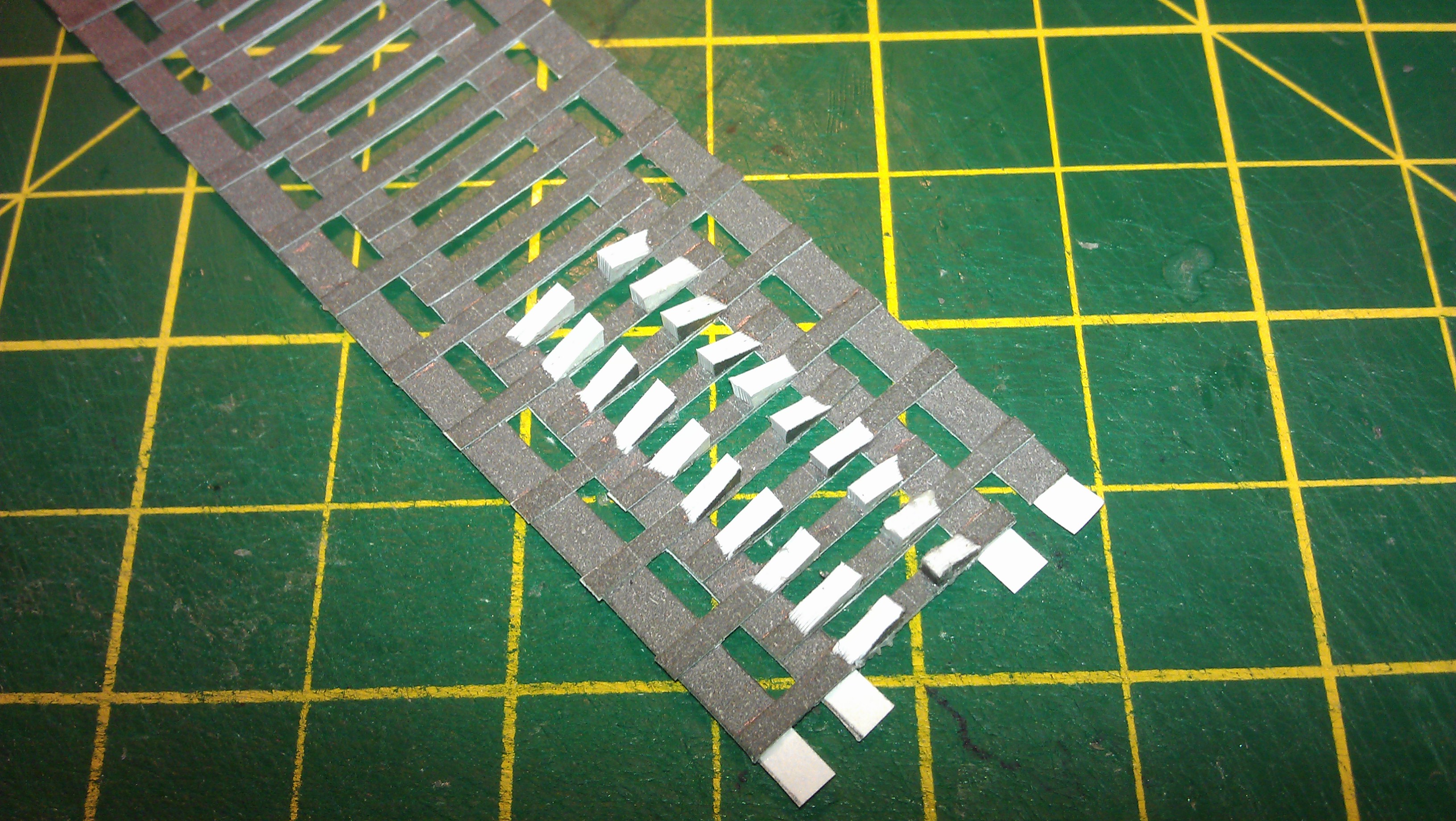

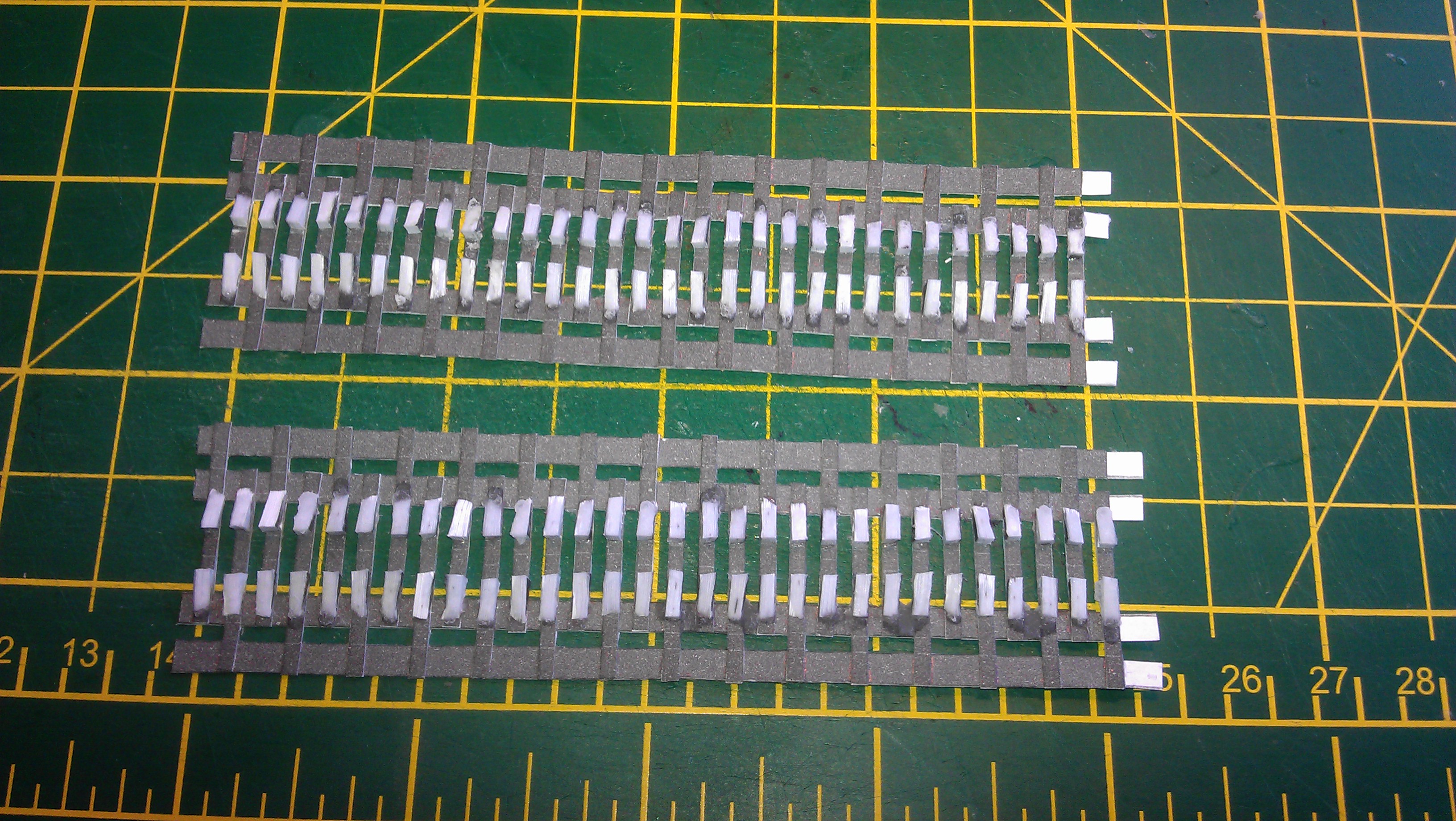

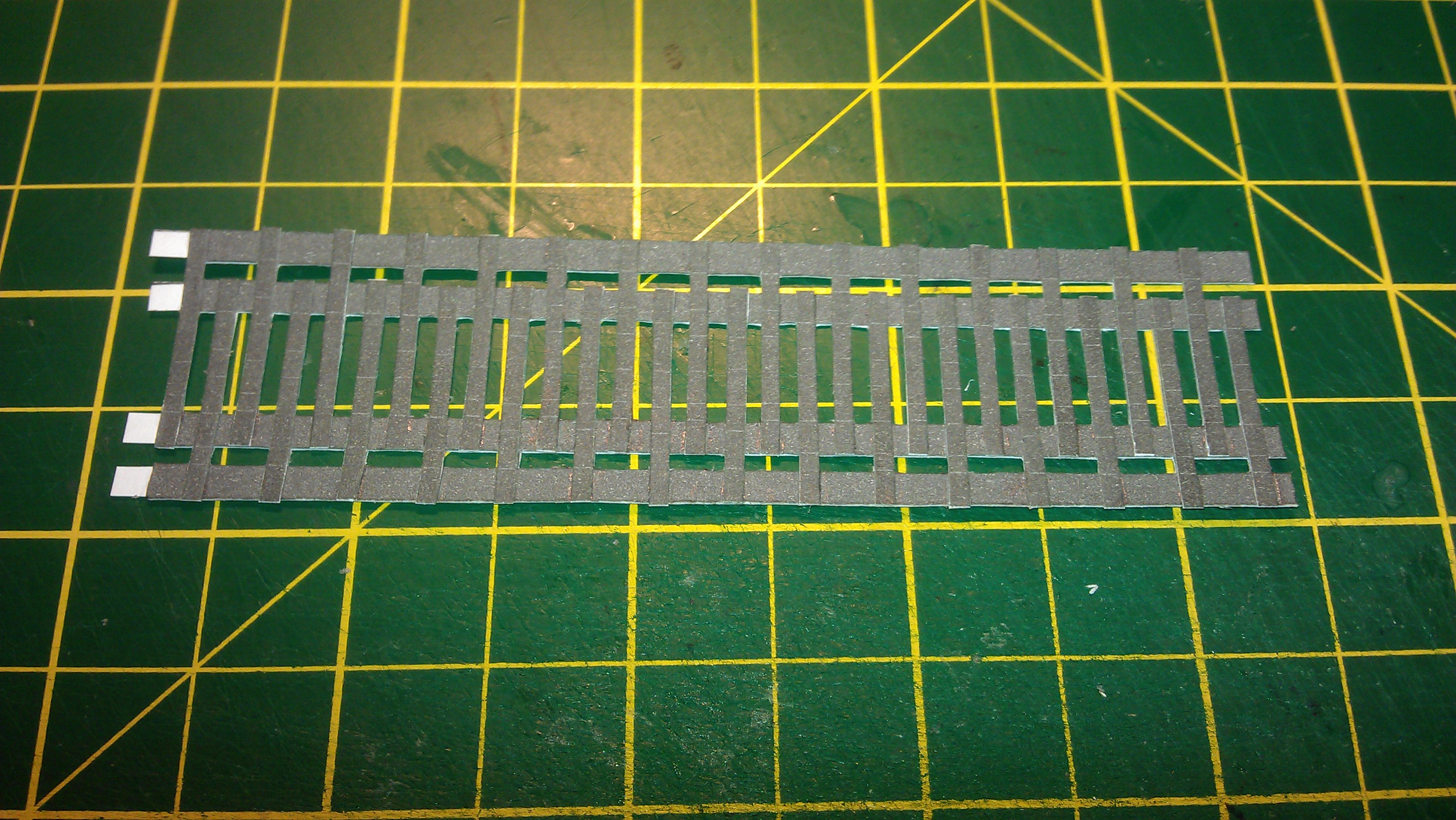

Starting with the inside half of the tracks. Here are the parts that are needed (the tracks, slats and guide posts).
These slats are attached first.

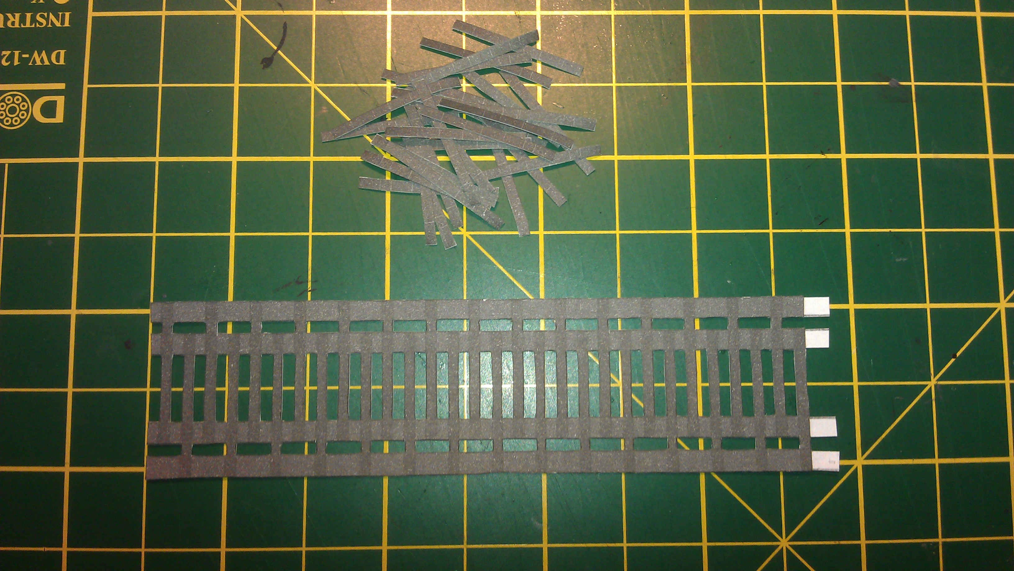

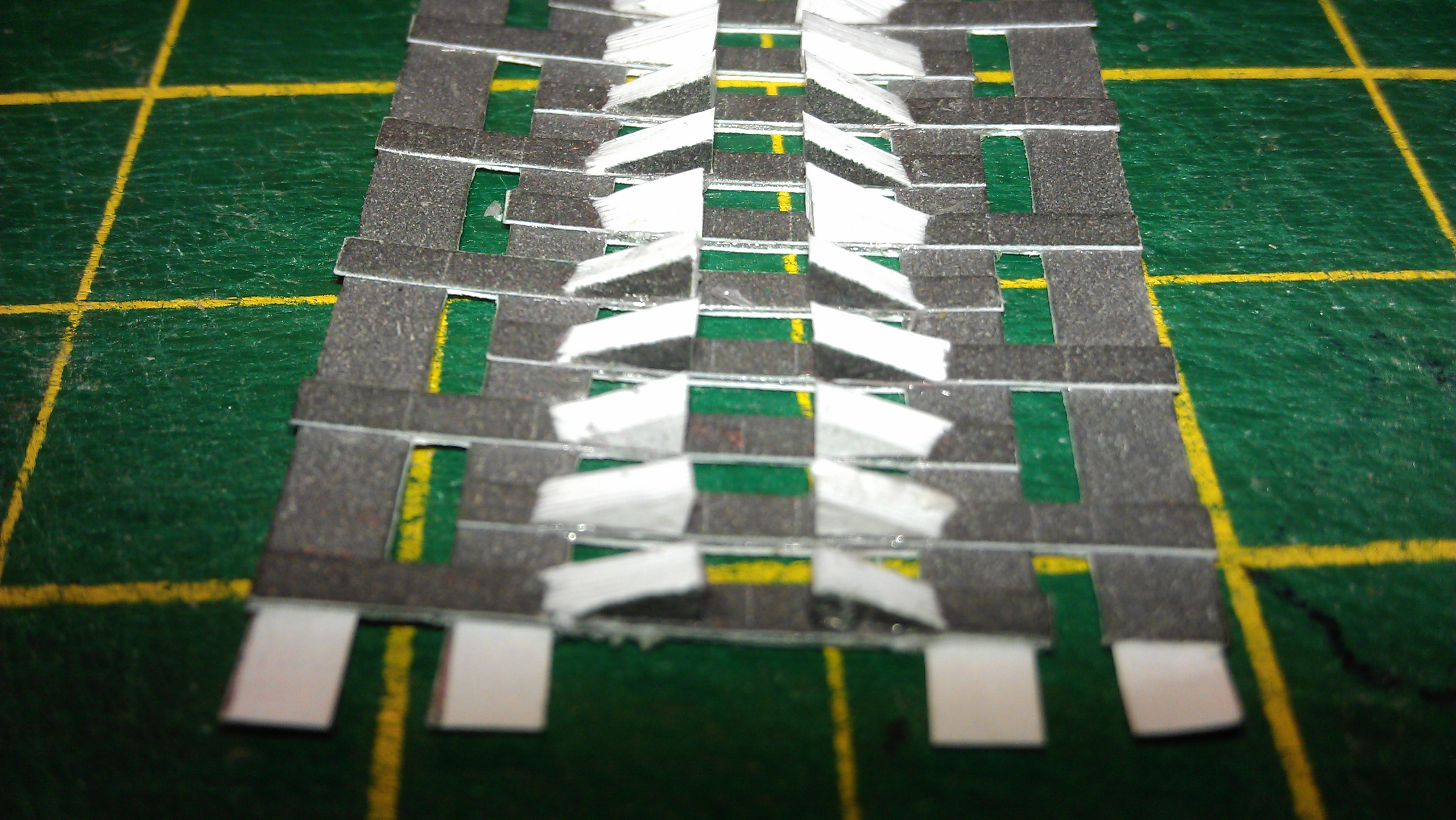

Now for the guide posts.
*NOTE* The guide posts are (roughly) 4 - 5 mm apart, so that the wheels will fit properly.

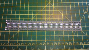

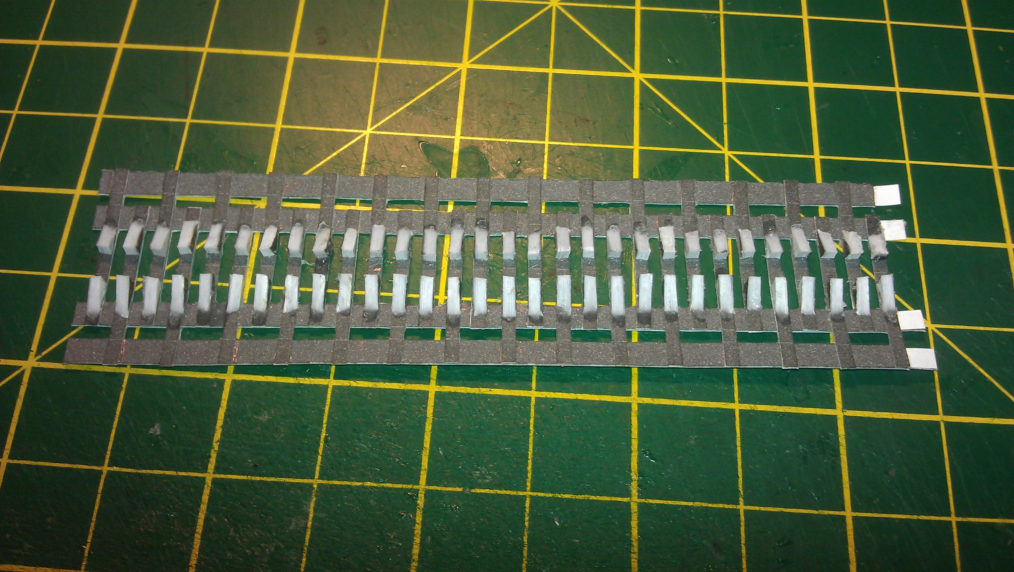

The first half of the inner half of the track is done.

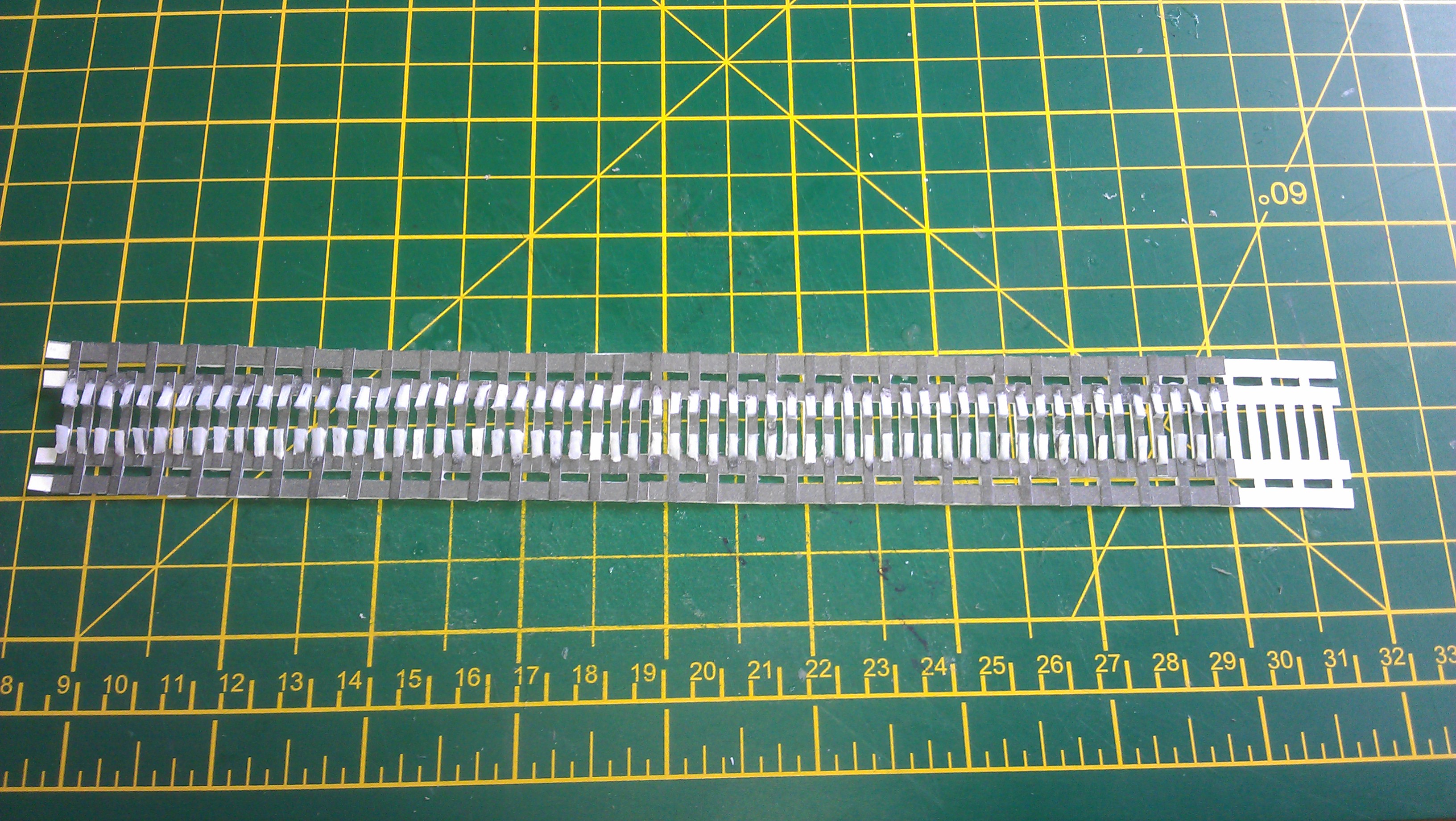

Here are both halves of the inner half of the track.
Both halves are connected.

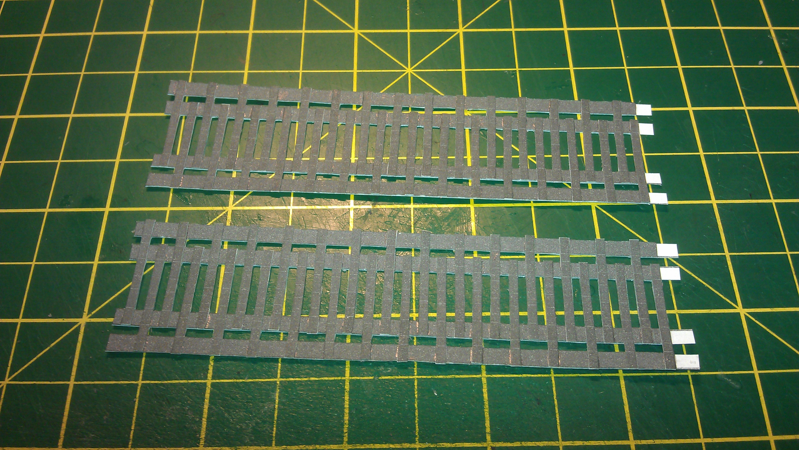

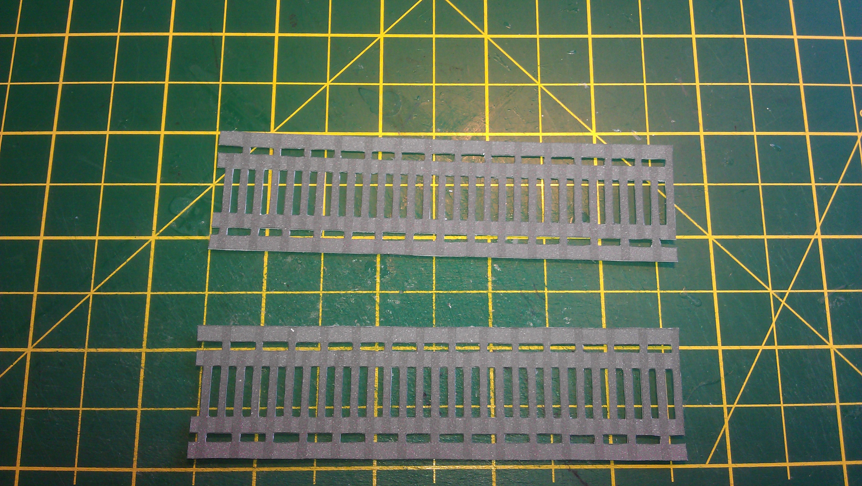

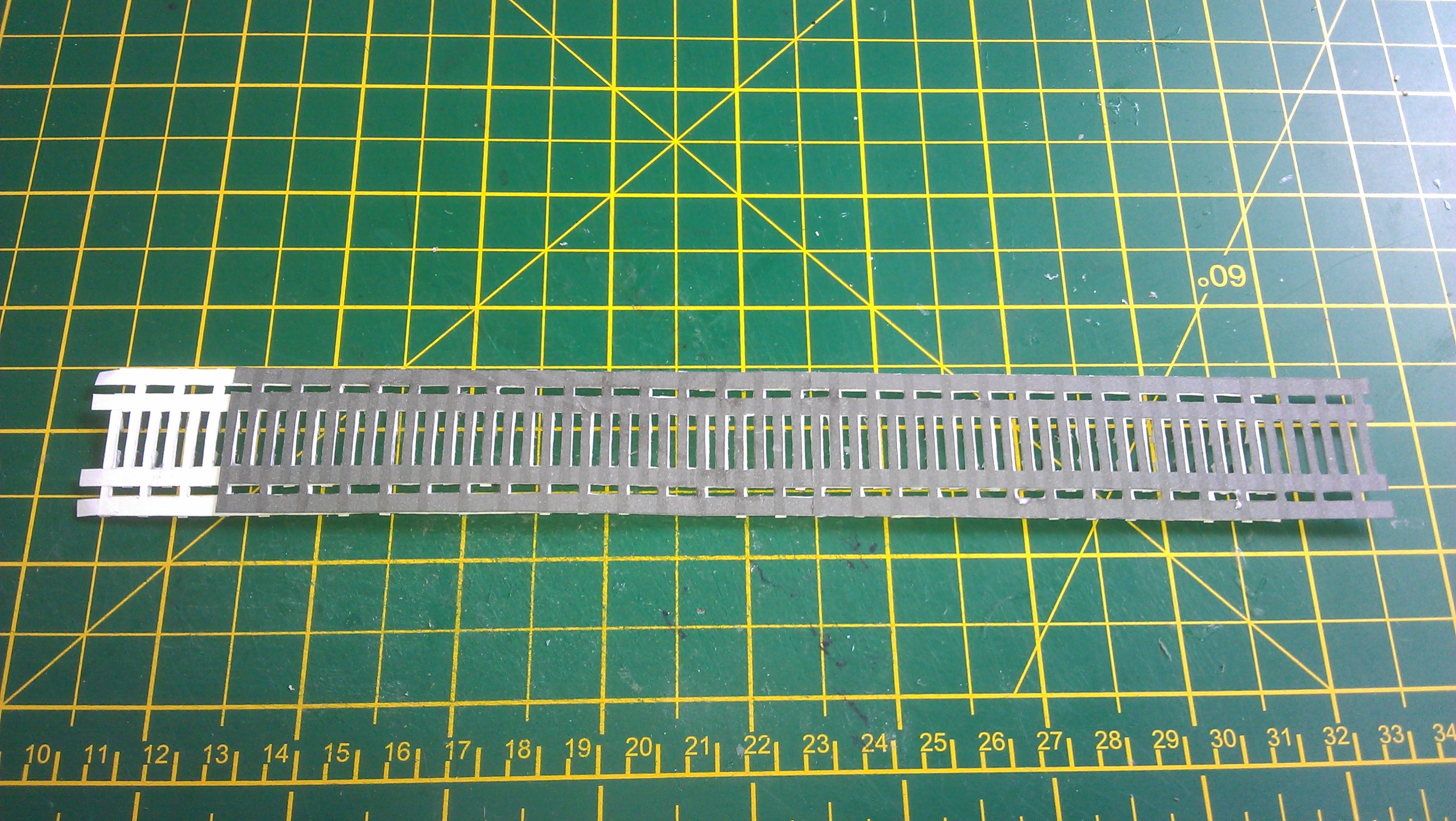

Here are the outer halves.
Both the outer halves and inner halves are laminated together.
*NOTE* make certain that you leave some overlap, so that they will connect properly.

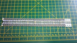

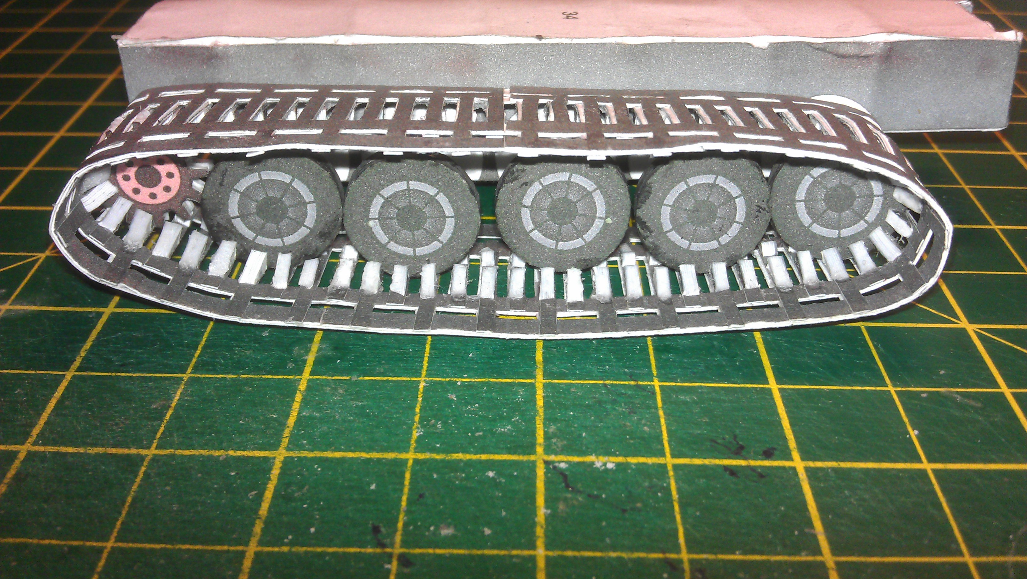

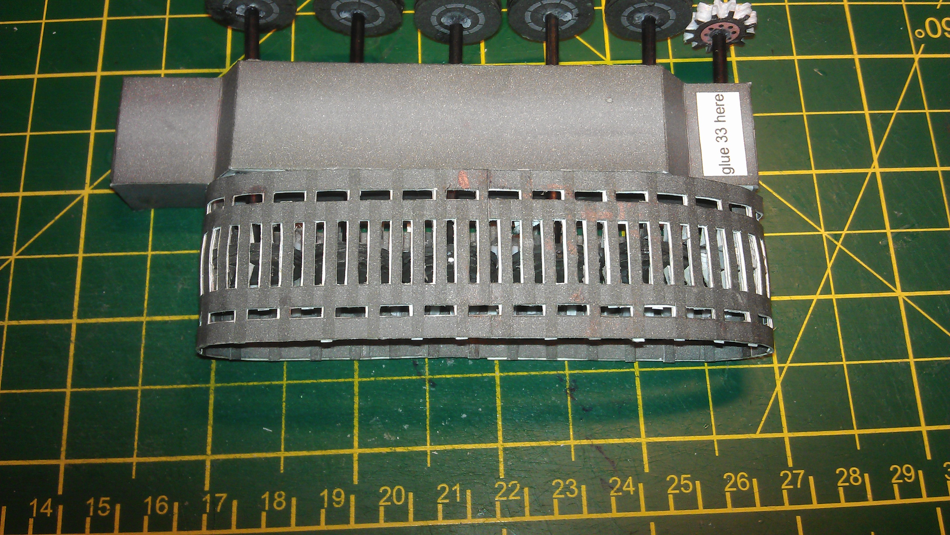

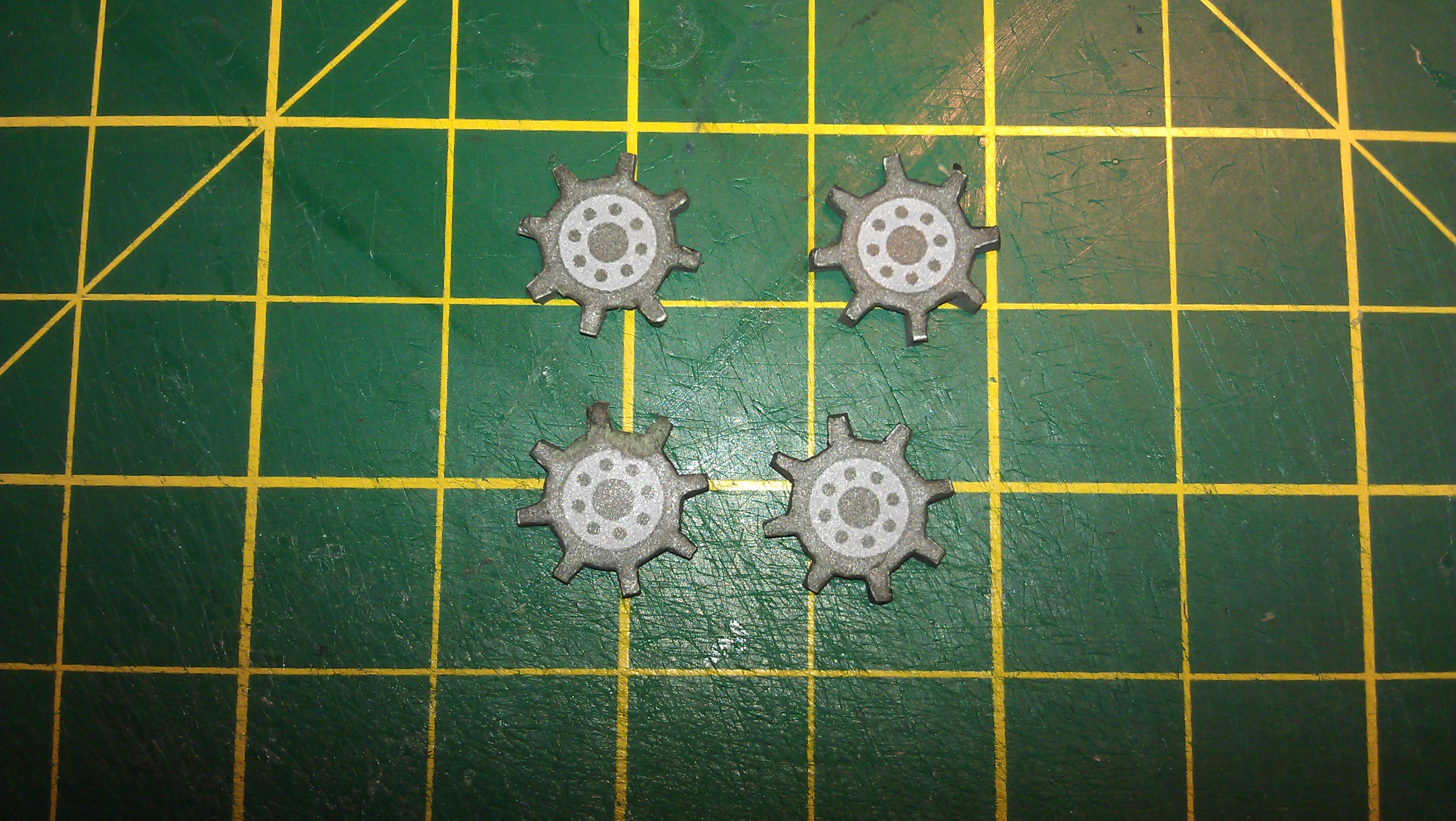

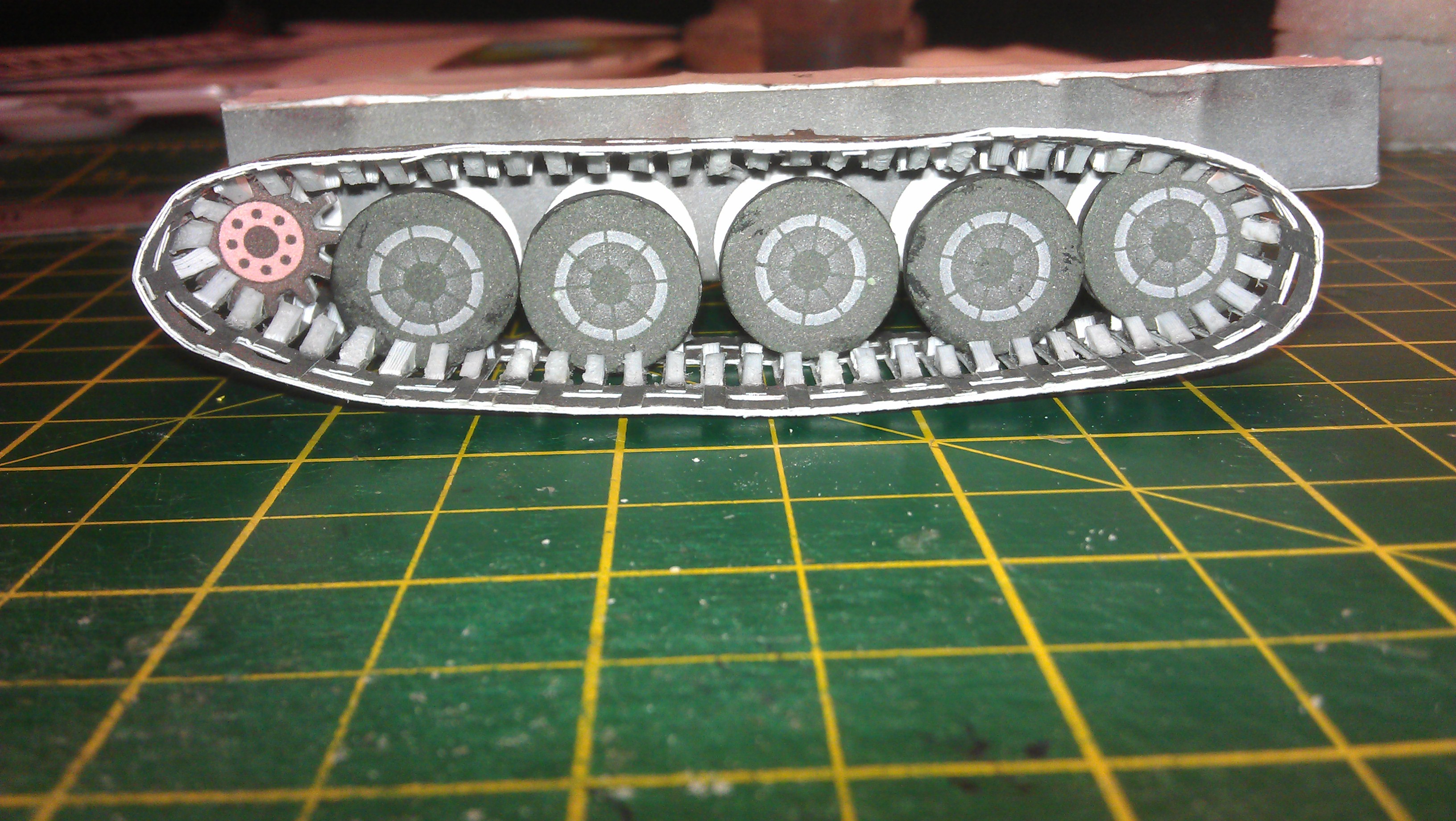

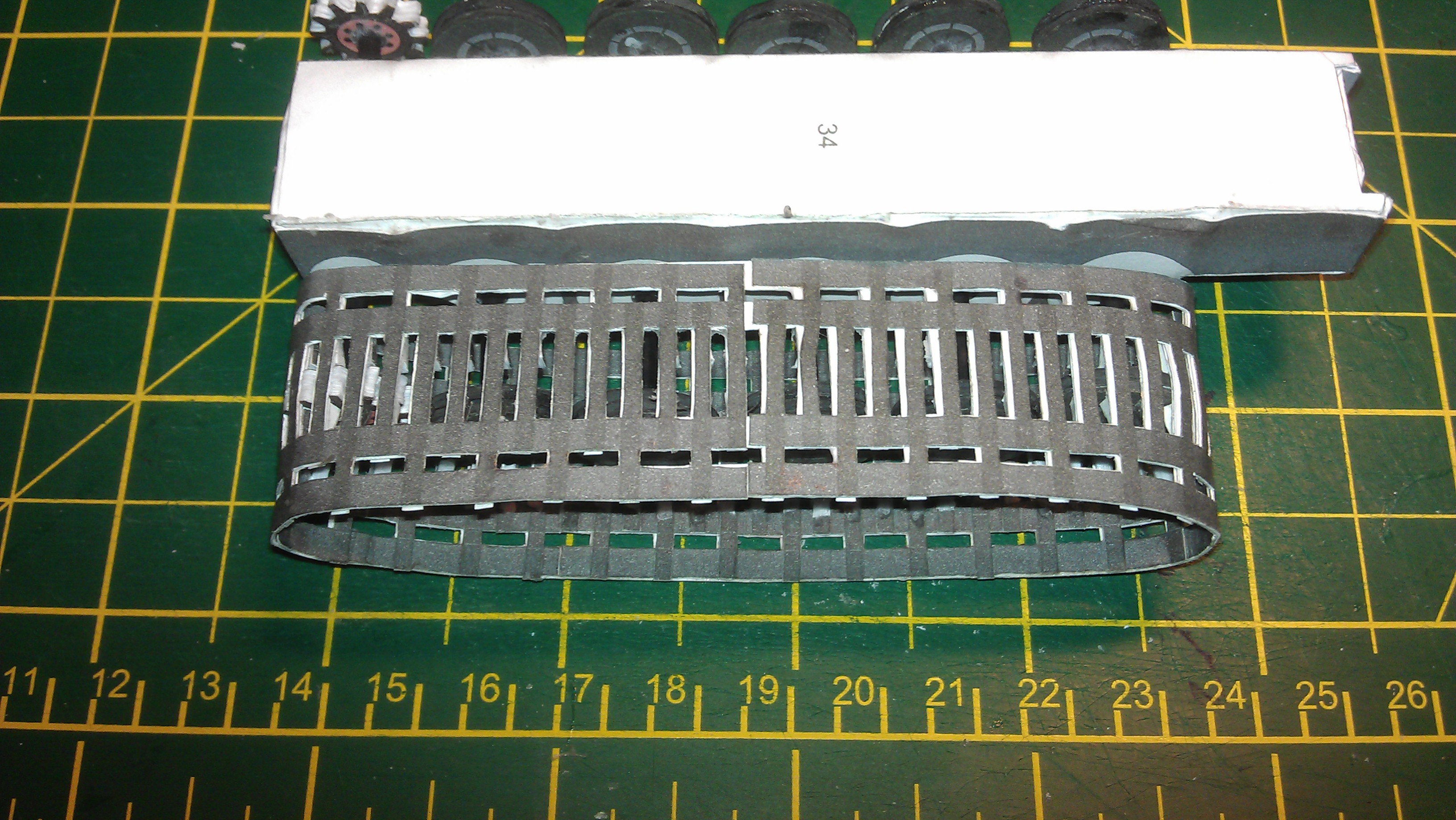

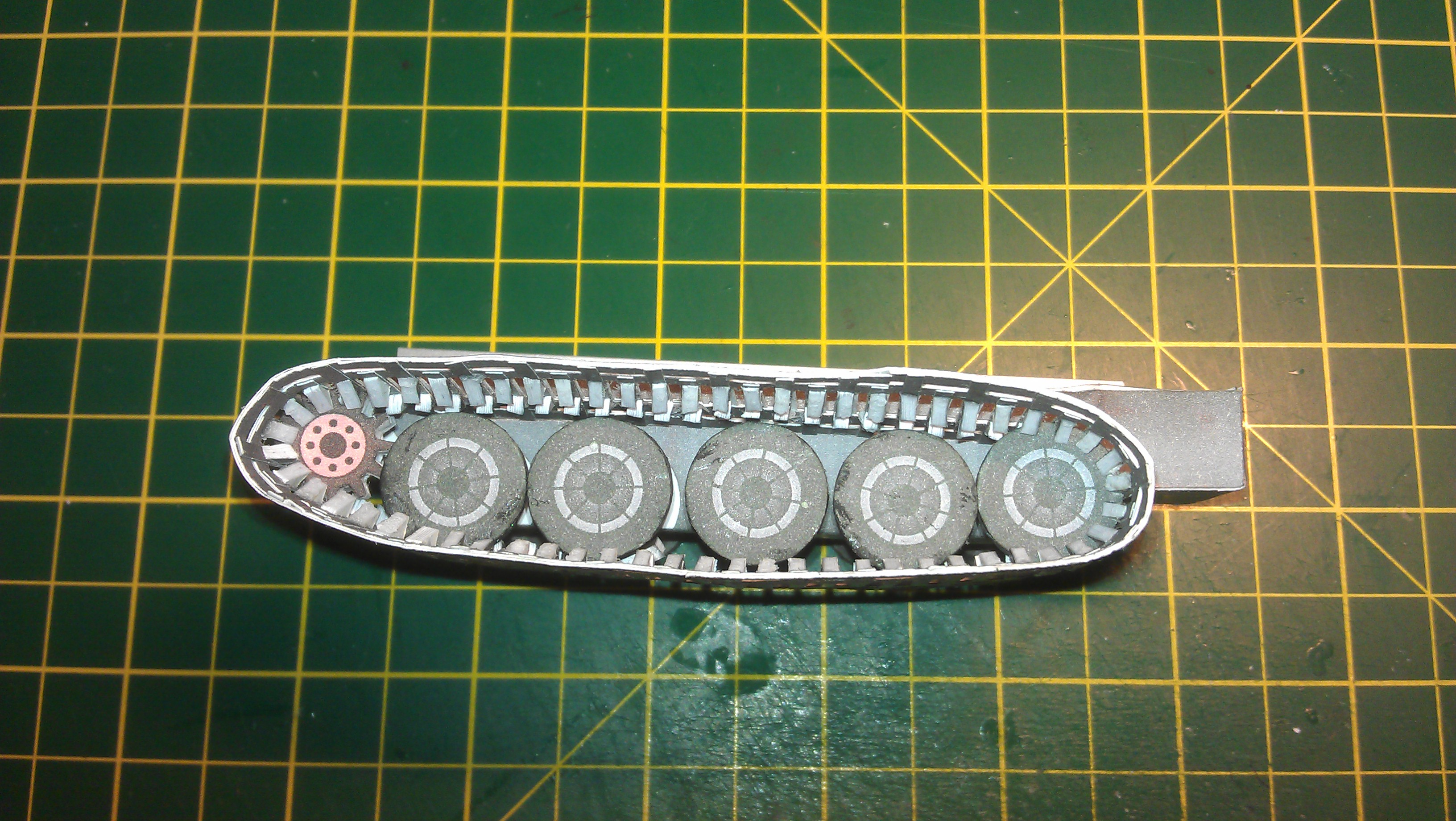

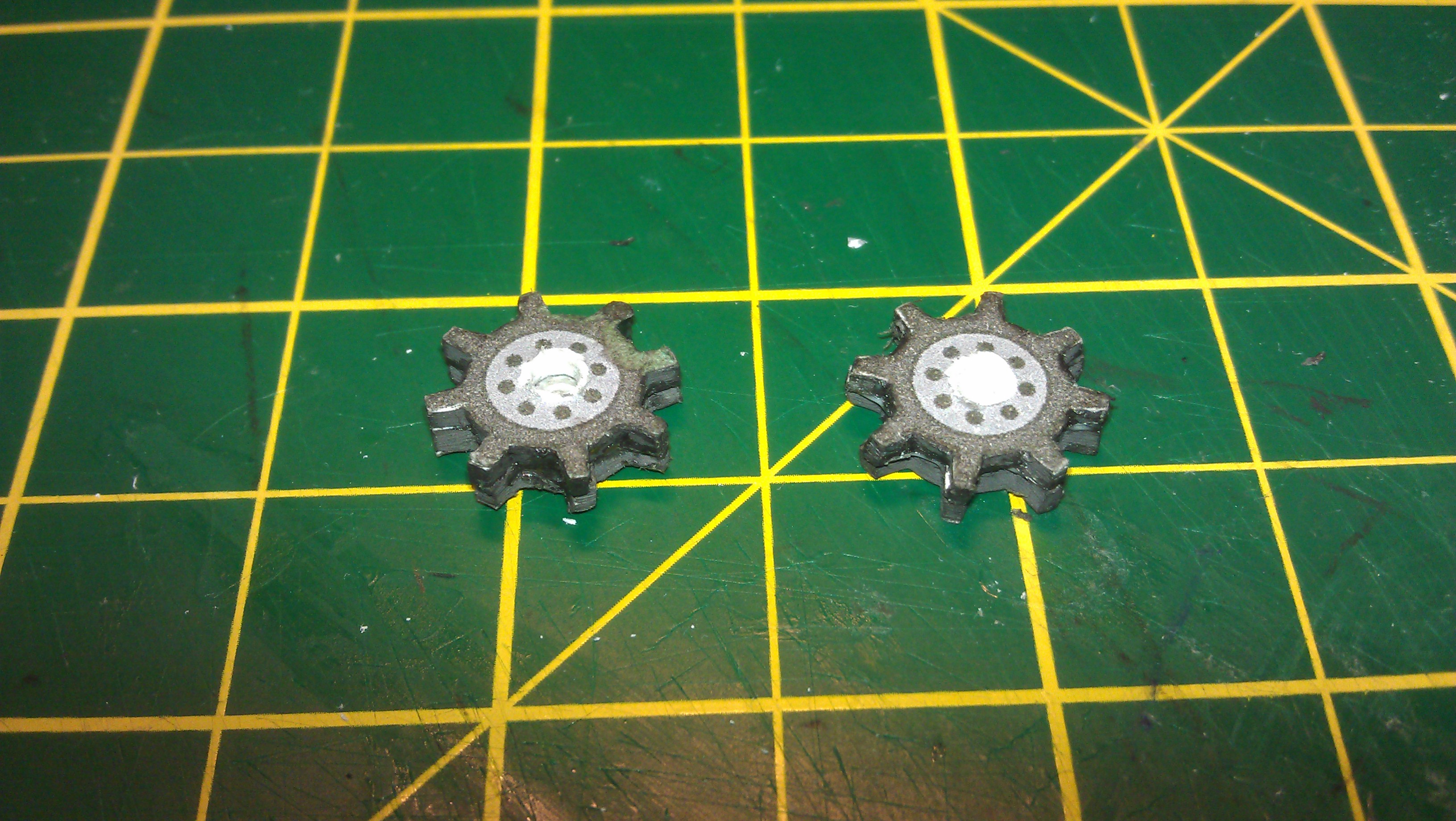

The proof of concept is finished.
I had to change the drive wheel to a 12 point wheel. After that, I wrapped the track around the wheels and everything fell into place perfectly.
Since this is a "proof of concept" build, I did not add the blades on the tracks (there are 60 blades total).
(*NOTE* Even though the track system is made to look realistic, it is static.)
I have sent all of the photos and new parts sheets to Revell-Fan for review and revision. Once the revision is finished, it will be added to the rest of the add-on components.
