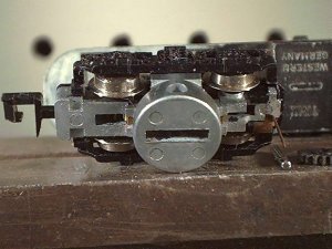

Most often I've found that the trucks need the most attention on these Minitrix locos. Removing carpet fuzz, pet hair and things of that nature.
After removing the shell, remove the pin(shown in photo) and the truck will come off. The large idler gear rides on this pin and can be removed also.

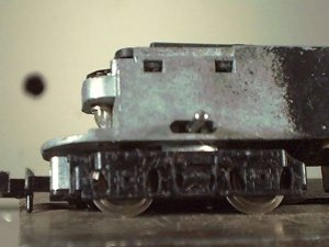

To remove the bottom cover and sideframes, remove the screw on the bottom and release the tabs on the ends. I find releasing the 2 tabs on the coupler end first helps. Watch out for flying coupler springs at this point.

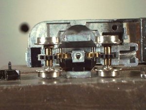

If yours are as clean as this one was , I would just check to see that the electrical contacts are clean and in contact with the wheels then apply some light oil to the bearing surfaces, a little grease on the gears then reassemble the truck. Otherwise remove any foreign objects and clean the parts with the contact cleaner or alcohol.
At this point I test the motor. If it runs oil the bearings on it and the worm assemblies. Clean the electrical contact pads (under the fuel tank), Install the trucks. Check to see that the contact on the truck contacts the contact pads correctly.
Give it a track test.
