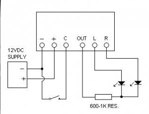

I purchased a circuitron fl-2 flasher unit, want to hook it up to a set of tomar cross bucks, can anyone help with the wiring? the directions are really vauge to me, ty
not much with a putter but the circuit board has hook up points marked as follows,
from left to right ( - + C out L R ) 6 points, I don't have detections units yet, but hopefully down the road will do that, I just want to be able to turn them on and off for now with a SPST, It has directions too, but I can't make sence of them , if it helps my e mail is paintingetc@fuse.net if you need something scanned I can do it that way, thanks for the help

handyman, try this hookup. I can't make out the polarity of the LED's
so , if they're backwards, reverse 'em.
The 3-rail diagram shown operates by the wheels of a car in the zone
switching DC- to the C terminal, making a detection circuit. The toggle
switch will do the same thing.:thumb:
If the lamps are not LEDs then the resistor value needs to match the lamp
requirements.

there are 4 wires coming from each crossbuck(2) N.J. International model 525-1090 Crossbuck w/lenses and 16 volt bulbs.
Connect one wire from each bulb to the wire going to the OUT terminal. You probably don't need a resistor if the voltage output of the flasher is 16V or less. Connect the other two leads to L and R, as the dwg shows. You may want a higher voltage supply than 12VDC. If your power pack has a fixed DC output, use that. It's probably 16V or more. Just don't over-voltage the flasher or the lamps too much. I cant really read some of the text on the sheet, but I think it specifies 10-16 VDC.
