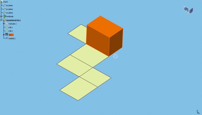

Hey all,
I'm mostly skilled in V5, and we occasionally use the unfold feature in one of the shape licenses for various template constructions. It occurred to me that it could be a very useful tool for unfolding pesky NURBS files (catpart surfaces, iges, stp etc) which so far Pepakura doesnt handle well even post translation to a polygon model.
I'd expect that there aren't many CATIA users for home/hobby use, but has anybody else tried this feature to make paper models out of? I did a test rectangle today, had to tell it which edges to tear but seems to have come out good.

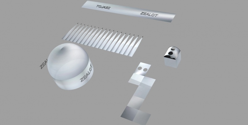

You got me thinking when you said NURBS. I stay away from Pepakura because many of the models have an ungainliness to them which seems difficult to transcend. This was some stuff I was playing with in Rhino. It is completely done in Rhino. It is about 10 minutes worth of doodling.
The Box with the Roof with two holes unfolded. The Dome over the cylinder, split and petaled, I prefer conical sections myself. The word Zealot projected onto the cylinder, then unfolded. The word unfolds with the command if you select them together. Just playing around. :)

I went back to catia and had no issues. I found it pretty much unfolds anthing as long as you cut it into quarters. So if you have a really complex shape, say a fuselage, if you cut it in half vertically down the buttline it may or may not unfold. But if you cut it in half both vertically and hortizontally down the middle you can unfold the quarters.

Well, Rhino has incredible unfolding abilities, but you need to use the "Squish" command and "Squash" command to try and unfold compound curves. Just so you know, Catia may be unfolding them, but that does not mean that those unfolds will fold back into that shape. I attached a model that I have worked on, I don't have any plans to release it. but it is something that many have tried to model with not so good results. I was pleased with the final model. It is very different going from something that is going to be machined or formed into shape opposed to making something with paper's limitations. As far as tutorials. I tried doing that, but I found that people did not stick with it. Rhino isn't something I have seen anyone master but then again, I haven;t seen anyone master any CAD program. You just work with it.
Rhino is really good if you learn how to form surfaces and make the shapes you need for yourself, rather than take a shape that someone else makes, as far as paper models go. The attached renders unfold effortlessly, though I can't say they went together that way! .
