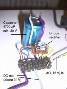

Here's an example of a CDU I built out of almost nothing: 1 capacitor and four diodes for the bridge rectifier.
It is fed from an old power pack with 15 V AC
Ron

And here is the complete setup with the control panel at left and the powerpack at right.
This CDU has power enough to shoot four PECO switch machines at once without any problems.
