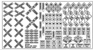

Can't find my sign!
Would y'all look at this scan and tell me what the "P" sign means???
I think I know these:
"W" - whistle post
"X" - multiple grade crossing (used under the "W")
"S" - speed limit
Double numbers - Pass./ Freight speed limits (approach)
Also I'm unsure about the angled speed limit signs. I saw one place refer to them as "high speed" signs. Is that a limited Resume Speed sign?
Could not really find a comprehensive dictionary of these signs. I found a lot of partial info
but nothing complete. If anyone sees a site that lists all these signs, let me know!:)
"sees a site" he he (groan)

I think that some of it at least will depend on the particular railroad and/or country you are looking at. For example, many crossbucks say "railway crossing" in Canada, and different roads use different types of yard limit signs.
Do you know the origin of these signs, or are they a "generic" set?
Andrew
Each road seems to have had its own ideas regarding how its signage should look. Some used angled speed limit signs. The Milwaukee Road had speed limit signs like those shown in the scan: post end cut on an angle to match the post, while the free end was cut off square.
According to Trains.com, some roads used a "P" sign mounted on the mast to indicate a permissive signal.

Andrew, this is a scan of a sheet of Blair Line HO signs. They even come with posts
to mount 'em! Not bad looking signs. I think I might use the Mountain Man's "Crew Rest Stop" suggestion!:D
