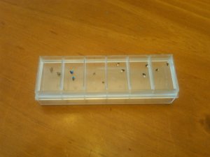

My wife hates it when I do things like that. She jumped a good 2 feet or so and accused me of being a sadist. And for the life of me, I cannot figure out why I kept the amputated leg s, but... well, here they are...

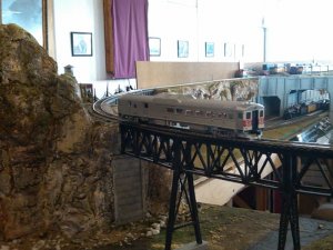

The next day, I took the RDC over to the club and ran it around...

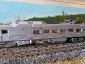

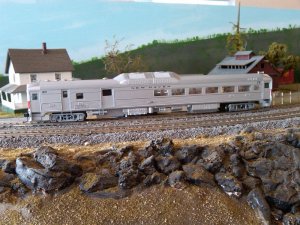

For ~25 bucks, I got a Proto 1000 RDC wired for DCC and peopled. Not too shabby.

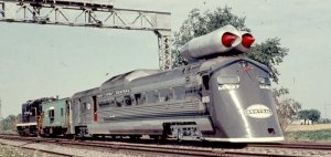

I bought the NYC RDC-3 for the purpose of modifying the model to this jet-propelled prototype. However interesting it might be, I decided to just leave the RDC alone.
