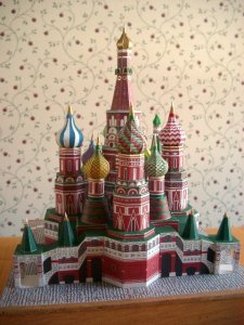

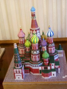

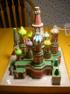

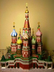

Canon Creative Park released an attractive Saint Basil’s card model pattern by M. Yukishita. The model, as built from the kit plan, provides a convincingly close facsimile of the actual prototype in Moscow. The towers and domes are modeled in octagonal forms without the complicated curves and projections of the actual prototype. Yet the overall effect is still excellent.

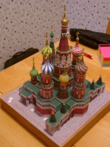

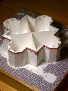

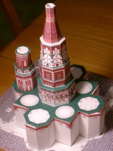

Starting out construction
The paper base area of the US letter size pattern measures 10.5 inches x 9.75 inches x 0.75 inches high. Gluing only the cobblestone pattern pieces to a 10.5 inch x 10.5 inch x 1 inch box of one-quarter inch plywood provides support that resists sagging over time and still fits inside a case made from standard 11 inch x 14 inch x one-eighth inch picture glass. An 11 inches x 11 inches plywood plate closes the box bottom and supports the clear case from sliding down onto the model.
Towers support onion domes above in a basilica plan arrangement.
Some of the towers slightly lean in towards the central tower despite the crossed support walls under the cardstock floor. In hind sight, there would be less center sag if the platform floor under the towers were stiffened with plywood, rigid plastic or more support cardstock walls.

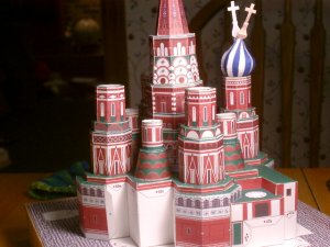

The Threes
I wanted to build the model with as much three-dimensional (3-D) detail as was practical. With few exceptions, the model pattern was assembled to the original Canon instructions up to the tops of the four large onion domes. The original parts were modified to better match prototype details shown in photographs.
The windows and doorways of the central tower part 6 were opened up and a back wall was positioned concentrically to it. Carpenter glue held the wall and supporting floor together. The doorway cutouts were glued onto the back wall, aligned with the outer doorway opening.

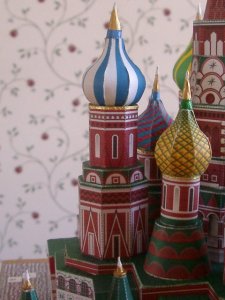

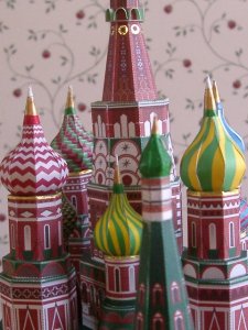

Onion Domes Assembled with Butt-Joints
Onion domes printed on 65 and 110 lb paper card stock frustrated my attempts to assemble them using the integral gluing tabs along the pattern arms. Instead, butt joints between the arms allowed for manageable pattern alignments without twisting, especially at the domes’ tops.
Because Eastern Orthodox crosses shall be used, parts 1, 59 and the other Roman style crosses may be discarded.
Mirror Reprint of Reversed Dome Patterns
Photographs indicate the swirling stripe patterns were reversed on two domes.
Dome part 11 is reversed and light in color. Two of the eight arms had incomplete stripes as well. A mirror reprint of dome 11 provided replacement arms with a complete stripe pattern. Red and dark blue color pencils intensified light colored red and blue stripes of the original pattern.
Dome part 42 is reversed. Mirror reprinting corrects the striping direction.

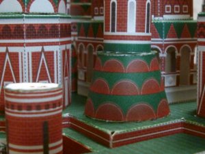

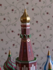

Central Tower Details
The central tower has an outstanding amount of gold detail. The small repeated projections up the side edges would be great to model but I don’t have a convincing simulation. Eight gold ring details can be cut from aluminized Mylar polyester. An empty coffee ground wrapper provided the aluminized Mylar film. Punch out the basic circle with a 5/32 inch diameter hole punch. Punch out the center with a 3/32 inch diameter hole punch. Fasten the rings over corresponding printed shapes at the upper section of part 3. The punches are available at Harbor Freight Tools as part of a six punch set.
A greenish ring of windows circles the top of central tower part 3 by gluing a floor disk with an octagonal cut-out center to fit around the tower. Eight green card strips, 1 cm. x 0.5 cm then trace corresponding black arch lines on the central tower. The ends of the arches begin and end attached to the previous floor piece.

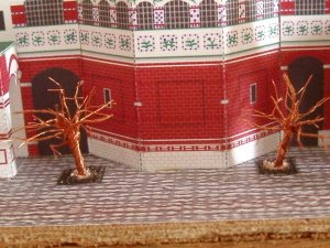

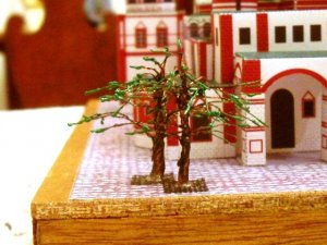

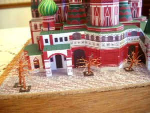

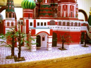

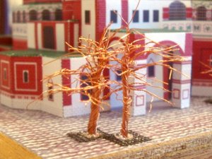

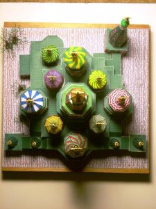

Keeping the Trees Three Dimensional
Three equal lengths of 16 gauge stranded copper wire are used to make trees. The two larger trees (parts 74 and 75) look like lindens (tilia cordata) with a pyramidal shape cut to a ¾ standard that allow pedestrians to pass underneath them. Start with 5 cm wire lengths and bend lower branches horizontal, leaving the lowest 1 cm bare so people can pass under the branches. Branches shorten and bend upwards towards the tree top. Branches normally grow a series of bilateral side branches beside a center lead growth.
The smaller trees (parts 76) appear rounded but still have the lower 1 cm bare trunk for pedestrian traffic. Start with 3 cm wire length.
Paint the branches black to dark brown. Paint leaves. Add flocking to taste. Drill holes through the tree base locations. I used fiberglass window screening with two off set layers to simulate metal grating used for protecting public tree plantings from trampling.

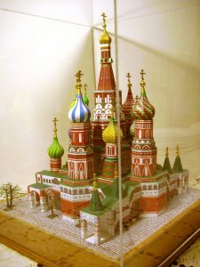

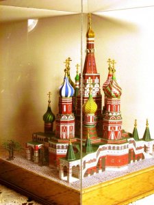

Clear Cover Case
The clear case is 1/8 inch thick plaskolite acrylic sheet. Two side pieces 10.5 inches x 14 inches are solvent welded between two side pieces 10.75 inches x14 inches. A 10.75 inches x 10.75 inches top covers the top edges of the sides. I used methylene chloride sparingly applied to the joints from a glass eyedropper.
