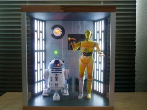

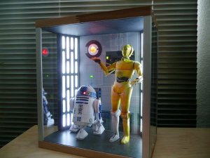

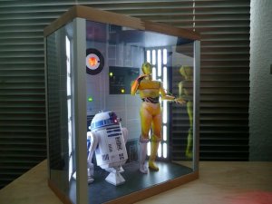

Here is my latest Diorama:
R2-D2 and C3PO at the Death Star, trying to shut down the garbage compactor beneath the Detention Block.
This is my first Diorama with lighting.
Regards Loenf

What can I say but amazing!
I have also made this R2-D2, but yours, combined with the diorama and the magnificent C3PO...it is truly a masterpiece.

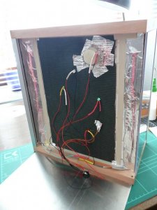

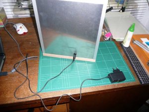

Here are some pictures from assembling the diorama. The background is illuminated by LEDs in differend coulors. The current source is an old batterycharger from an old cellphone.
regards Loenf

Amazing. Good to see the rear of the model as well. The lights are a great addition.
That's a brilliant/brilliant diorama loenf. Yes, it really is. :wave7:
Thanks for showing the pictures from behind also.

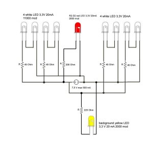

Any chance you could give an electrical schematic? I am sure many of us would appreciate it, I certainly would.
Many thanks for the post.
Andrew
Andrew
Hi,
here is an sketch of the LED circuit of the Diorama.
Here is a very usefull Current Limiting Resistor Calculator for Leds
All the LEDs are parallel connected to the current source. With different resistors you can change the luminance of the LEDS.
Regards Loenf
