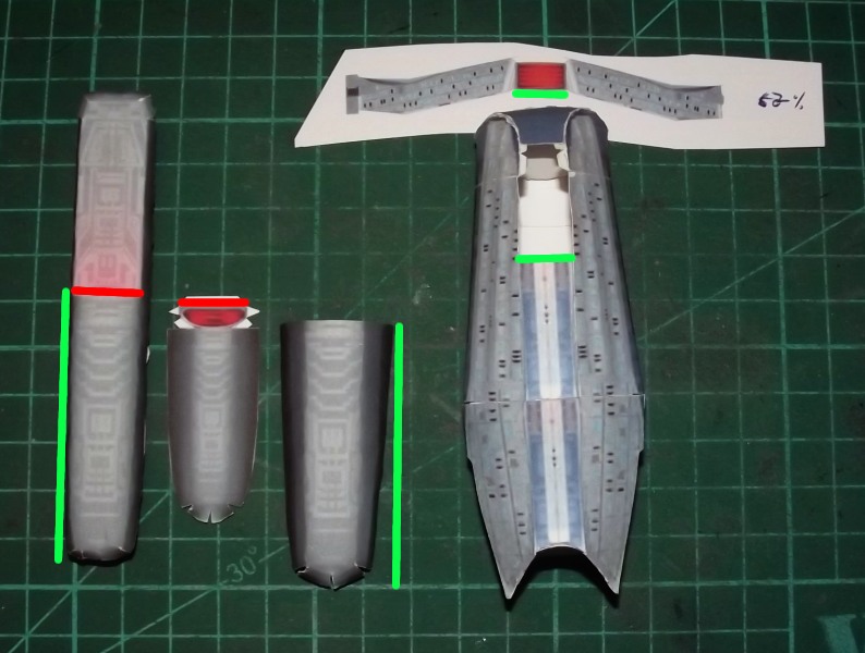

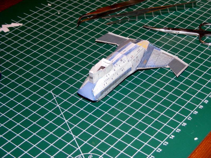

I've found the old files of my Wanderer class build again. Now I can tell you exactly what went wrong with my build. First, the neck which combined the saucer section and the engine section was too big. I resized it to about 57 % which should fit. The impulse engines on the warp nacelles were too big, too (the parts with the red lights). I reduced them, too. You'll have to check the length of the (grey-blue) cover part and maybe resize it a bit to make it long enough to cover the nacelle. Unfortunately the main parts suffered from bad storage conditions and cannot be used for completing the build; I guess I'll make a new one soon.
I have attached a small pic showing which dimensions must match (green-green / red-red).

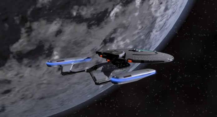

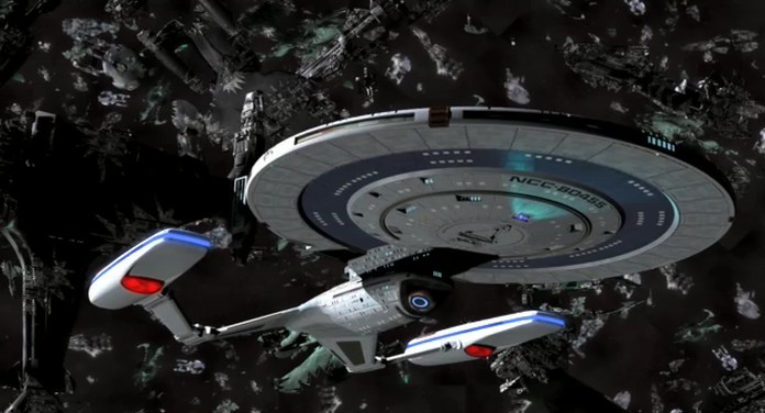

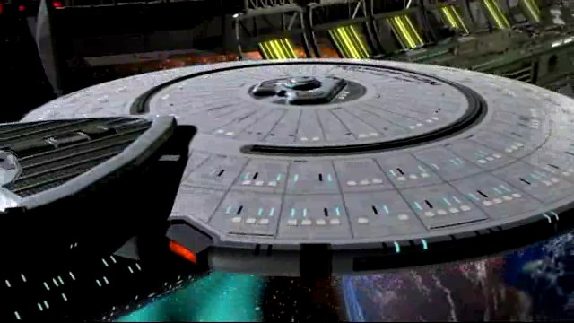

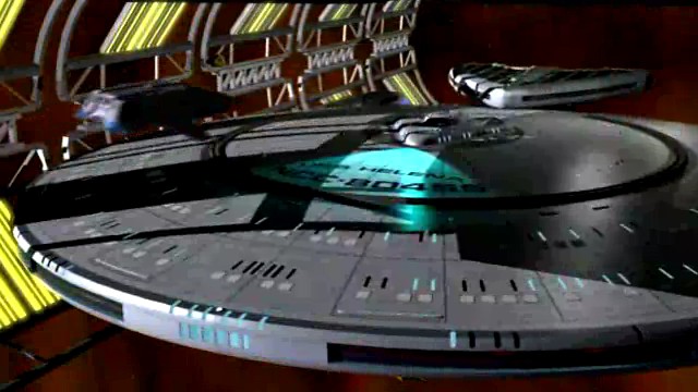

And here are some screenshots of the Helena in action. Enjoy!

I don't have the nacelle scaling problem, seems like your sheet 2 and 3 didn't have the same scale perhaps ?
The neckpart is a problem though. When you scale it down and would assemble it the way it is then the dish would be tilted because the neck doesn't line up correctly.

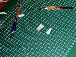

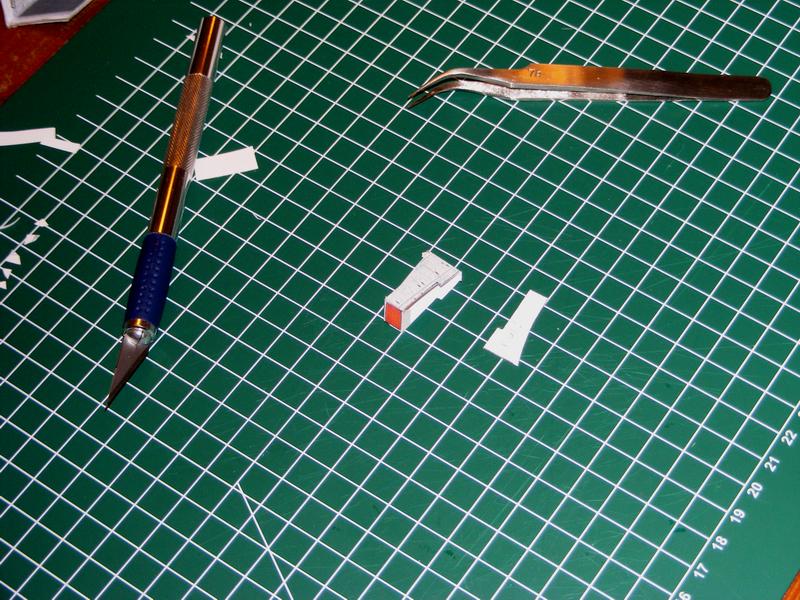

Little update on the Wanderer.
I had to carefully cut my first attempt for the neck off the main hull again because the saucer tilted forward, looked sleek but not realy accurate.
So I started from scratch today and made a complete custom neck template which I can use to cut out the left and right neckparts out of a hullplating print I made. If all goes well it should fit and keep the saucer in the right angle.
When I start building the neckpart I'll make some pictures and post them so you can see what I meant.
Cheers and all the best,
Elko

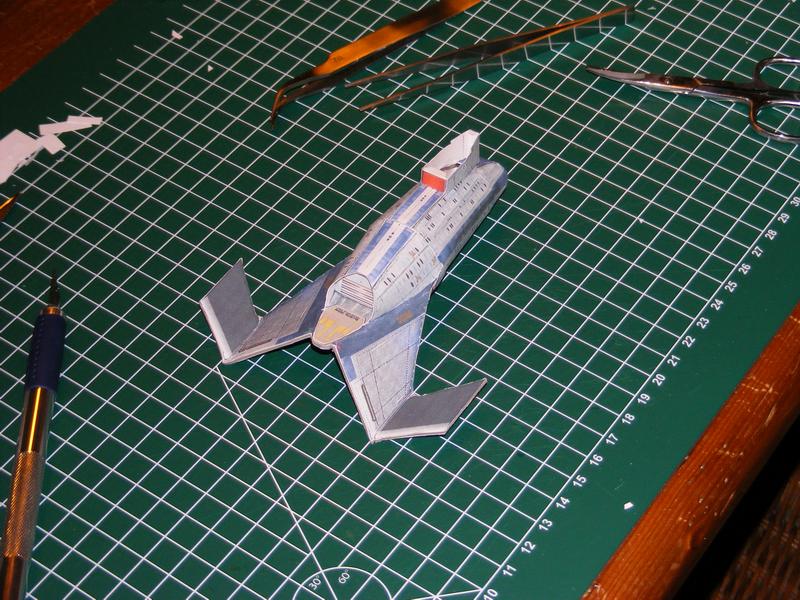

Next update, the neck episode....

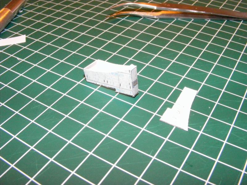

As I said I made a template for the neck part.
I used it for cutting out the right en left side of the neck, I printed some hull plating textures from another part of the model for that.
The first pictures show the assembled neck with the template laying in front of it.
I also made a custom scale impulse engine and frontside of the neck with the photon torpedo tubes.
It turned out great and after setting it to the hull I could hold the saucer on top to see if they alligned correctly, and they did ! :mrgreen:
I allready made some custom impulse engines to the saucer but forgott to take pictures of that, you'll see that in the next update when I put the top and lower part of the saucer together.
It's been a lot of work to get the neck just right, making a custom one alltogether was easier than using the excisting parts though.
I'm now going to finish up the saucer and start with the nacelles.
Cheers and thanks for all the compliments.
Elko
