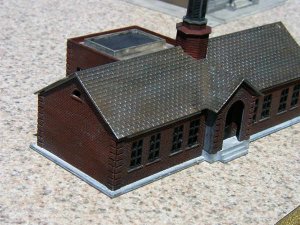

I got some "brick red" acrlyic at Wal-Mart, but the few buildings I've done, I use several shades since no brick is consistantly the same color. I finish off with an alcohol/ink wash. If it's not right, I do it again. If the paint buildup becomes too much, I wash in in alcohol and use a stiff brush to remove the paint, and start again.
here is one of my first attempts:
the color i started was box car red then kept adding roof brown to get darker color and used a thin wash (water color)of paynes gray with a dash of light yellow for mortar lines.
Looks great. I guess you have to be patient.
