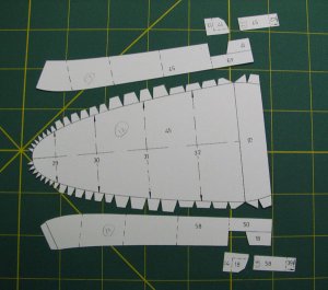

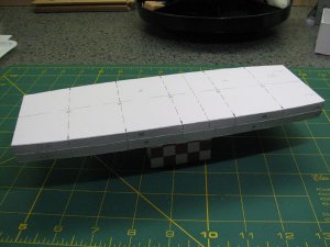

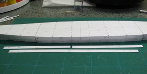

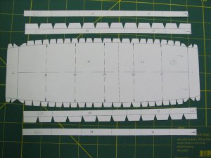

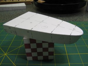

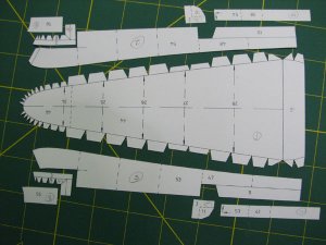

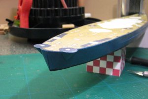

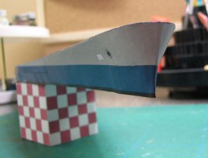

This is a simplifed hull design. It uses only card stock, there are no laminated formers. The hull is built in 3 sections and later joined. The first steps are to gather parts that form the bow section. Then do the same for the stern section, and finally the middle.

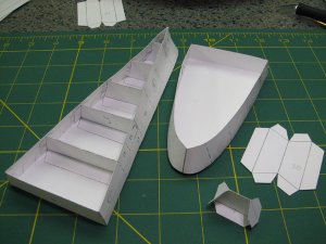

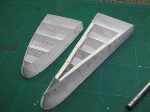

Next each of the 3 sections is flipped over and formers are inserted. The "formers" in this case are simply folded card pieces with glue tabs. This picture shows a sequence of formers going in.

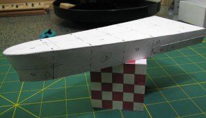

I find that in bow section, I got a lot of bowing in on the lower side, so I inserted some cardboard braces to help straighten it out a bit.

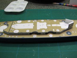

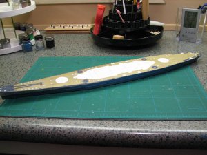

Jumping ahead a bit, the 3 sections are joined, and here we see a few parts that are used to reinforce and build up the lower half of the joined hull.

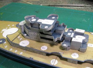

Just a little progress. Main superstructure first, then most of the fore superstructure in place.
I have noticed 3 things about this model that I don't like. First, there are color registration problems here and there. Not a big deal, but still... Second, parts fit is kinda hit and miss. Makes for some things that lean in ways that they shouldn't! Lastly, the deck and top of the main superstructure have no solid support under them. Thus the surfaces tend to be "wavy" and it's hard to stick walls and such to them solidly and without deforming them further. Just the nature of these older JSC kits I think, as others have noted similar issues. It won't be my best looking model by a long shot, but this is a "learning experience". Yeah, that's it...

You're off to a good start. The superstructure looks sharp!
I noticed the same thing about the wavy decks with the older JSC kits. What worked for me was to add some balsa wood strips longitudinally underneath the deck and between the formers. This gave the decks some extra rigidity. Worked well with my JSC KGV.
You might be able to go back and add these at this point and help stiffen your decks?
