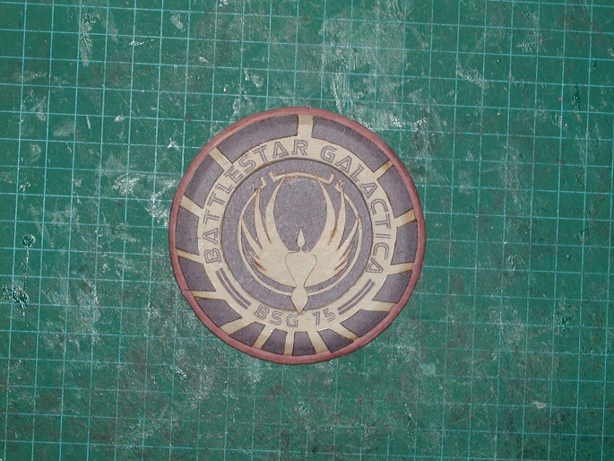

This is a little project I started fiddling with a long time ago. Well, okay, a very long time ago. But I finally pulled it to the top of the pile and have finished a beta version at least.
Here's a shot of the finished product, and a link to the beta version for anyone that would like to test build it and give me feedback. Even if you don't want to test build it, I'd still appreciate feedback.
It took me a long time to come up with textures I liked, and while they're nowhere near perfect, they look pretty decent. I still want to find better textures for the base (a polished copper kind of color) and I may just map the gold bits in the center to one of the images I've found on the web, though none are really high resolution.
The reason I haven't just mapped it to an image is that I can't find one with even lighting. I want the model to have consistent coloring so that when it's displayed, the actual lighting illuminates it, rather than having an artificial lighting.
If you have a link to a good Gold texture, or a good polished copper please share it. I have a few more ideas as well, but I'll post those later when I get around to testing them. Whenever that is.

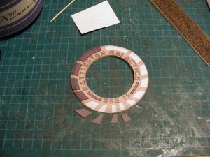

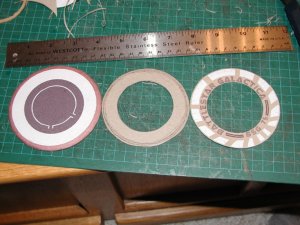

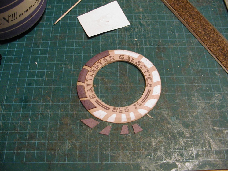

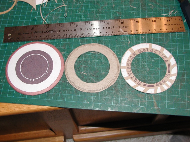

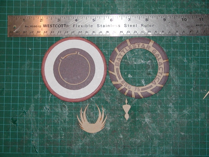

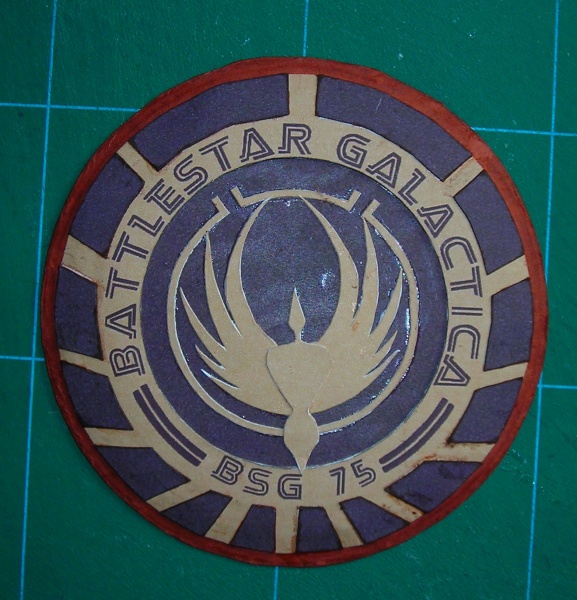

And here are a few in progress pics....

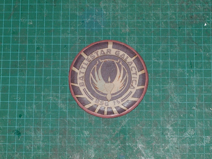

The first three show a few stages of the assembly. The fourth is the finished product as posted above.
The fifth image shows what happened when I tried to clear coat it to make it look shinier. Oops. I forgot that I had reprinted the leaf-like part in the center and not sealed it with a fixative. Unfortunately part of it discolored badly.
You may also note some darker spots here and there on the light brown areas. I didn't have an art marker that matched closely and got a few spots when I was edge coloring. One thing I think I will do to minimize that is make the whole thing a bit bigger.
Anyway, a few comments on assembly.
Included in the pattern are 4 discs, and 4 rings. The 4 discs are to build up a solid base for the bottom layer (the coppery colored one). Each of the 4 discs (and the rings too) should be laminated up to a thickness of 1 mm. Then you stack them up and glue them, and then "skin" them with the patterned part. The four rings build up a base for the lighter brown part, which then sits atop the base. This is shown in the first picture.
The detailing in the center, and the dark brown raised bits I laminated to 2 or 3 layers of cardstock. Sorry, but I honestly don't remember. Just go with whatever looks right to you.
When cutting and laminating those center details, I found I had to cut them out, laminate to another layer, cut again, then laminate again to avoid tearing them. And use a nice sharp blade! I've included extra pieces in the pattern in case of accidents.
