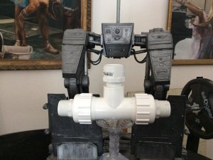

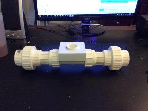

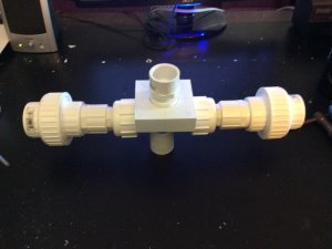

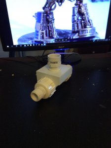

So we shall begin with the 'pelvis' which I found ready made on my local Lowes Building center where I purchased about six bucks worth of PVC pipe fittings A compression fitting Tee, a threaded coupling for the connection to the upper torso and two more for the hips connections.
Naturally all this is quite utilitarian and looks exactly what it is, some pipe fittings and there are many titans that follow this procedure and leave the fittings as is. I intend to flesh out the assembly in styrene so as to hide all the piping that will only serve as an armature or skeleton for the model.
In the image below you will get an idea of how much more robust this construct will be compared to the pelvis and hips of my Warlord.
Where as Luteus Vexant has hips trunnions about an inch in diameter 'Invictus' shall have 1.5 inch axles.
The beauty of this ready made construction technique is I shall be able pivot the waist and separate the model easily and hopefully allow the legs to be posed in a walking position as well as the spraddle-legged pose.

Basic Pelvis Block Complete:
With thsi post the basic pelvis is complete. All that is left is applying the detail. I may bevel the corners and edges to add more pizzazz as I did on the Thunderhawk but all that is cosmetic.
The Epic Imperator is very plain and you can let your imangination run wild with the amount of detail a 3 foot tall model requires. I have a good stock of City of Dead panels left over from my Warlord and I have a Fortress of Redemption to decorate the greaves if needs be.
I used 0.040 thousandths styrene to sheath the pelvis and sanded the edges smooth; there's not really much to say about the step except to take great pains to make your angles square and true. Good enough is never "Good Enough"; that's my motto.
A few extra pains taken now will save you a lot of grief later.

Two Steps Back:

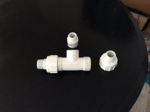

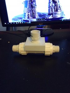

Found these dynomite compression couplings that are just made for this construct so scrap the rods and the sleeve for the nonce and work on cropping the length of the assembly.
By cutting off the octagons I managed to crop the length by about 30 MM which makes the extreme width of the hips 12.5 inches (31.75 CM) compared to my Warlord's 10.5 inches (26.67 CM) which should be just right for a scale:180 to 200 ft (54 to 61 meter) tall Emperor Titan.

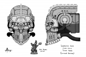

Look what I just found! Before I started this I had so-so enthusiasm for this project thinking it's worth a shot making a easy to build Emperor Titan that my readers might attempt along with me but that stops now!
I am totally jazzed about this project since I found this head. Back when I began my Warlord finding Dave Smith's Epic rendering committed me to the project. That is what finding this image has done.
Starting now I'm going to build this part full sized (as it prints out on Landscape 8.5 X 11 paper) and build the rest of the titan in proportion.
The overall size is just about an inch bigger than my Warlord's head overall so it is in keeping with my projected height for my Emperor.
This is going to be 'dynomite!' if I can accomplish it.

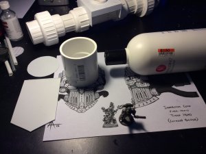

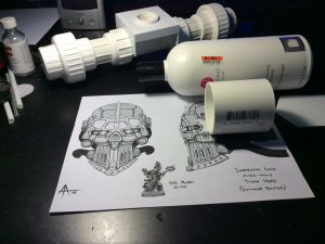

Simple As Falling Off A Log:
When I started this thread I said to myself, "I'm going to make this model as simply as I can just to see what can be done with off the shelf items readily available to the judicious builder."
I planned this so anyone can make one of these along with me.
Here we have about $25 bucks worth of plastic pipe fittings, and model styrene. A $3.50 bottle of conditioner (We just need the bottle and a bit of imagination (Supplied by your's truly :D) and a fantastic head image to work off of, all you need is a cheap printer........
So with these parts gathered there should be no problem making the head and hip components.

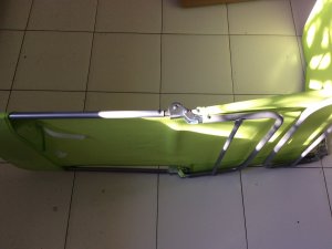

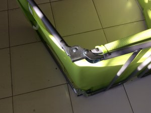

The next part is a bit of a lark on my part; you're going to need an old beach chair. We've all seen them usually tossed in the rubbish with a broken hinge mechanism but usually two or three still functioning and all we need is two.
These will form working knee joints, I hope, with a bit of ingenuity.
Of course it's not necessary to have flexing knees but since I have the chair I might as well go for the gusto. ;-)

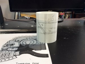

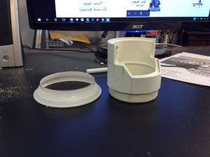

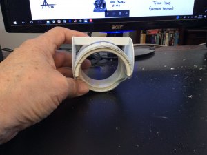

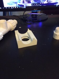

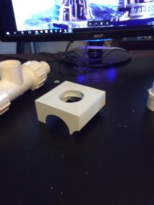

Jaw Cut Out:
Using my vibrating saw it was a simple matter cutting out the jaw recess in the coupling.
The neck is now ready for shaping and detailing.
Incidentally my Chicago Electric vibrating saw is a must have tool for hobbying;
http://www.harborfreight.com/variable-speed-oscillating-multi-tool-62867.html
This cut would be really difficult with virtually any other device other than a hand tool and my $25 dollar saw was a tremendous time saver. It took about five minutes to make this cut including the blade swap.

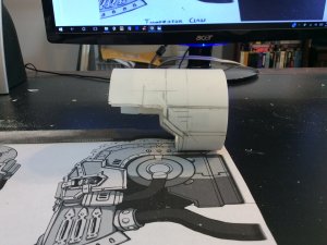

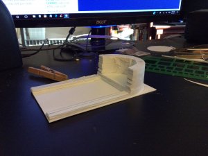

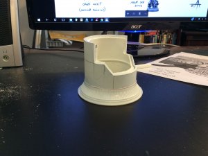

Snow Bound:
So to while away the weather front I did some work on the neck which I have to admit is coming out better than expected. I sheathed the coupling on 0.040 thousandths styrene to three layers and then proceeded to bevel the rear edges 45° as in the drawing.
As you can see below there is quite a bit of cutting to get the 45° bevel in the front edge ............
but my 'Farmers file' was up to the task.
The forward bevel needs to be refined but is okay for the moment while I make the inner neck mechanism so the head can be tilted down. My previous Warlord has this capability but the mechanism is very clunky and I am hoping to refine it on this model.

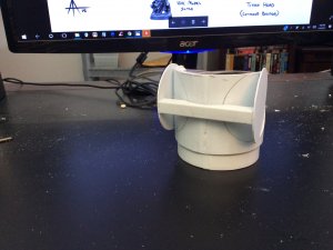

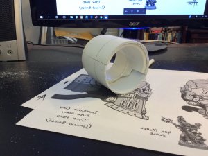

Finally I found this collar that will work very well in the scheme I have in mind for the side to side movement of the head and fits into the Emperor design quite well.
Can anyone guess the source of this wondeous bit of sculpting?

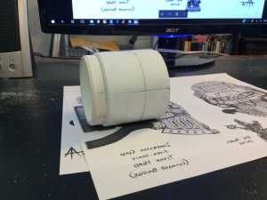

2D vs 3D

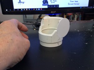

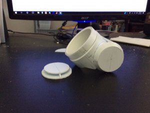

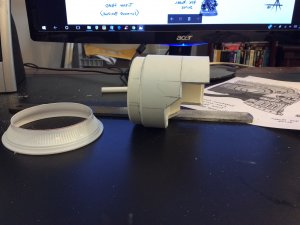

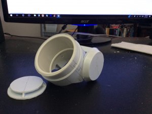

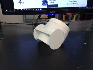

I'm getting way ahead of myself with this head assembly so I put the brakes on to pitch an update. After scraping my initial idea of how the head assembly can tip forward on the neck I came up with this solution which will give me a lot more cockpit room for the crew. There also is a poetic license taken by the artist who drew the front and side reliefs of the Command Bridge. The huge ear discs that contain the head tilting mechanism cannot function as drawn and are of different sizes in the drawing. Never mind though, I have a solution.
I'll start with cutting the forward neck ring to allow the discs to mount flat to the sides of the neck.
Carving out an outer race for the gimbal head mount pad and gluing on the gimbal bases is what is shown here. The two 0.040th inch discs are 71 MM apart and 56 MM in diameter.
The bridge truss maintains the distance and keeps the gimbals square to each other and stabilizes the bases
Bottom view showing the forward ring carved out to accommodate the gimbal bases.
Next, the manufacture of the gimbals mounts. (The area left black in the 2D drawing.)

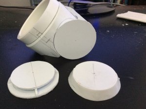

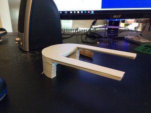

Gimbals:
Or Trunnions whatever, These truncated discs will support the head on the neck to allow it to look down in a purely theatrical way as a downward pointing camera would be just as effective but the menace of this skull staring down at it's victim is too good to pass up.
Above; the disc is a simple truncated construct featuring two circles 45,0 and 54,0 MM separated by 2,0 MM by 4,8 MM styrene spacers.
Unfortunately I got the angle wrong so I have to re-sheath the bevel but that's not a big deal.
Tomorrow I hope to be working on the cockpit.

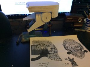

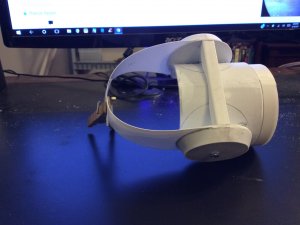

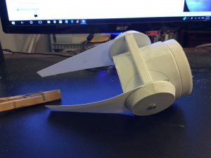

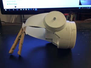

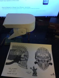

The Visor:
Allowing for the helmet I mounted the gimbals with extended visor mounts made of 0.015 thousandths sheet styrene. As I don't really have a plan for the cockpit, chin or gullet piece all this is subject to change but at least now I understand how the cheek pieces work with the gimbals.
I suppose the best thing is to cut the helmet to see where it falls in relation to the ears (gimbals) and the amount of clearance required to allow the head to lower and raise.
Somehow I managed to guess right which moving part eclipses which and for that I am grateful.
Later on this evening I'll cut the helmet but I need to relax a bit after this thoroughly draining exercise in design. Martini Time!!!!!

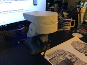

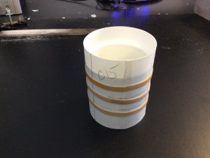

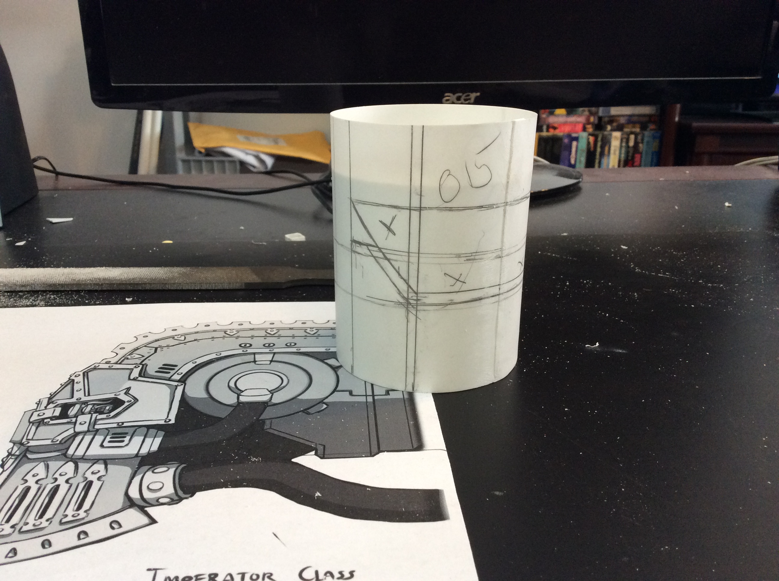

Helmet:
My initial thought was to use a suitably shaped bottle to form the helmet but after experimentation I found that was unsatisfactory for my obsessive compulsive mindset. I opted instead for building up the helmet out of stratified layers of styrene and cutting the helmet out of the resulting block in much the same manner as I did for my Warlord Titan
This also relieves me of the necessity of finding a suitable glue for mating the different sources of plastic......
It's bad enough that I had already go through the identical thought processes in making my Warlord but to have not learned for my previous effort defies logic. :(

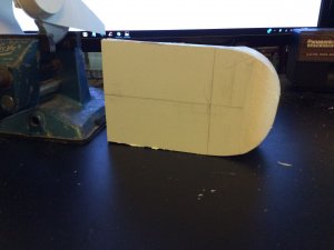

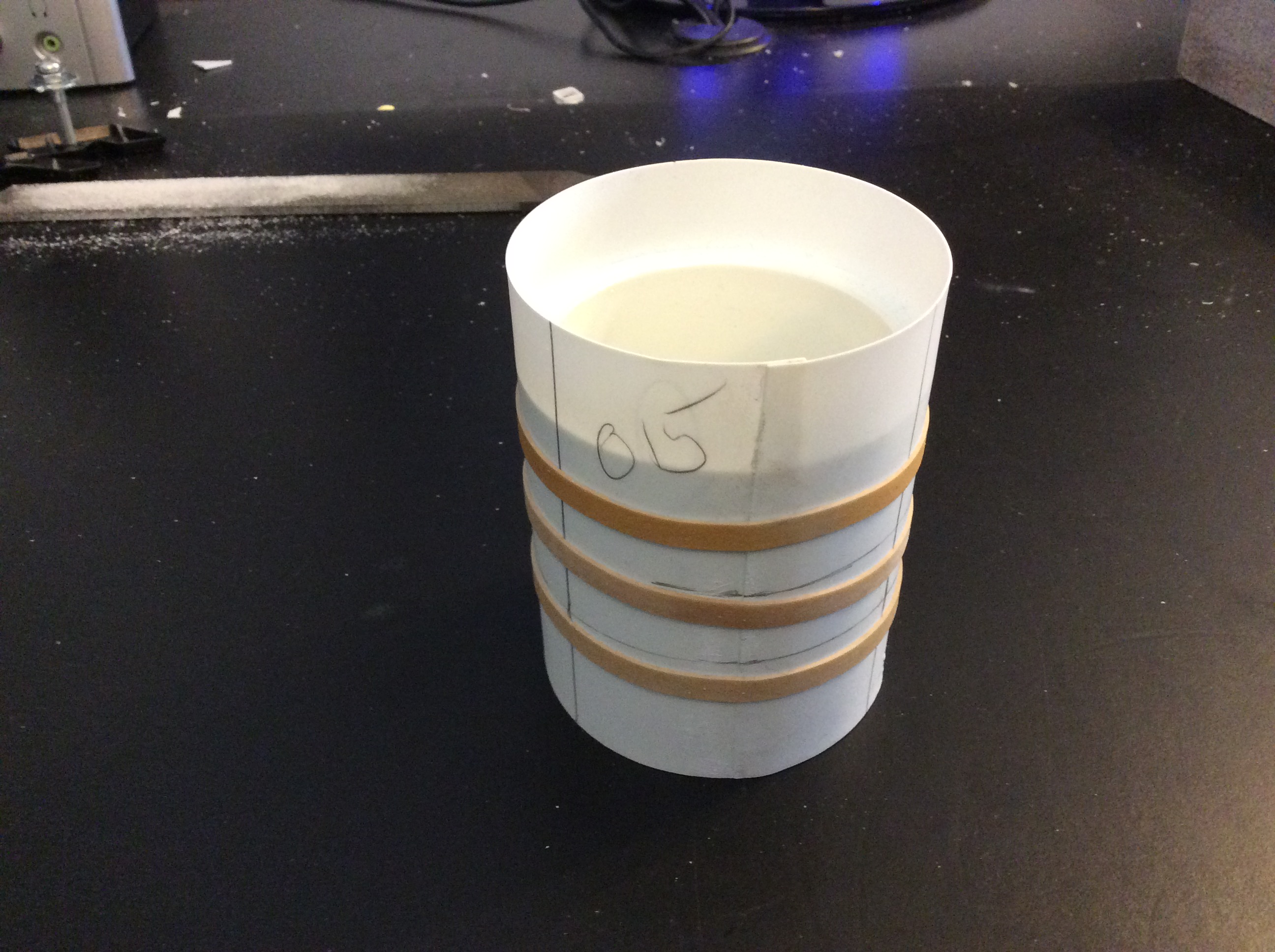

Ready To Begin Shaping:
The layering is complete and all needs be done is the shaping
I made the helmet about an eighth inch over sized per inch to allow for carving and sanding
Tomorrow I should be well along on the paring down to the rough dimensions.
Thanks for the reply,

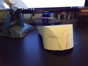

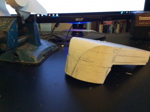

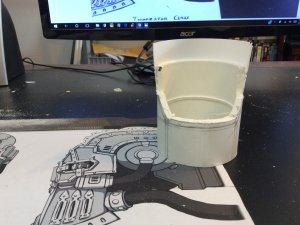

First and Second Contour Cuts:
Most of which are done on a stationary belt sander.
One more preliminary contour cut to make.....
The sides have to be rough sanded at about 45° before the finishing contour sanding.
