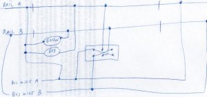

Jim, You had me doubting myself for a second. The lamps work fine because it is either connected across the two rails, and will light, or is connected to the same rail, so it won't. I tried it. Here is a crude drawing. Leds would work just as well. But I have only used single color leds, not bicolor. Also, you can use the position of the toggle handle to indicate which end the reverse section will match.

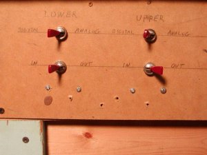

Here's a picture of a panel almost as crude as my drawing. I built it to allow operation of analog locos on my bottom level mainline. Basically the layout on the bottom level consists of a double track mainline with staging reverse loops at each end. One end has three reverse blocks, the other 5. I made one of the blocks at each end able to bypass the auto reverser (the digital/analog switch) When in analog, the other switch is in the circuit, and aligns the polarity of the reverse block with either the inbound or outbound end. This is what I referred to in my last post, using the handle of a toggle to indicate which way the polarity is set. Wouldn't have been hard to install lights or leds but I felt it wasn't needed. BTW, after using the toggles initially, they haven't been used in years, I don't want to throw toggles! I just don't run analog except to test prior to decoder installation, so don't need to run them into the reverse blocks. Hope some of this helps.

Gary, great help. It will be much easier to stick with bulbs than diodes and your circuit having oner bulb across the gap (red) and the other (green) across the tracks, will not only do the job but be much simpler & cheaper.
Thanks for solving my problem that has been festering for quite a while.
Thanks, Jim
