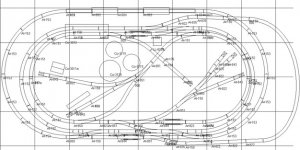

I've chosen this layout to build, but, there isn't any details on placement for power terminals and insulators, nor any info on how to wire the switches.
So, Here's what I'm looking for. I'm looking to wire this system for NON DCC operation with the ability to upgrade it in the future to DCC (without having to re-do my insulators and terminals).. Also, I would like to know, when it's appropriate to use a Snap-Relay with the Snap-Switches..
Note: Someone in this forum has built this layout as that's were I got the original from, but, I plan on making the scenery completely different including having a small river run through the layout. This layout is probably more than a newbie needs to start out with, but, I'm ambitious.

Connor,
The only thing you have to absolutely get right is that reversing loop on the inner most oval.
Other than that it becomes a question of how many trains do you wish to run at once?
Toss out that answer and someone might suggest a way of breaking the layout into blocks.

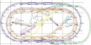

Here is another copy of my layout color coded with multiple lines. This is how I'm thinking of breaking it up..

Too many colors for my old eyes to handle.
Are those small blocks to be used as places to stop a loco? If so they could be connected to the adjacent block and a simple dpst or spst switch could be used to kill the power. I'm not saying they have to be done that way, just that they can.
I think you should have those ovals split a bit more. Basically the idea is to block at the switches, after you leave the frog end a new block starts.
What system did you use to render and color that layout? I'm still playing with design software and what I want for my layout. I have a basic idea and (too) many possibilities. Multiple fallen flags and still operating roads and a pile of interconecting junctions. I have a large if currently somewhat train unfriendly basement.
I can render a higher quailty image that'll be easier to see, just couldn't upload it, too large. I'm using the Altas RTS software to render the color's, Took me a while to figure it all out.. I ended up have to disconnect all my track color code it, then re-connect because it wanted to color the whole thing the same color otherwise. Yes, the spurs are to be used to stop loco's and that's why they're color coded, most likly feeding from the yellow line (reversing sectioin) or possible a number of differnt lines using some switch magic. I'm thinking this layout should have 4 cab controlls (3 for the main lines,1 for the switch-yard and reverse section) I'm using atlas track with non-powered frogs, so, I really don't understand whats needed at the switches. I figured breaking them up where I did was best..

The size of the image isn't what causes me problems it is too many colors. They tend to distract me.
Basicly all I've ever done when it comes to blocking a layout is to follow a really simple rule that starts a block at the frog end of a turnout and to electricaly bond the point end. This rule is relaxed somewhat in yards by combining what would be very small blocks usually consisting of ladder turnouts. This means that there are four insulated joints at each turnout and they are all on the frog end. This is a simple method to follow. I've also added a couple of pockets on switches to allow parking of locos.
I haven't priced switches lately and shudder to think of the cost for a large number of cabs which is why I mentioned jacks & plugs instead of selector switches. There are all kinds of trade offs. The saving grace is that you can always add a block or combine adjacent blocks after you have tried the layout in an operational setting.
I guess the switch stuff is what's confusing me.. I've been reading a Atlas book on how to wire stuff.. and in my layout, I've got the switches isolated on the frog side on the curve. The straight part of the turnout will be continuous. (I'll be using Atlas Snap-Switches and Turnouts which means no powered frogs)
