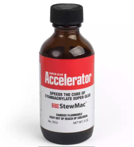

I glued a piece of cast iron that broke off of an alternator pulley on my '73 M.G., and 40 years later, and 10s of thousands of miles, it's still holding. I did use an accelerant with the CA Glue. It can be amazing a glue, but I only use it on automobiles, and outside. ;)
