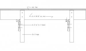

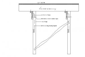

Just one problem with that type of construction for my purposes. I am going to have to take this whole thing down someday and get it up the basement stairs. I will need to be able to take the leg assemblies off the "table-top" to accomplish this.
I was thinking of building "self-contained" leg assemblies that would bolt on to the 1x4 cross supports of the top. Something like the attached pic. What do you think?
:D Val

Hey Val:
The diagonal bracing runs up, away from you in this view, and is bolted to the L-girder and the leg. You can unbolt the brace at the leg, loosen the one leg bolt at the "L", and fold them both up under the table. 'Course, you can always unbolt them using the other scheme as well. You may want to add one diagonal brace between the legs, i sketched this in using "paint", if the wall doesn't provide enough support.
I think once you bolt or c-clamp your 3 modules together you'll find they're plenty sturdy. Our individual 2x 4 modules wobble like a one year old's legs, but c-clamp 'em together and they firm up pretty good.
Regards,
Ted
