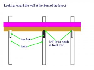

Here is what I am thinking: Build the grid so it sits flat on a table... all the gridwork is the same size. Now, with the long shelf brackets, the front is about 3/8" higher than the back where the bracket attaches to the track. The front 1x2 of the gridwork could be notched at each place where it passes over a bracket as in the following drawing...

Interesting idea Gary, and another variation on what seems to be approaching a final approach. (1/2 dozen....! ;) )
However, I would still recommend modifications to the bracket in order to support a standard "module". Modifying every module seems harder to do, and have bigger complications should you not get it quite right...

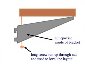

here's another idea, as long as we are coming up with ideas....
Now that is cool - and would allow you to adjust as you go... NICE!
I think you have a winner...! :thumb: :thumb:
When I get around to mounting my modules on the wall (legs for club meets only) THAT is what I am going to do.
:cool: :cool: :cool:
Andrew
you could actually put two nuts inside the bracket, one at the top and one at the bottom, epoxy them in (have the long screw threaded in both nuts with some grease on it so the epoxy doesn't stick to the screw)
this would make the screw more stable. also, you could put a washer and locknut at the top and tighten it down against the bracket to make everything solid

Gary: after all this time, I want to suggest that you not have the brackets too individual. A design that lets you interchange them will be easy to work with.
However, you may want an adjustment bolt on the front of some of the brackets. I've put up those shelves and lining up 20 feet of the wall thingies gives you loads of opportunities to get a few not at the same height.

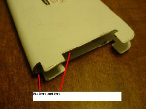

I thought I should post a follow-up to this thread, just in case anyone else is considering using the shelving brackets for a layout support sustem.
Reminder of problem: The longer shelf brackets are built with a 3/8" rise from the back to the front. We were discussing ways to fix this.
What I ended up doing was filing some of the metal off the wall end of the bracket. This lets the bracket tilt down a bit at the front, making it level. I did the filing with a hand file. It doesn't take much. It also doesn't hurt to "pre-weight" each bracket while it is installed in the rail, just to seat everything and knock off any paint blobs that may be holding the bracket higher than normal. I tested the bracket in the rail with a level quite often as I was filing.
I still like the idea of adding a nut and screw to the bracket for leveling purposes though to tell you the truth.
