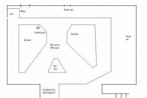

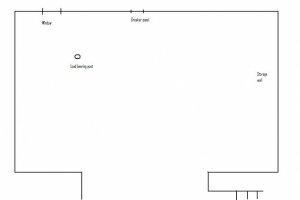

I have an area that is 14'x15' inside a room that is 18'x17', With 1 exception, the room is without encumbrances. The exception is one corner needs to be cut off for the sake of passing between the layout and a wall.
I am having a hard time figuring out what benchwork design will give me the best use of the space.
The crux of the situation is a yard that I want to include in the track design. It is in the shape of a triangle, and needs to have enough space for steam engine servicing, a large roundhouse and a 90' turntable. I have no idea how to compress this configuration into a workable yard design without using too much space.
I figured that I would turn to the trackplanning gurus.
If anyone has a suggestion, I would be very pleased to hear it.
Thanks,
Matt
I will try to do a drawing of the available space.
The room, for the most part has only 3 walls. 1 is earmarked for storage, the other has a low window and the breaker panel, rendering it off limits.
I will whip something up with Paint, but it won't be pretty.
Will post it in a minute or 10.
Thanks,
Matt
Attached is a rough representation of the room, done with Paint, and a prototype photo of the yard I am hoping to compress.

It is in a basement, so the window does not need to be a fire escape route as there is another window on the opposite side of the basement.
Ok, so you could build 24 to 30" tables against three walls and a center peninsula. What will hurt will be that helix. It would take 4 to 6' square just for that.
Loren
