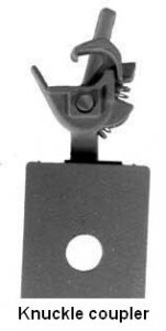

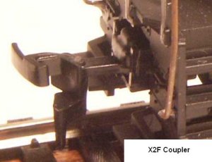

Coupler types attached below. Which ones do you have?

The pins coming down from the coupler are designed to be squeezed together as they were pulled or pushed thru an uncoupling ramp made for them. When slack was given in the train, they would push apart far enough to pull away, leaving the car behind in the siding. It was a good, if not ugly and not entirely reliable way to do switching in a day when there were 7-8 different couplers out there.

jej34:
The knuckle couplers that comes with Athearns use an tiny spur of plastic to keep the knuckle closed. Problem with that particular knuckle coupler is that the plastic spur sometimes do not provide enough spring tension to keep the knuckle closed well enough, which means the cars can uncouple on curves.
I would advise you to change to a better knuckle coupler. Get some Kadee couplers, which uses a much more reliable brass spring to keep the knuckles closed. Those keep my cars coupled, and this is on 18" curves (and yes, most of my rolling stock is Athearn retrofitted with Kadees).

I have the one on the right. Looks like the knuckle coupler
Most knuckle types come with plastic spring work that fails very easily in storage. As Tom says, your best bet is to replace them with Kadees, #5s most likely, hopefully you have a hobby shop nearby.

Sounds like the earlier knuckles from about 8 years ago that had plastic springs to close the knuckles. In storage, they would be held open and the plastic would "memorize" this and never close again.
