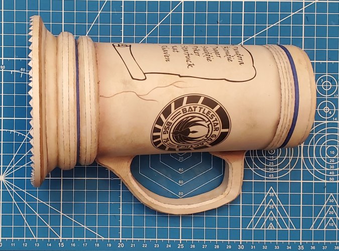

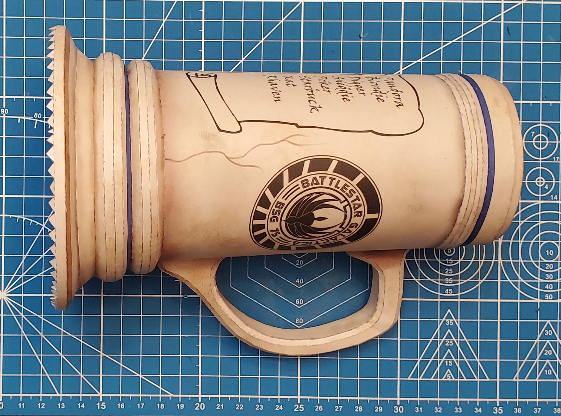

I am making the Battlestar Galactica "TOP GUN" stein (designed by @Revell-Fan).

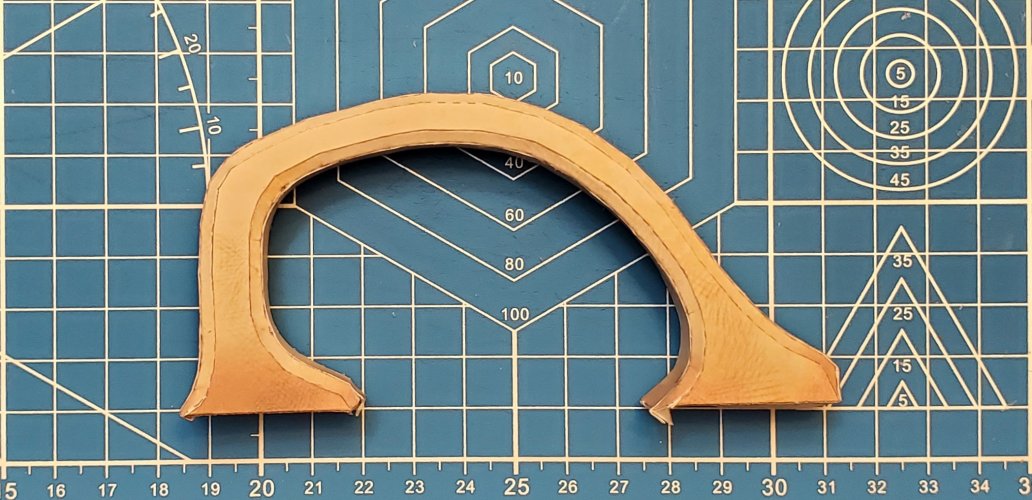

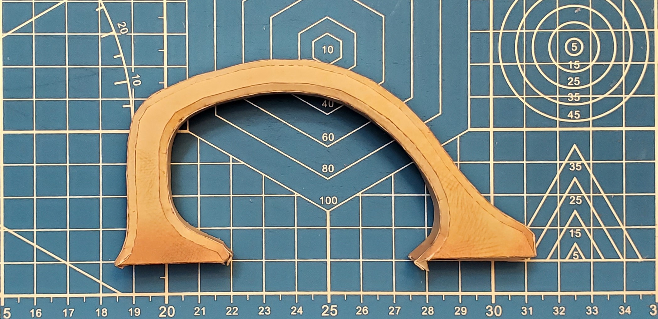

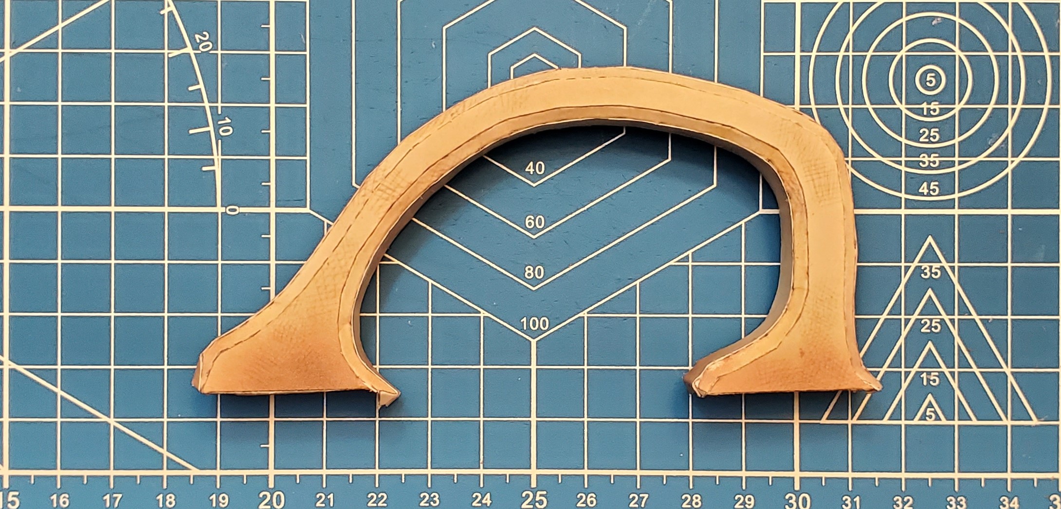

Starting with the handle. Here are the parts for the handle.

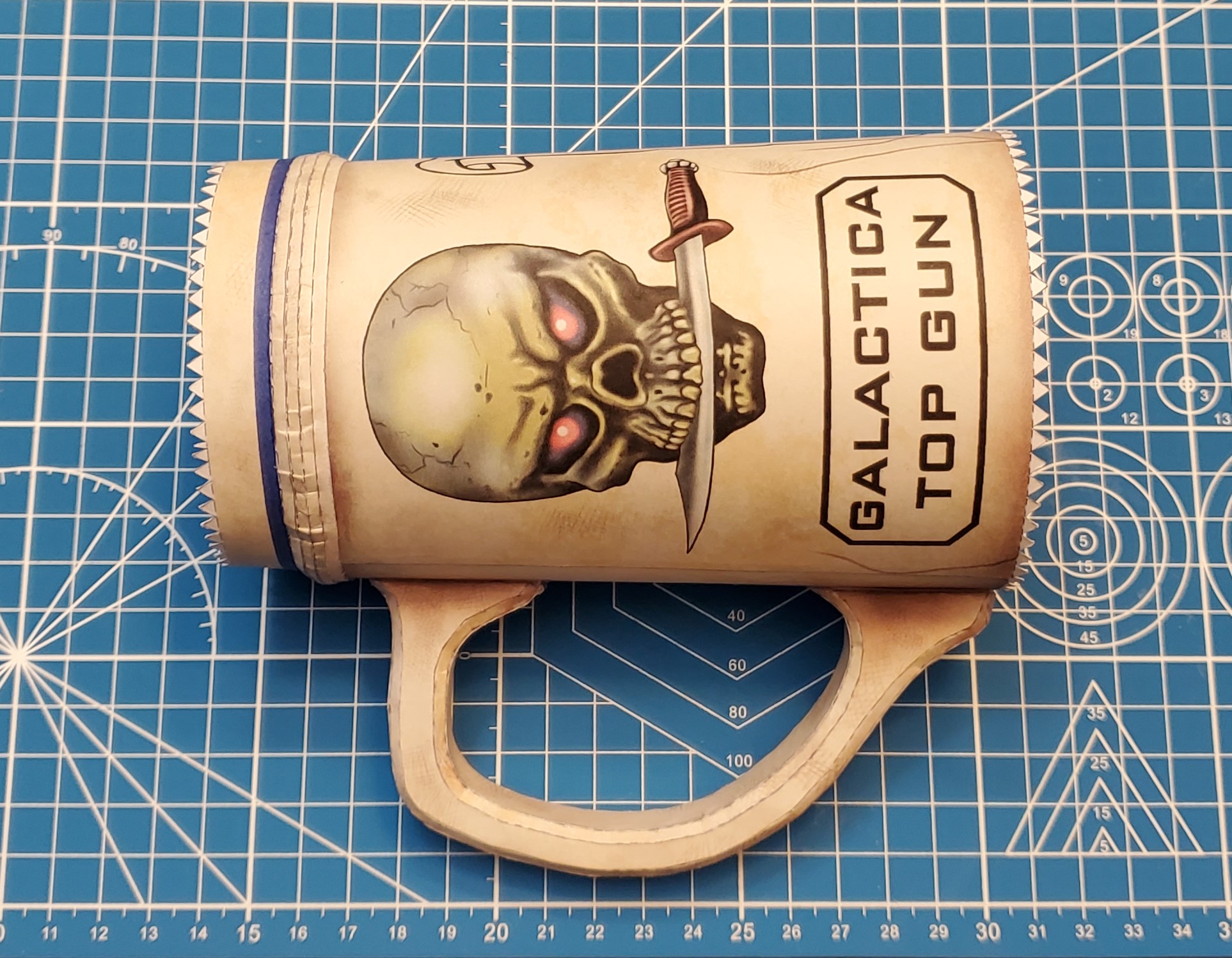

The handle is assembled. (*NOTE* Follow both the text and pictorial instructions closely. Otherwise, parts will be out of alignment or the handle will warp.)

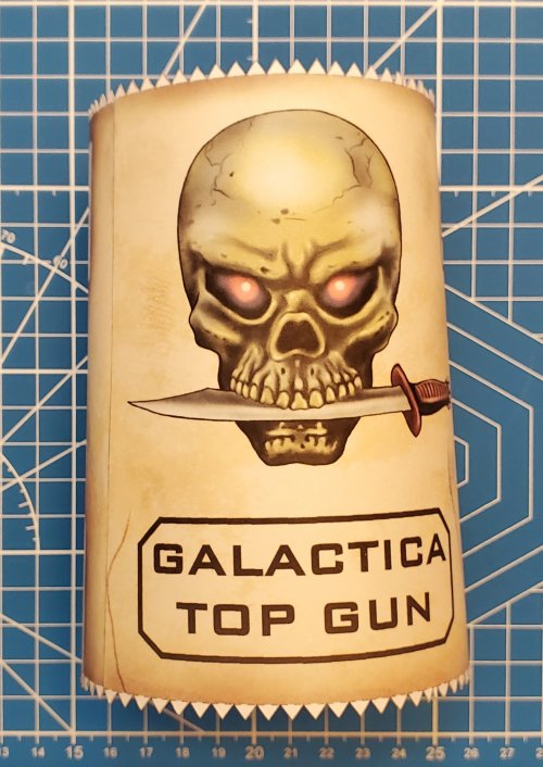

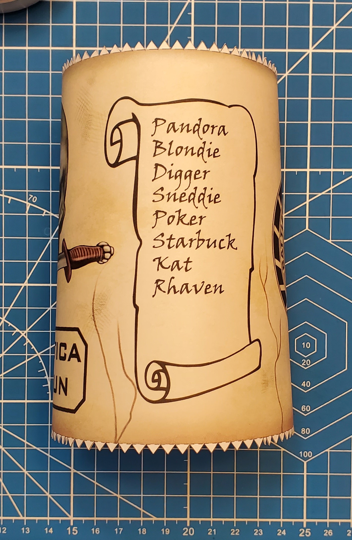

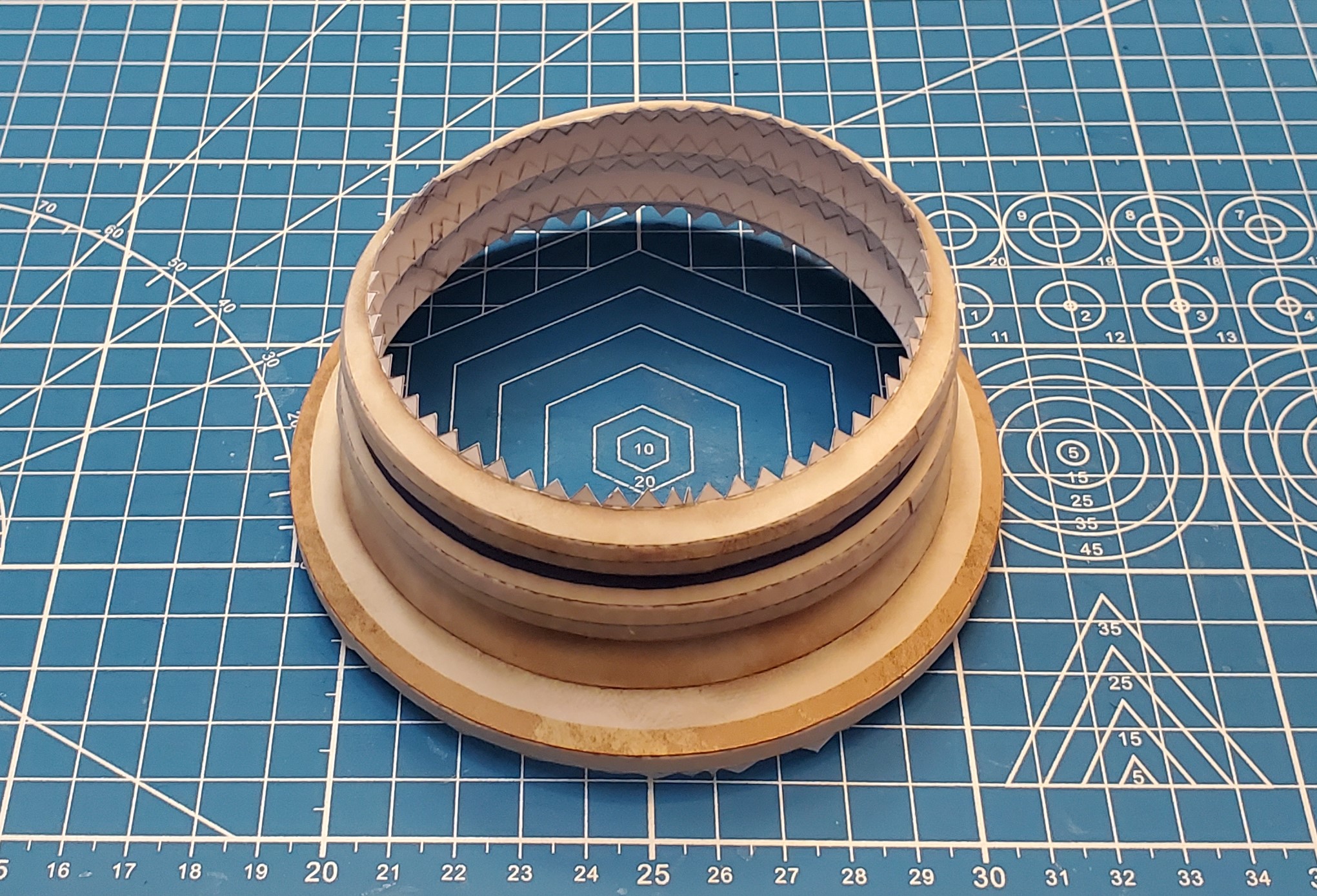

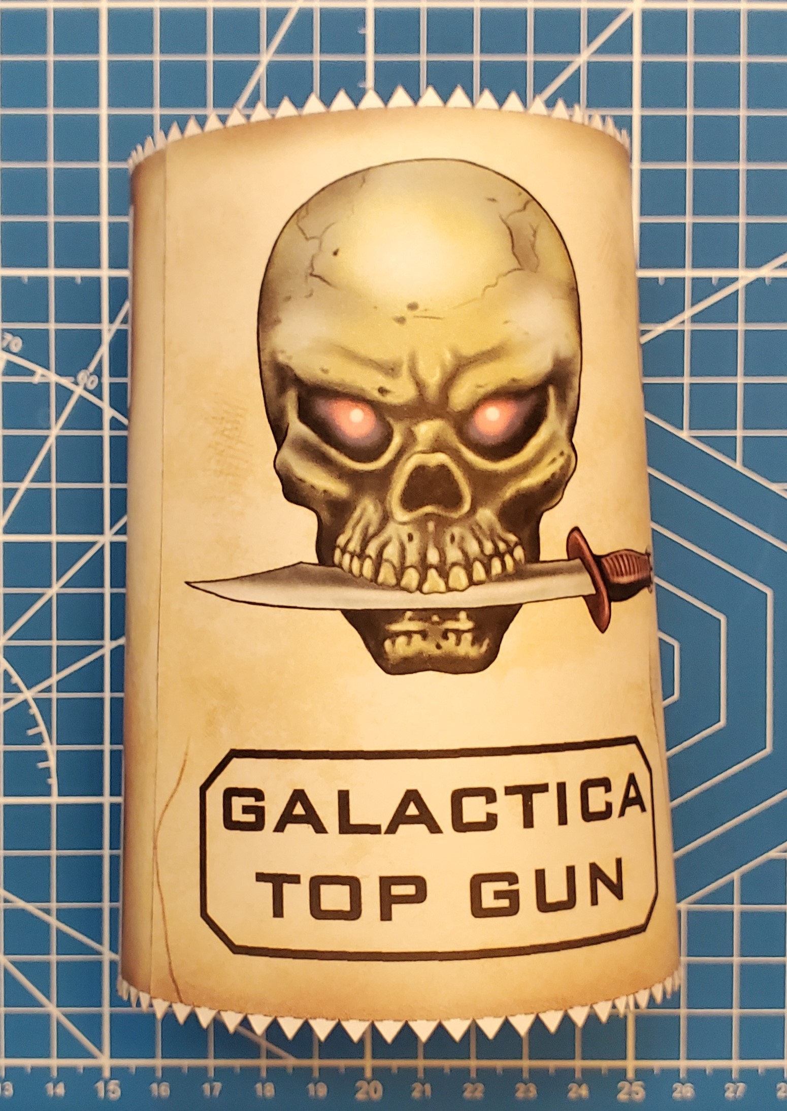

Here are the parts for the main body of the stein.
The main body of the stein is assembled.

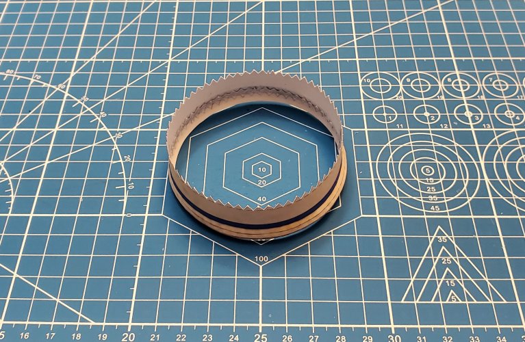

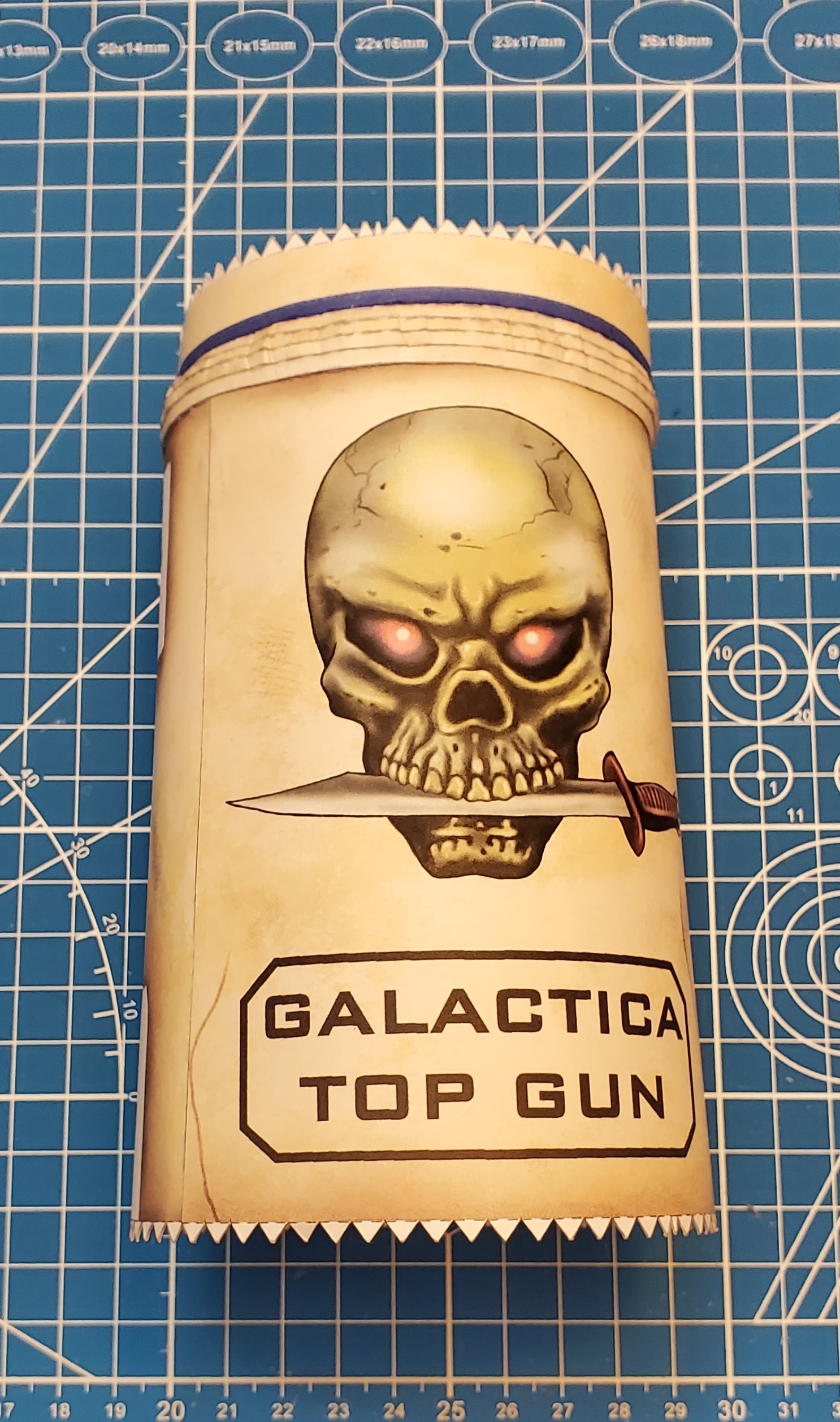

Here are the parts for the top section of the body of the stein.
The the top section of the body of the stein is assembled.

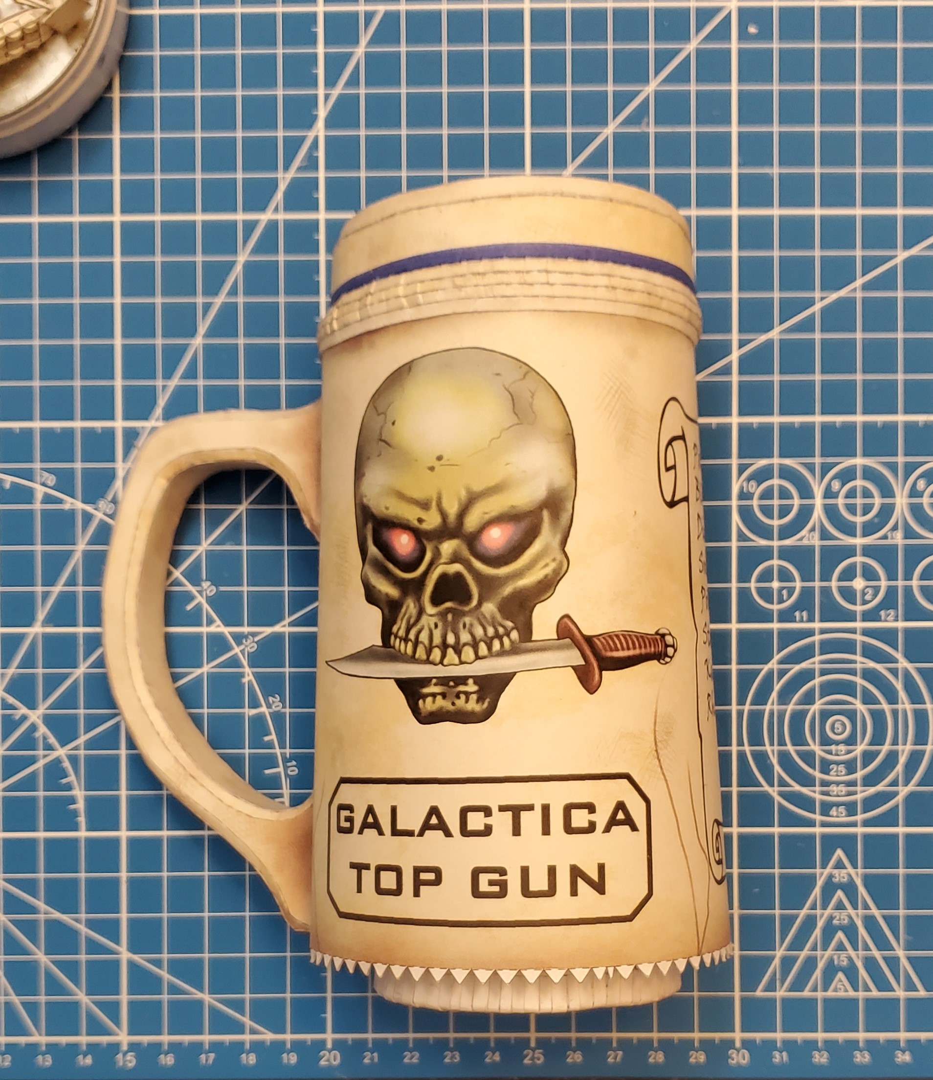

The the top section of the body of the stein is attached to the main body of the stein.
The handle is attached.

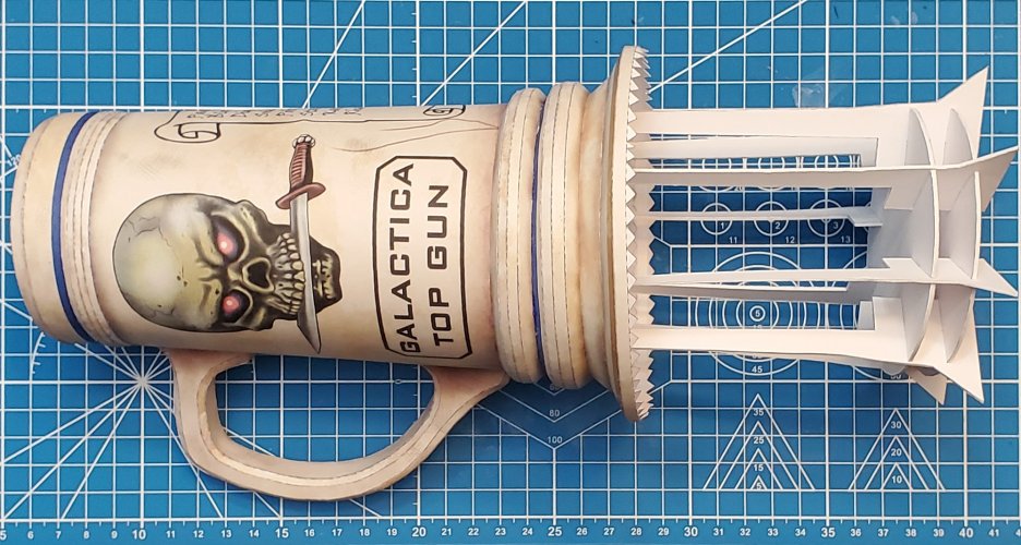

I completed the model in 2012 and it went into my archive. Last summer I thought it was too nice not to be shared with all of you. When RB made the test build he found out that something was wrong. After a tough research I found out that somehow the parts for the inner tube were the wrong size. The layer must have been disproportionately resized somewhere between 2012 and 2022 which really puzzled me (the canvas size was fine though which was the reason the error eluded me). Fortunately I still had saved all development files which allowed me to fix that. Unfortunately I forgot to check the cutout of part 23 which I enlarged to make the (then wong) inner tube fit. That's the only issue we encountered and which had to be fixed. Really, nothing wild.
However, while we were at it we noticed that there was still one area which could be improved: there was no support between the outer hull and the inner tube. So if you picked up the stein on the body and not on the handle you might squeeze the hull together a little which might create a dent by accident if you weren't careful enough. So we were thinking about it and came up with a new set of formers 20 minutes later. The array looks like an octopus embracing the inner tube. It is inserted from the bottom. To allow it to do so the two rings 22 were eliminated and all hull parts were combined. There is no division between foot and body any longer. Once I receive the new pictures from Chris the template will be updated and released. :)

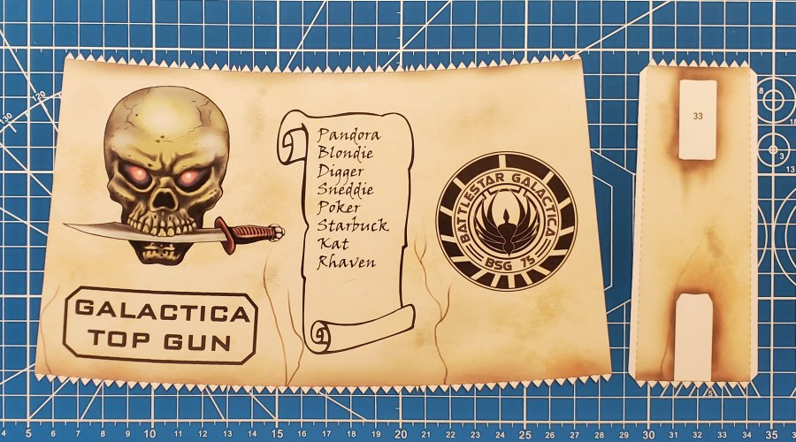

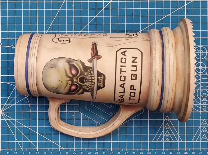

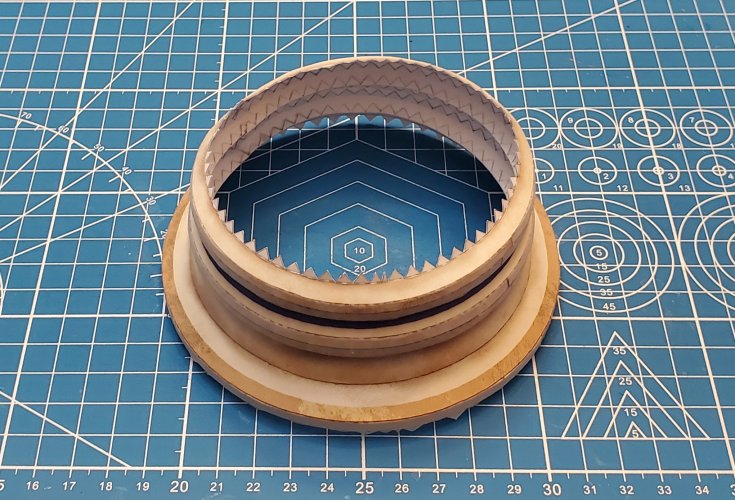

FINALLY! (After dealing with a few minor mishaps) I am now able to post an update.

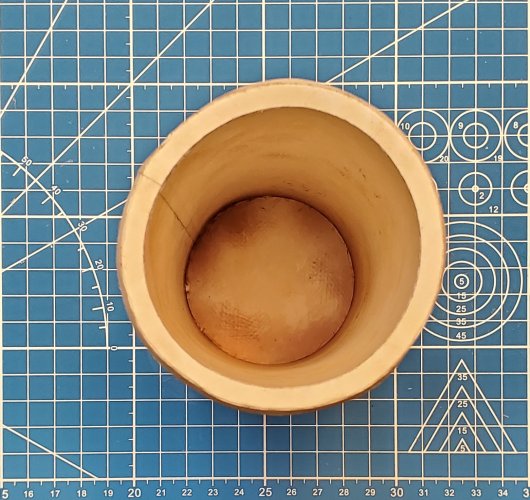

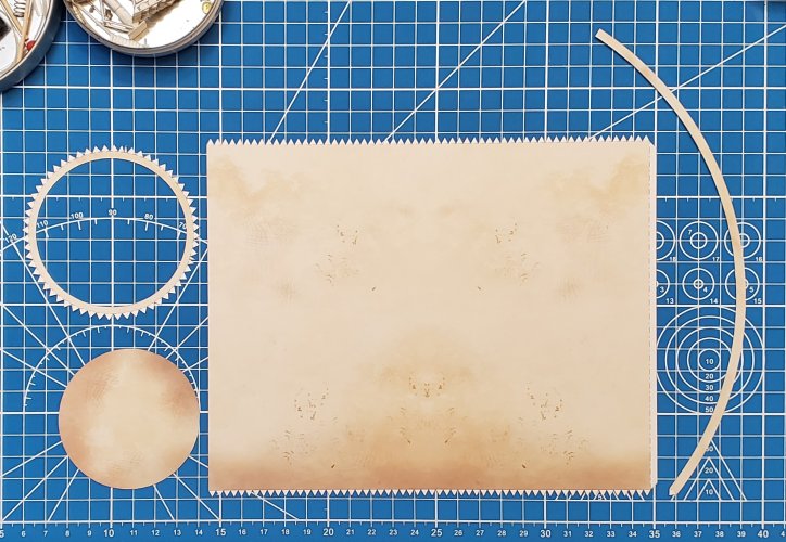

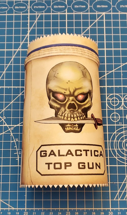

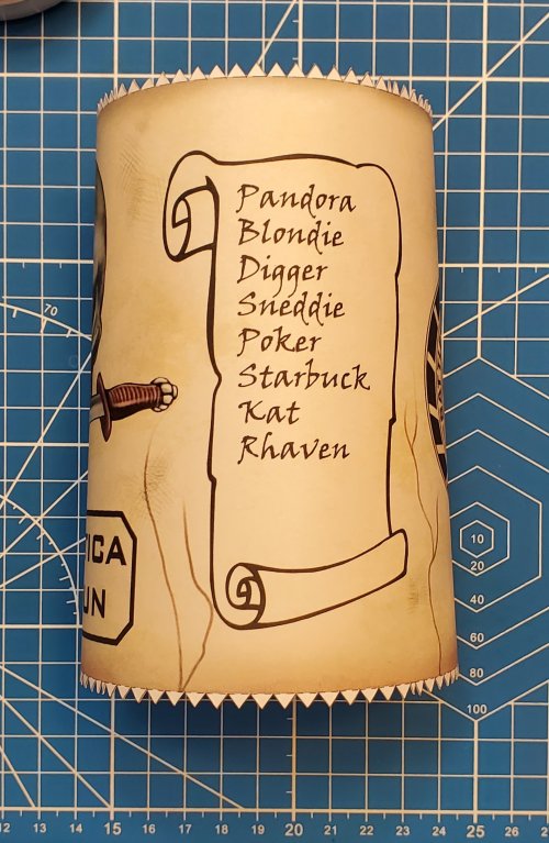

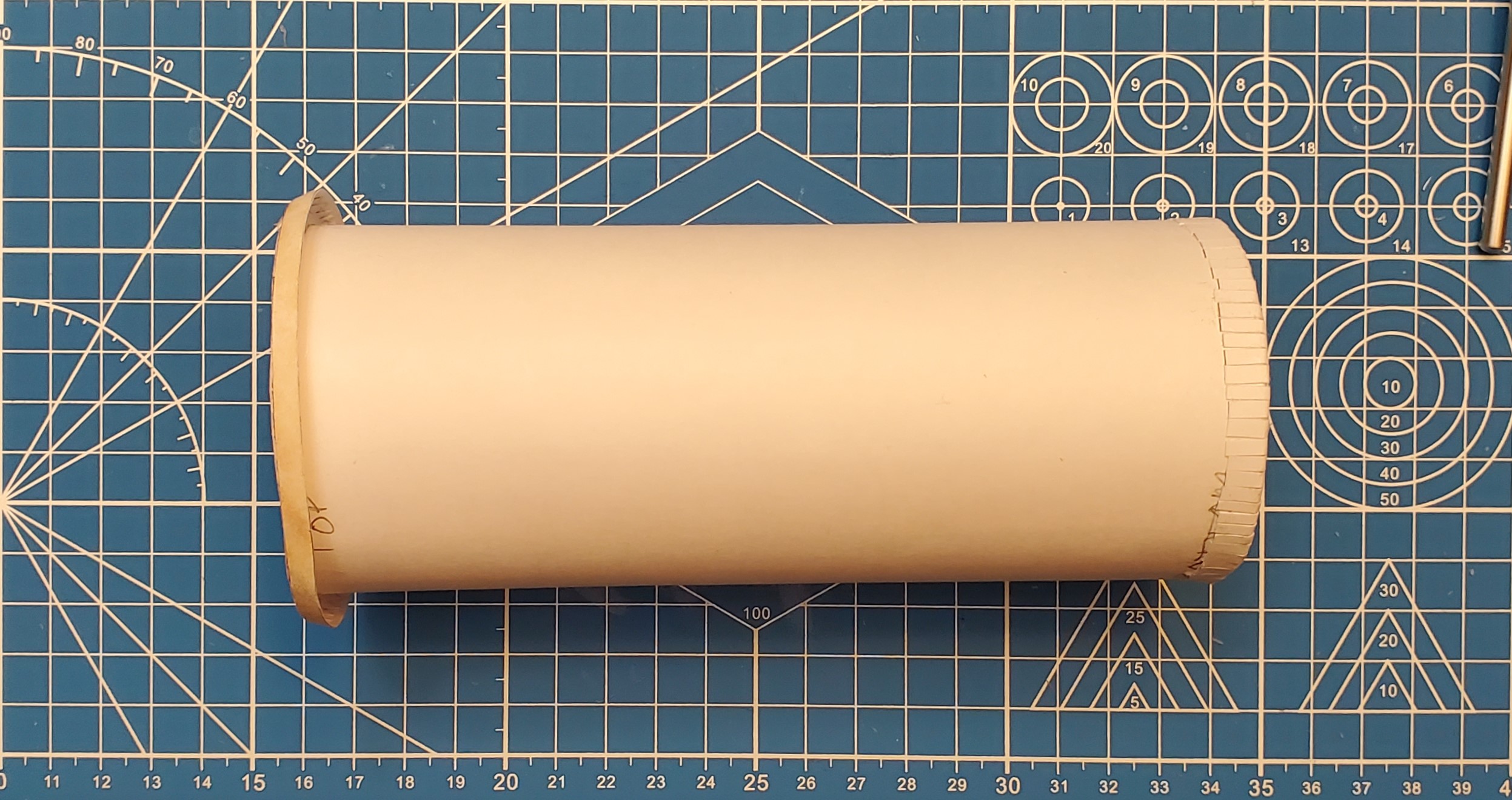

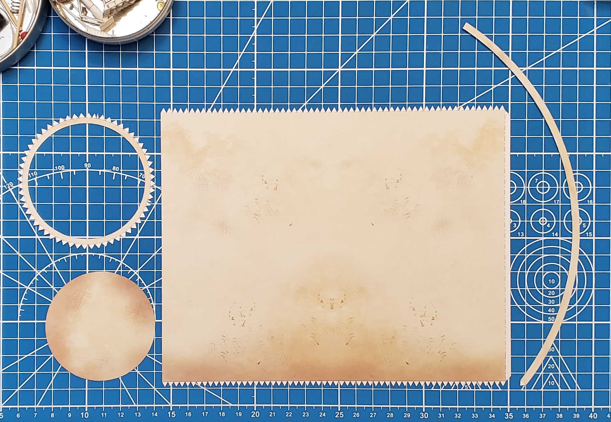

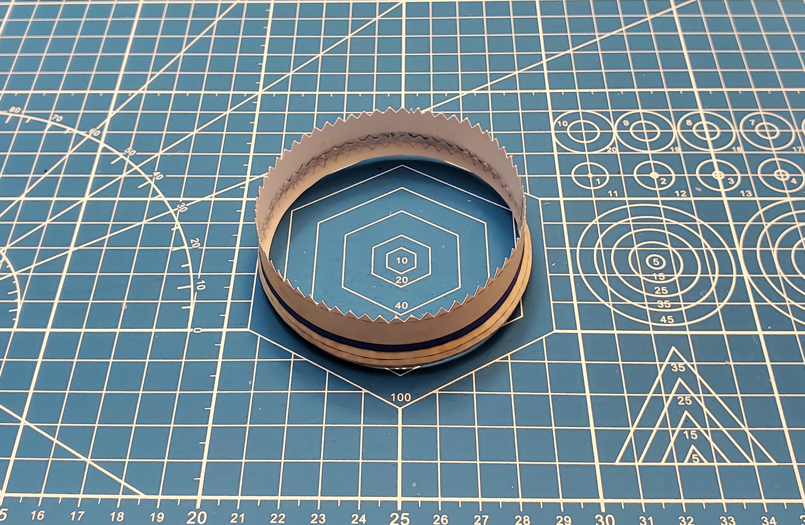

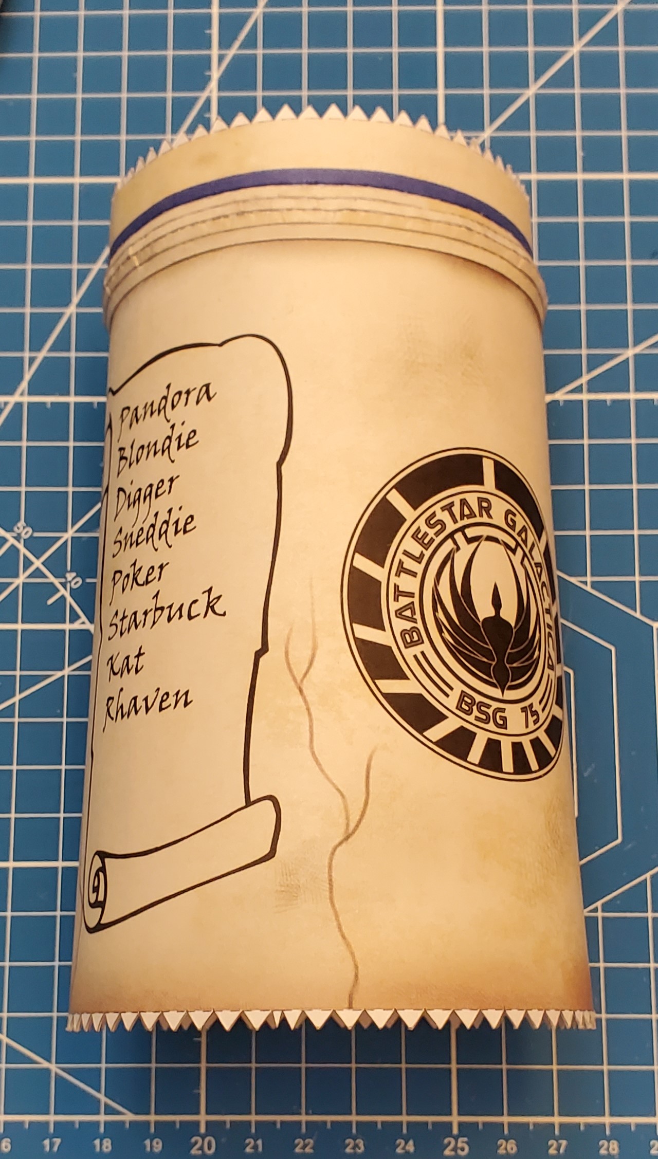

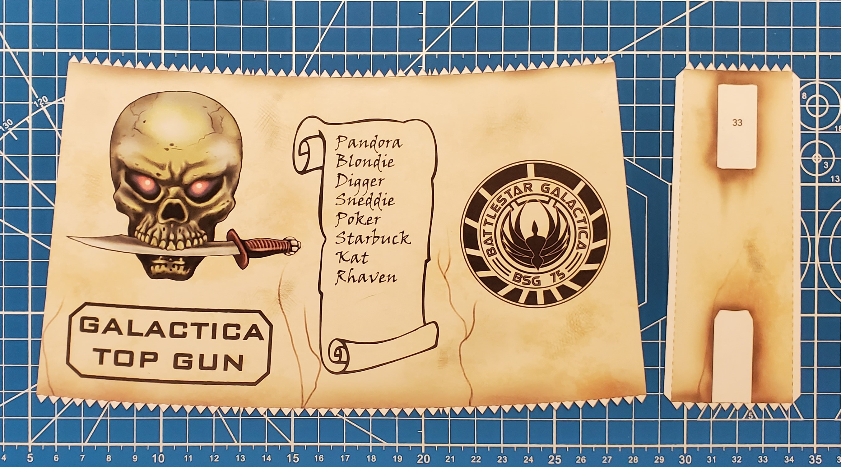

Starting with the interior tube body of the stein. Here are the parts.

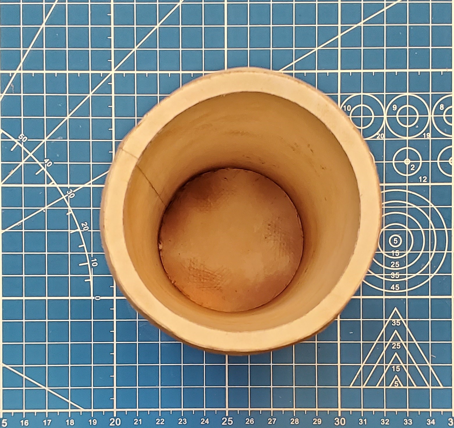

The interior tube body of the stein is assembled.

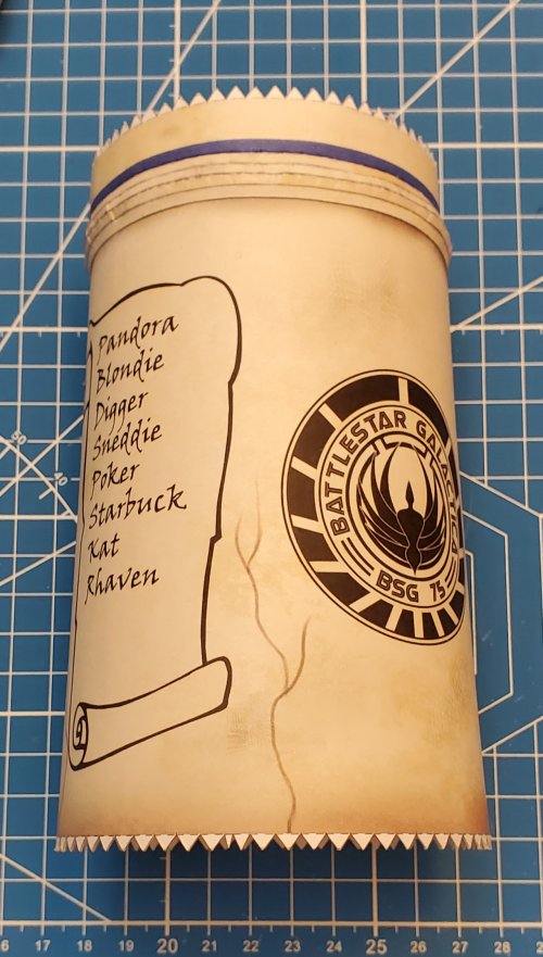

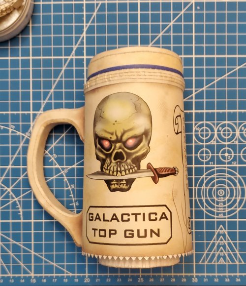

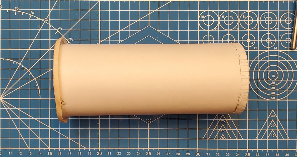

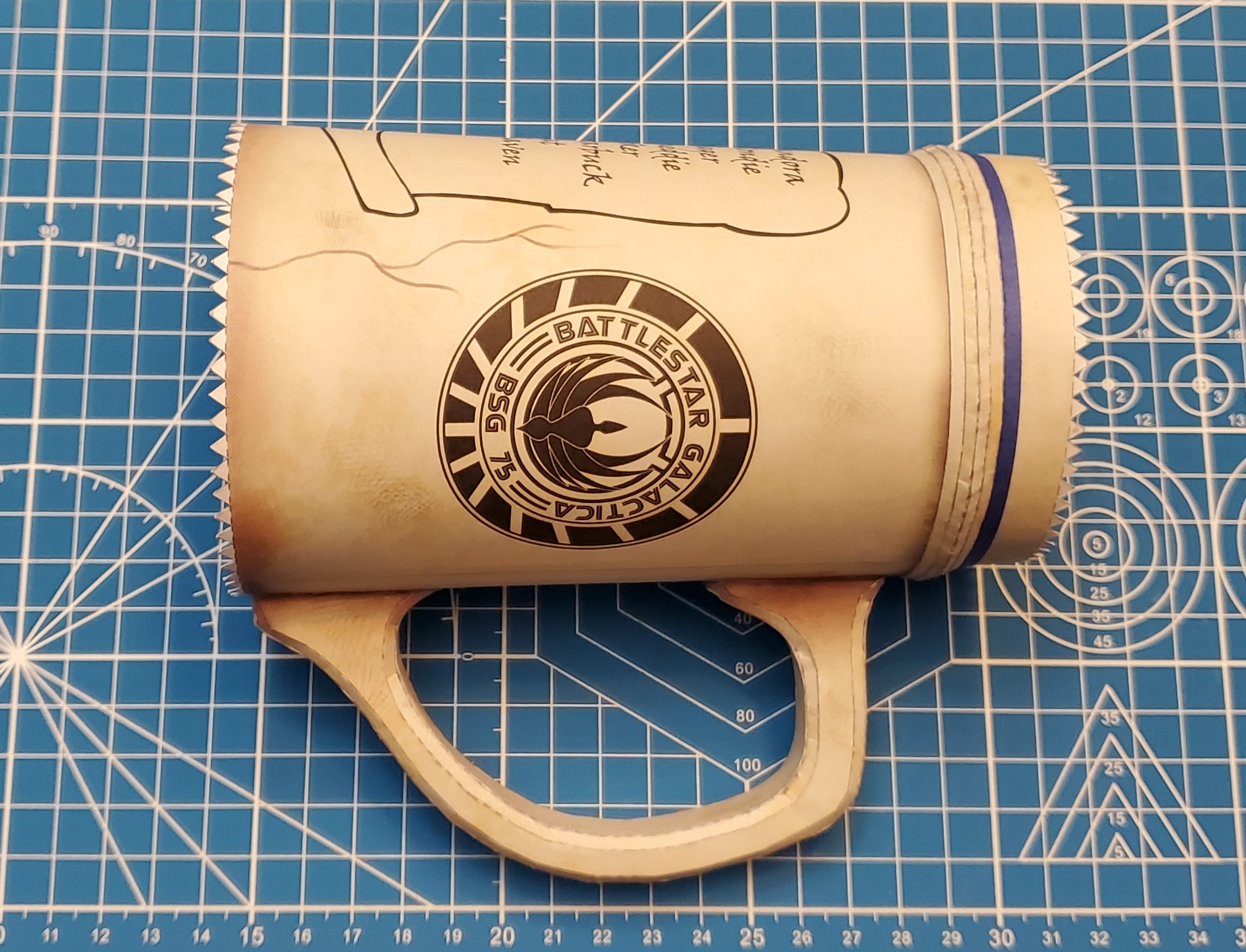

I attached the interior tube body to the exterior.

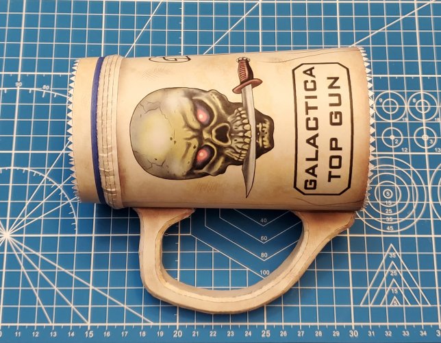

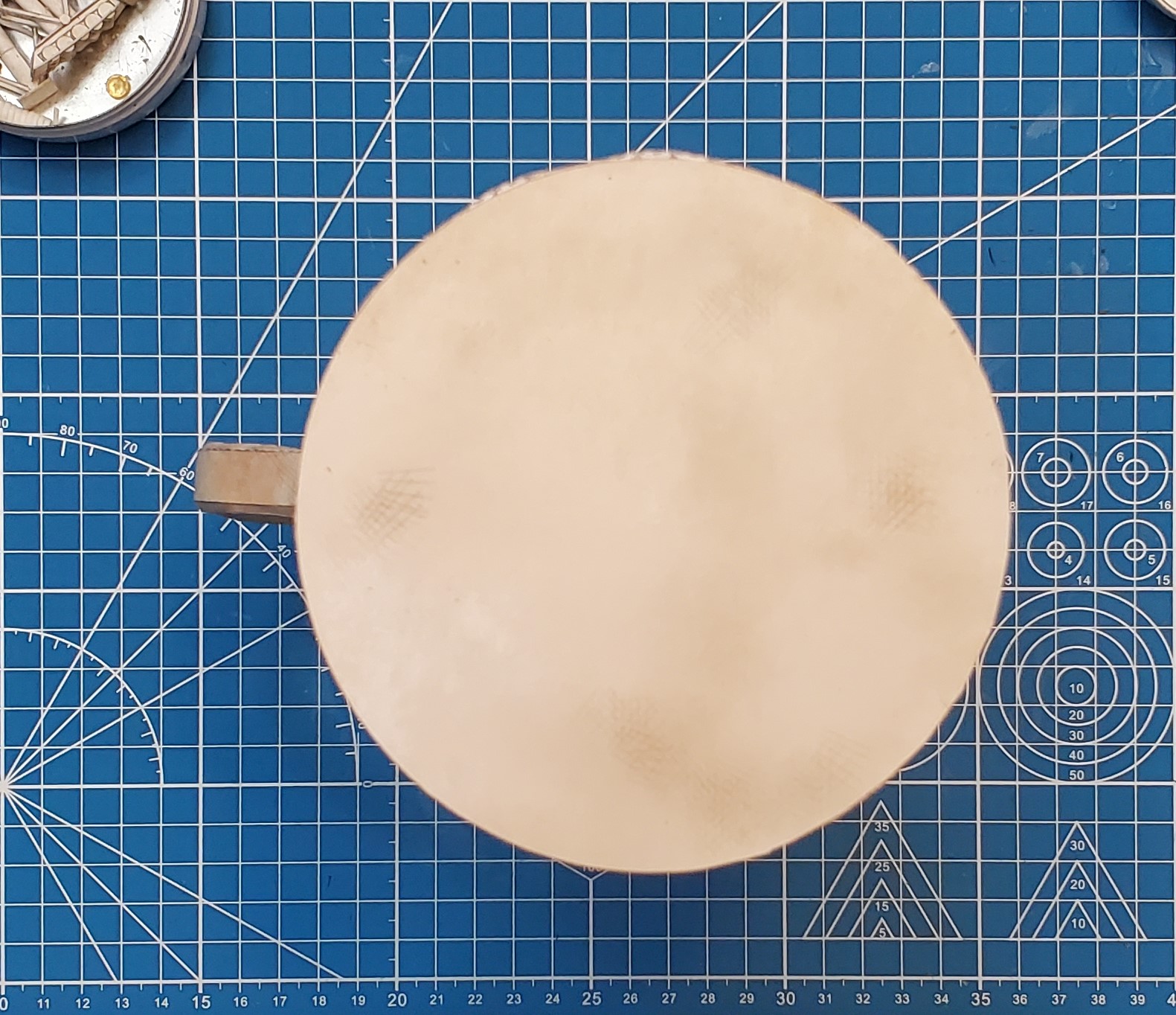

Here is the base.
The base is attached.

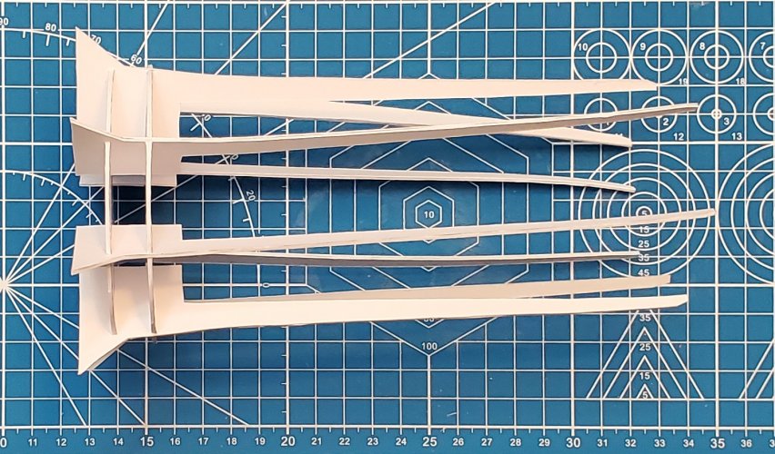

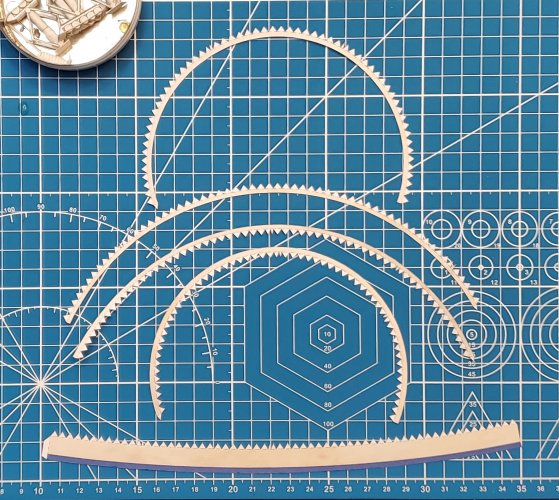

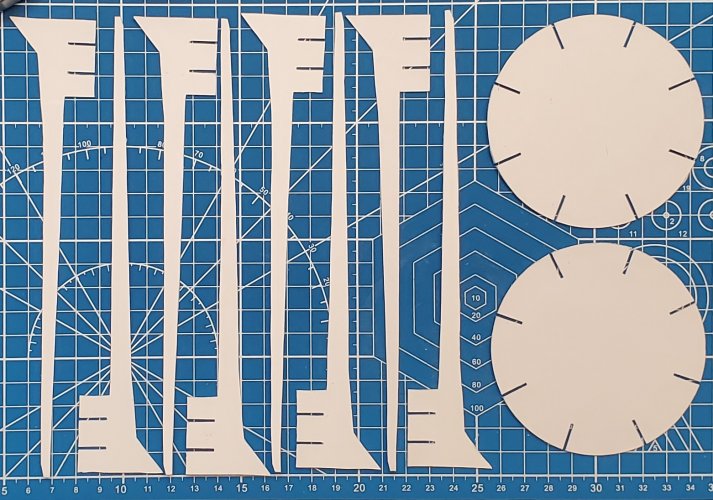

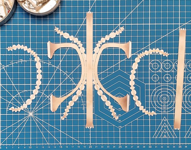

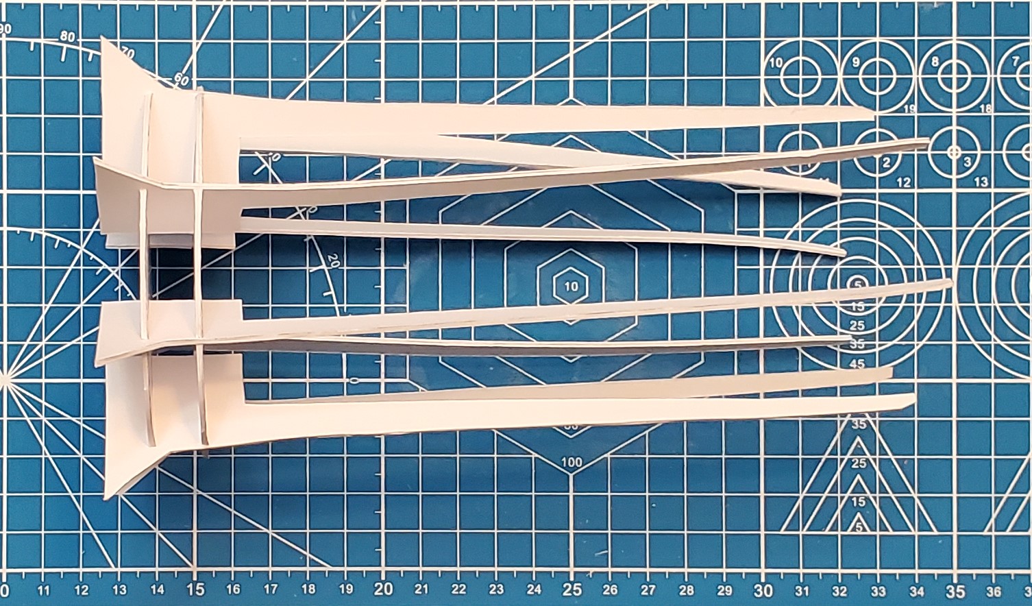

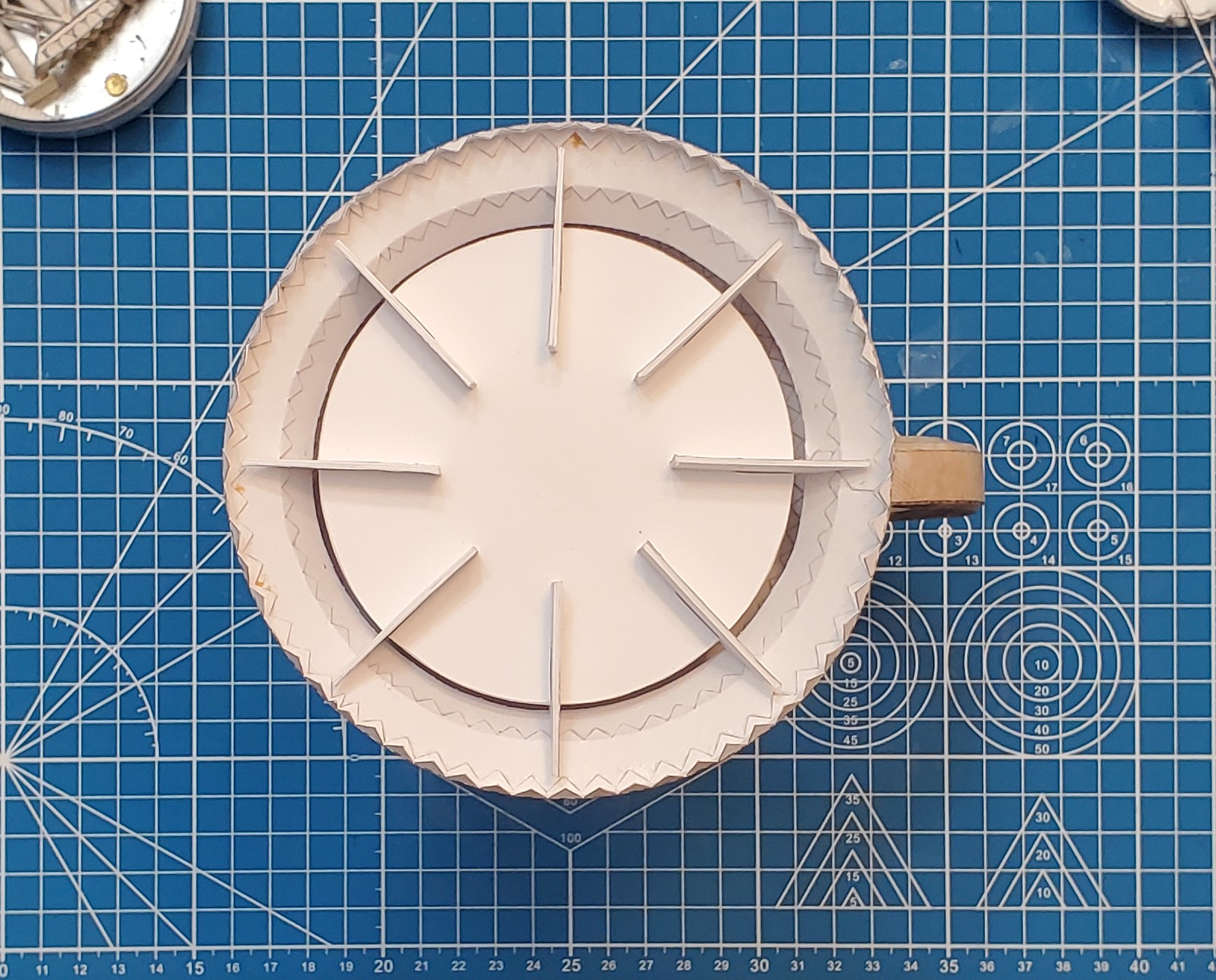

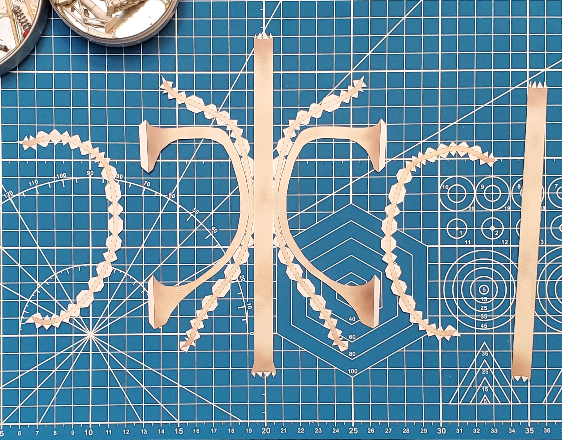

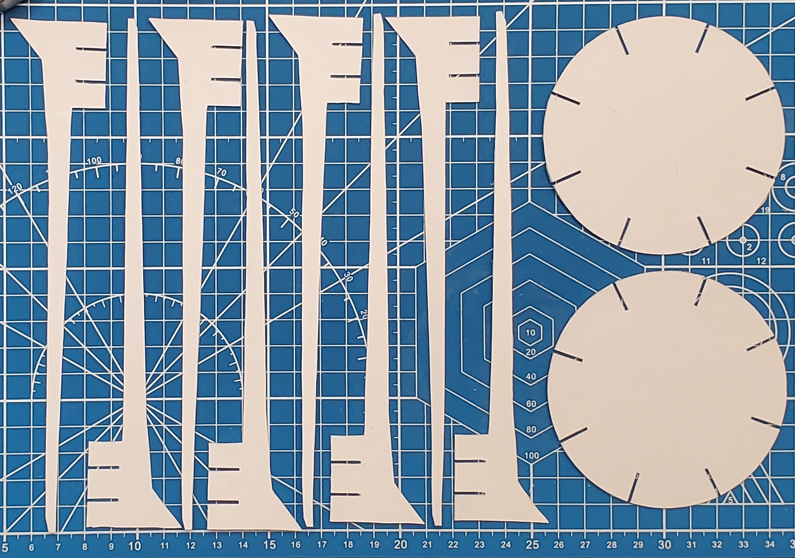

As mentioned earlier, @Revell-Fan created internal formers for the stein for added strength.

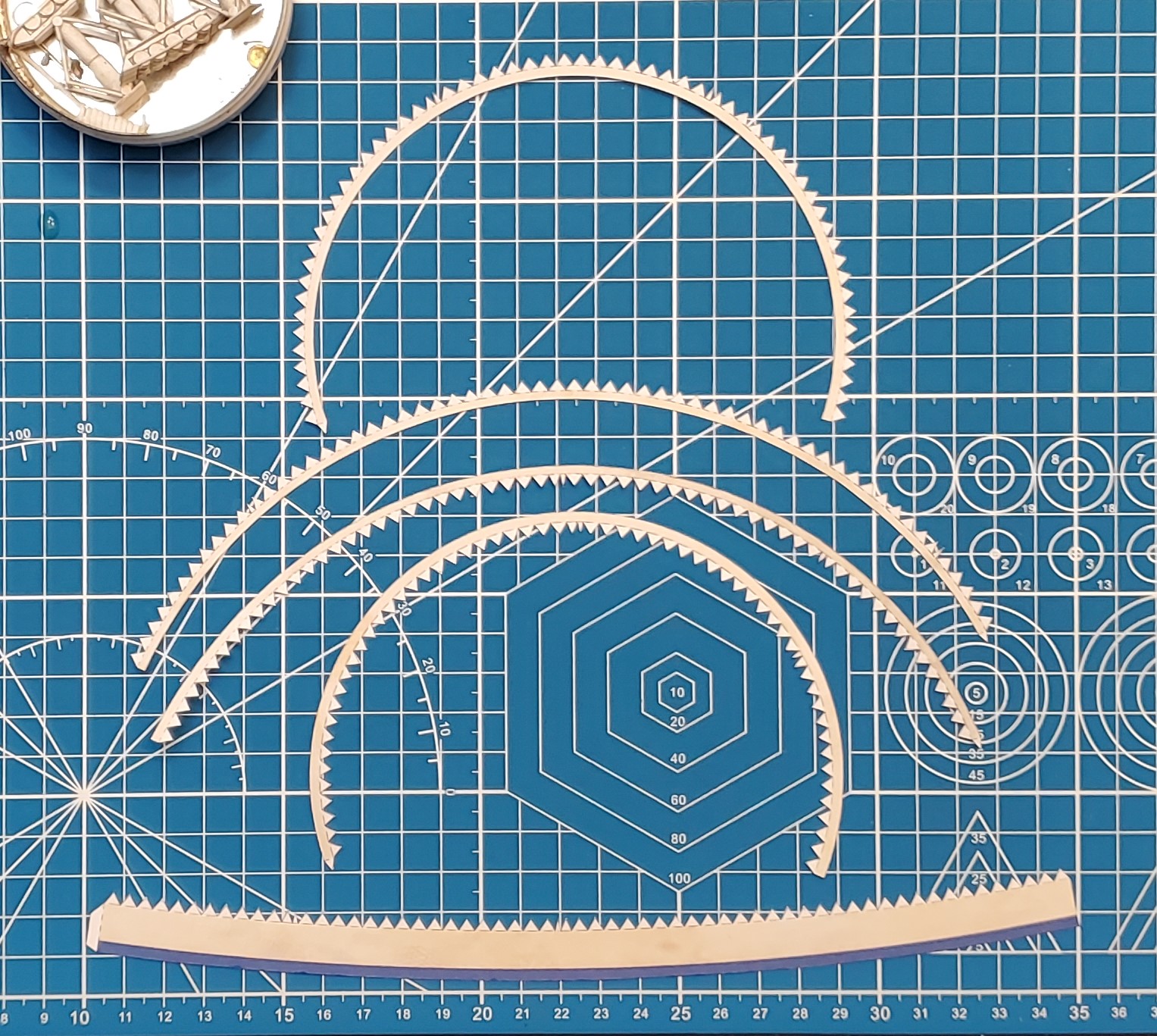

Here are the parts for the formers,
The formers are assembled.

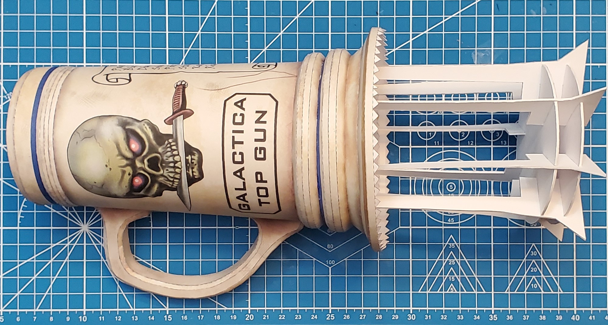

(It looks like an alter to Cthulhu.)

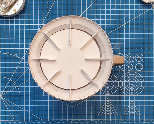

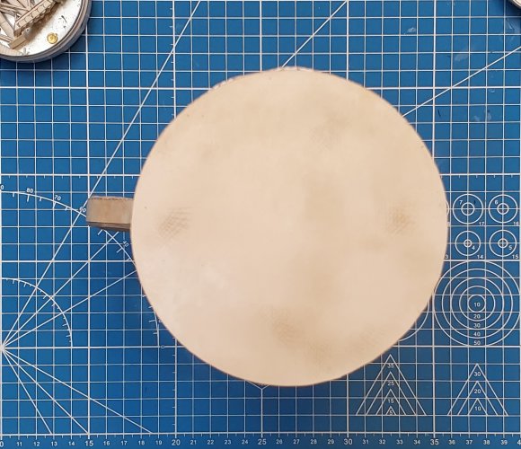

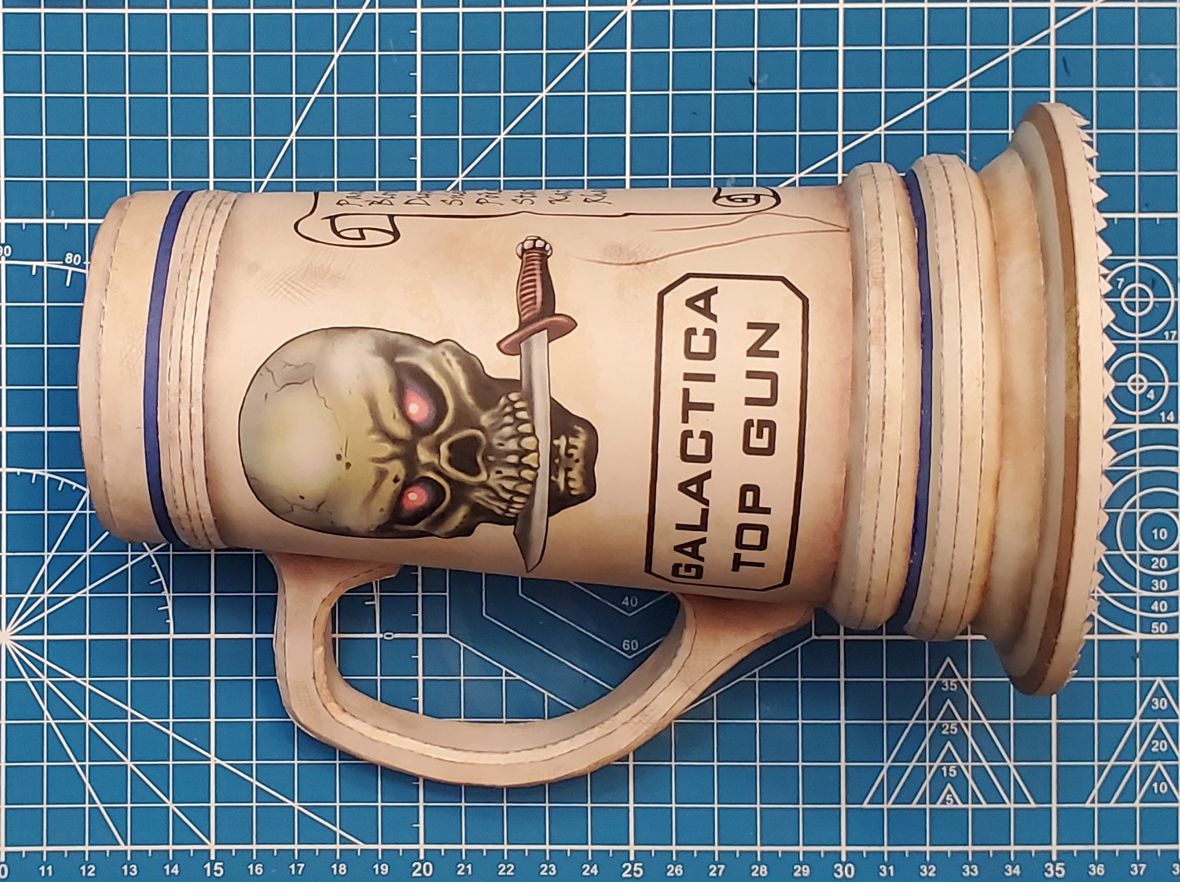

The formers are inserted through the bottom.
The bottom plate is attached.
