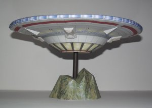

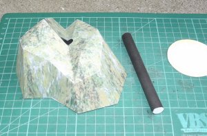

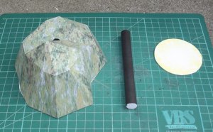

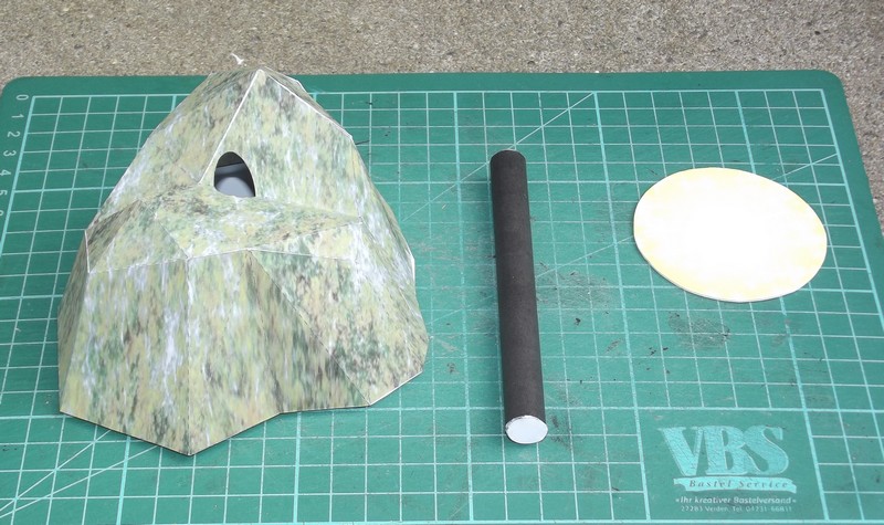

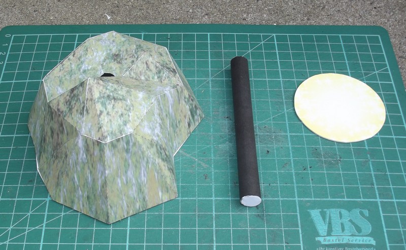

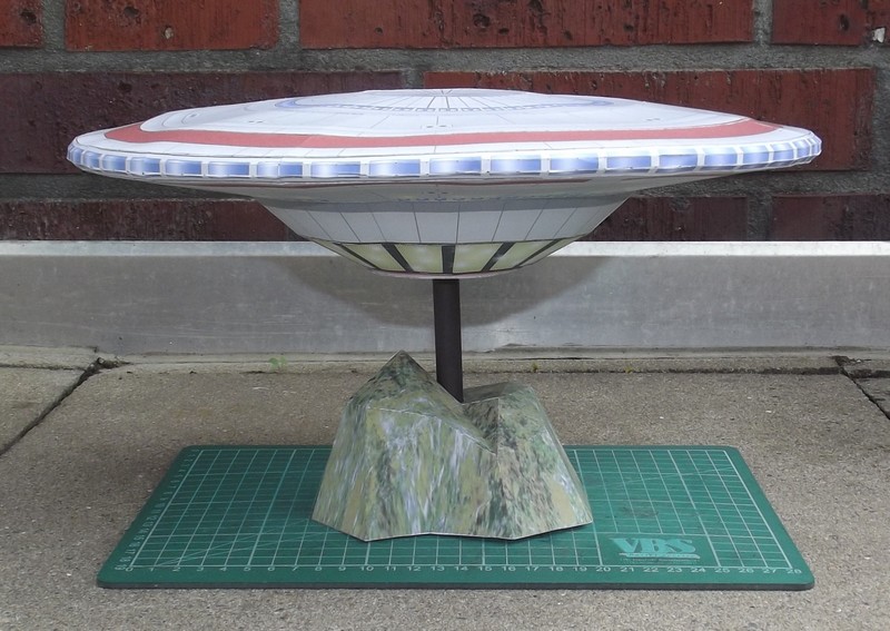

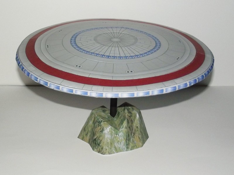

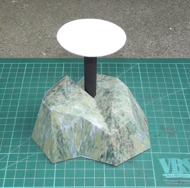

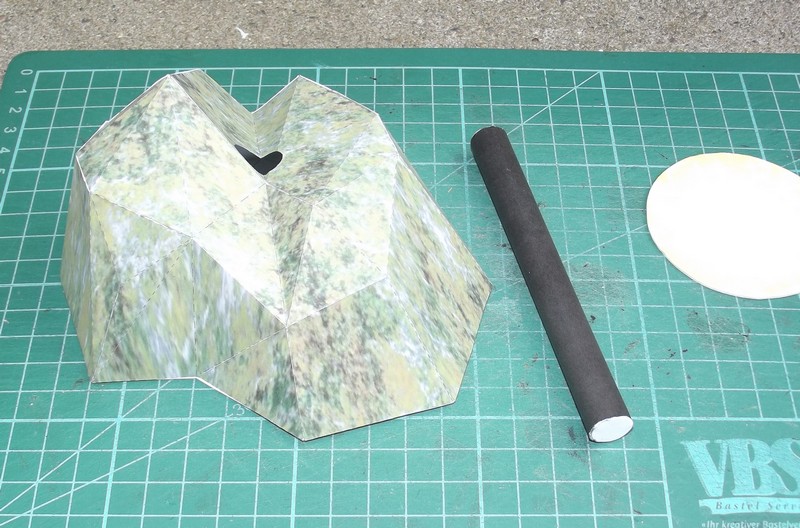

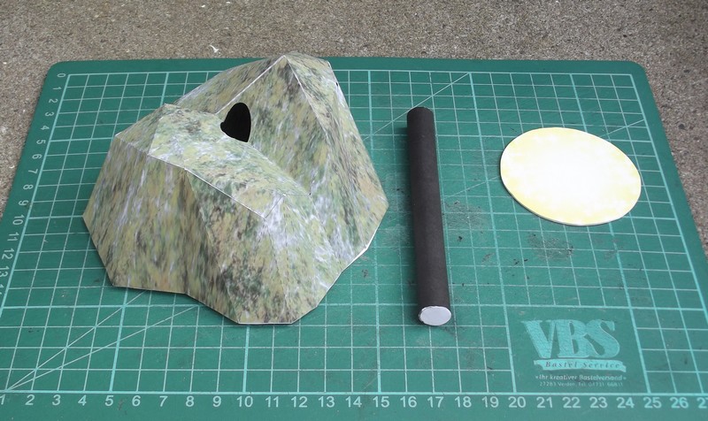

Here are some pics of the flight display stand. I created a mountain base which was heavily influenced by the mountain of "Close Encounters of the Third Kind". The "rock" consists of two parts on one sheet. The texture was made with TheGimp and then projected onto a stylized rock made in SketchUp. I will add a separate page to the package so that you may recolour it according to your needs, i. e. add a brown wash or rotate the colours to get a more deserted or alien look with less green.

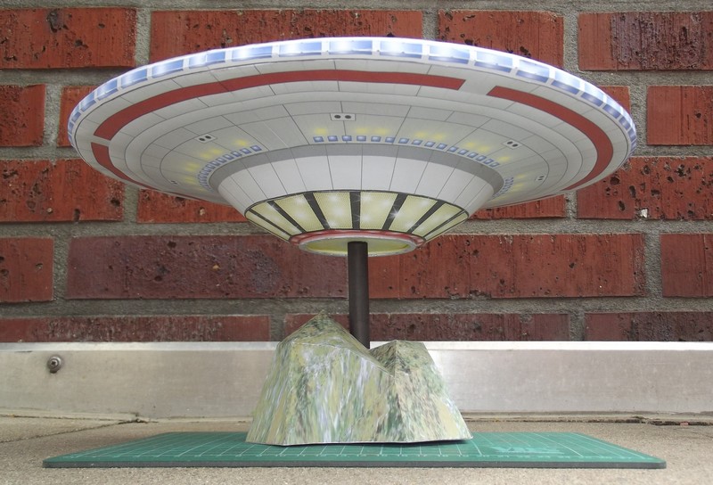

The model rests on a dish which is textured like the circle on the bottom of the ship. So it looks as if it is balancing only on a tiny black pole in the middle, giving the impression to be floating. I'll try to find an acrylic rod to increase the effect.

For the stand, you could use sheets of clear plastic (like from some of the clear plastic IKEA packaging) and roll it into what ever size of tube you need.
Reactions: Sky Seeker
Thanks for the tip, RB! I'll give it a try as soon as I can find some.

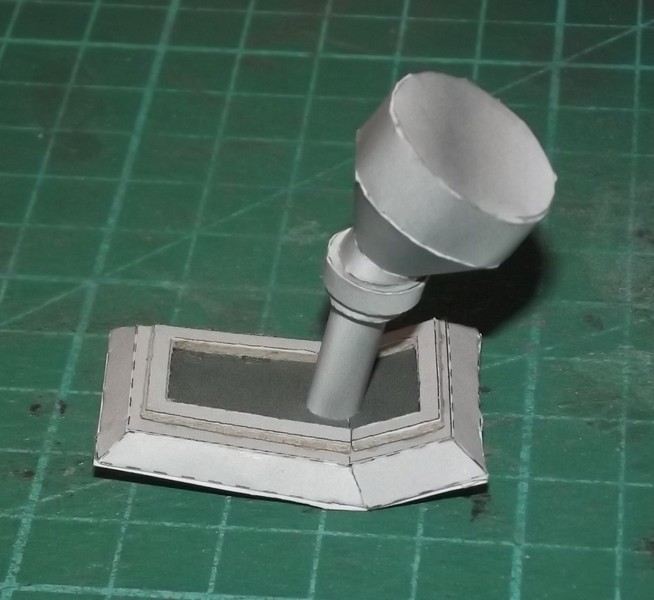

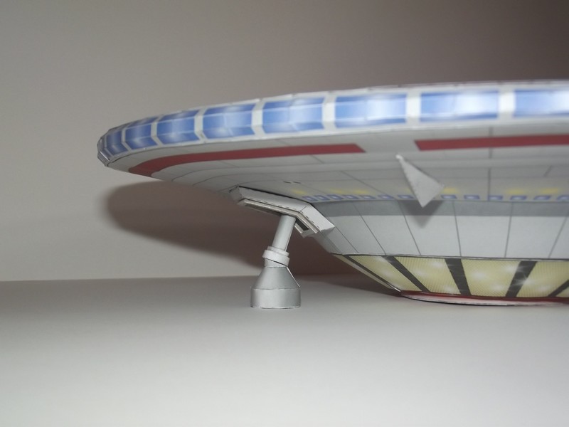

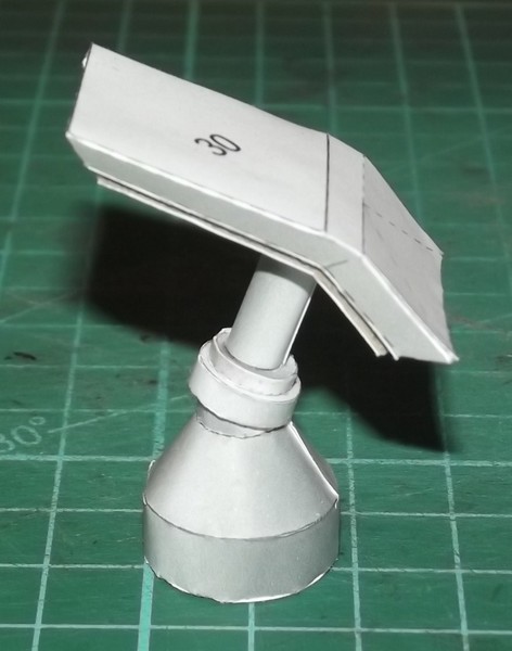

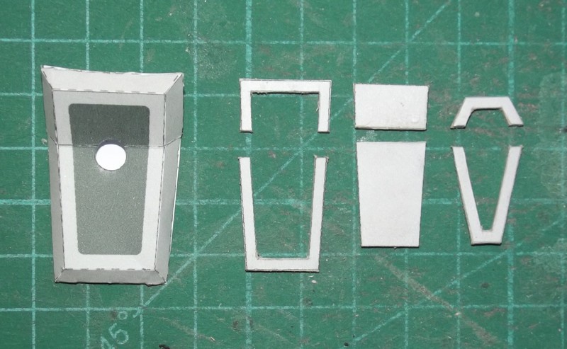

Here are some pics of the ship's landing struts. You can build it with or without them.

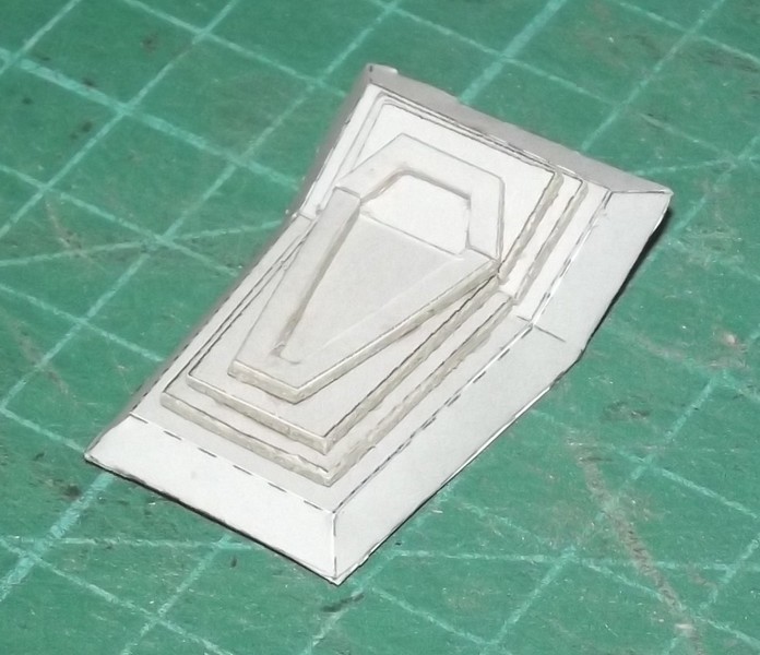

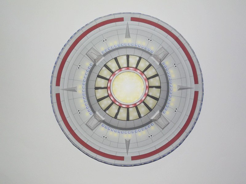

I chose to build my prototype without them. The landing strut housings are closed in this case. The second picture shows a nice bottom view of the model with all greeblies in place.

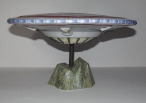

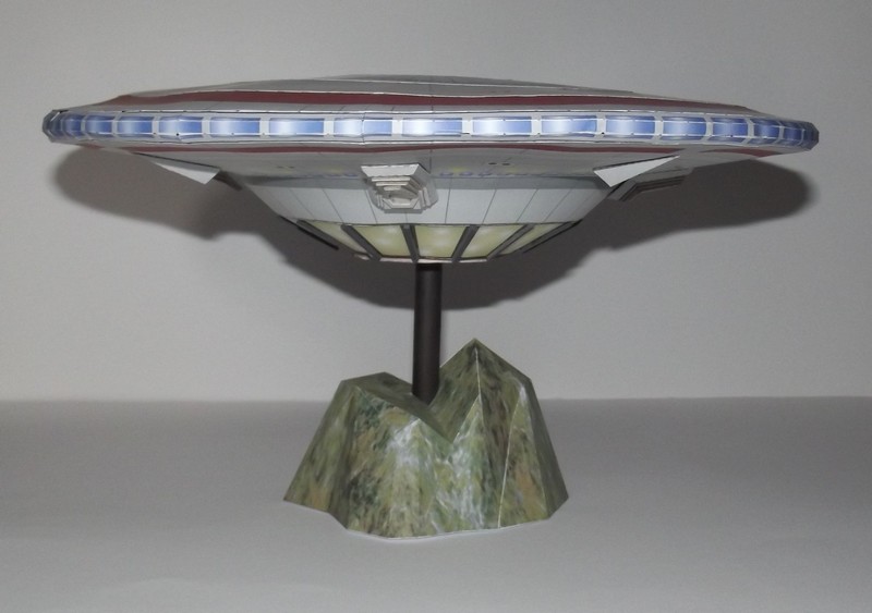

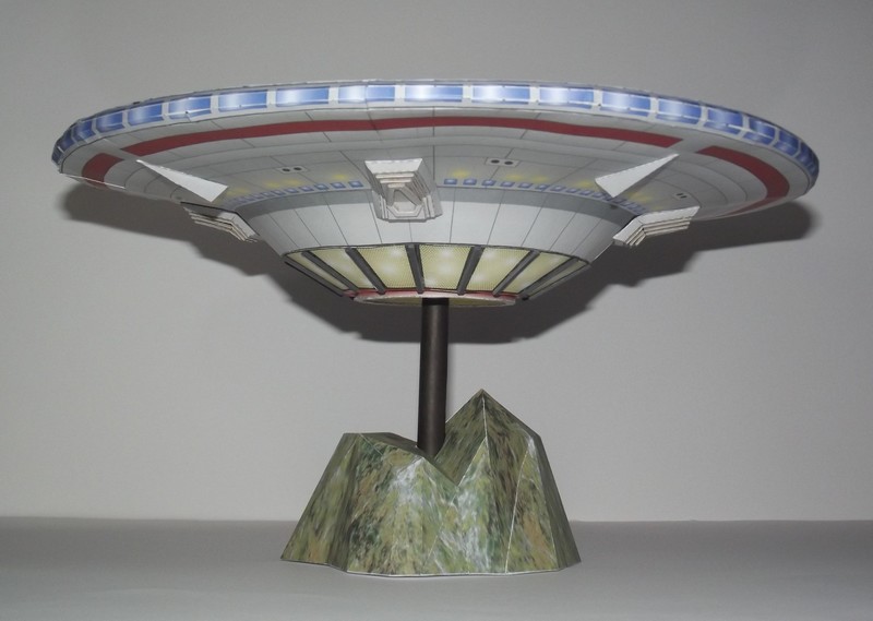

And here it is, Dr Zee's antigrav ship. Despite my initial worries the final model has indeed a fine size, I don't find it too big any more. If you look closely you'll see that I was able to "beat out" the warping a bit by cutting into the outer edge of the warped parts and taping the two ends together so that they overlap a bit. An easy and effective solution. I even had some time for a little Gimp magic (last pic). I'm certain that a version equipped with LEDs would become an even more impressive display piece. :thumb:
This is the 25th model I have designed. As I said before I made this model for one reason only, to learn how to apply a texture to an uneven surface in SketchUp. Even though there is a little error I was unable to fix I must say that the result pleases me very much. It was a fun project which taught me a great deal of handling textures. One of the main disadvantages of SketchUp and Pepakura is that they do not accept texture maps above 1024x1024 pixels. I worked around that limitation and rose texture and export quality by not using one single map but four individual maps with max resolution each. The result is much crisper and cleaner. BTW, the procedures I learned here will be essential for the next project by me and Rhaven (yes, we are teaming up again!). I've sent the kit to him for approval and asked him to add it to the BSG downloads section. Till then, enjoy the pics! :wave:
