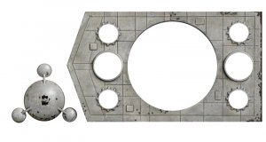

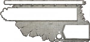

First of all I corrected some minor distortion in the image using a program called "ShiftN". Then the picture was loaded into Gimp. I made extensive use of layer masks to define the different layers which later will be cut out, laminated to corrugated card and stacked on top of each other.

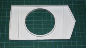

This is the first layer:
the second:

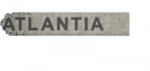

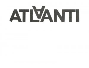

the name plate
the letters, already layed-out on letter-size paper ( ;) )

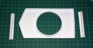

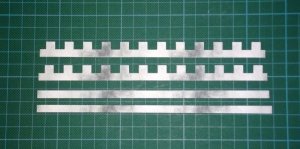

the top strip

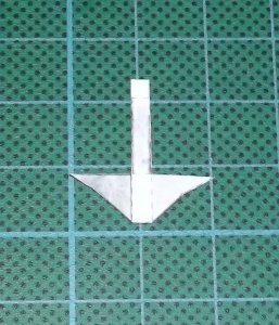

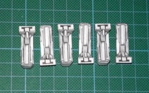

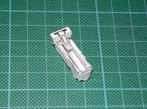

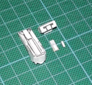

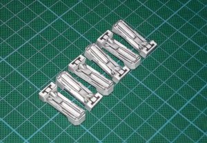

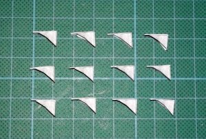

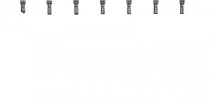

the clamps
and the plates

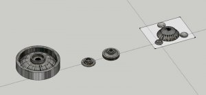

The clamps and the Moerser Karl parts will be re-created in SketchUp.

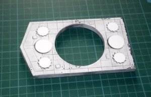

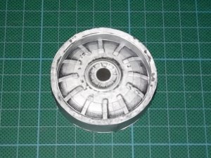

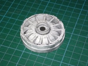

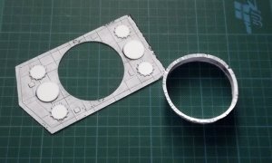

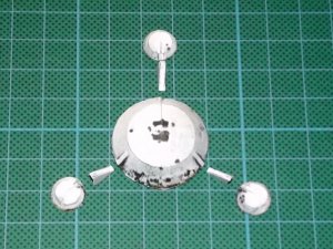

Modeling and unfolding of the parts is complete and I have begun test-building. First I am tackling the big Moerser Karl wheel.
The dome was assembled witout flaps. I used paper strips and glued it together on the back side.
The outer frame:

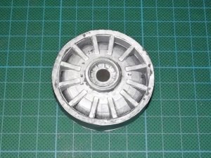

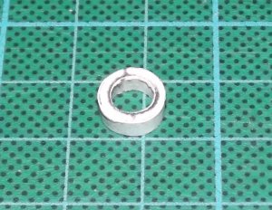

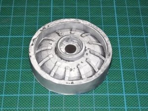

The main piece is finished. Now on to the detailing. A ring is glued to the center. I could have gone the easy way and made it using a rolled up strip of paper. However, the thickness of the part makes it possible to build everything "the traditional way".
Ring attached:

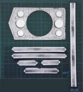

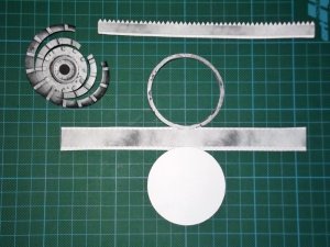

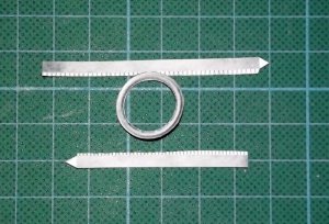

The parts of the Moerser Karl base.
The long strip at the right is the inner ring.

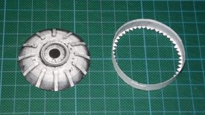

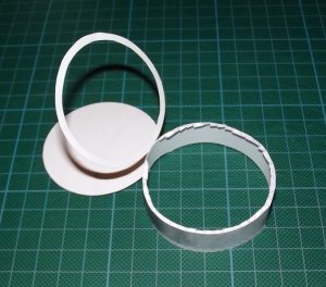

Inner ring and outer rim pieces attached.

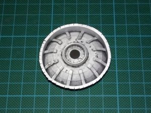

A simple set of formers is inserted.

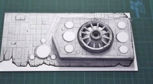

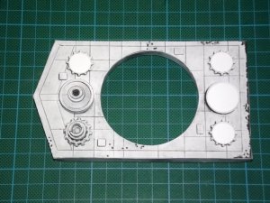

Quick and dirty test on the background plate.

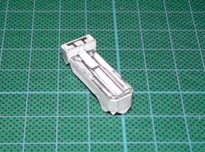

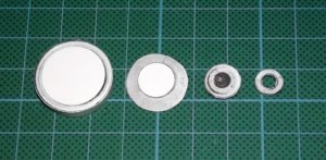

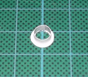

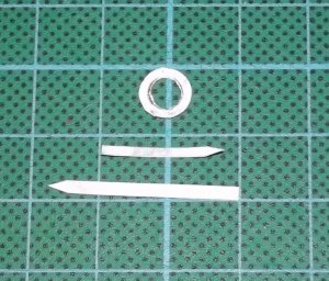

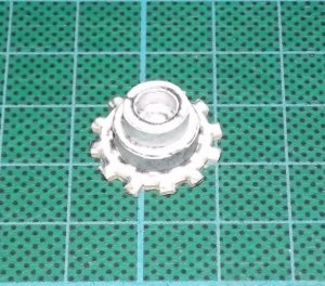

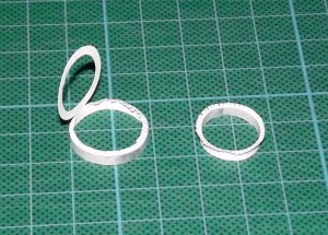

Now on to the small wheels. Each of it has a round tip with a hole in the middle. It consists of three pieces: inner and outer rim and top piece.

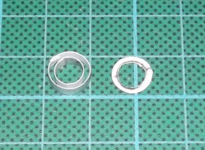

The inner rim is glued to the top piece.

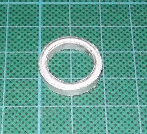

Then comes the outer ring.

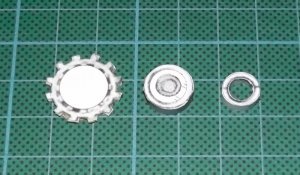

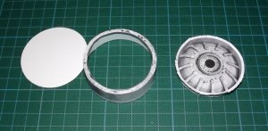

All three pieces of the first small wheel.

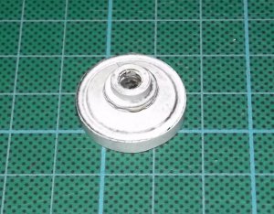

They are stacked on top of each other.
Small wheel #2:

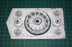

A quick test on the base:

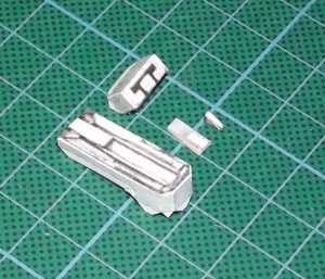

The dome construction:
