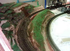

Thanks for the great advice. I will attempt to upload the picture with this posting (again). The paint color/shade which I used is simply numbered 8615. I chose it from a bunch of sample cards at the store. It seems too pink after it dries. I was painting directly onto the foam straight from the can (no water added). It is called super acryllic emulsion paint and the folks at the shop told me that it is a 'latex' based paint. I think that once I get the right color of paint for modelling the rockies in western Canada then I will start over and try the paper towels soaked in plaster as I would like to have a more natural look with rocks and crevices mentioned by Woodie. I hope the picture attachment works and you can give me some more ideas about the proper paint color or any other good ideas to get the desired look.
OK, it looks like you can upload pictures now, good, we can now see what you're talking about. What I did was go to Wal Mart and like you, have them mix me a gallon of flat wall paint in a light tan. I also have some of their small bottles of acrylic paint from the craft dept that I use to tint the tan to suit the color of the terrain I am trying to achieve, sometimes darker, sometime lighter.
I am in the process of expanding my layout. The original area has a lot of hills and I covered it all in either paper soaked in plaster, or just pre-mixed joint compound. The new area will be mostly flat, so I just painted a base coat of medium brown right over the blue foam. It may eventally all get covered over, but if any of it peeks through, I hope it will look like spots of dirt. Incidentally, the foam covered fine with just one coat.
That looks pretty good to me Douglas! The thing is that earth is light tan when dry, darker when wet, and rocks are usually various shades of grey. Painting on plaster will give you different colour results from painting on blue or pink foam, so if you're ultimately going to use plaster, I would experiment on a small patch first.
