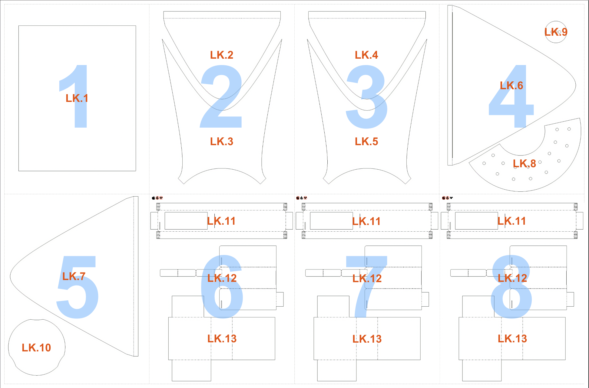

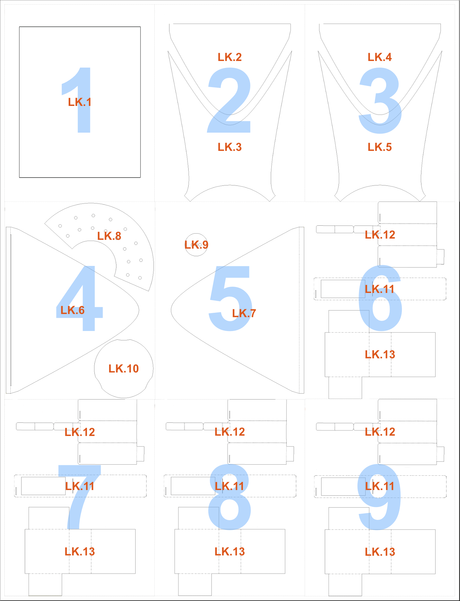

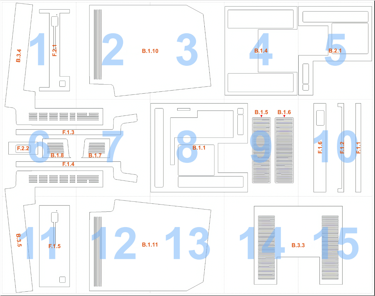

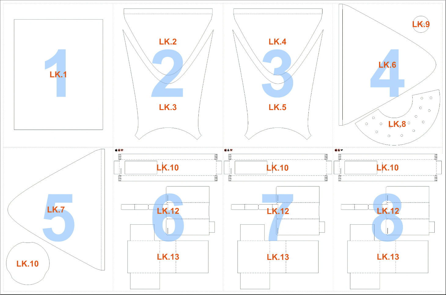

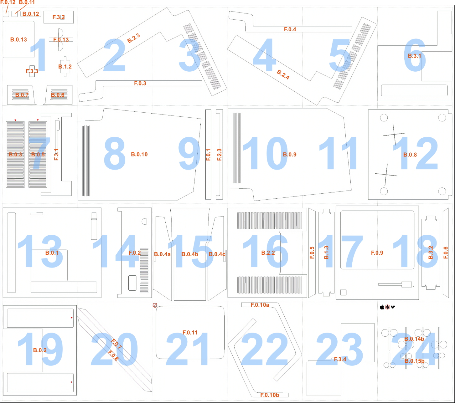

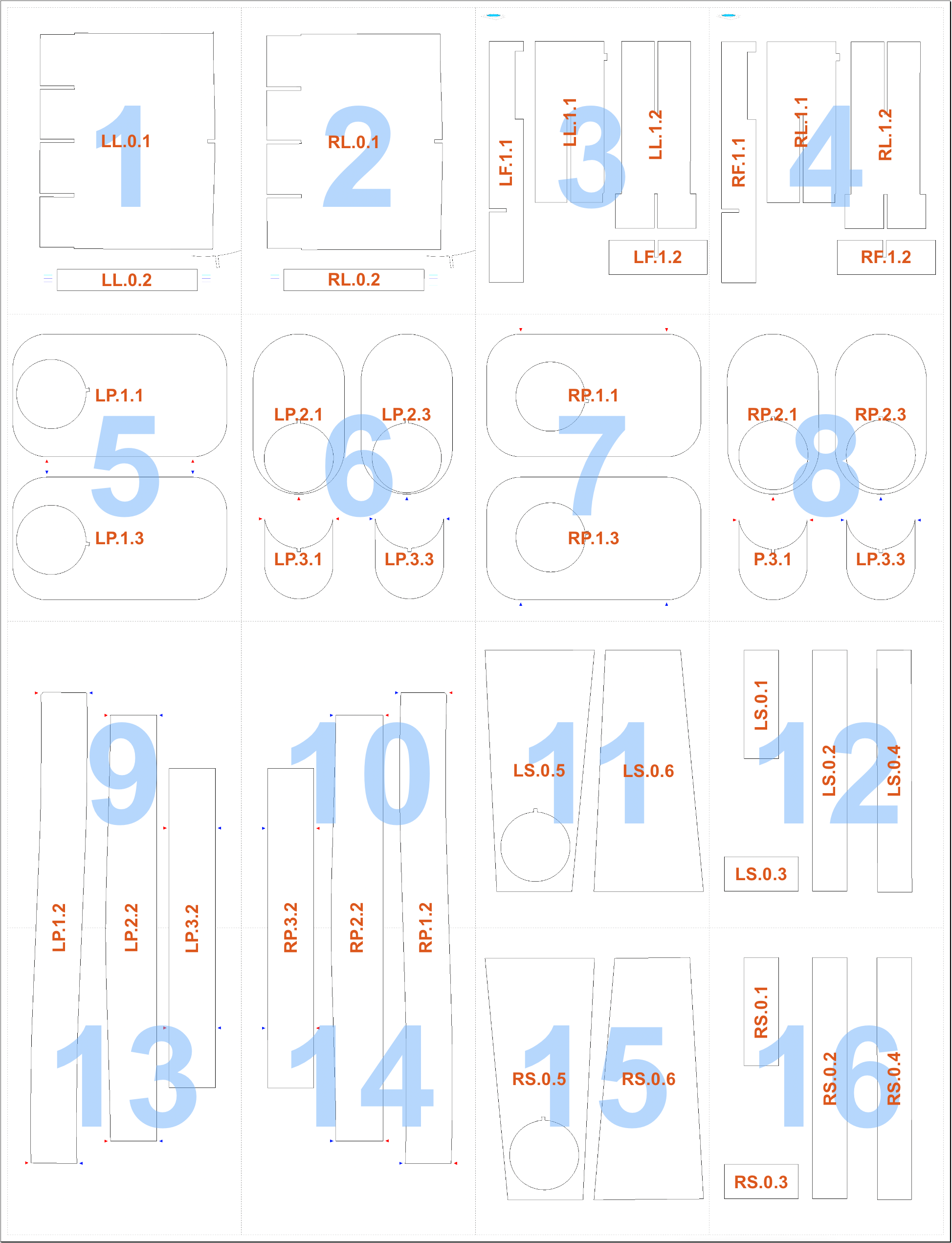

This is the absolute LAST time I post the part layouts.
Banana Base.pdf
Bulkhead.pdf
Exterior (Banana/Apple/Veidt).pdf
Interior.pdf
Light Kit.pdf
Unfortunately, this forum has been hit with DNS attacks numerous times. All throughout the forum, quite a bit of material (to include resources and photos/images) has been removed from said attacks. Not only that, but when the forum was moved from "Tap-a-Talk" to Xen-Foro, Tap-A-Talk took quite a bit of material as well.
Thank you for uploading the template sheets to the thread. However, it would be better to combine the templates with the instructions in a rar file, and upload it to the resource section. If you need assistance with it, I am willing to help you.

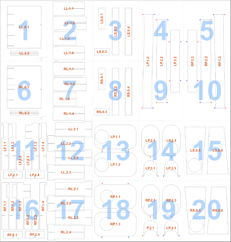

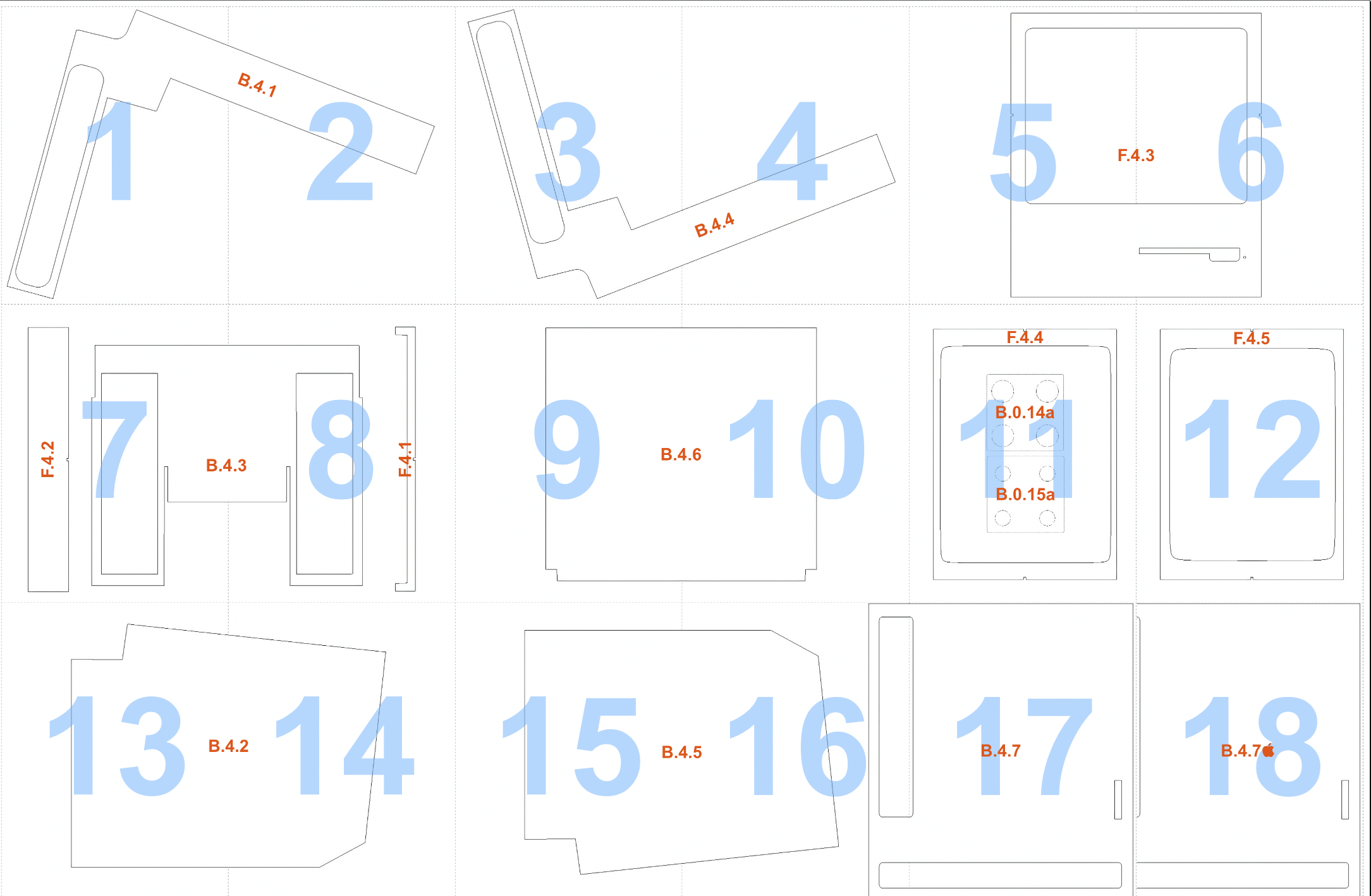

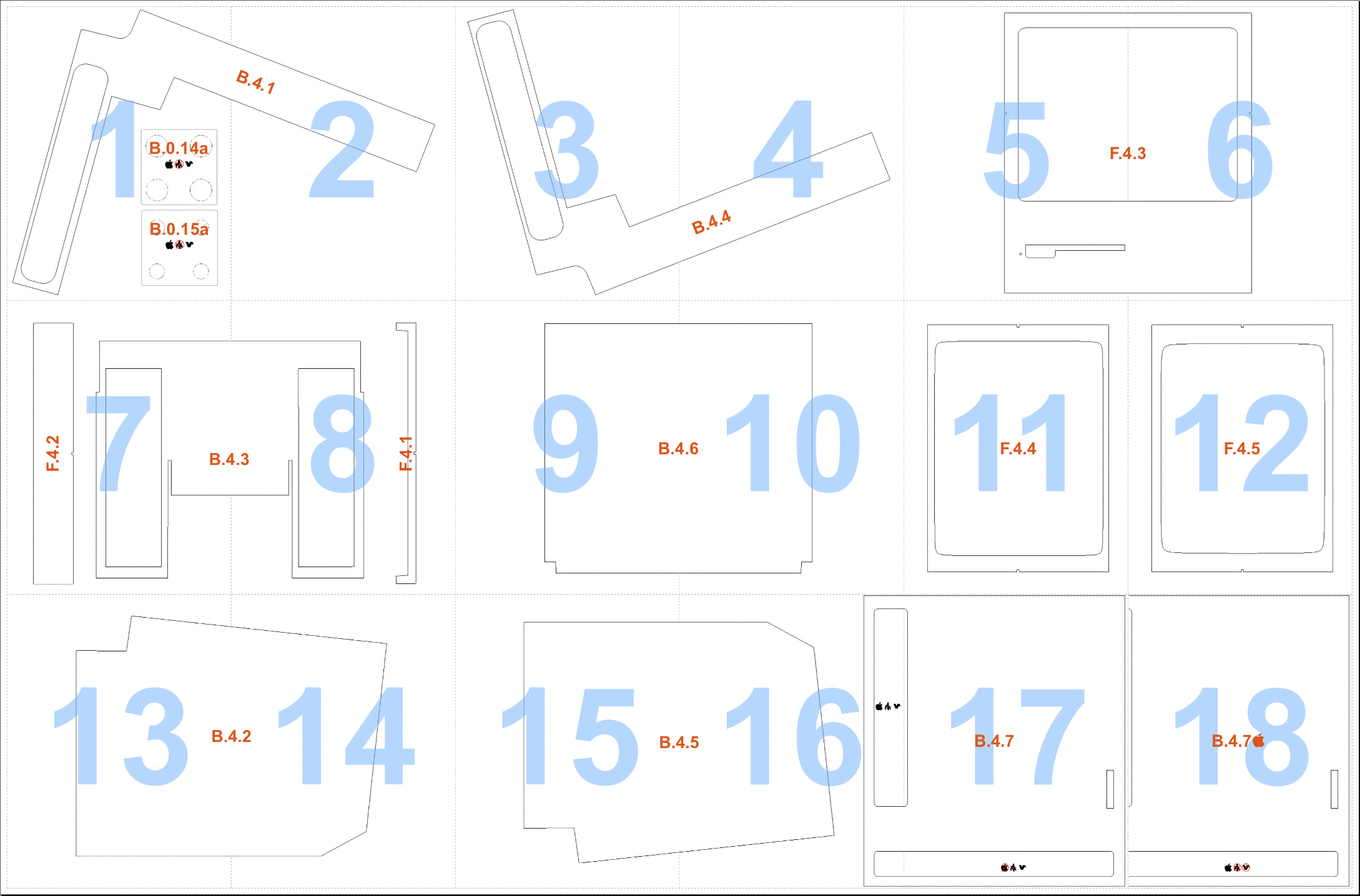

There are 5 pdf files, one with 3 variants, for a total of 183 parts. As before, the part layout pics are just an overview. I’ll continue writing entries to this thread as I’m building the model. I’ll upload the pdf files along with an assembly guide when I’m done.
Thank you very much. I am glad to see that you are indeed continuing on with this project. I am looking forward to seeing how it turns out.

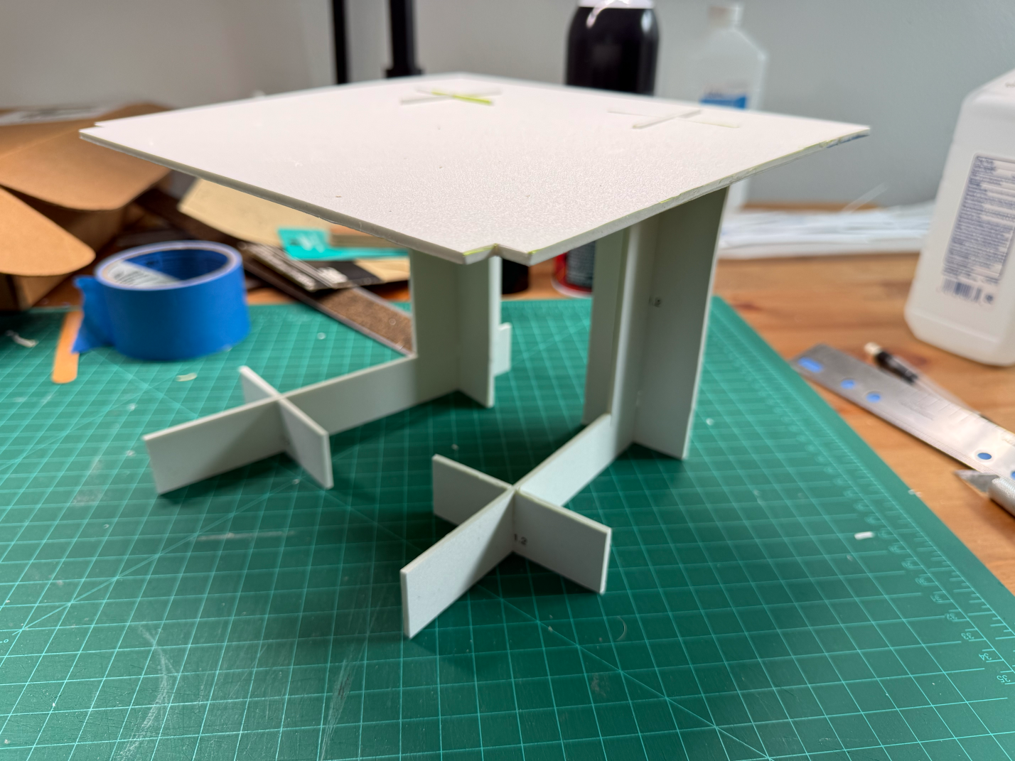

Since I'm using 1/8" PVC board for the Bulkhead pieces (instead of corrugated cardboard) I made the executive decision to use the PVC board for the Banana Base support structure. That trimmed the page count from 85 to 81 and part count from 183 to 140. The Banana Base part layout diagram has been updated above.
Edit: And I might as well use the PVC on the Banana Shoes, too.
Page count: 82
Part count: 167
I'll be reusing some of the old pictures of the first build.

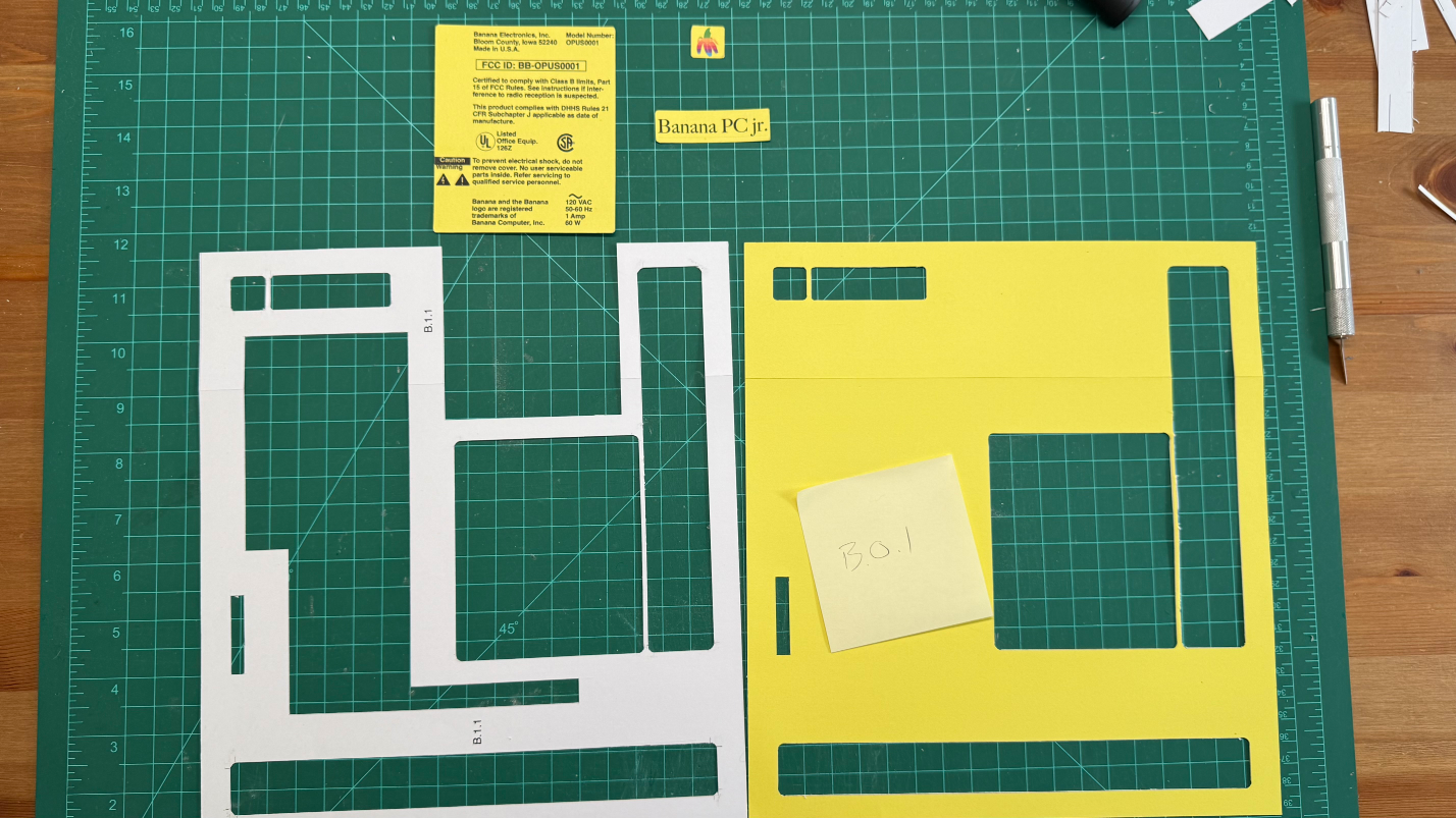

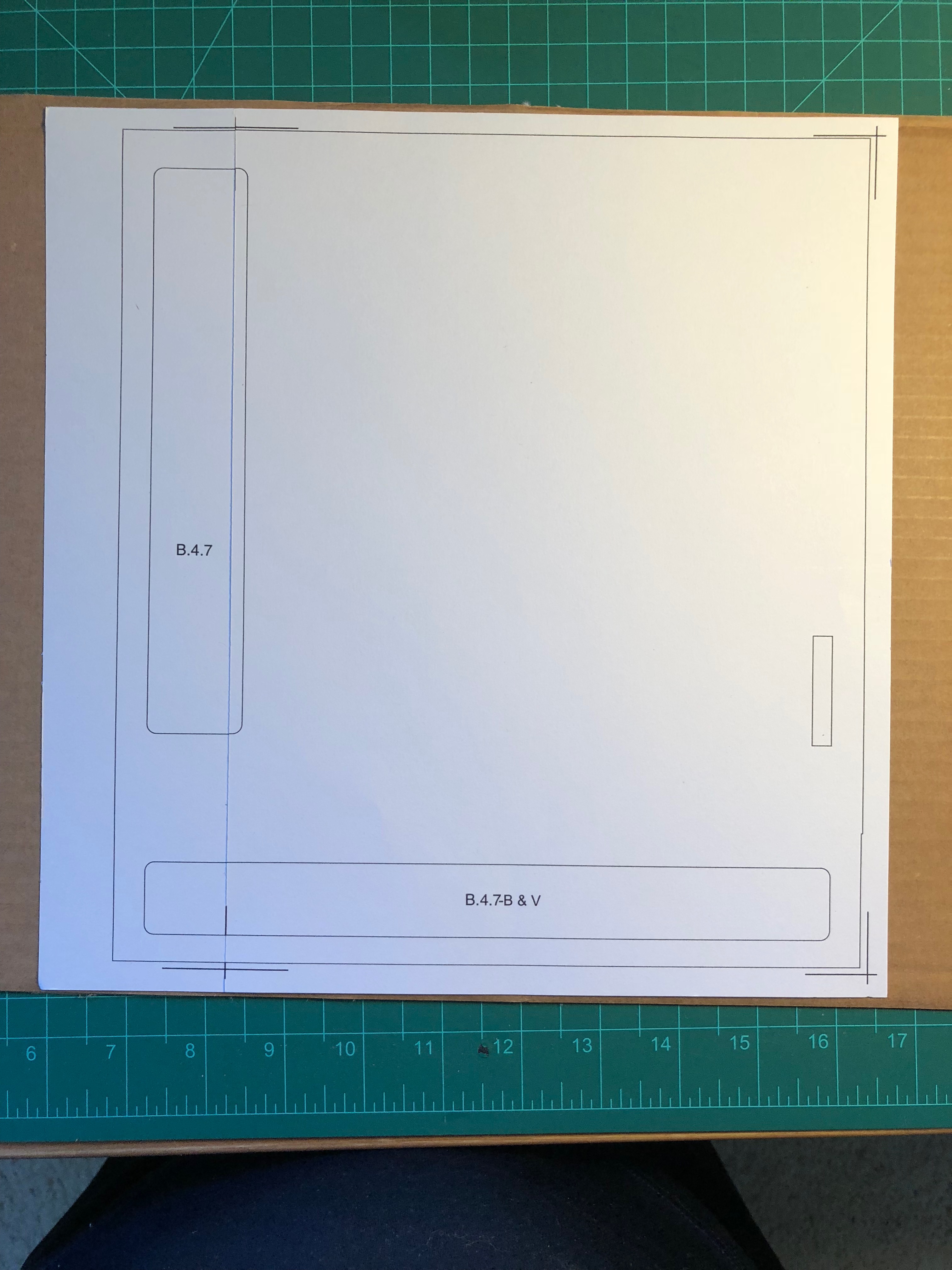

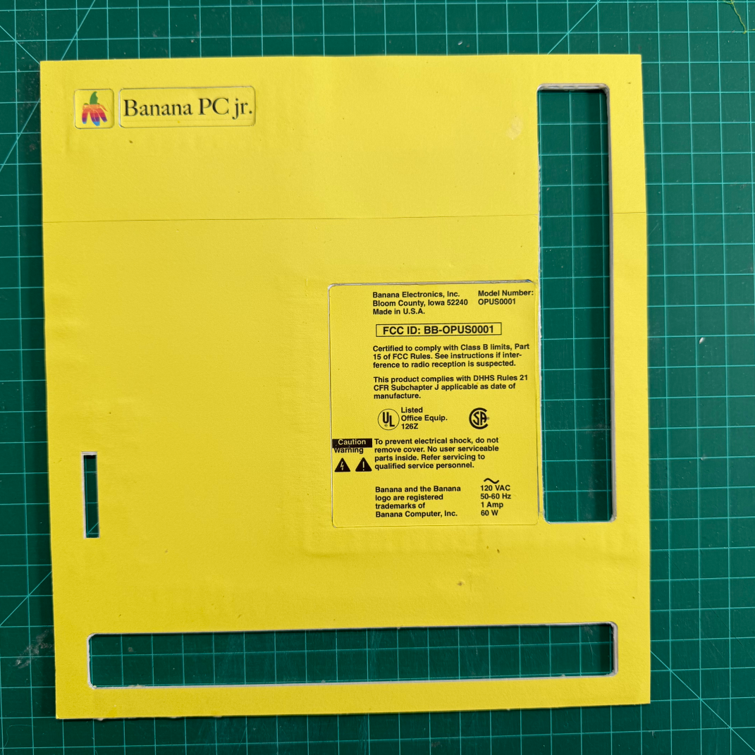

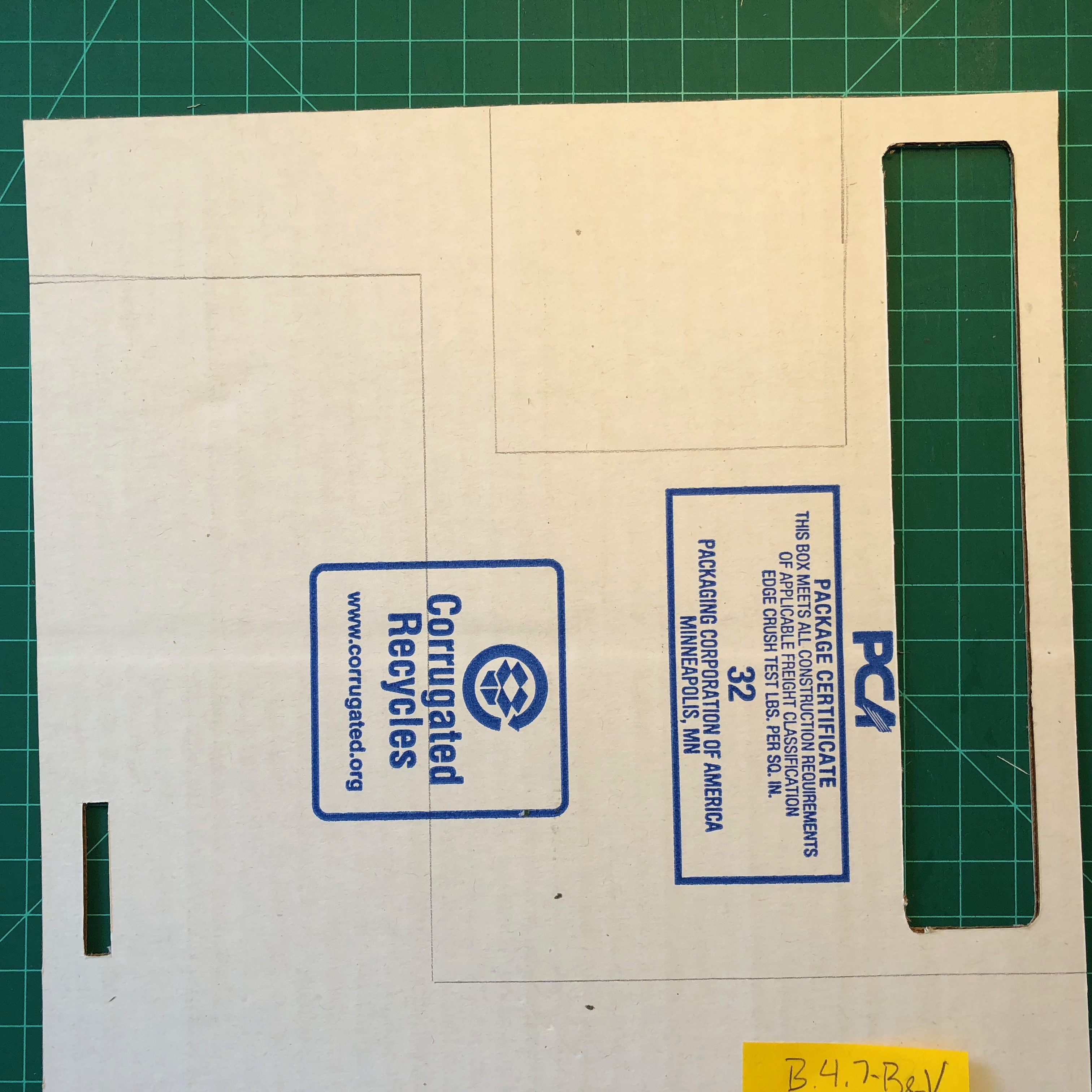

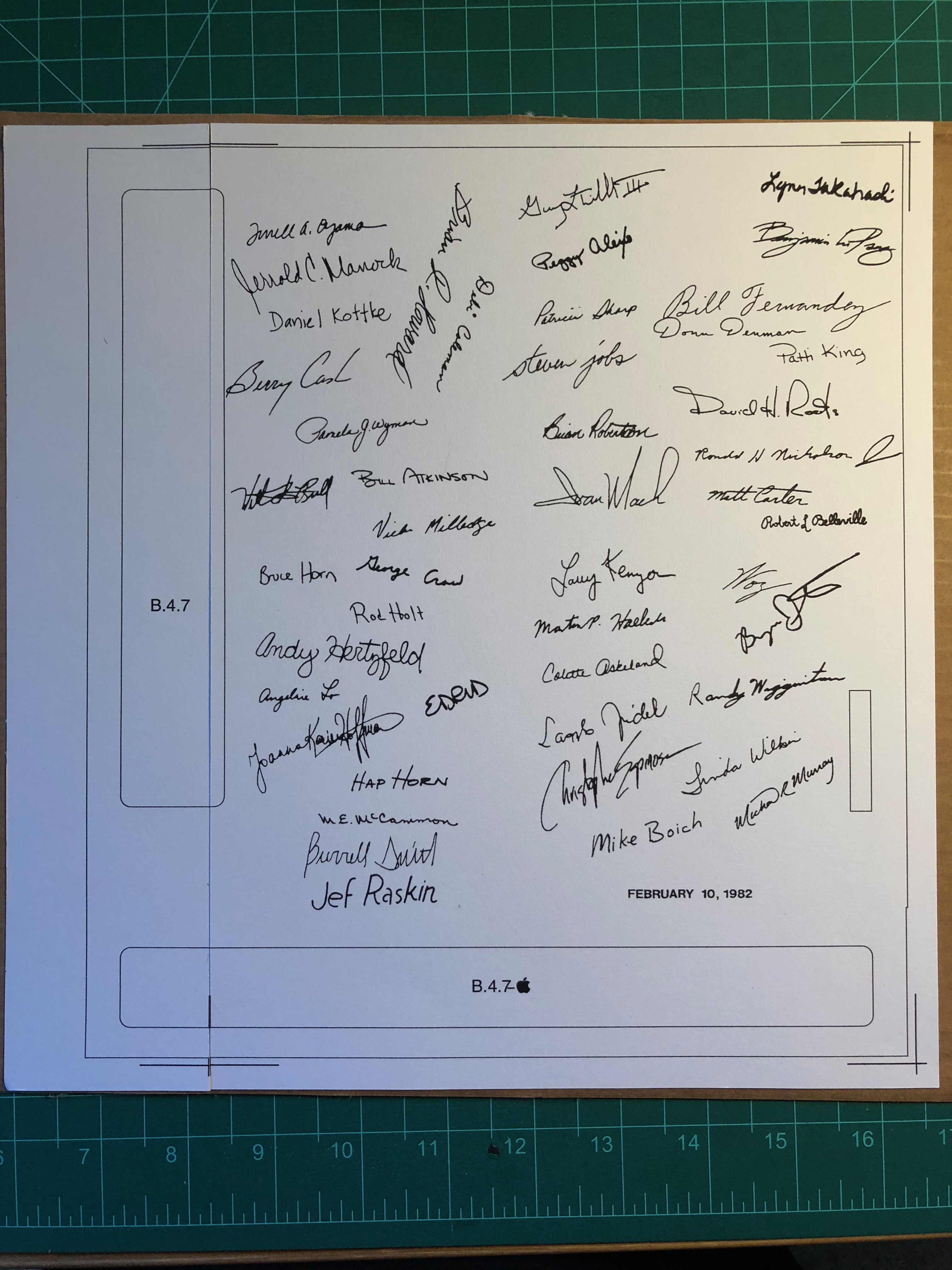

Case Back​
Back Panel​

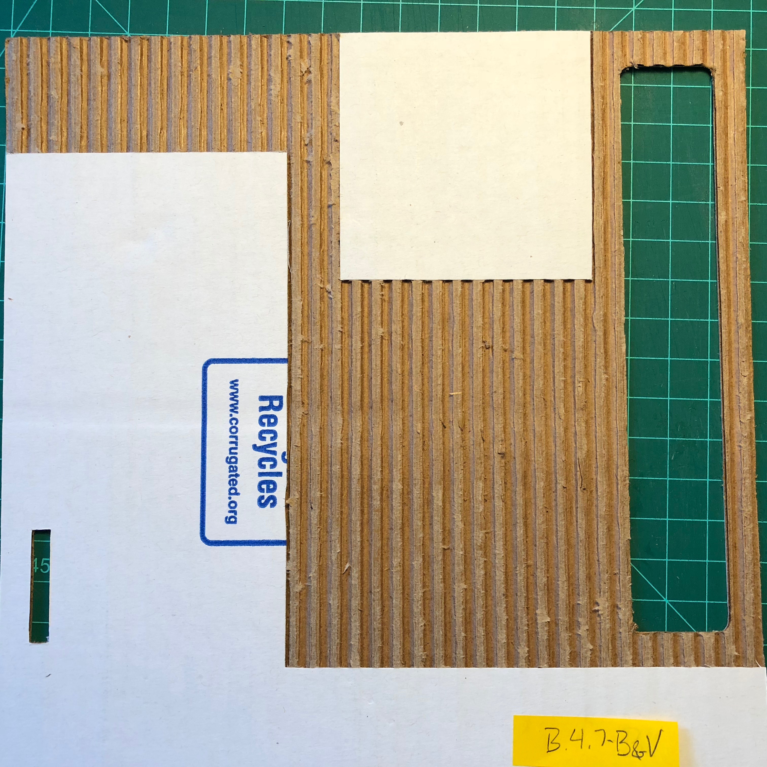

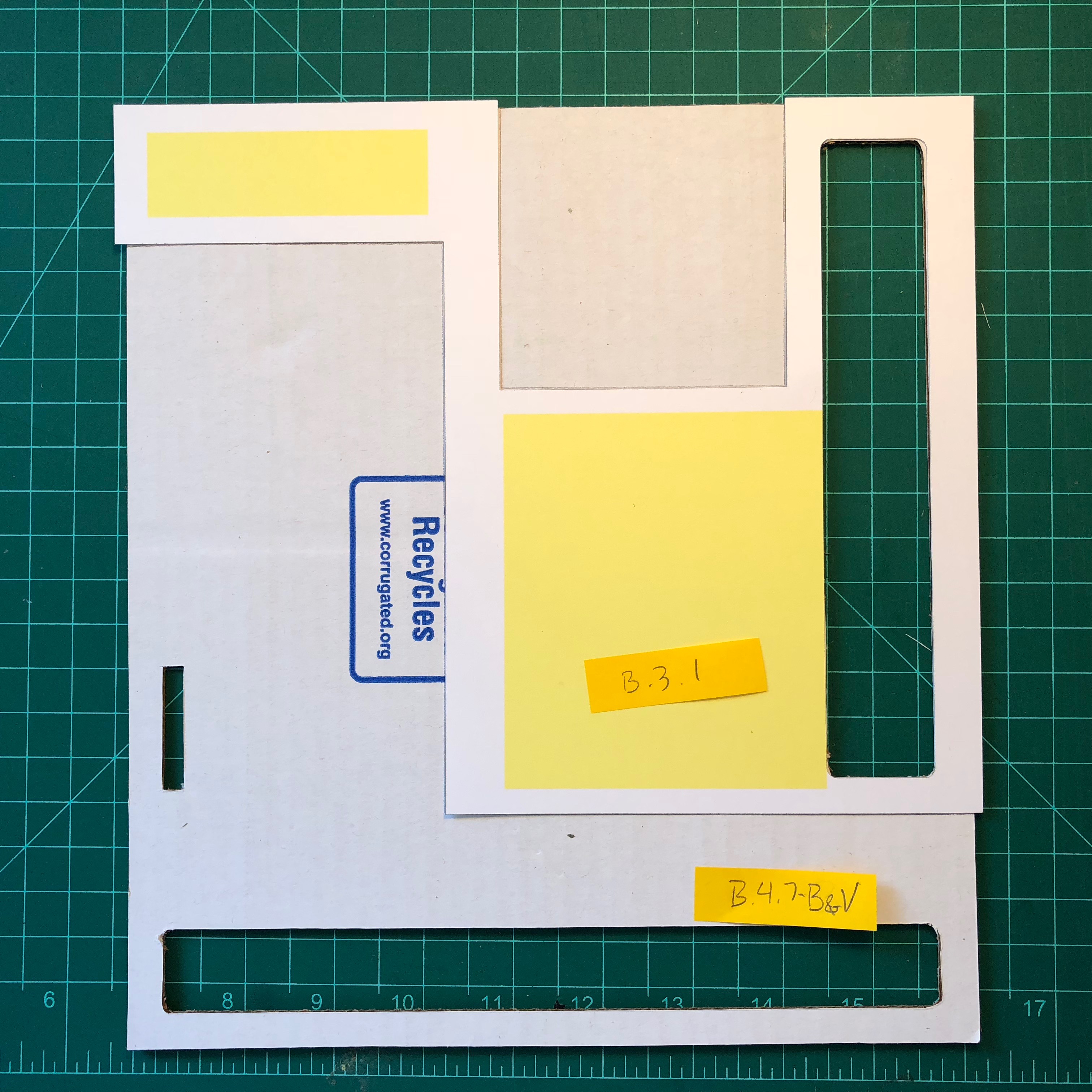

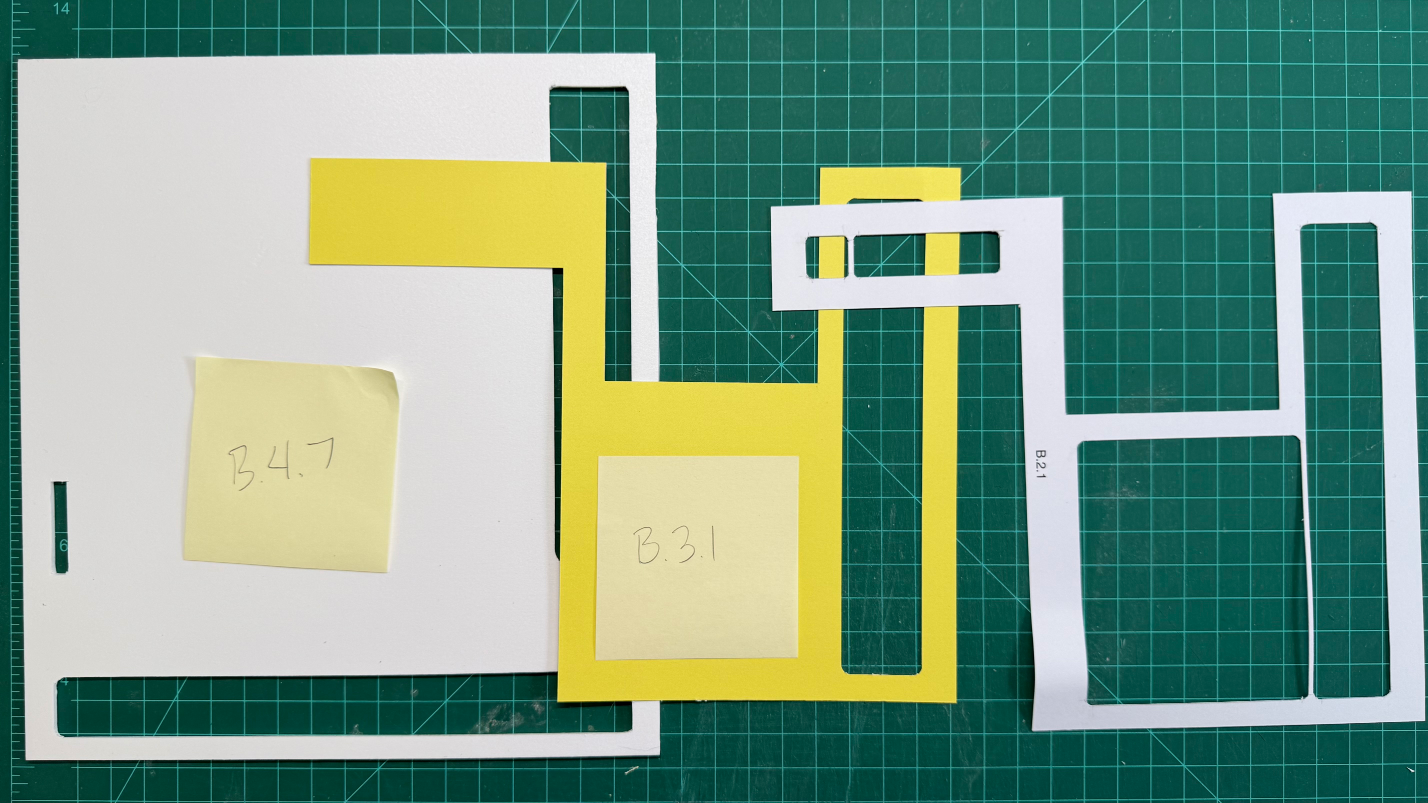

Laminate the case back part (B.4.7) to the cardboard or PVC.
If you’re building the Macintosh use page 18.If not use page 17.
If you’re using cardboard, strip off the surface below B.3.1.
Glue B.3.1 onto B.4.7. Align the part to the top of B.3.1 and with the large vertical hole.
Glue B.2.1 onto B.3.1. Align the tops and the large holes
Glue B.0.1 onto B.1.1. Align the top and holes.
Glue B.0.11(company logo) inside the square on the upper left. Glue B.0.12 (name badge) to the rectangle beside it. Glue B.0.13 (consumer info) to the large square in the middle.
Finished part. The paper overhand is intentional.

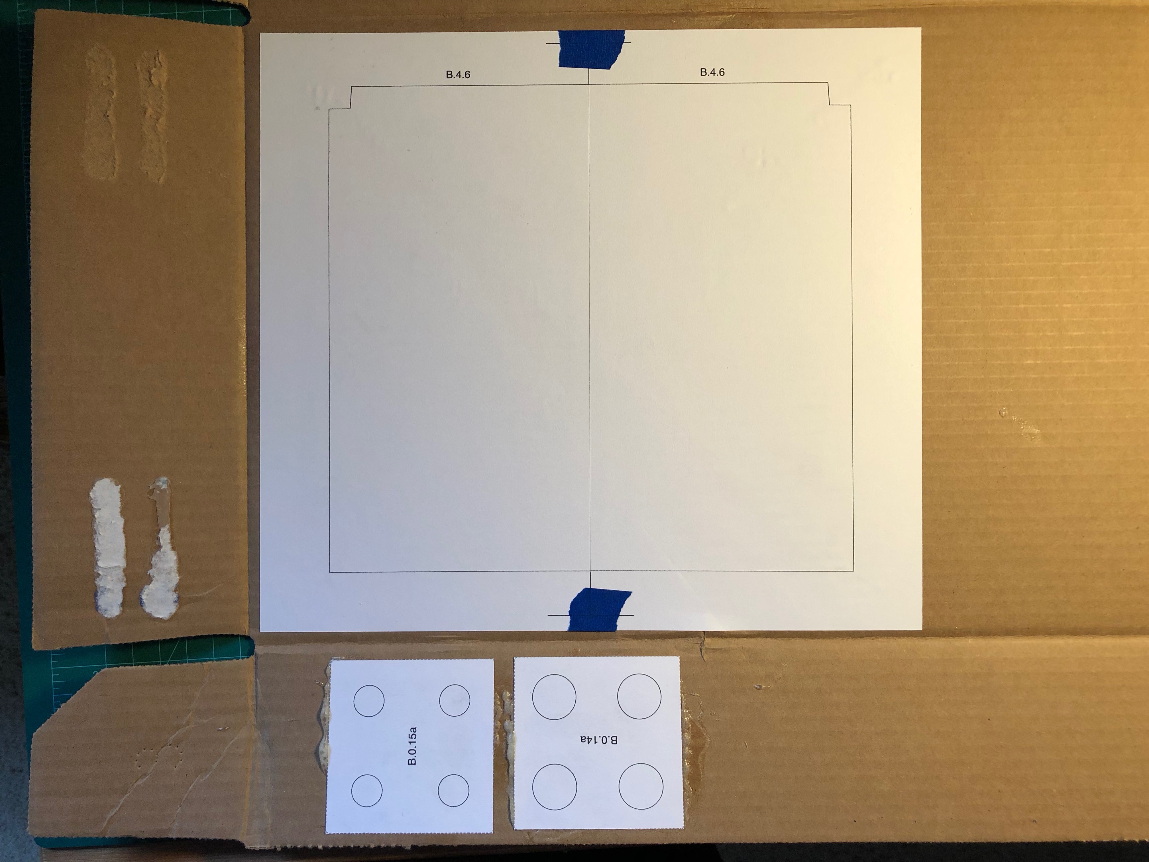

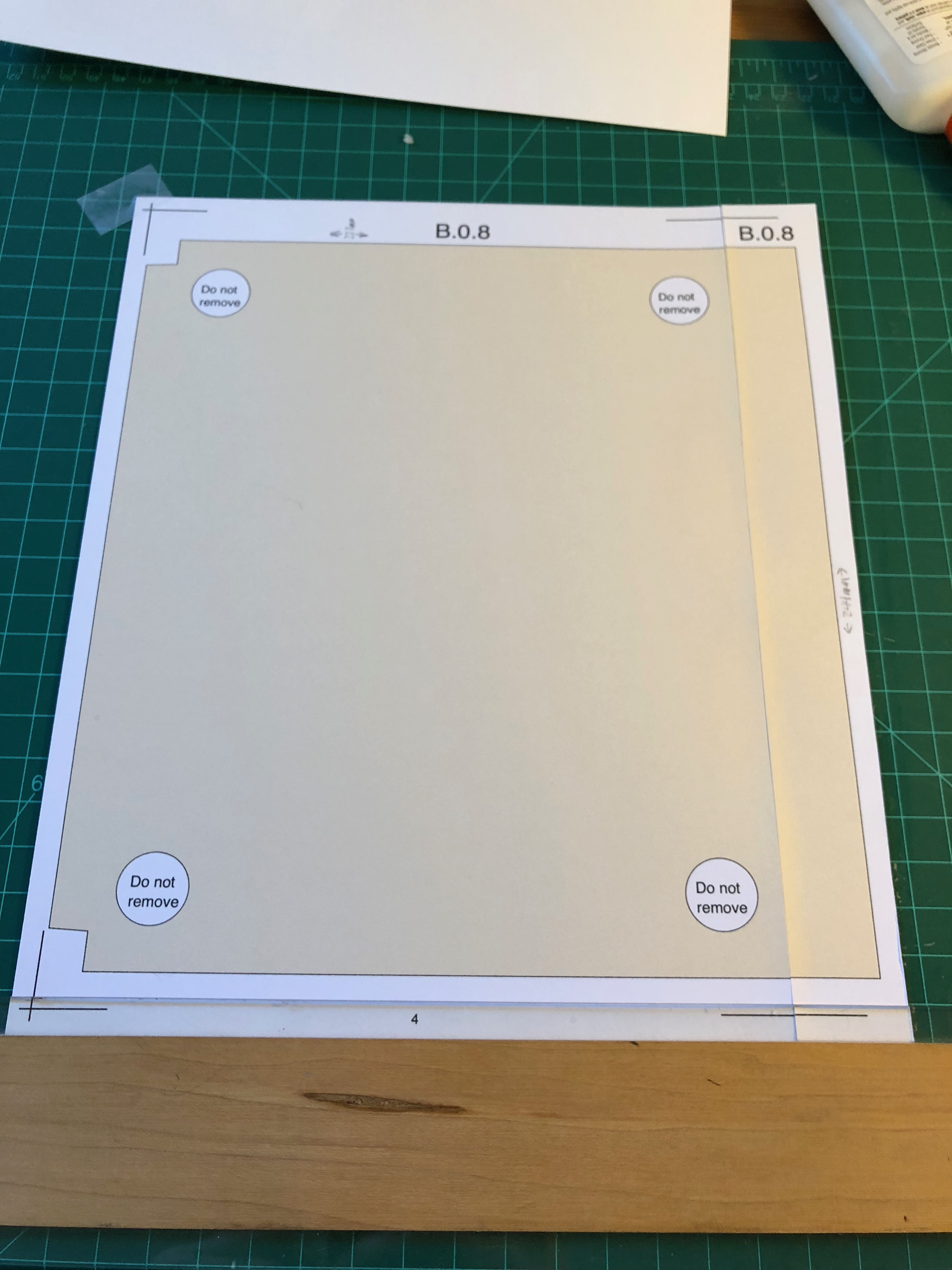

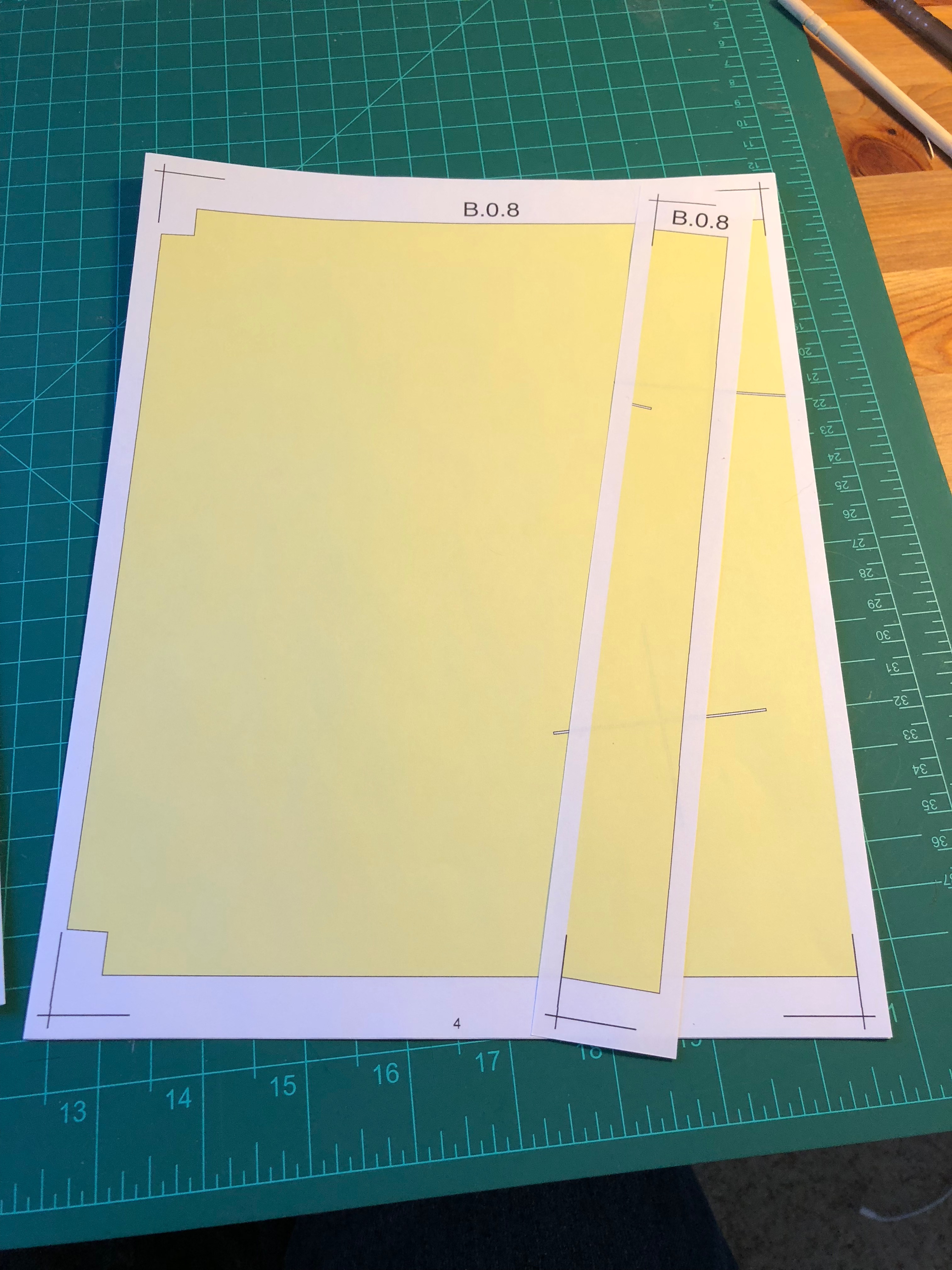

Case Back​
Bottom Panel​

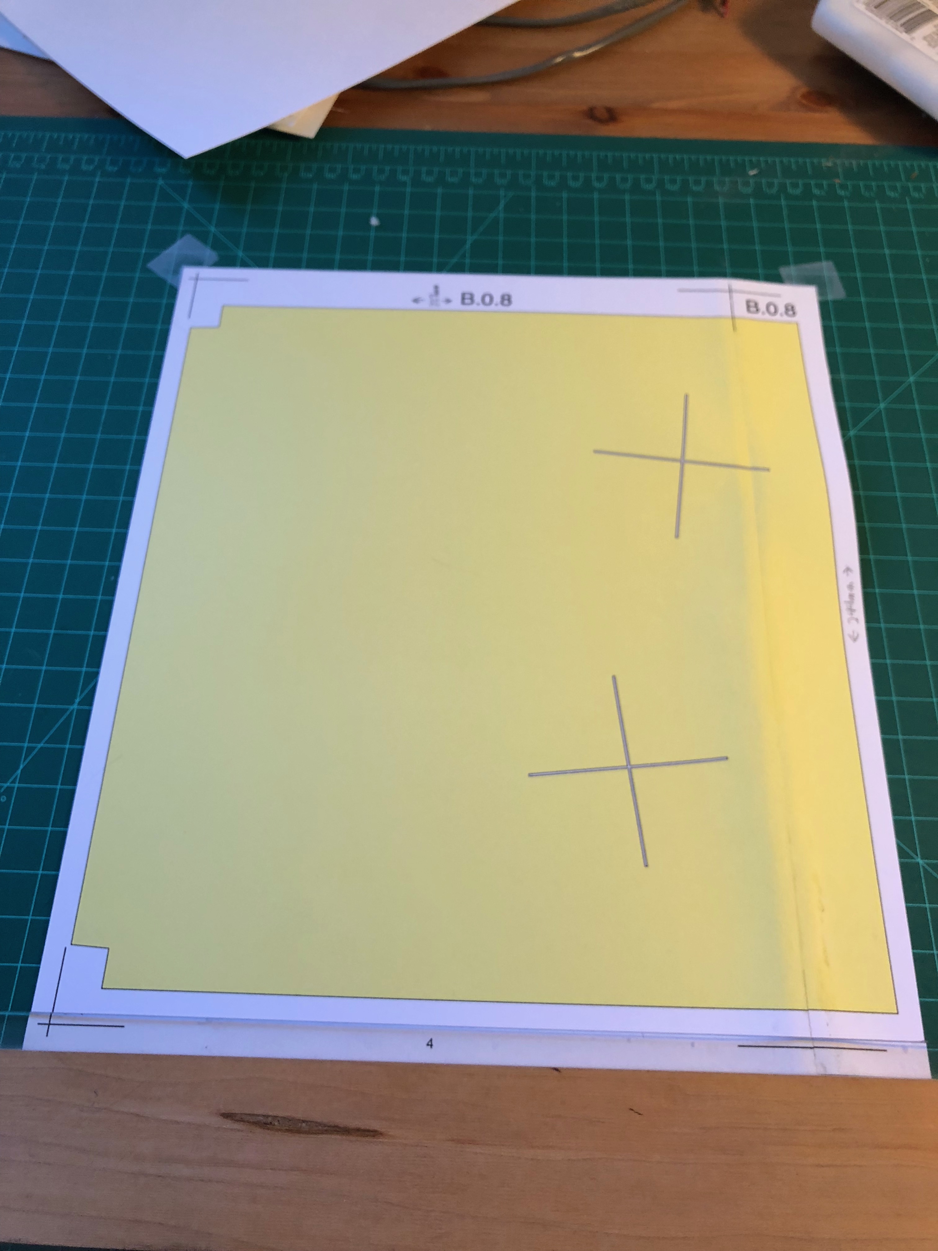

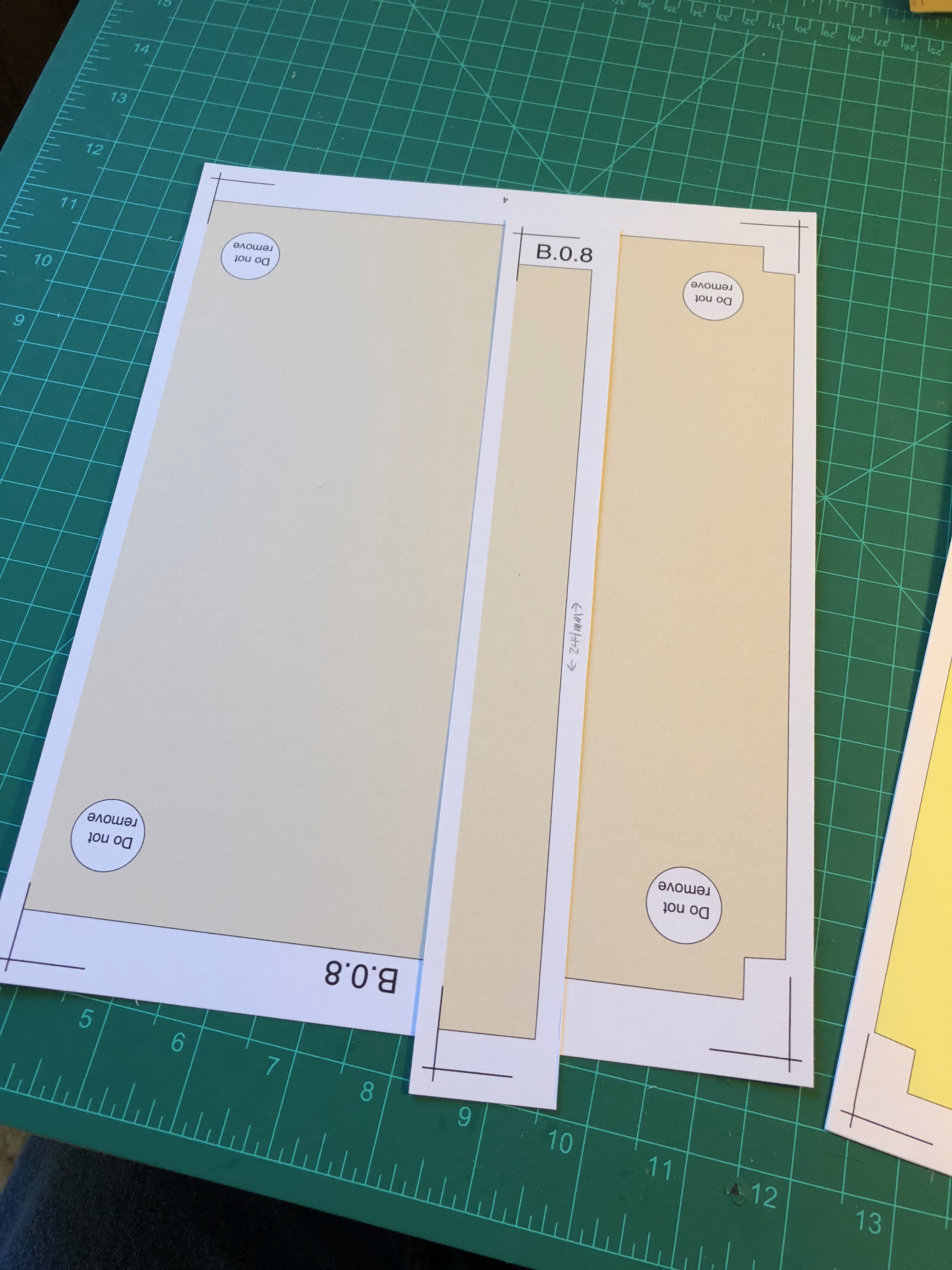

B.0.8 for Apple and Veidt.
B.0.8 for Banana

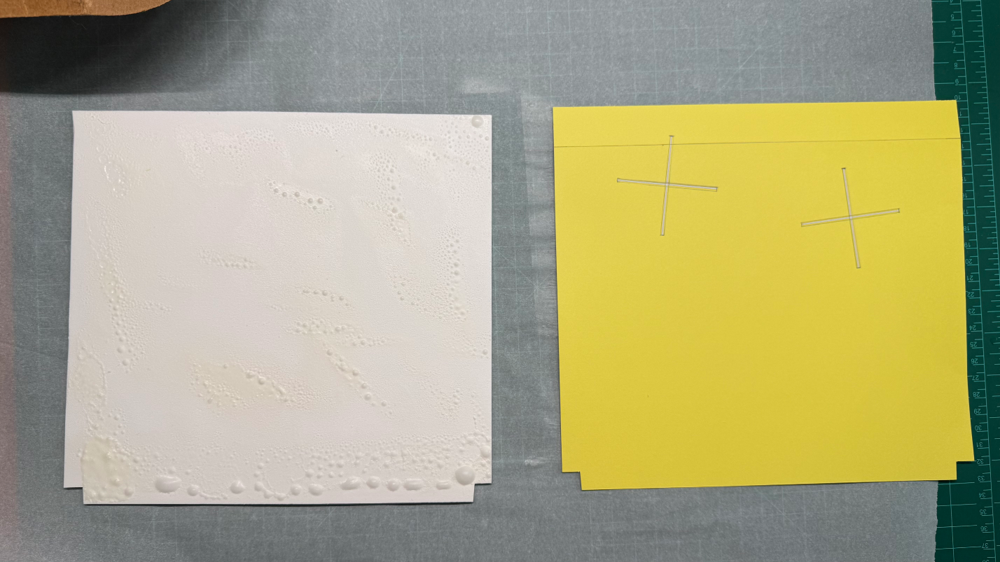

Glue B.0.8 onto B.4.6 aligning all edges.

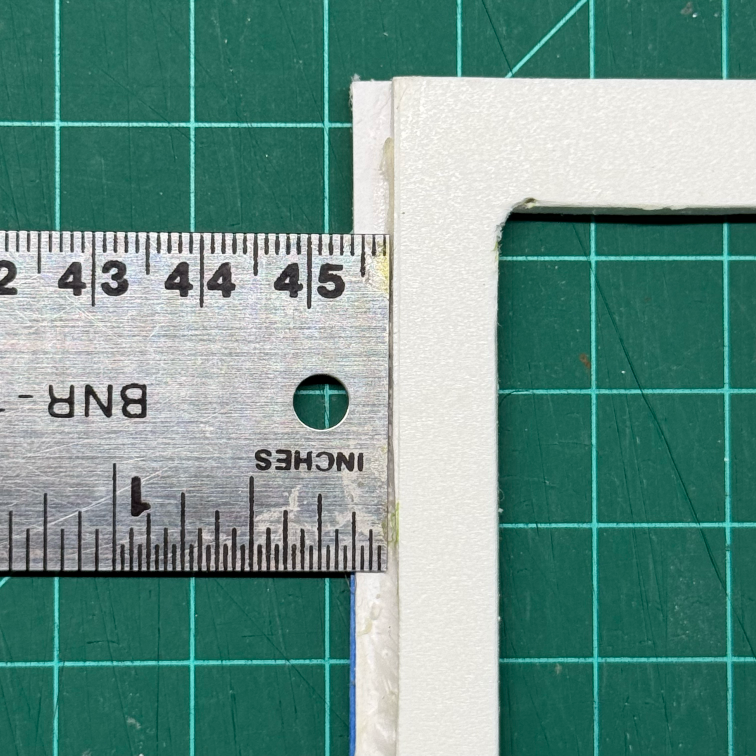

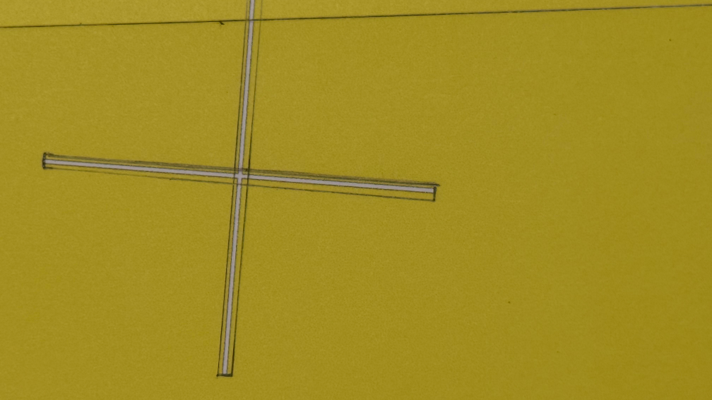

You’ll have to cut the slots for the legs wider than is indicated. The pattern has the slots at 1 mm. They need to be 3.61 mm (1/8”).
Test fit with the Banana legs.
