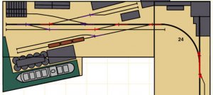

Plan with one turn back loop
here's the latest shot at a plan the "boss" can live with. I tryed to incorparate some of you guys ideas from before, while sticking with me prototype. Removed the turn back loop on the left and the "shelf" is only 16" wide.

These are easier to see- in the lower one there are three places where trains could enter or leave the layout. The two on the left would be the main line, and could be turned back toward the center of the room and run along the top of the knee wall of the stair well, where trains could be assembled or removed. The one on the right would run against the wall, and could be an interchange with the Southern Ry.

This one has everything flipped
I think removing one of the turnback loops makes for better operation. Which plan do you guys think is best from an operational point of view. Or how can I make improvements?
