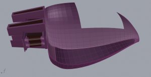

I'd like to see this model developed not using Pepakura as it cannot make true curves without an extremely high Polygon count. Rhino would be the program of choice. Pepakura models always look like Pepakura models. If Gandolf can unfold that nose, which isn't really too difficult if you "Extract" the Wireframe, then use the mesh lines the you need (then immediately pull the yellow wireframe away from the model!!!!. You can then get the shape very close to what you want. If you made a plug out of paper, by making formers and filling that in with two part epoxy, you could water form the top and bottom surface, and reproduce the mesh. Just make sure you printer uses Pigment ink. :)

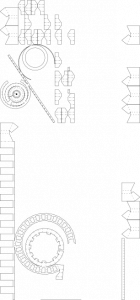

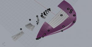

I unfolded my nose!... ( ok Ok ) Enough Kids! )

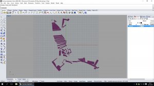

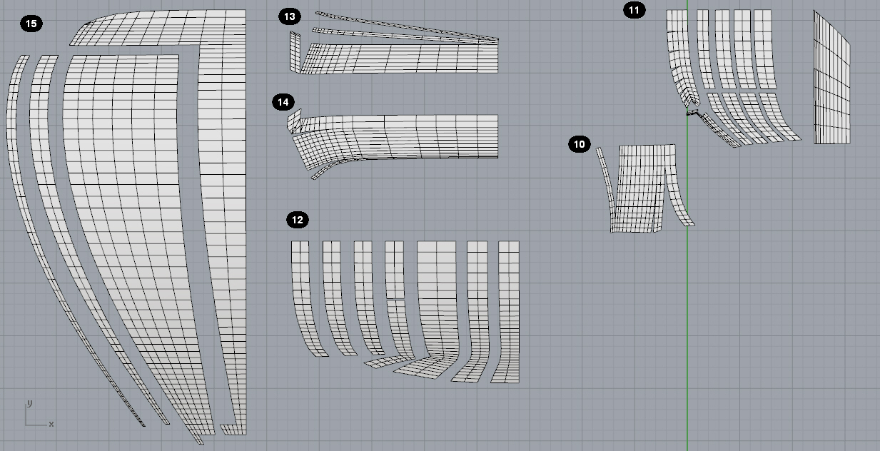

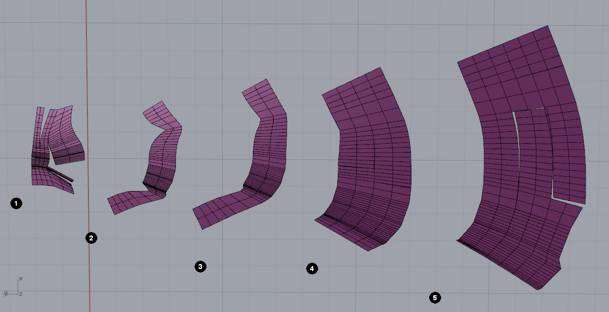

Got things to work the way I wanted..no help from any Rhino boards or the like..I know..others do this..as every time the question is asked on what to unfold a mesh with..people say Rhino..has a function to do that! Yet the tutorials and such..are basically only for stuff made with Rhino!
So after a lot of trial and error got something I can work with..still have to re-arrange things..rotate some stuff..took a full day to figure out how to cut a mesh apart ( didn't want to explode it, but ended up doing so..and found how to put it back together again...) the unfold is NOTHING like pepakura!!
as you can see..and of course as only as good as the mesh..but stuff is not scattered all over creation....
I already have been working on it as when unfolded it is ONE SINGLE mesh...what you see above is 1/2 of the Vorchan Head .
I need to figure out how to get to paper, as soon as I finish up getting things organized...and some notes...then will pass on a copy to Beta test!!!

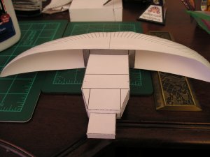

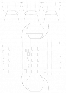

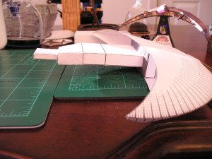

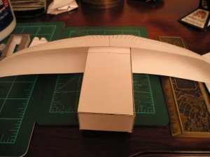

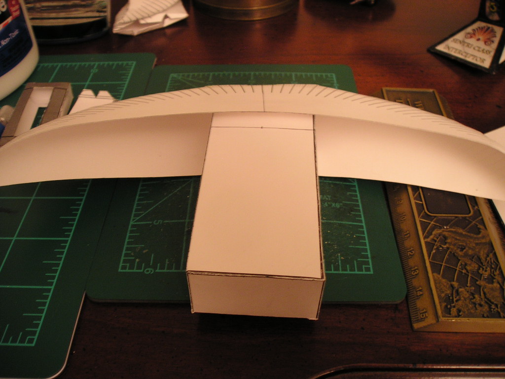

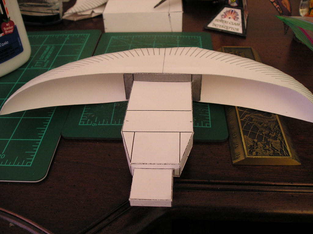

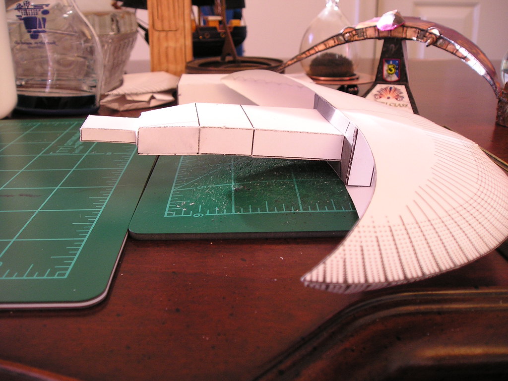

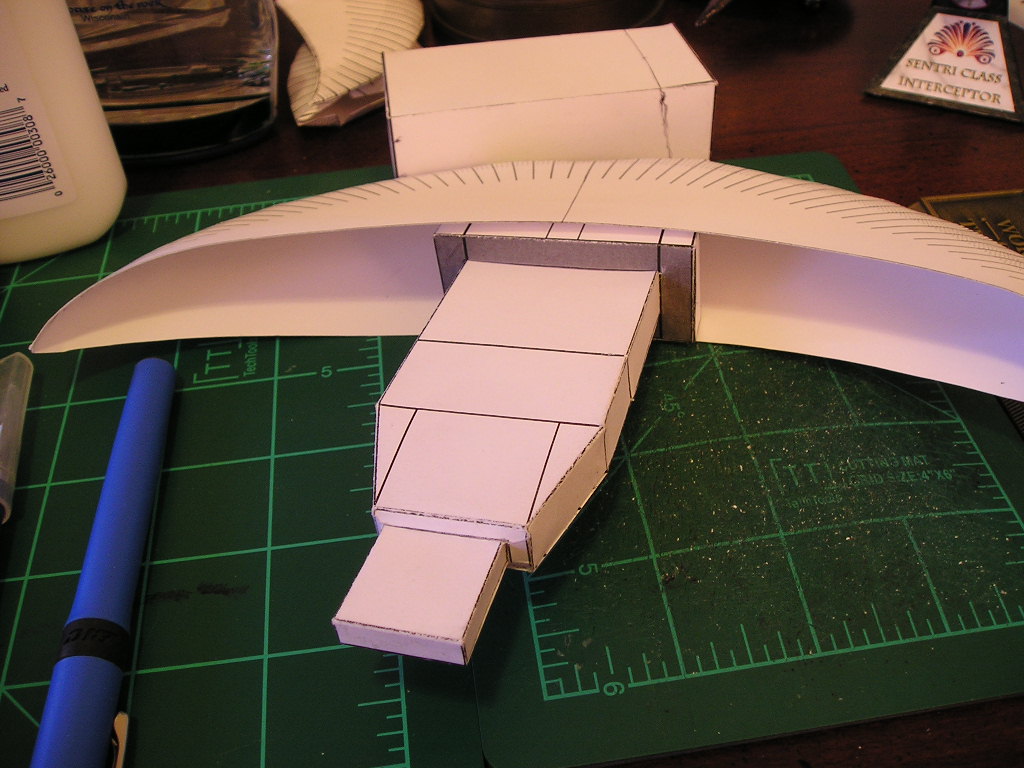

Additional pics. Fuselage assembly.

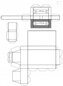

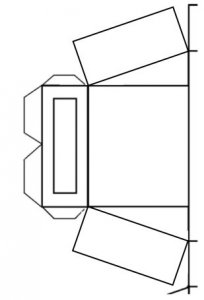

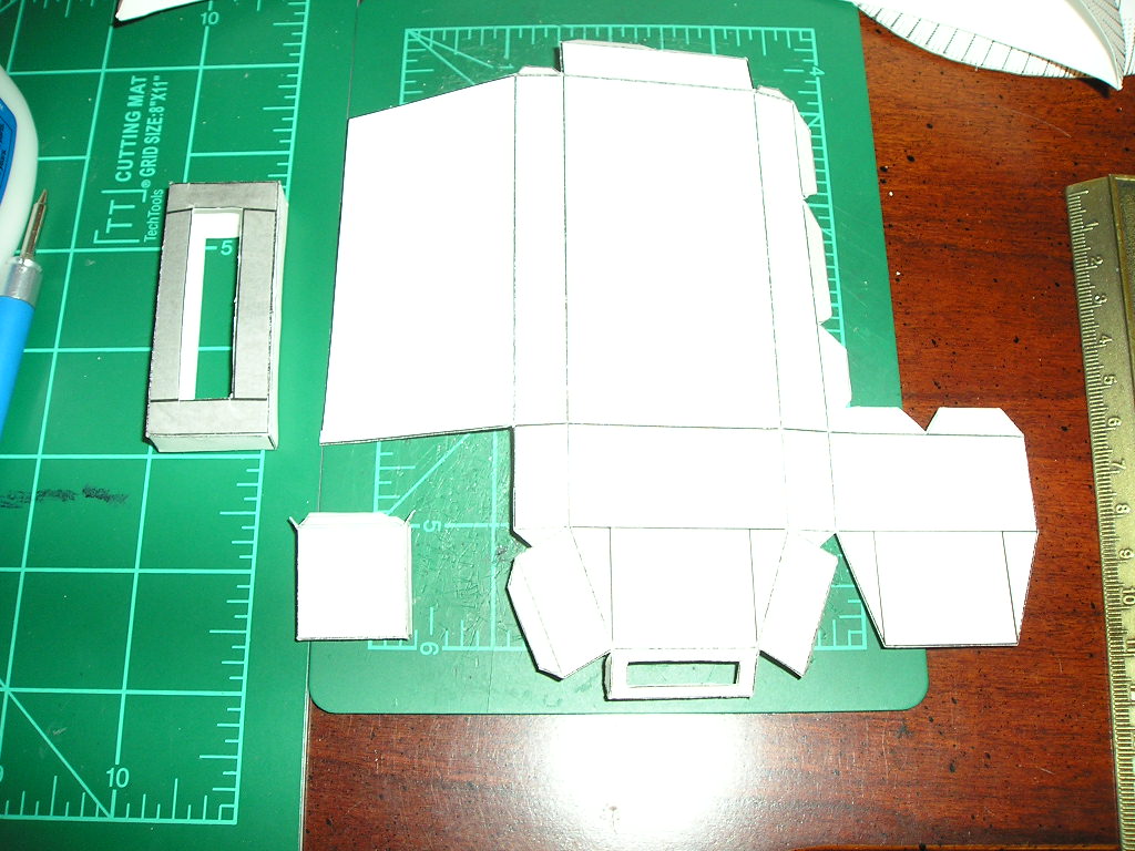

New template. The piece on the far left is the fuselage spacer and lower left is the nose support. The nose support should be able to slid within the curved nose portion that Gandolf is working on. Note the cut out portion of the front of the fuselage for the nose support.

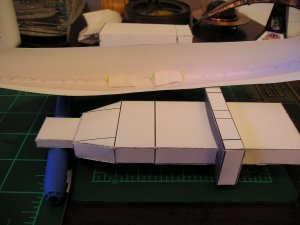

Originally a larger rectangular fuselage was built. The size was too big when slid into the wing. At this point a redesign was required.
Instead of the large rectangular fuselage. I reduced the main fuselage in size and created a space for the smaller fuselage to fit within to act as a support and to line up the fuselage with the main wing. Additionally, it will act as a support and guide for the front plate for the turrets. Note also the inside of the main wing. The excess cardstock was folded in the back and glued. The result was a very strong support in the back behind the engine assembly.

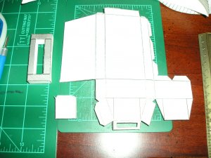

Pre fit of main fuselage and fuselage spacer.
Fuselage space glued in place with main fuselage.

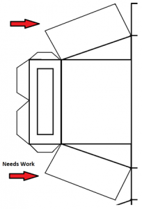

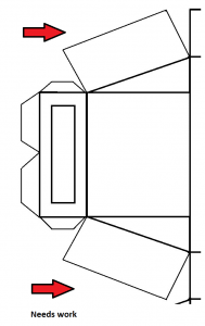

As you can see on the side view the front trapezoidal section needs some work. It actually angled down somewhat.
Current template fuselage and fuselage spacer.
Please feel free to modify as desired. The rest of the fuselage seems to be to scale with the main wings.
That's it for now.

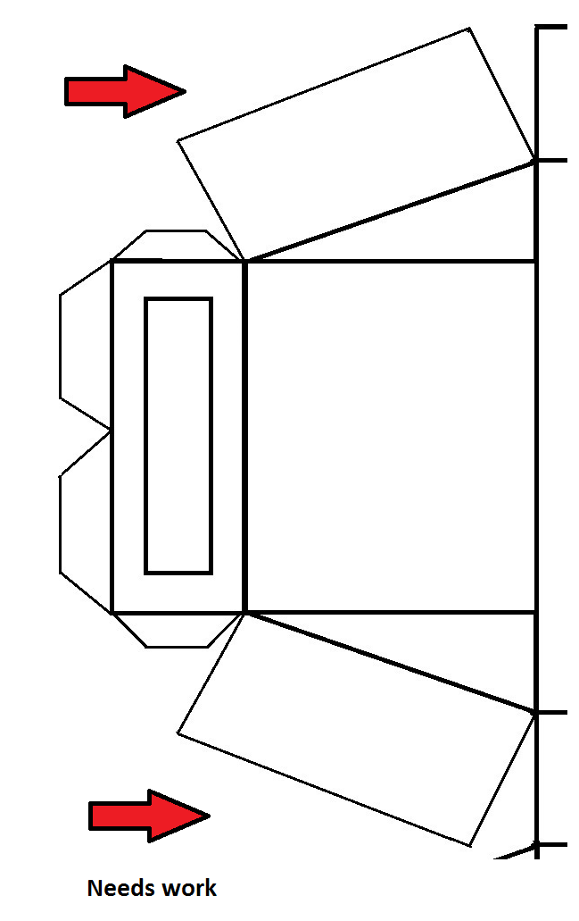

The front section need to be modified. The side rectangles on either side of the trapezoid don't line up well (i.e. they are too big and are not 90 degrees from the hypotenuse of the triangles). Please feel free to modify.

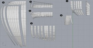

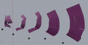

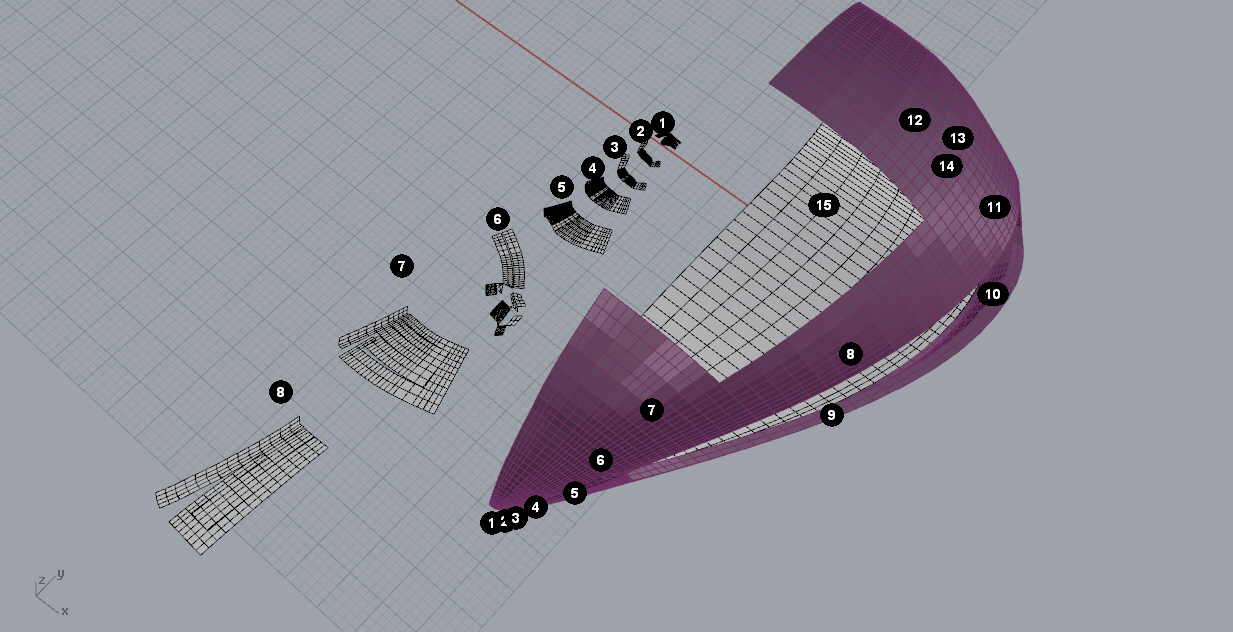

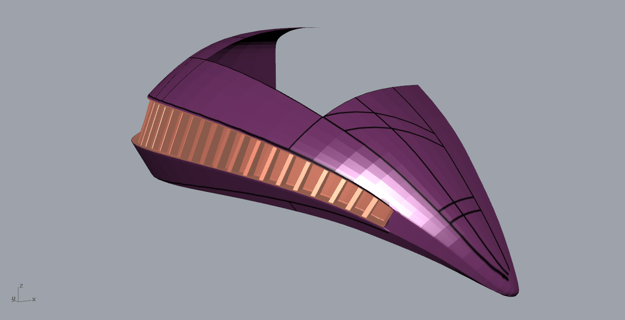

In Rhino, you can split the MESH by the lines on the MESH itself using the commands given in Rhino. This allows you to break up a mesh into unfoldable pieces. There are so many different ways to break up a mesh, it's almost impossible to get into it, or say which one is right. Unfolding in Rhino is extremely easy. Take a MESH and start playing with the commands. You could turn "OSNAP" on and make a curve following a mesh line, then use that line to cut the MESH, one of many ways. I try to stay in one program and move into others when necessary, but I find Rhino has most of model making wrapped up, it's a matter of learning the controls and manipulating them to do what you want them to do. Making shapes to use as cutting tools is another way to break up a Mesh. Extruding the line made by the aforementioned method will give you an excellent cutting tool. Rather than making every part, I tend to think of cutting up shapes to get the shape I want, if I am sing an existing MESH. By "Locking the piece, you can then draw over the mesh in the proper Viewport, and create the unfoldable shape you wish.
You can split Mesh's by their Isocurves. This makes working with MESHes easy. The first thing you have to do is "Extract Wireframe" from the MESH if the MESH was made in another program, as Rhino cannot see the MESH. Once the wireframe is Extracted, you slide the highlighted part away, you will see the original mesh, and the new one, made of "Curves" next to it, which is what Rhino works with, "Curves". At this point, you start deleting the lines you don't need, like most of those horrific triangles, and and keep the edges. I usually group the stuff I don't want first, then delete the group, as I go along.
I tend to make my own meshes, but since I work primarily with Rhino, you just see the basic shape of the part, or the whole part, depending on what type of view you are using. There is a lot of help with Rhino, though I tend to go to you tube and gather bits and pieces, and come up with my own method. I would gladly help anyone if they just asked me. No guarantee I know how, just an offer. :)
Took and deleted everything I don't know how many times..as things just were not quite right...and had to many files between too many programs and computers..to keep track of anymore..Finally did my own thing ...may not be the way others would do it but if it turns to paper..who cares!!

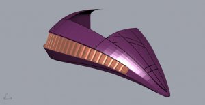

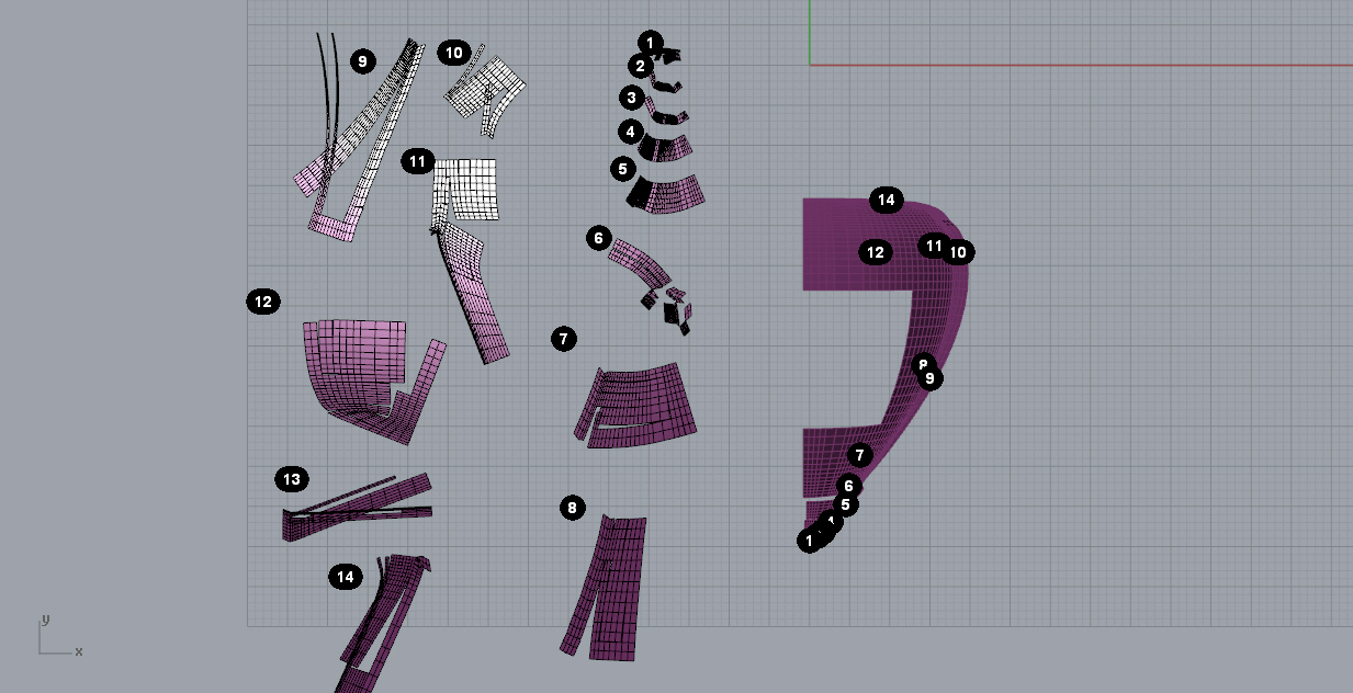

re-split the nose in half down the length..merged/deleted all the tiny protrusions..( can be greebled on if someone wants to... ) sliced the thing like vegetables going into soup...15 separate slices..and several of those had to be sliced again to rearrange due to overlaps... I have it with some textures but they will be dumped.... Spent a long time trying to figure out why the uv maps were destroyed when it was flattened..but it seems lots of people have the same problem with Rhino since version 4 at least...with solutions that verge on the absurd... haven't even looked at the internal texturing options in Rhino as yet.. but here are some pix...

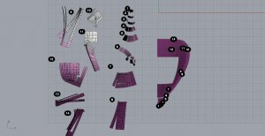

VorchanBeta30.jpgSection Layout
VorchanBeta31.jpgPattern work
VorchanBeta32.jpgNosecone (?) thing is actually all 15 pieces..just arranged them for the view
VorchanBeta33.jpghaven't got this far..started from the back to front...
VorchanBeta34.jpg went back to old design..can have the option of extra texture elements or not..
VorchanBeta35.jpg top area to slot into head openning..
VorchanBeta36.jpg Transition neck piece to fit around support structure...
VorchanBeta37.jpg command doodad on top...

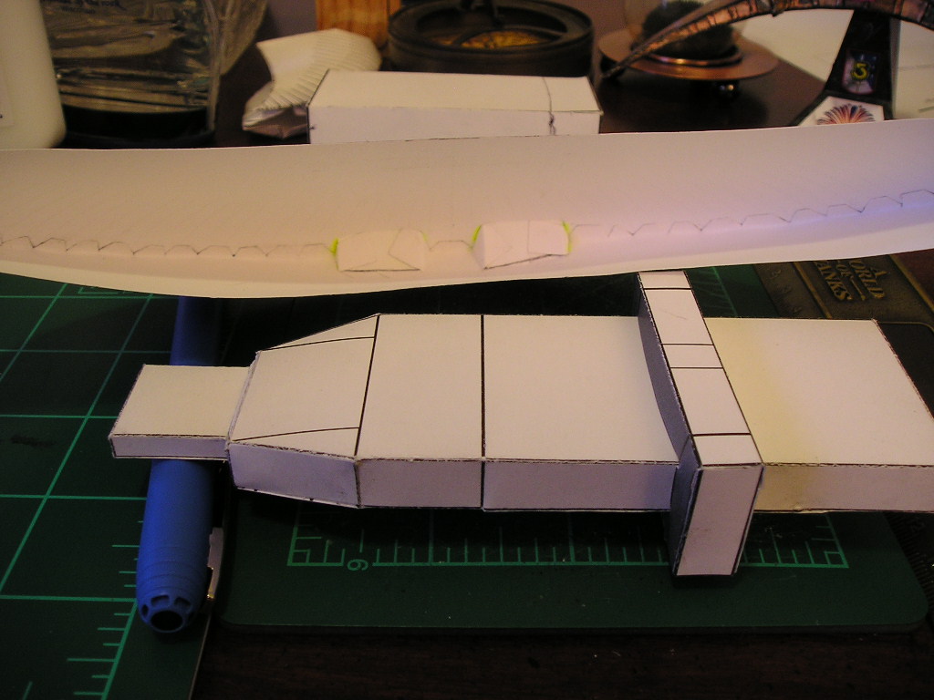

That's it for now.

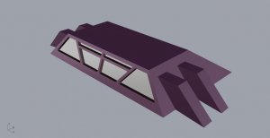

Maybe maybe NOT. Your work thus far has inspired me to do more. I have finally (I think) finished the design for the wing plates with the boxes for the wing turrets. Also have finished the main body nacelles. Working on the designs for the ridges on top of the main body nacelles as well as some turret designs. Most of the work done has not been colored or textured yet as I'm not sure of the textures that are going to be used and on what areas.
Most of the focus right now is getting the parts assembled and assembly steps. Once the major parts are done, texturing might be done by me, but you look like you would do a better job. If you would like to please feel free to texture the templates completed to date.

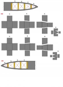

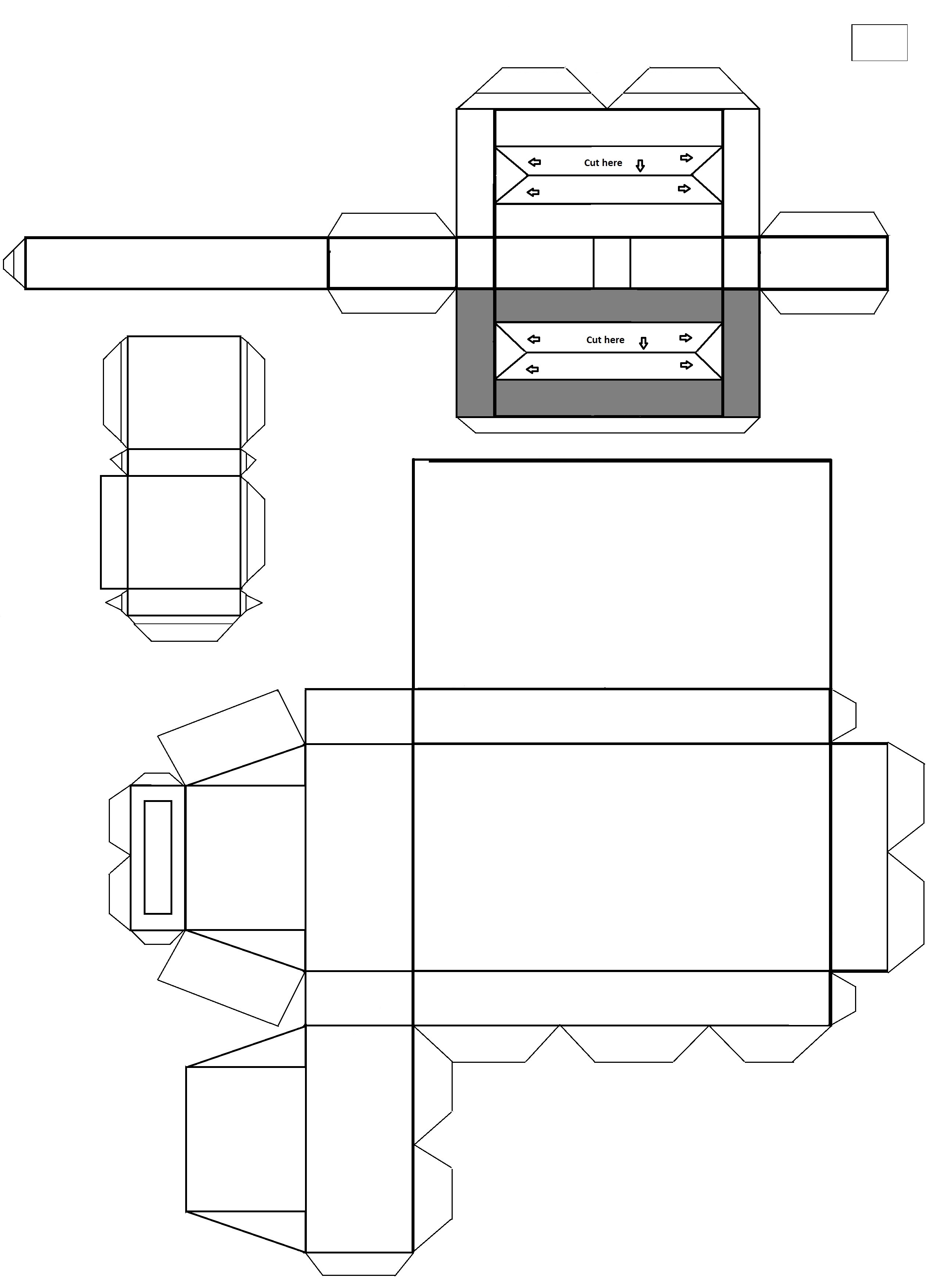

Here are some templates. They are labelled Pg. 2 - Pg. 4 respectively. Pg. 1 is your wing design which was the original inspiration and rosetta stone I have been working off of in addition to Jaybat's Omega Destroyer for scale reference.
Pg. 2- main fuselage - This is an update posted on this site. Modifications have been made to the front end by Revell Fan and some lines have been cleaned up. The main fuselage guide (the part that says cut here) has been moved down due to finding out when the nacelles were being designed that the center section was too far up. Some lines have been left in for guide purposes. Some lines should probably be put in to figure out how far the the fuselage is to be put into the guide. A hint is where the middle tab is for the fuselage where the front edge of the tab starts to go up. That's where the line should be for alignment.
Pg. 3 - wing turret front plates. The number designations indicate where the boxes go on the plates.

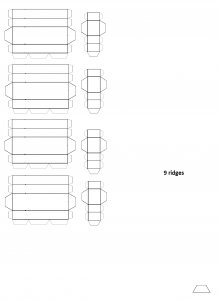

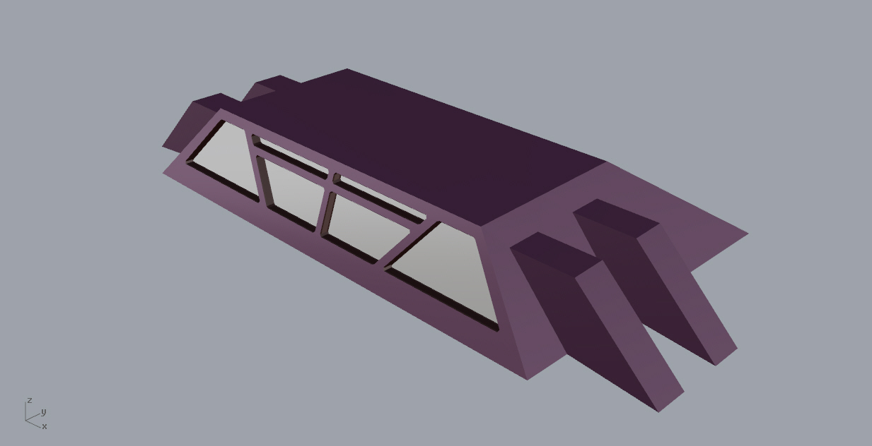

Pg. 4 - Upper and Lower Nacelles - main fuselage - still modifying. Missing the 9 ridges that go on top of the nacelles. The small pieces that are in front of the the main nacelles (big pieces) go in the front. The nacelles (big pieces) have been test fitted and are fine. Small pieces have not been test fitted yet. The small mini marks near the front portion of the nacelles line up with the big vertical line on Pg. 2 of the main fuselage.

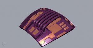

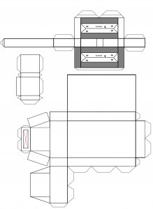

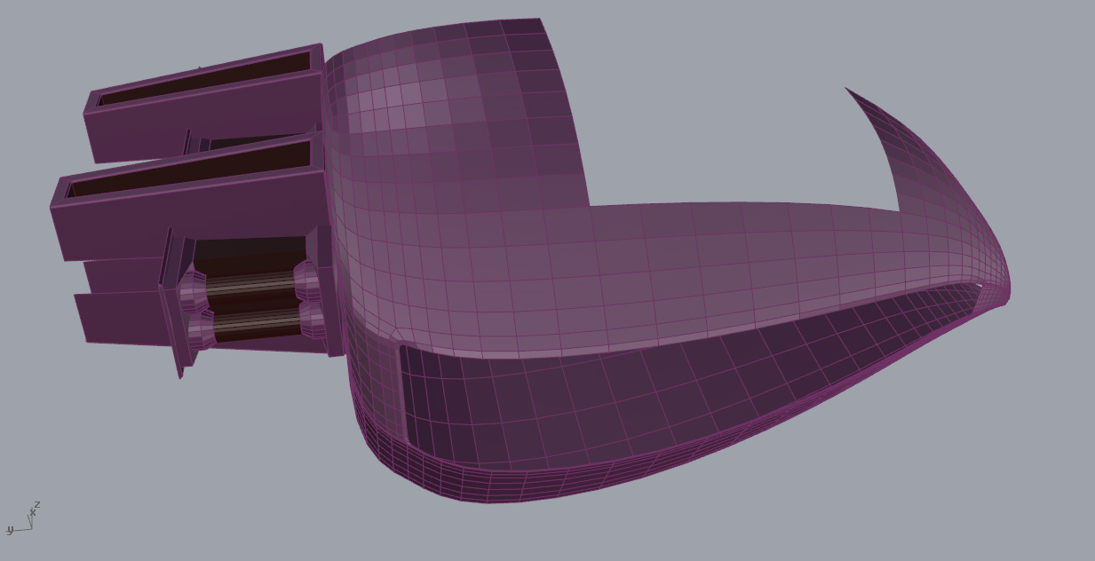

OK...well I have been busy....major problems with the mesh..and Rhino...and unfolding...some parts work great..some not at all..the simplest parts turn out looking worse than pepakura disasters on their worst days..the most impossible of parts..unfold..like The Shroud of Turin... and here is the reason...when made the original mesh was made for a rendering..meaning..no thought to joining boxes, corners,edges, meshes any of those things paper modelers think of! As I was trying to unfold a simple curved piece, I kept getting splinters of mesh scattered all over, no matter what I tried..so started looking closer at the mesh...1> the original, every edge of every box is filleted which in Rhino..leads to big problems..it can be done..but I don't have the time or experience to deal with the mesh as it is.. I can do it..but it will take far too much time than I am willing to spend...( I got models waiting to be finished...I hear them calling to me in my sleep !!) so...I am going a different route...and going to dump a ton of stuff on the beta builder !!!! Sky Seeker ( check your messages!! ) Right now like the ones posted they are not textured..but that is eye-candy..need to get the bones done first...
Engine Pod 1 of 2 ...page 1 of 3... THIS FILE IS ONLY AN EXAMPLE !!!!
Kept the fillets as double folds, details on engine pods can be cut-outs or eye-candy..I hate doing tabs but they need to be at least dotted in for those that use them...and such... I have just finished the 36th page of stuff like this one...virtually all the main components I think!?! time to check/Figure and re-do stuff...I have some of the details as well, just to test things...

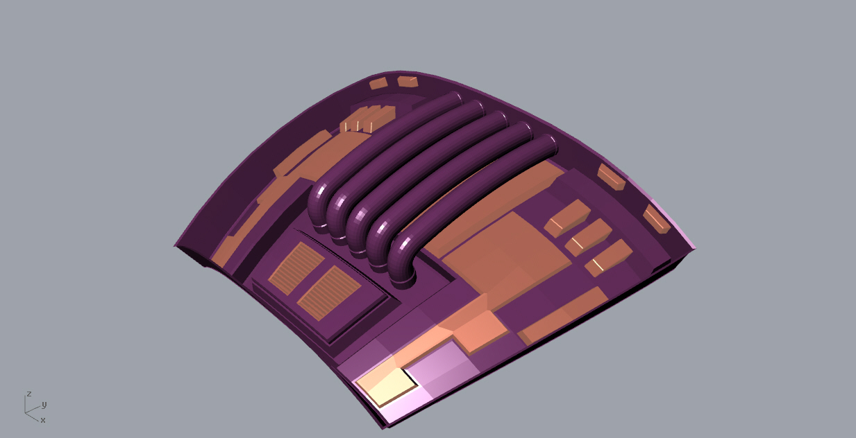

Engine Doo-Dads 1 of 6... THIS FILE IS ONLY AN EXAMPLE!!!
again simple eye-candy or can go full tilt and do the cut-outs!
Beta..Build is on its way!
