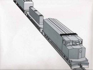

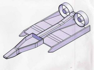

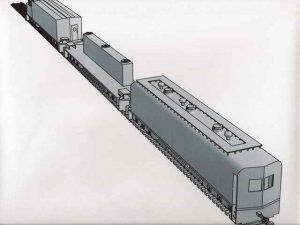

I have a few picts of assemblies that i have done (these picts are out dated of the actual projects which have changed a lot) if you would like to see what inventor can do. I personally use inventor, i started off with AutoCad 2000 and i eventually got better at it but it took alot of learning. i was also introduced to architectural desktop for all of our architectural projects (which i still use if i have to do something architectural) Then last year i was introduced to Inventor. Since then i have seen it from Inventor 6 to Inventor 10, and i have entered into many professional competitions and am waiting for some to start :thumb: If you have any questions about the program i will be happy to help you.
And can you believe that i am only 17 :wave:
